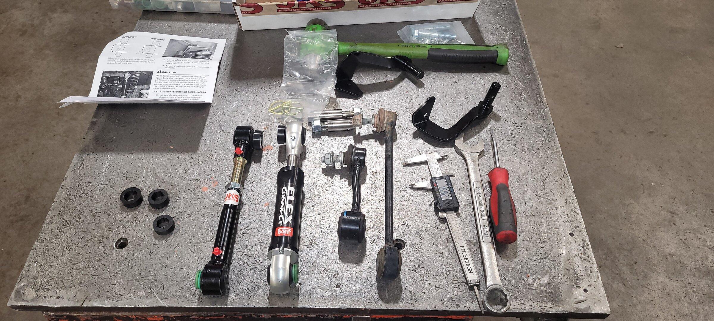

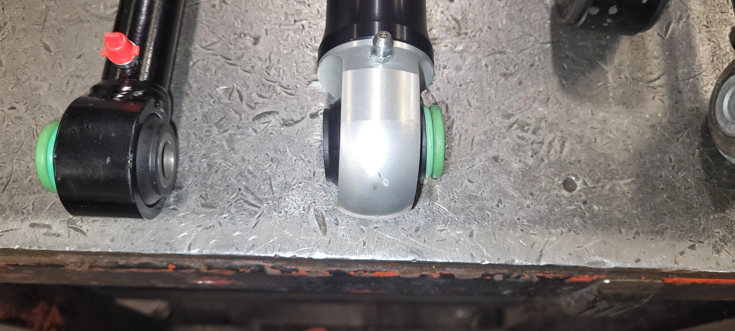

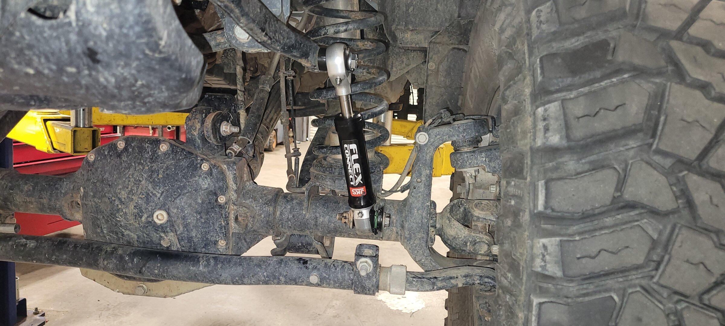

Just finished installing the JKS Flex Connect Link Kit part #PAC2114 on my Rubi this morning. Looking forward to a softer and controlled ride on our upcoming off road on a 900ish mile long trail!

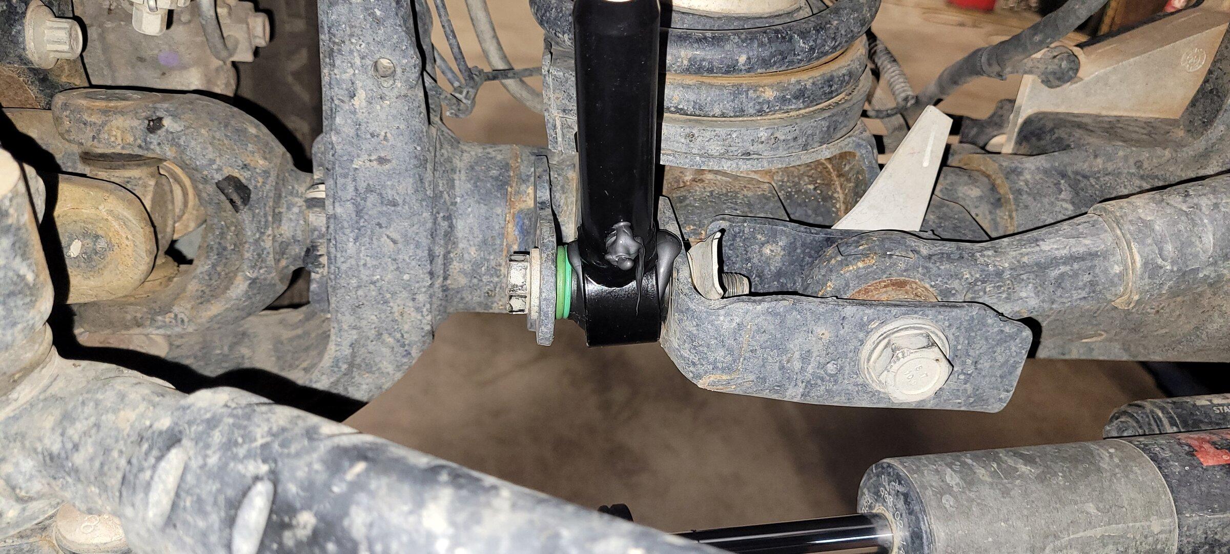

The unfortunate thing is that they do not currently offer a kit for those of us that have a Rubi disconnecting anit-sway bar so it is supplied with the hardware to disconnect and contain contain them when disconnected..... Another side note that Ive seen as a complaint here is that people don't like cutting off that double sheer tab on the right side axle tube.
I contacted them a few weeks back to inquire about availability, but all they offered was for me to piece together a kit with a bunch of stuff I didn't need at my own expense. I did send them another message this morning with pics, so maybe of enough of us lean on them with interest, they would make the offering?
Good thing I have the ability to handle the manufacturing of the required parts myself....... Not sure how long the O-rings will stay on there, but if they wear, I'll cut off some poly or UHMW spacers for that location.

They work as advertised. Its crazy how this product doesn't seem to have caught on.
Still running them in my truck and a few builds I did at the shop. For you they can be installed with the hardware supplied so they disconnect. I have since machined out some simple aluminum bushings for those of us that have the e-disconnect sway bar for a sano install.
