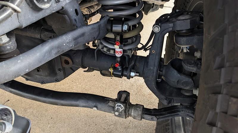

We installed the JKS Sway Bar disconnects on the Mojave today and we did have to cut the tab off on the passenger side. It was quick and painless.
Love them so far ill try them out this weekend.
Jeep Gladiator JKS Flex Connect for Mojave i-5wXbg9W-L
