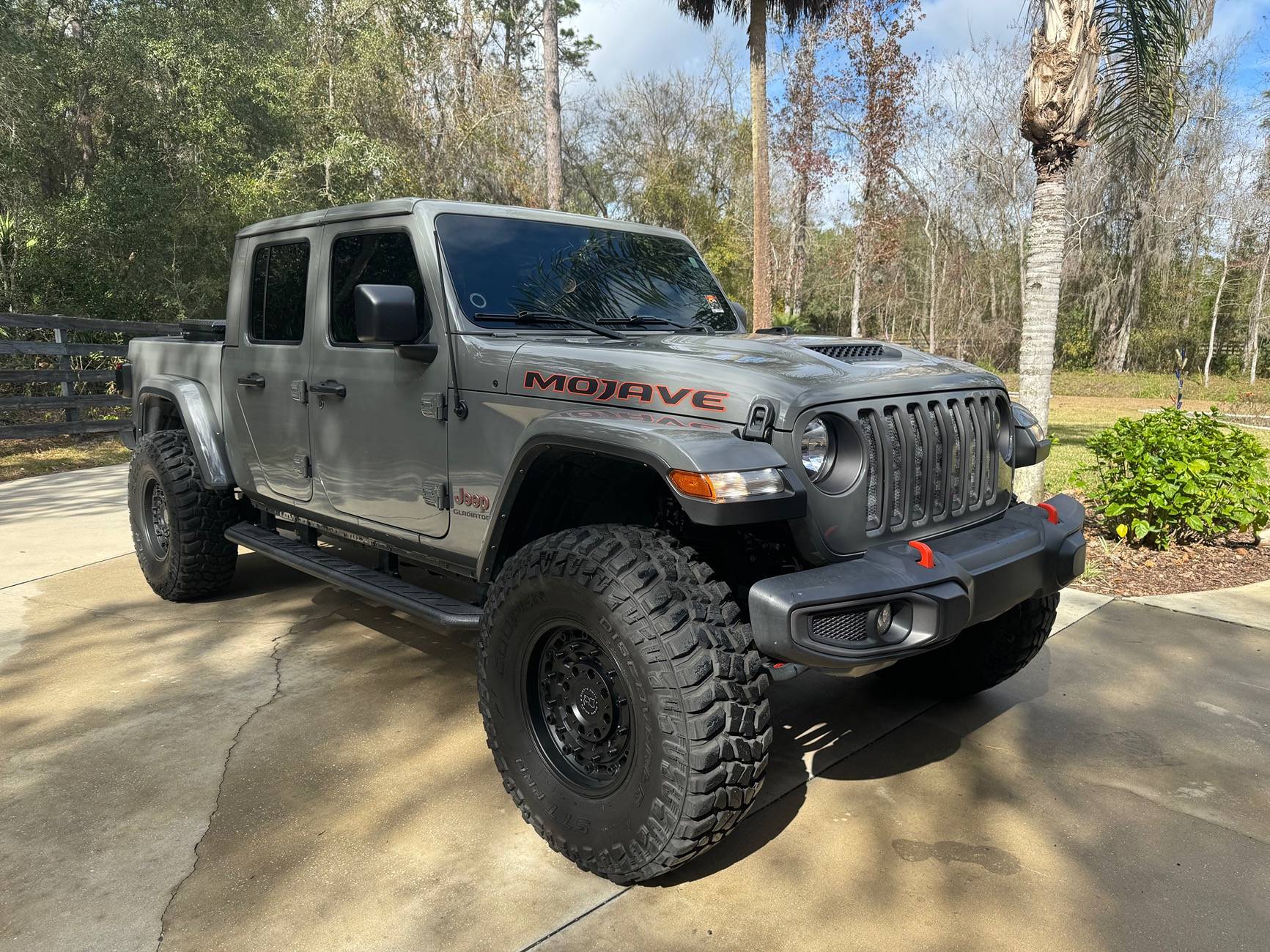

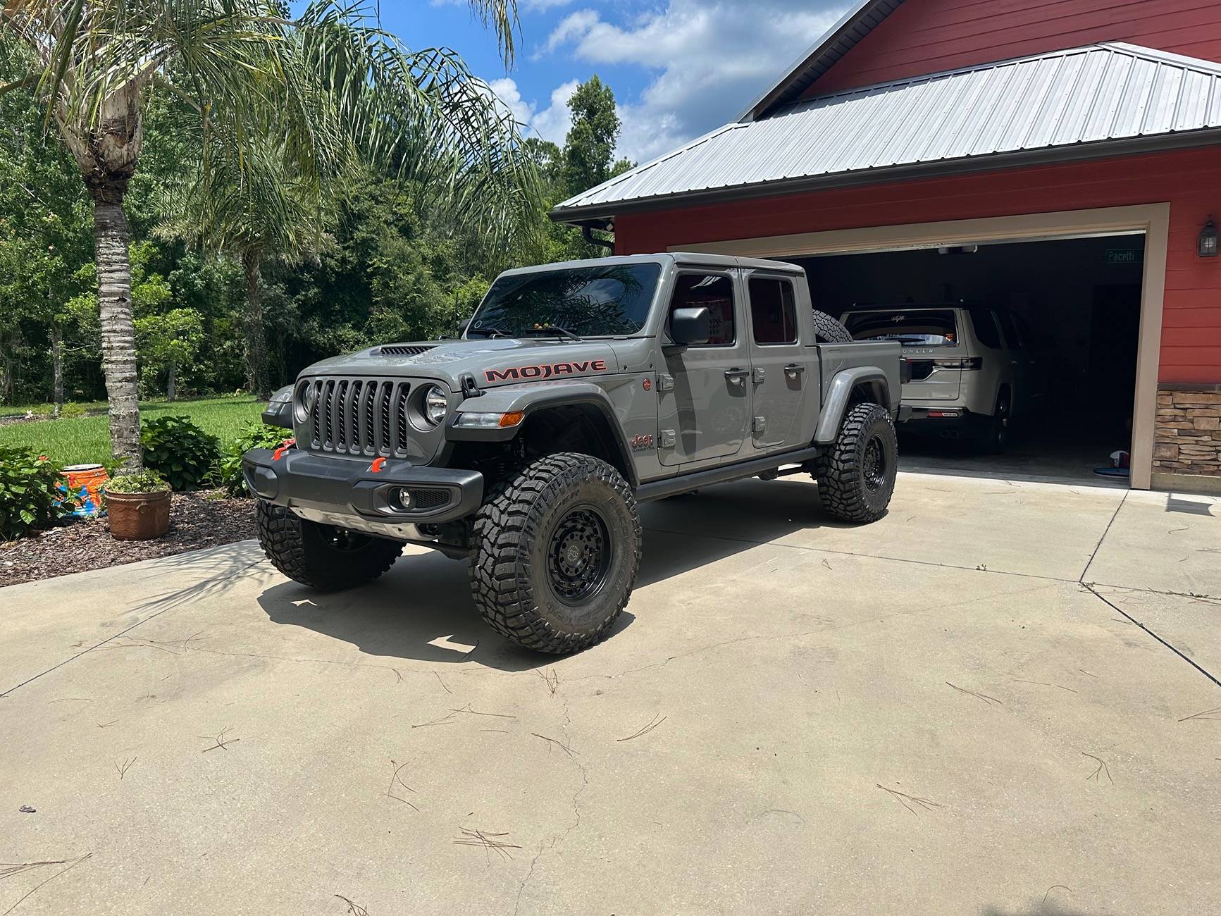

I’ve been running the JKS J-Kontrol lift before they came out with the ‘Mojave’ specific lift for a little over a year and have put 15k miles on it. I haven’t had any issues, and the ride quality is great even before I changed from the stock shocks. I’m running 37s in these pictures. Has done great off-roading at high speeds (60 in whoops) and rock crawling. Great company as well.
Jeep Gladiator Information about the jks mfg lift kit for jt MOJAVE IMG_2484
Jeep Gladiator Information about the jks mfg lift kit for jt MOJAVE IMG_5040
Jeep Gladiator Information about the jks mfg lift kit for jt MOJAVE IMG_5041

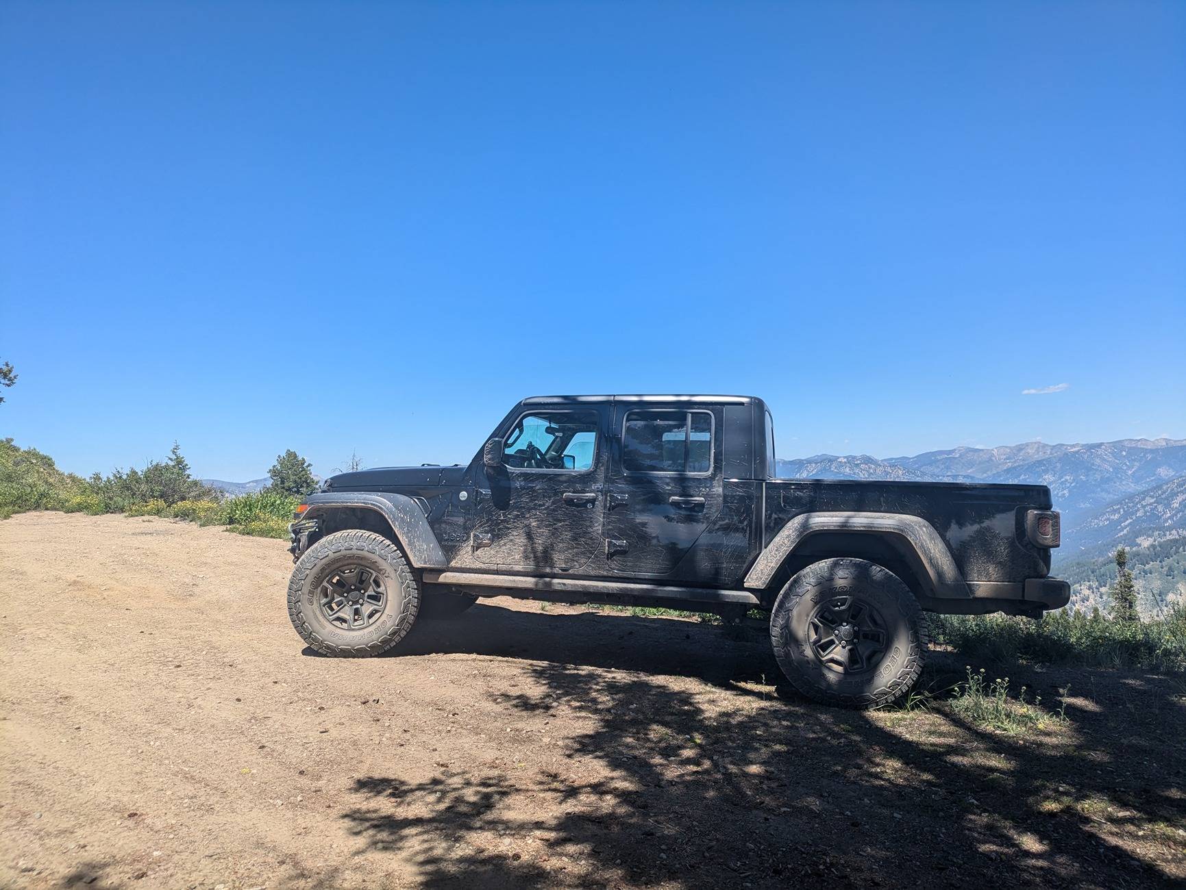

I've had the JKS 3.5inch JSpec lift on mine since February of 2020 and have zero complaints about the ride quality or performance of the lift.
Jeep Gladiator Information about the jks mfg lift kit for jt MOJAVE PXL_20240706_204827933
Jeep Gladiator Information about the jks mfg lift kit for jt MOJAVE PXL_20240706_201435135
