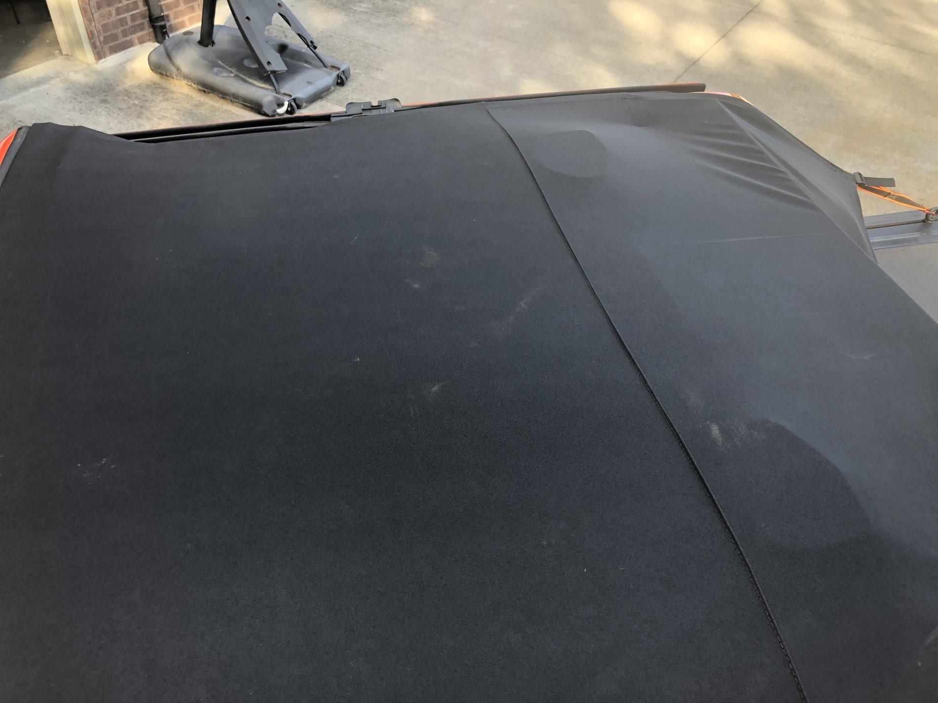

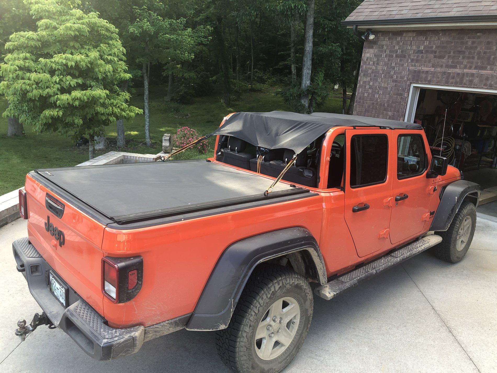

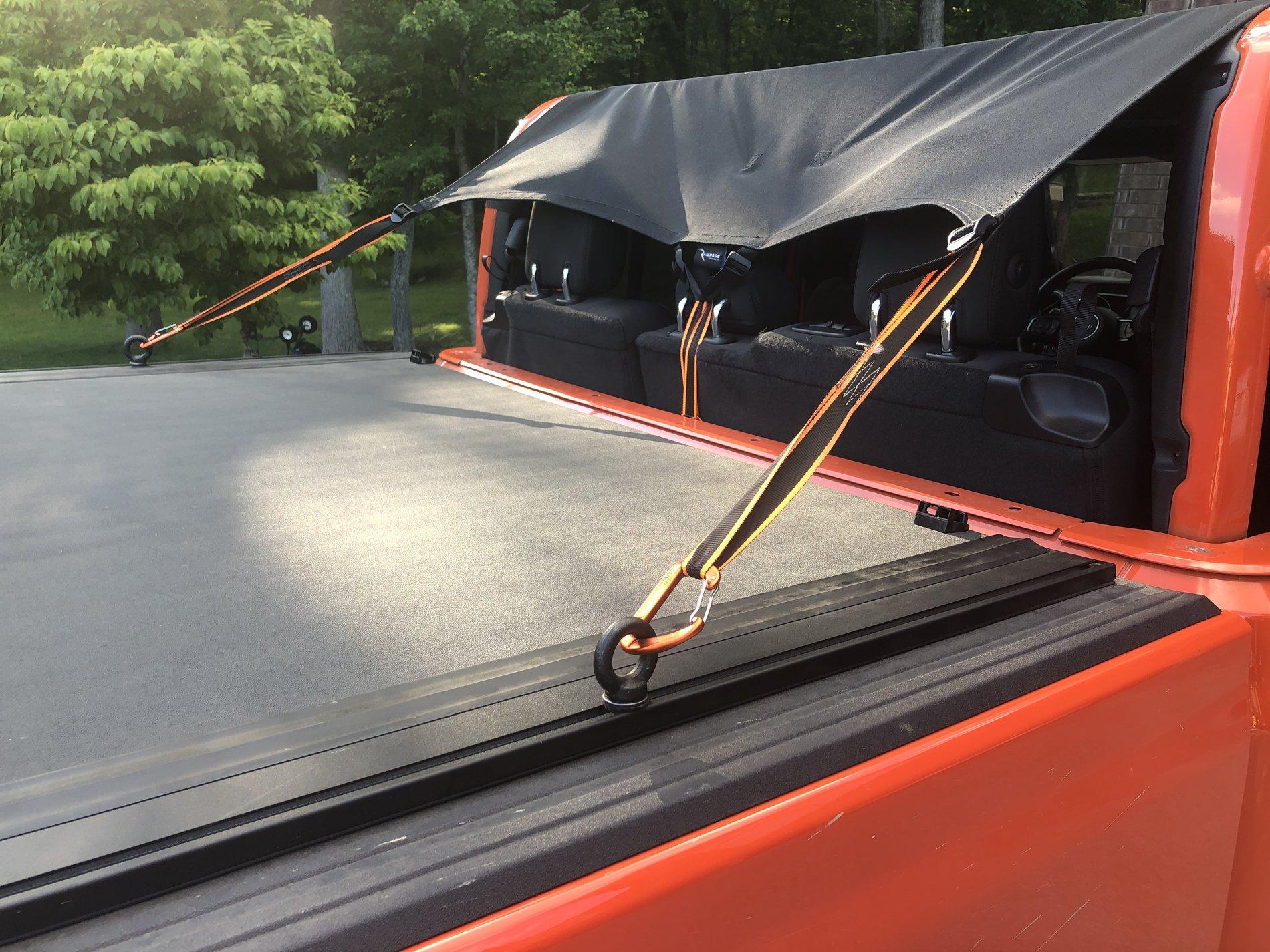

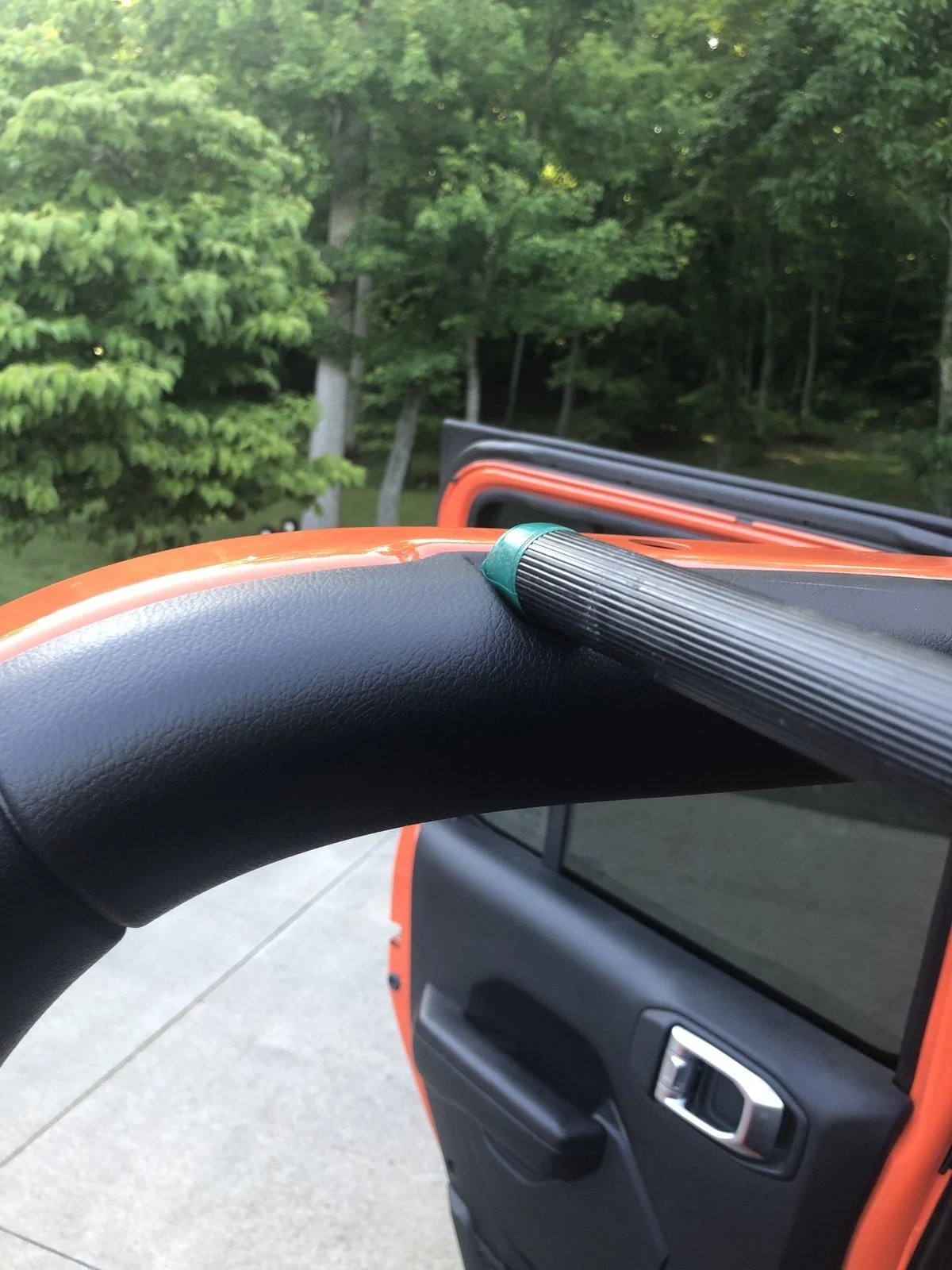

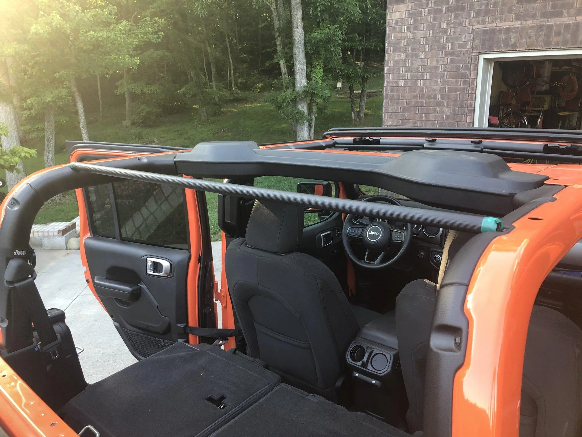

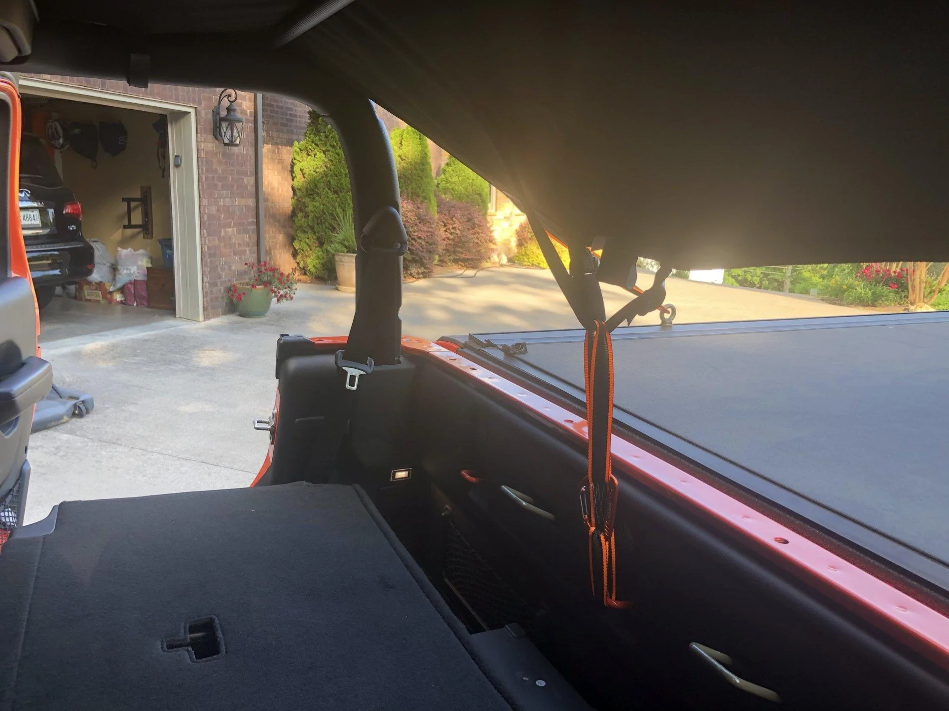

So here is my install of the Rampage JL Bikini. It’s a little redneck but it works. Used Yakima eyebolts in the T Slots on my bed rails. Pulled the middle down and fastened to car seat anchor behind the seat. I may change that. Really tight fit and no flapping on the interstate. Yes—that is a broom handle across the roll bars—cut to sit in the indentions.

Ever considered having it cut down and additional straps added to secure it to the roll bars? I think that is going to be my plan and i can't imagine it would cost very much for an upholstery shop to make the modifications.

That is a good idea—I’m sure it would be possible. Potential problem is that the roll bars are so forward you may lose some coverage. Not a big deal—you’re gonna get wet anyway if it rains. Hoping this is temporary and someone will come out with something better soon that covers from door to door like I had on my JK. Does the JT/JL soft top use surrounds like the JK? You gotta fill that gap somehow to keep the rain out.

Also it kind of needs to be pulled out & supported in the bed to eliminate any water draining into the cab behind the back seat. I have a bed rack so for me, i will incorporate the support straps to anchor off the rack.
