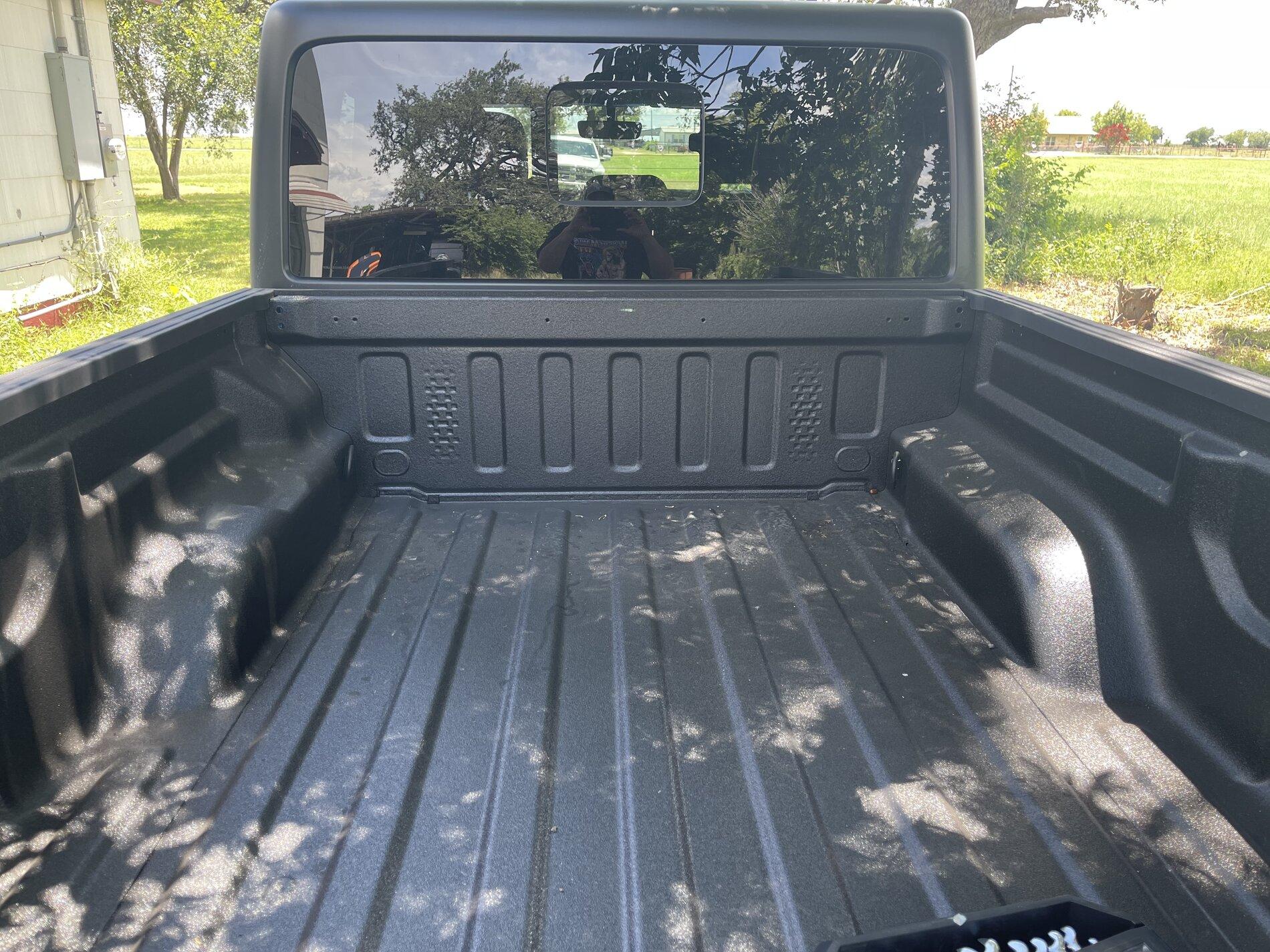

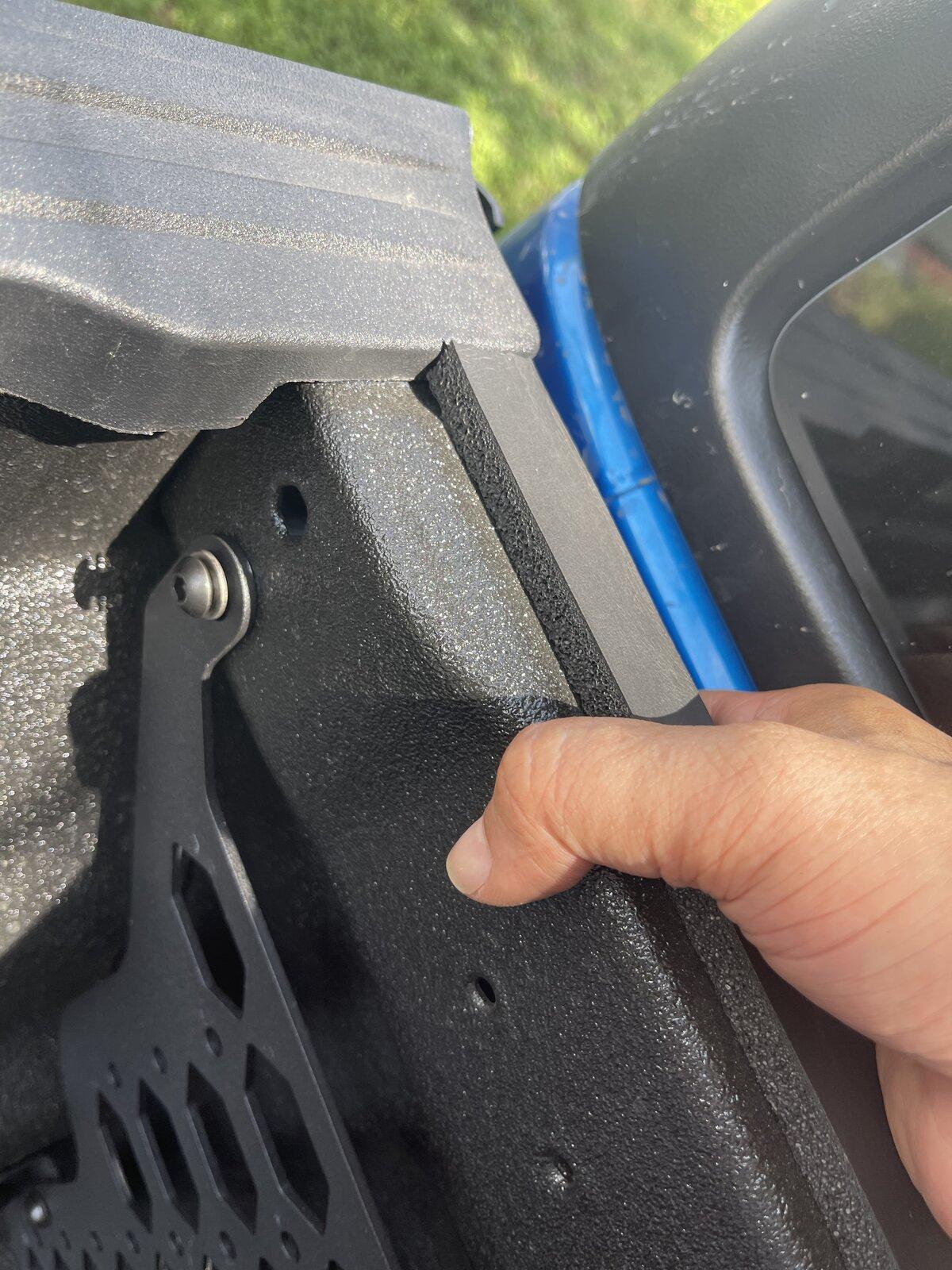

So i didn’t see this before hand but the side panels require 3 holes to be drilled into the bed side. You will then install 3 press in nutcerts. It says to use a tool which I don’t currently have. Going to search the net and see if i can just press in (punch and hammer) or If the tool is absolutely needed.
plus it is fixing to rain.. will come back to this.

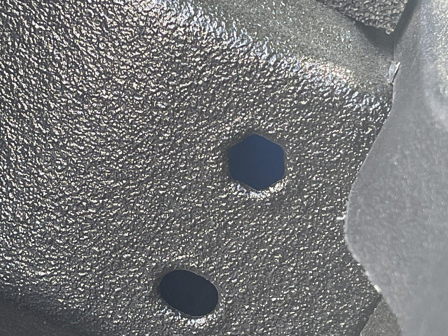

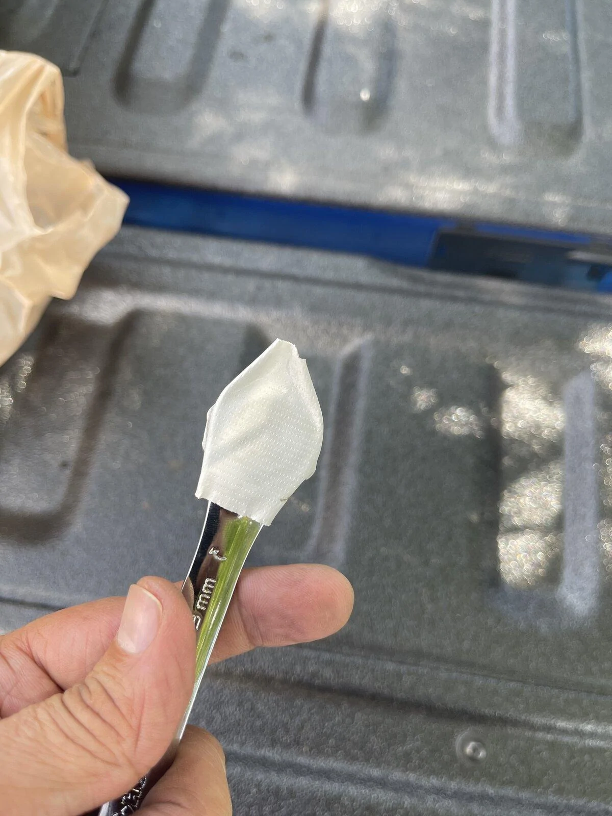

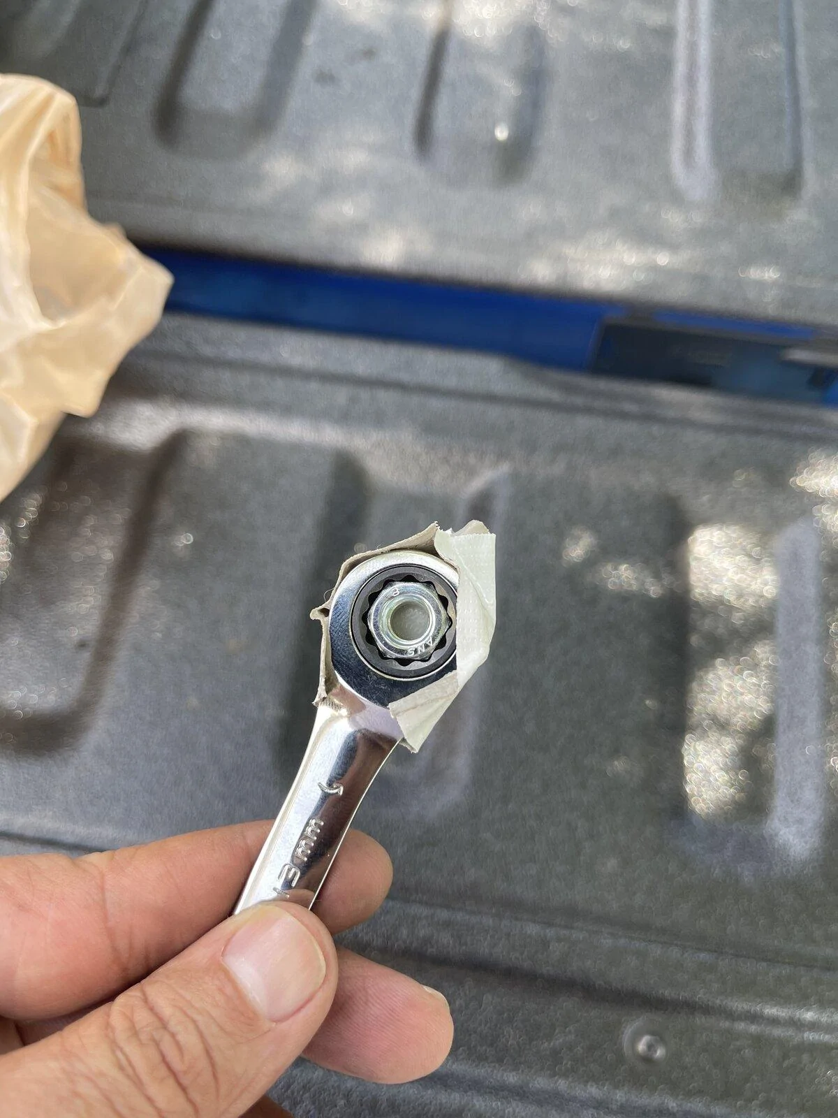

Ok so there is a manual method of install. RC provides the necessary bolt and coupler to get the nutserts to seat with out the tool.

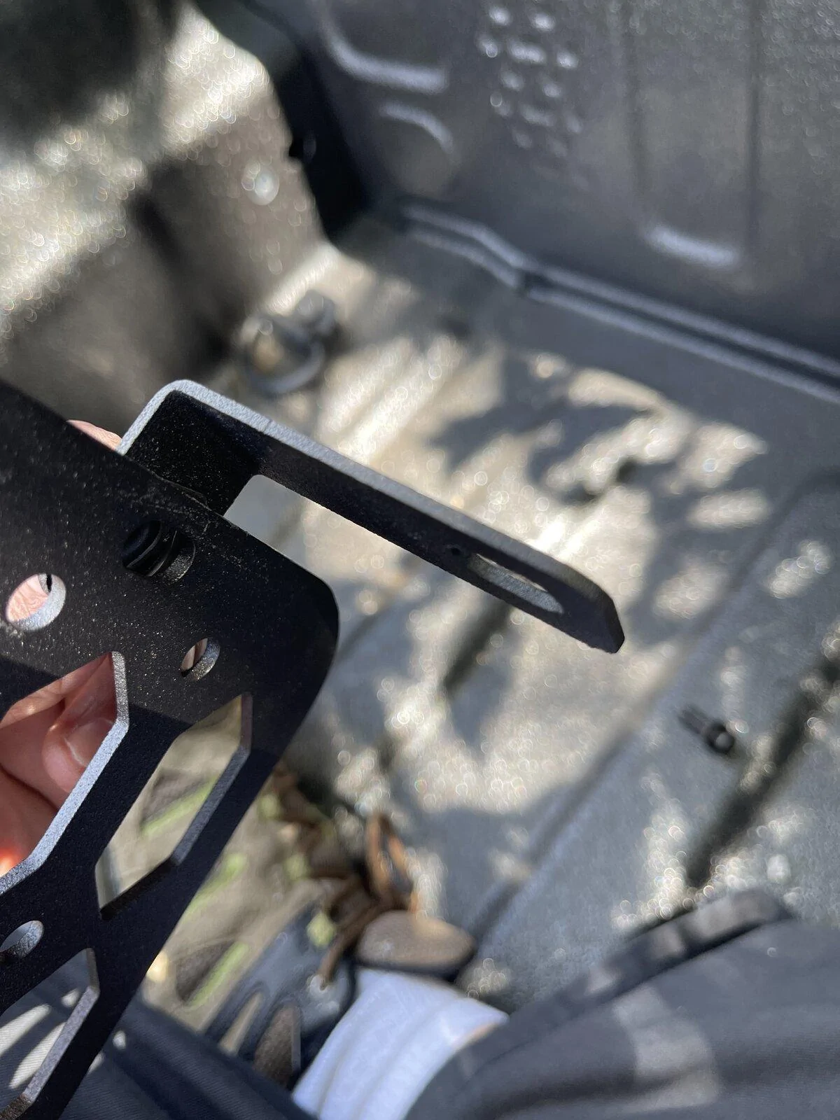

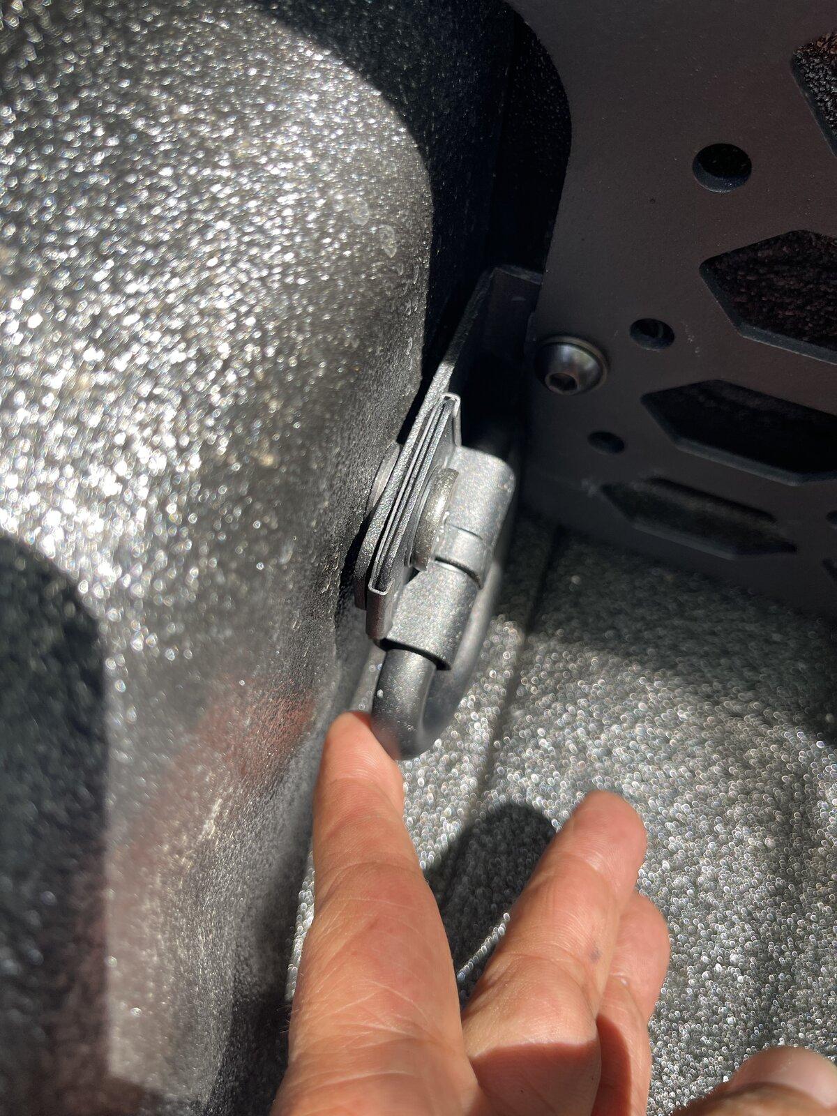

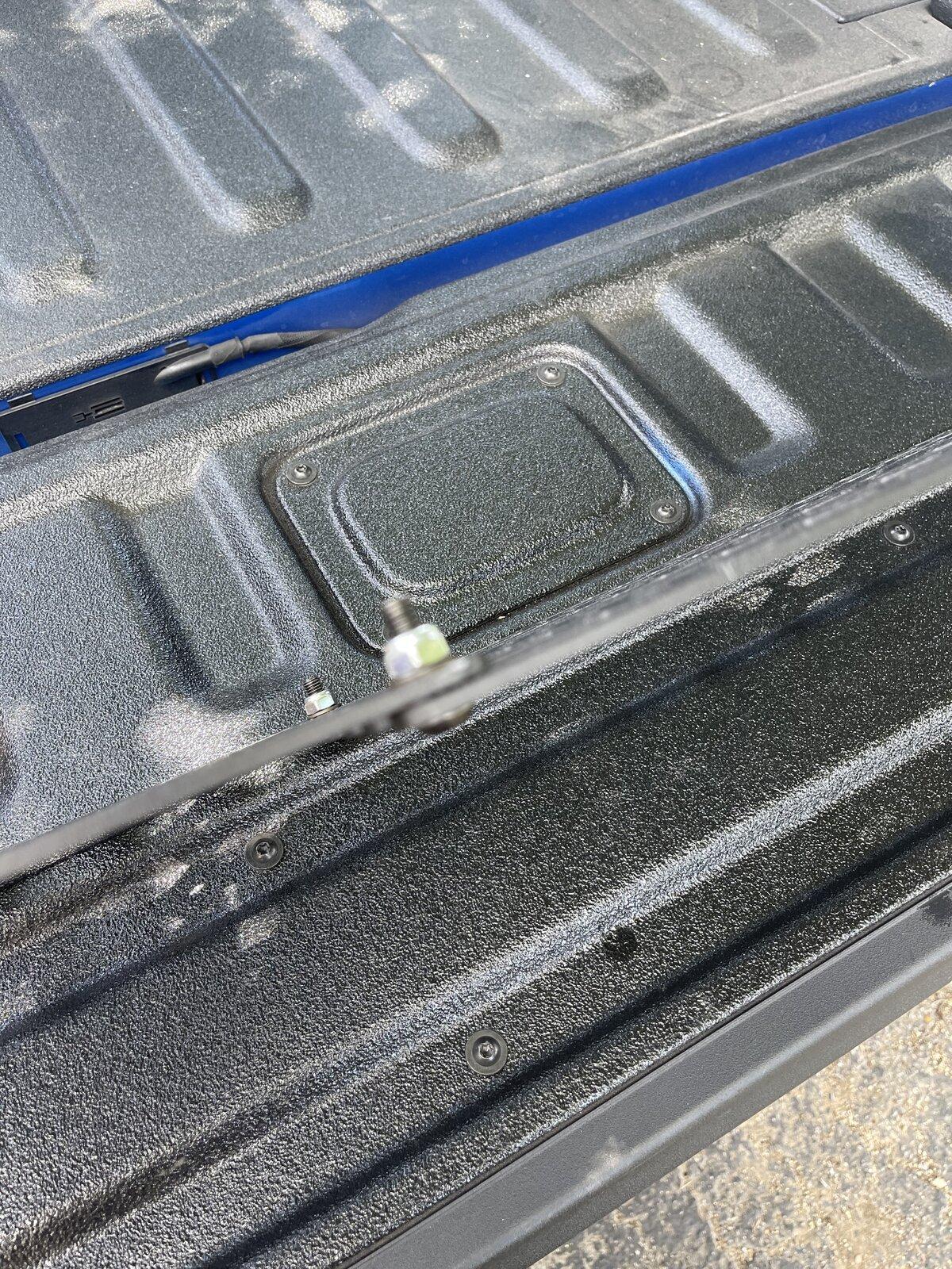

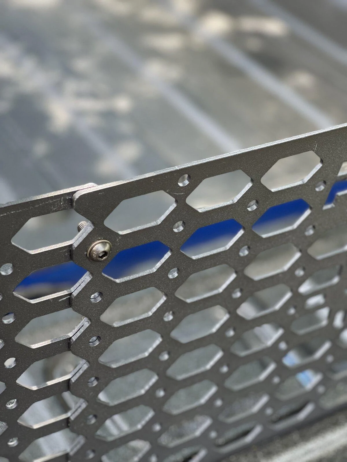

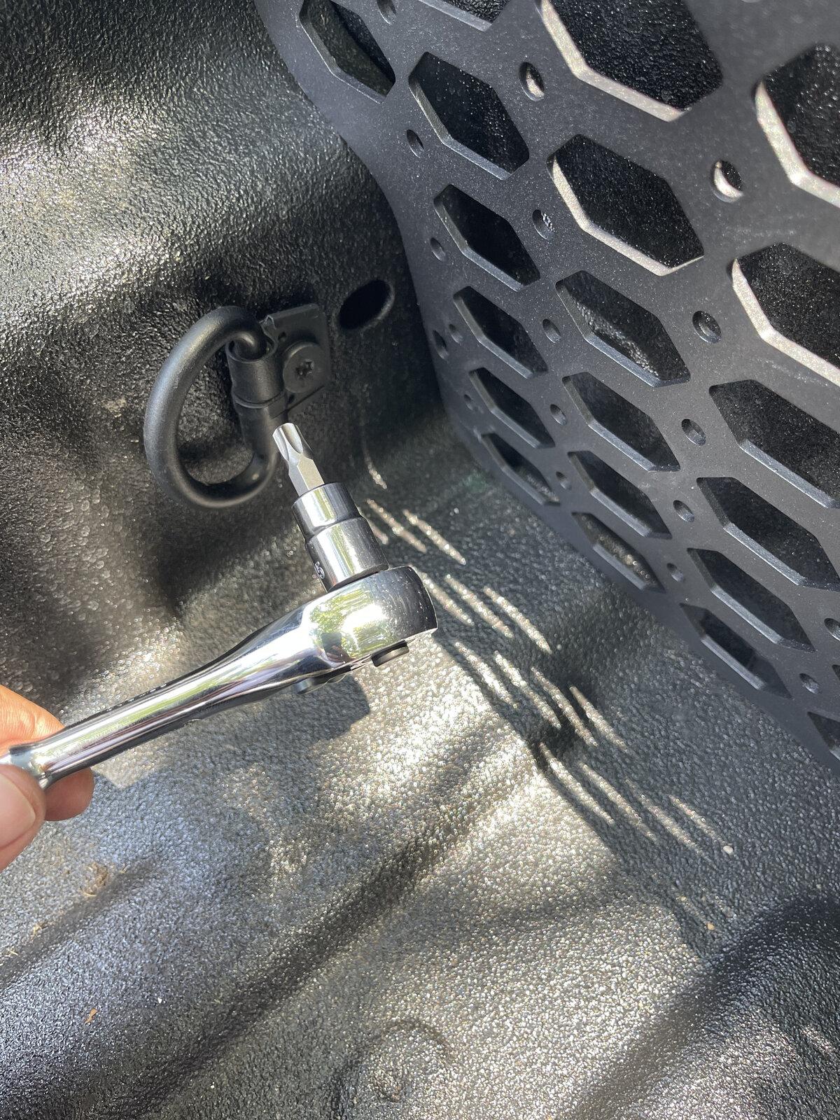

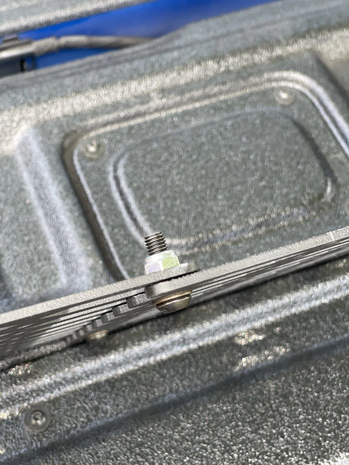

So i goofed this one under the bed light. The tie down is behind the bed wall, i had to drill through that too. Not a big deal but the nursert is for sheet metal, it didn’t seat due to the extra material.
i just used a bolt, no biggie. If you do these just make sure to orient the bracket so that it is flush and not on top of the tie down, i should have rotated it 90*.

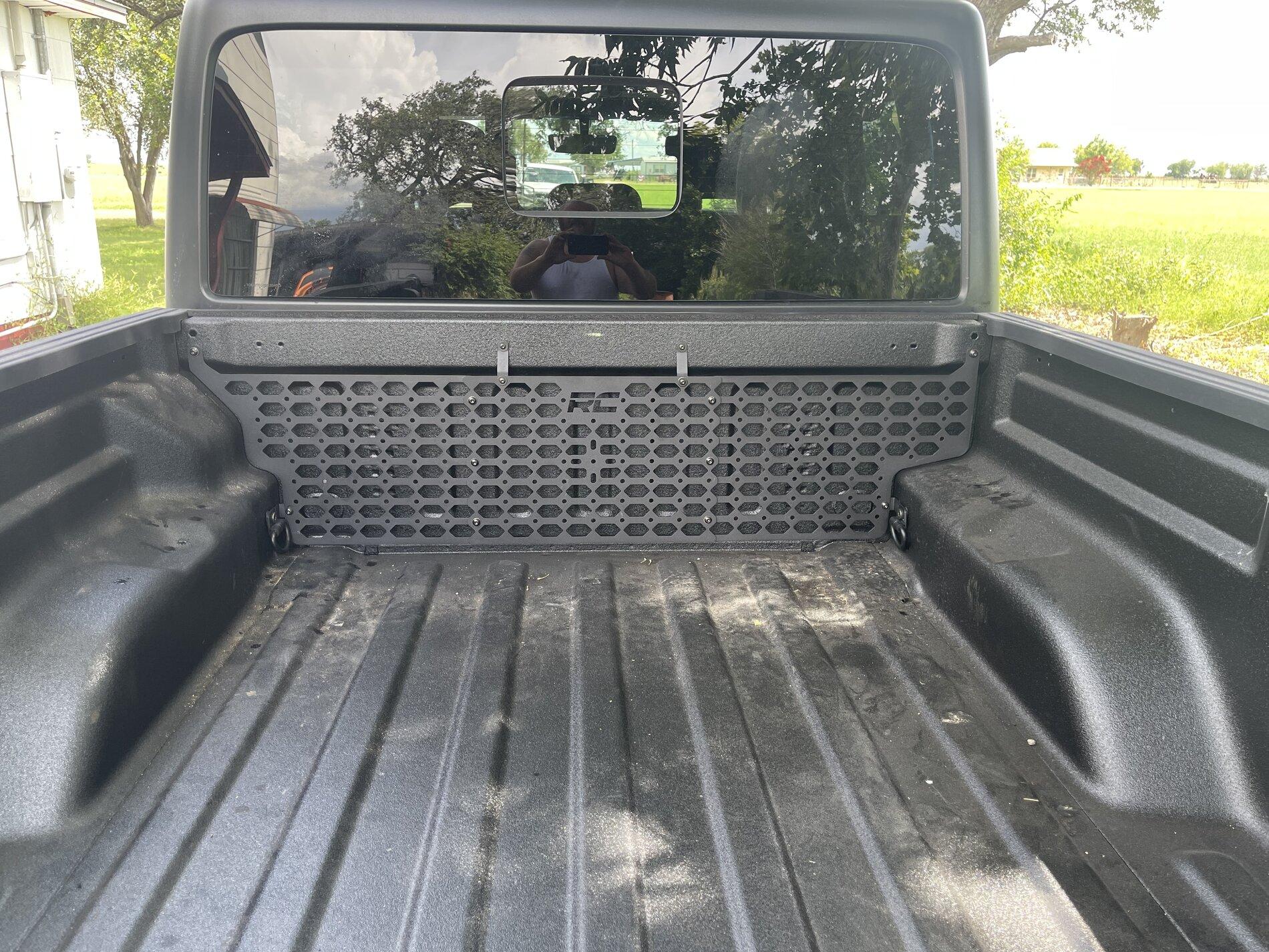

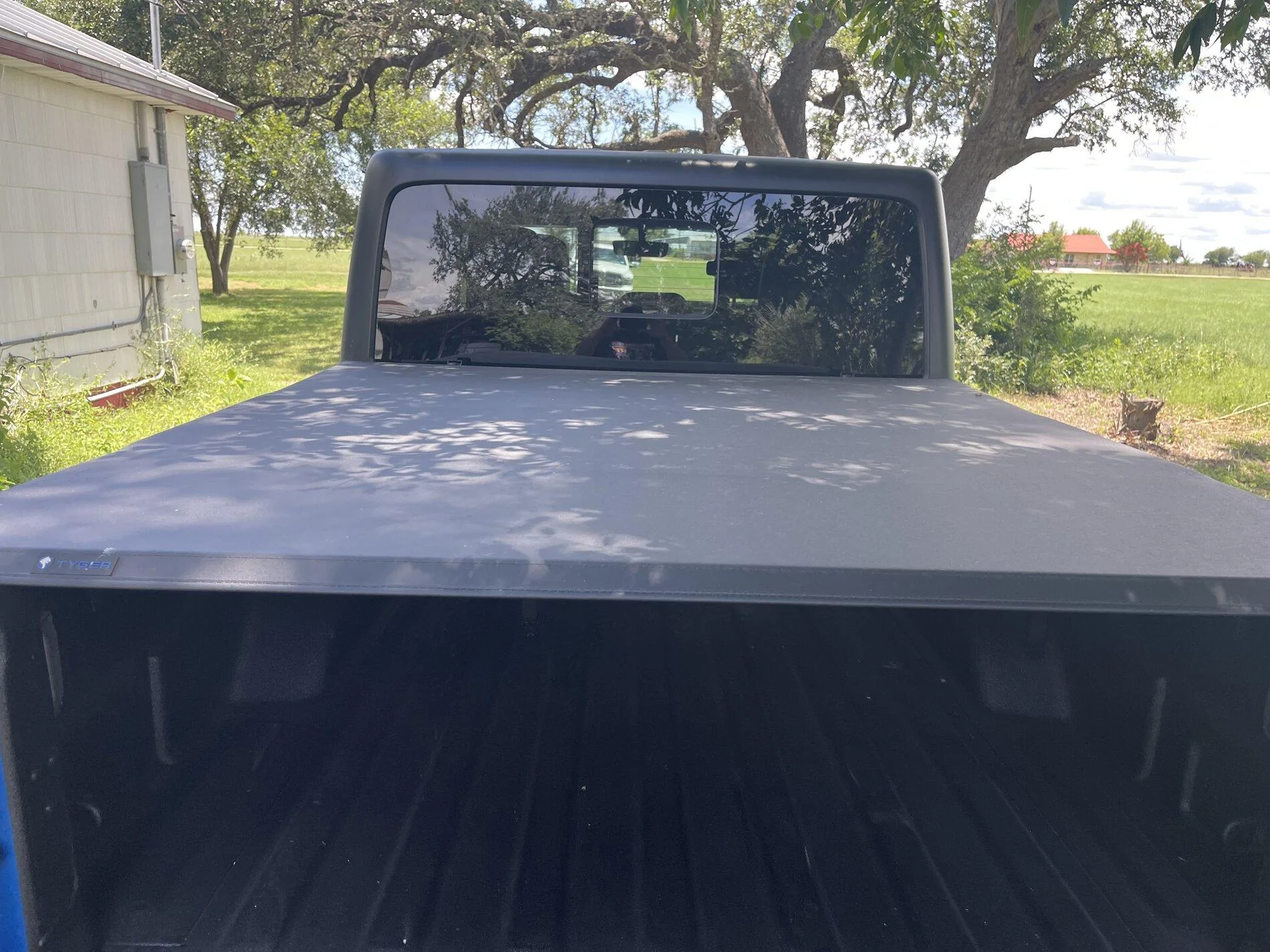

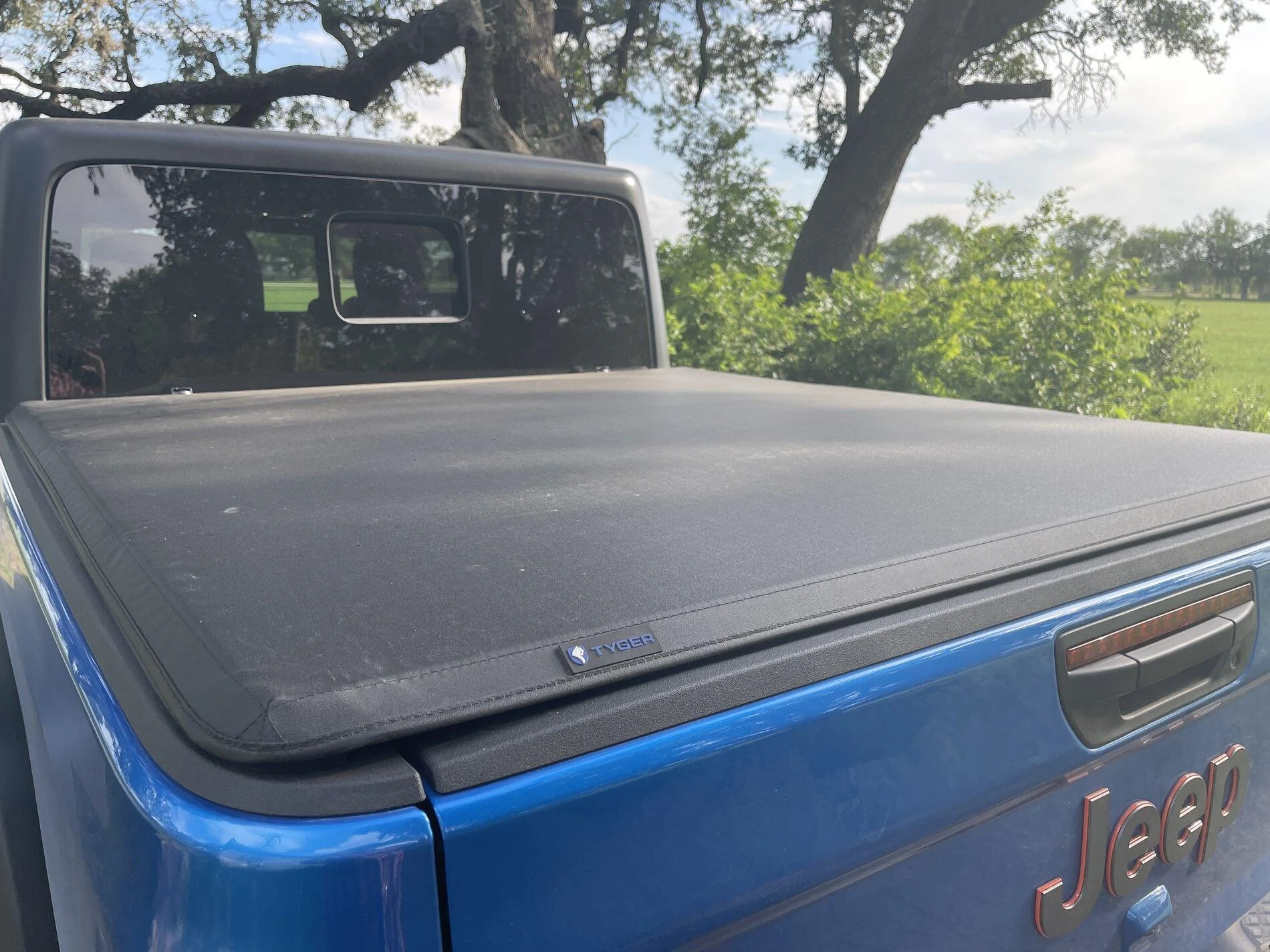

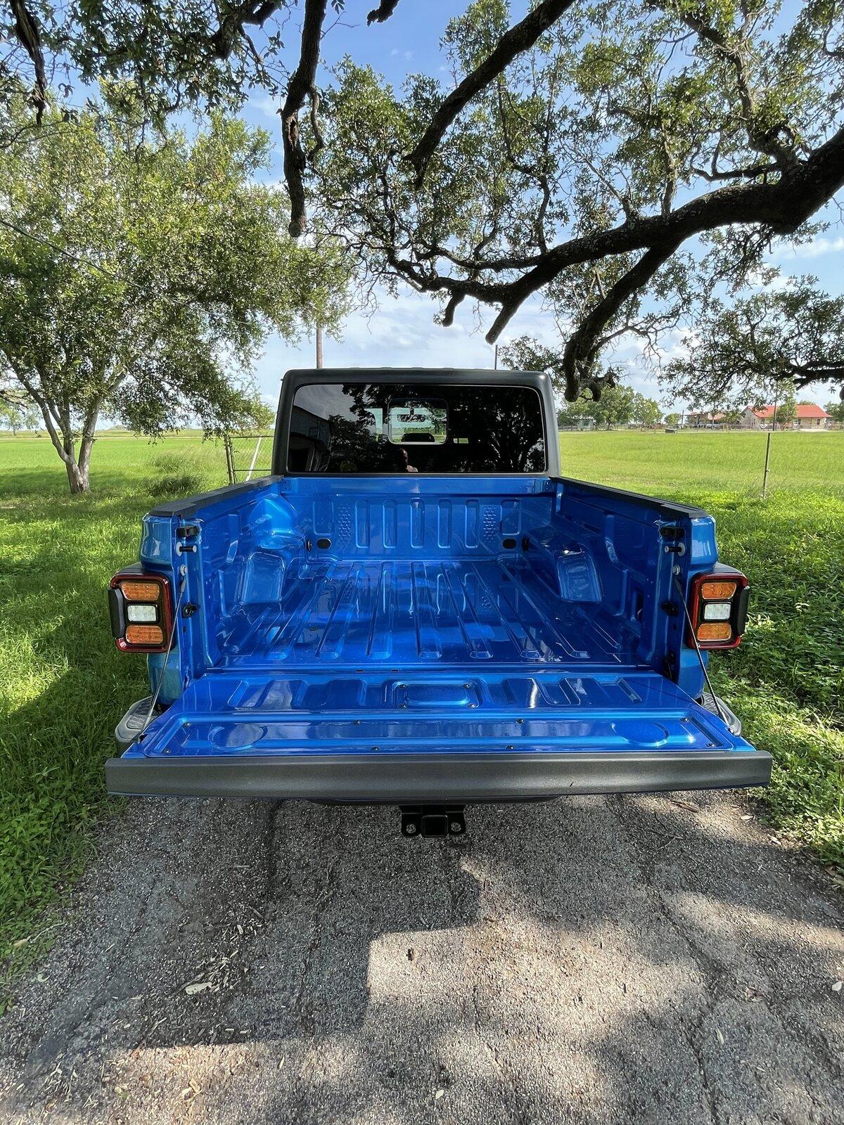

all 3 panels in. Traction boards mounted. tonneau back on. It is a Tyger tonneau, i had to trim about 1,5 inches off of the mounting levers so it could clear the molle panel.
