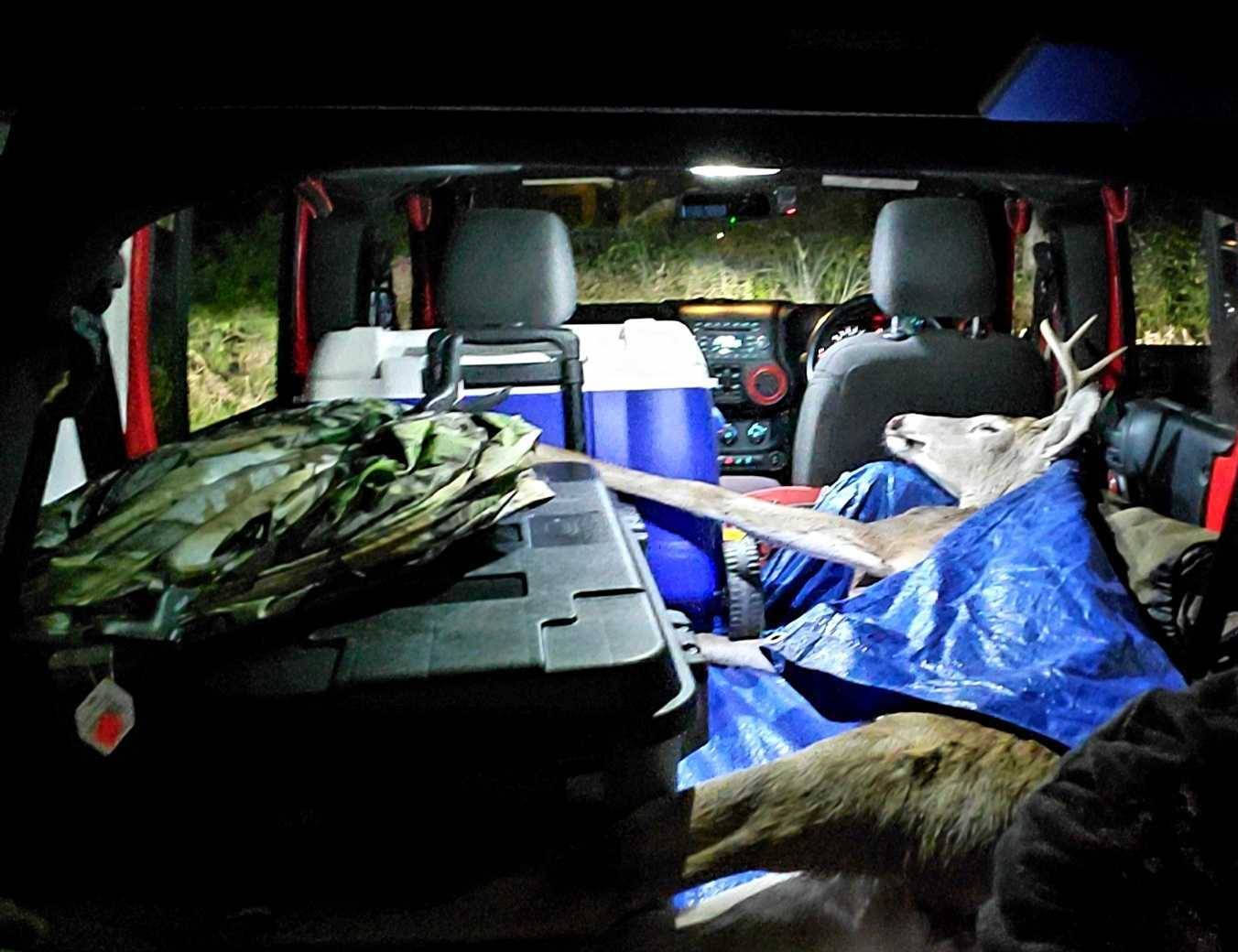

A few years and too many deer wrapped in tarps later, here we are. I ordered through Gupton and it was a pretty straightforward process. I was incredibly fortunate with my timeline, although I wasn't fully prepared to make the trip so quickly. The delayed pickup is killing me.

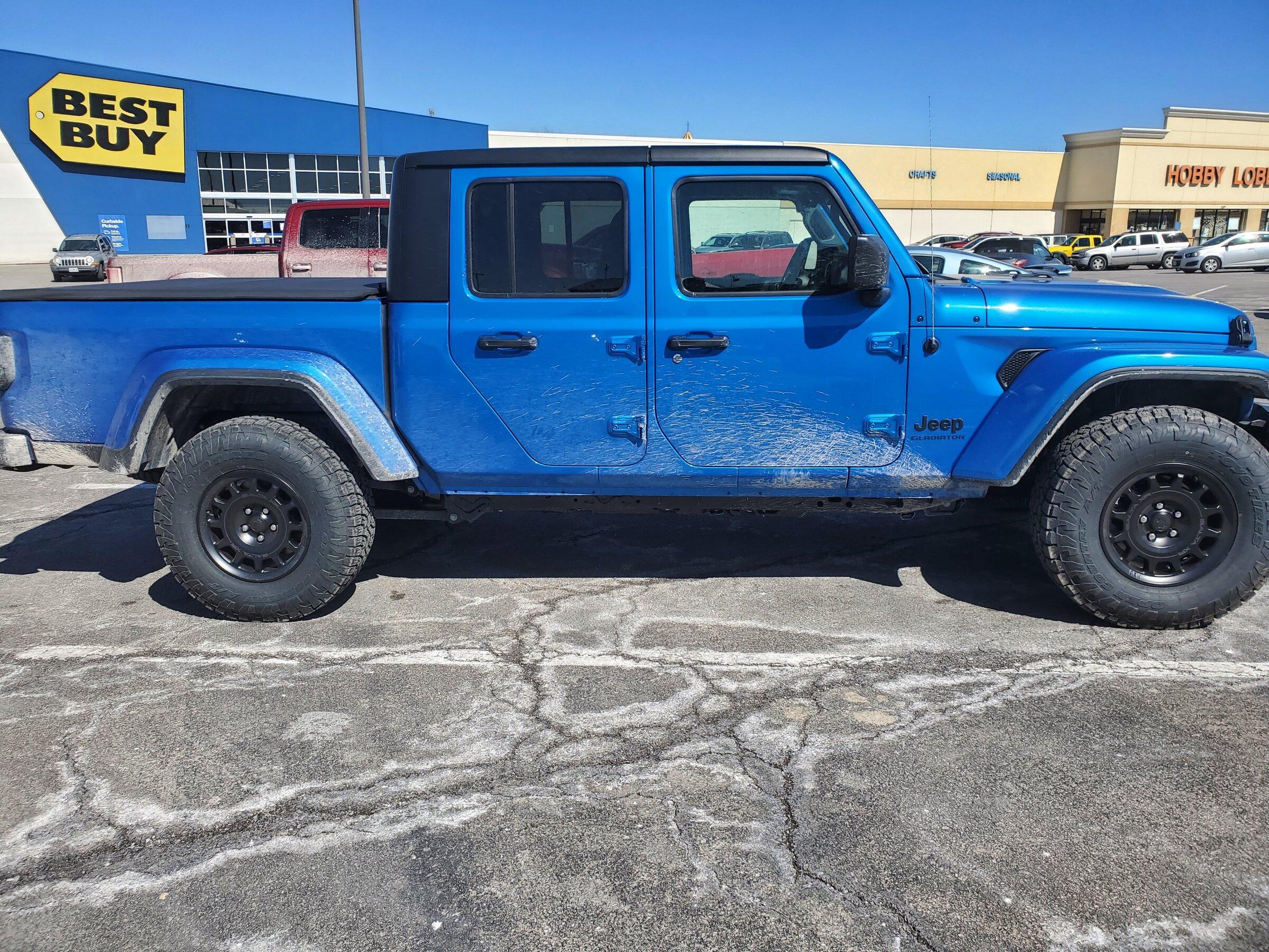

Here's the blank slate:
Jeep Gladiator Vrael's 22 Hydro Blue Sport S A80CB37E-A00C-4DCE-9DFD-80EEF6FCDFC6
And Current:
Jeep Gladiator Vrael's 22 Hydro Blue Sport S 20220909_122918

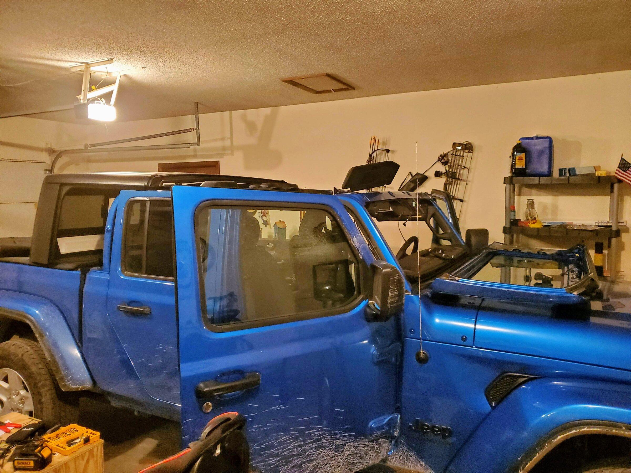

Tires came in very quickly thanks to @Discount Tire, but I had to hold off on the lift until the wheels came in. I decided on the Saltas and ordered them through Quadratec. Disappointedly hit some snags with what their site actually had in stock though and ended up canceling after a few weeks. @Northridge4x4 came in clutch though and had them shipped the same day I reached out. I prayed to the Quadratec inventory system for the TPMS sensors since they're on backorder elsewhere and they did come through.

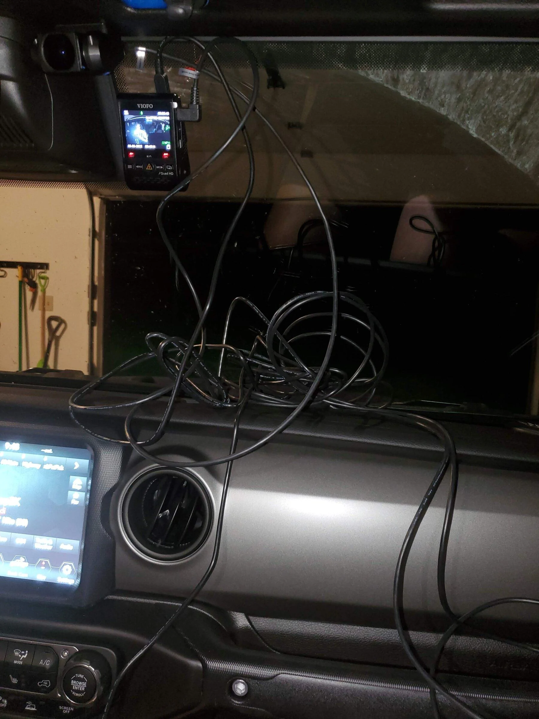

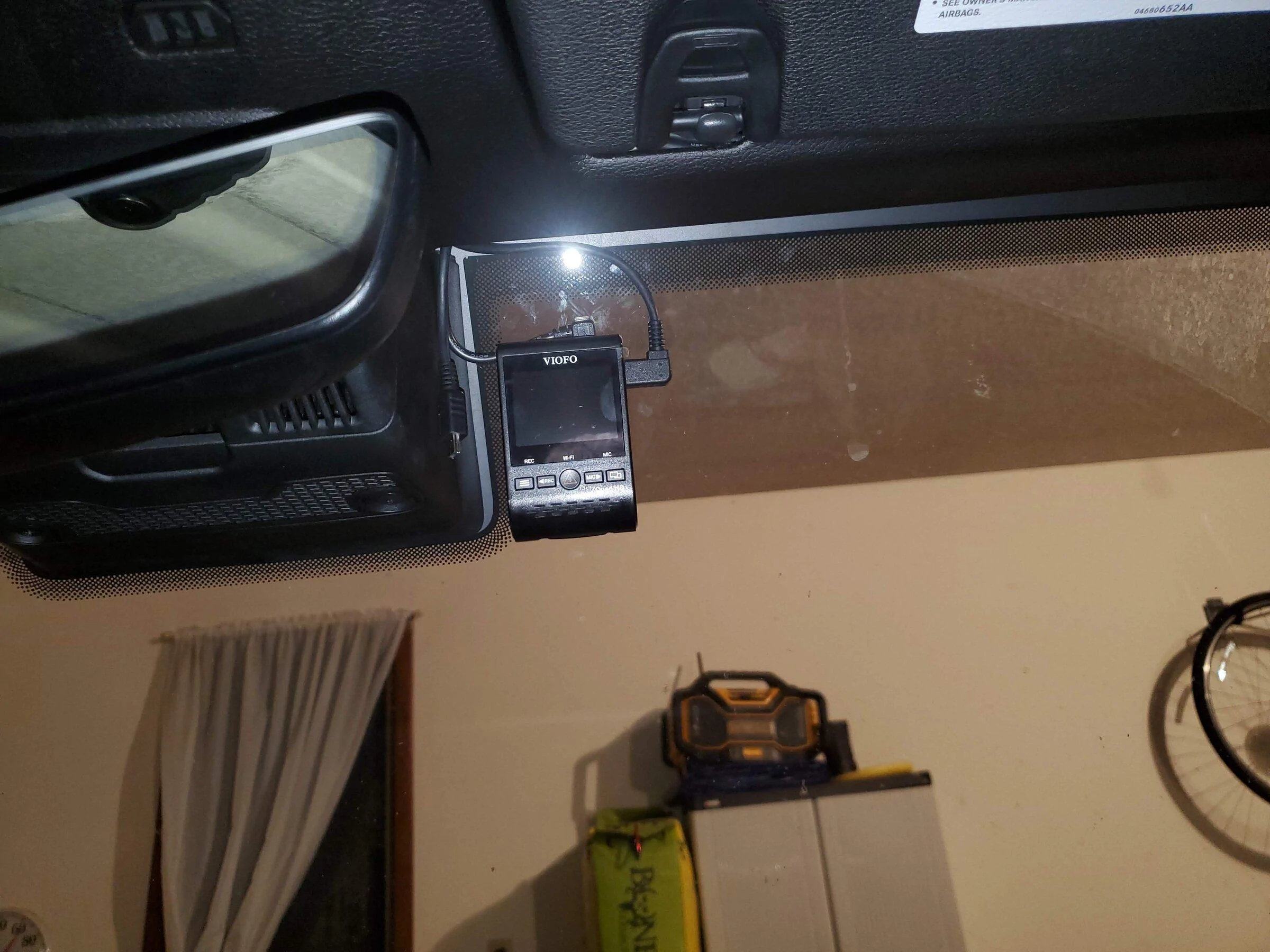

While waiting for the Saltas, my dashcam came in. I ran a previous Viofo on the JKU and after going back and forth on a few options, went with the A129 Plus Duo IR. I chose the IR because the rear camera can be affixed to the front windshield. But then I ordered the non-IR one by mistake and spent too long trying to make the rear camera work. Nailed it.
Test run for fitment and to make sure the units aren't faulty.
Jeep Gladiator Vrael's 22 Hydro Blue Sport S 20220302_214817
The non-IR rear cam also came with a 20ft cord. I should have returned it and ordered the right one, but instead decided that trying to frustratingly hide 20 ft of cord sounded like a better decision. I could have just bought a shorter cord but that would have been logical. I got really familiar with the Jeep though and removed all sorts of panels until I figured out how I wanted to run it.
Jeep Gladiator Vrael's 22 Hydro Blue Sport S 20220303_220753

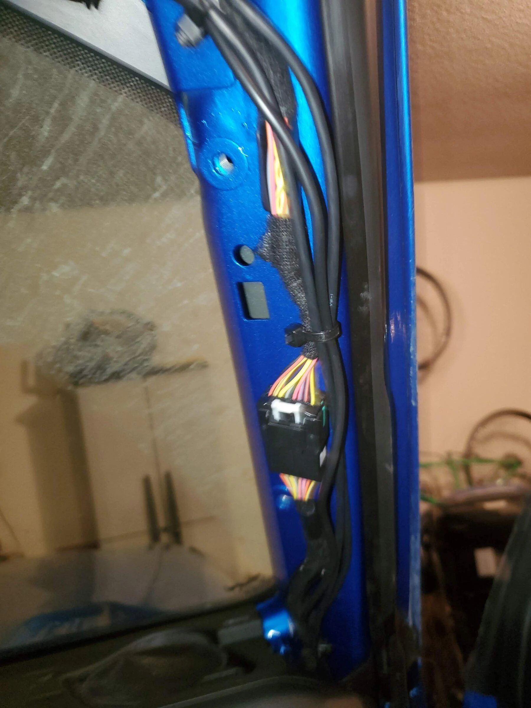

I ended up pulling it down under the dash pillar with the main camera power and then running it back up.
Jeep Gladiator Vrael's 22 Hydro Blue Sport S 20220303_232042

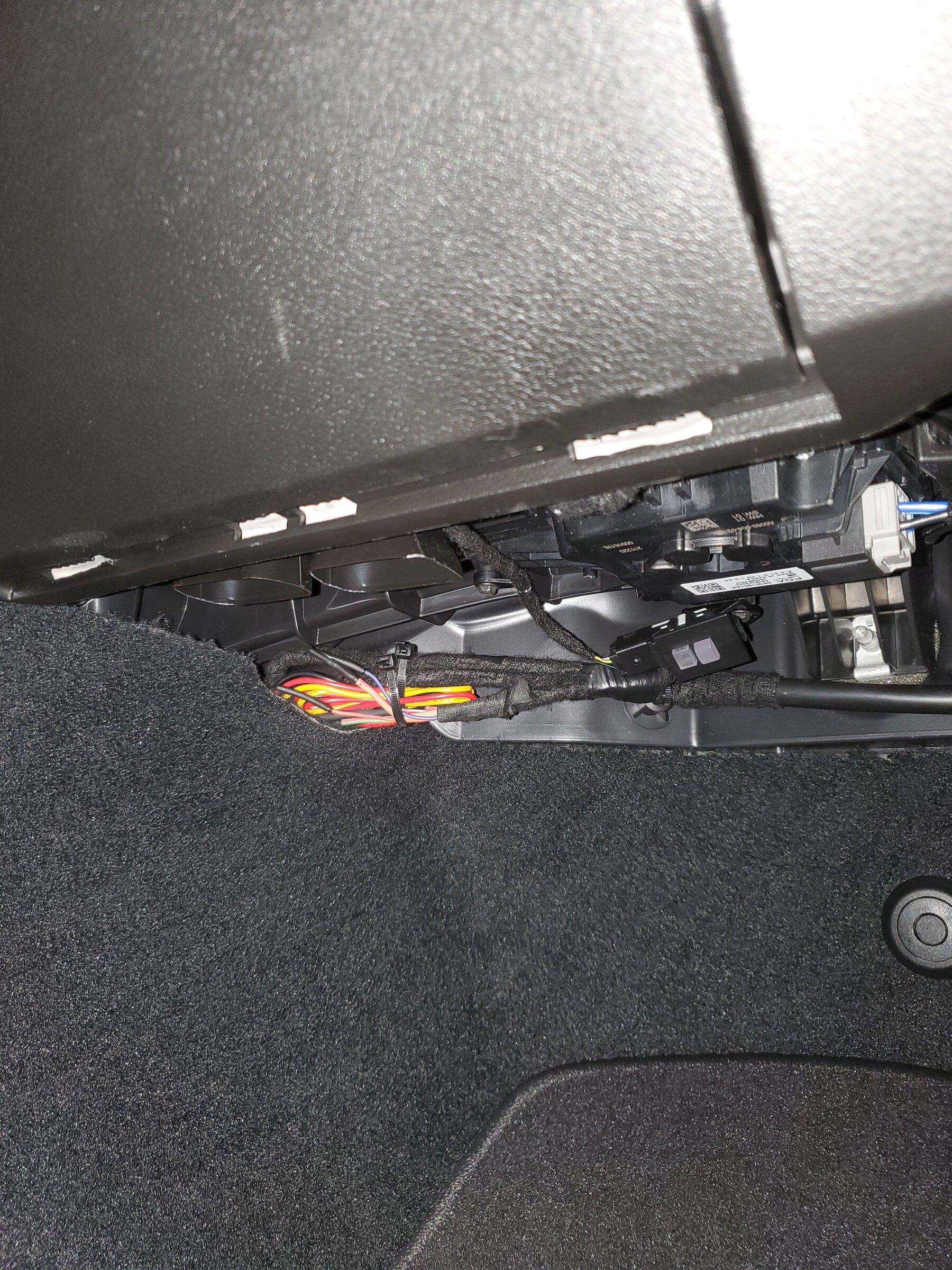

I bundled and zip-tied the 20 ft cord to the right of the passenger's right foot. I took the main power line further and fed it into the aux wires and grounded near the left foot.
Jeep Gladiator Vrael's 22 Hydro Blue Sport S 20220304_001341
I'm colorblind just enough to make things interesting, and this part was...interesting to say the least. Also, totally not an electrician, but my Jeep hasn't burned down yet so we're probably in the clear. Probably.

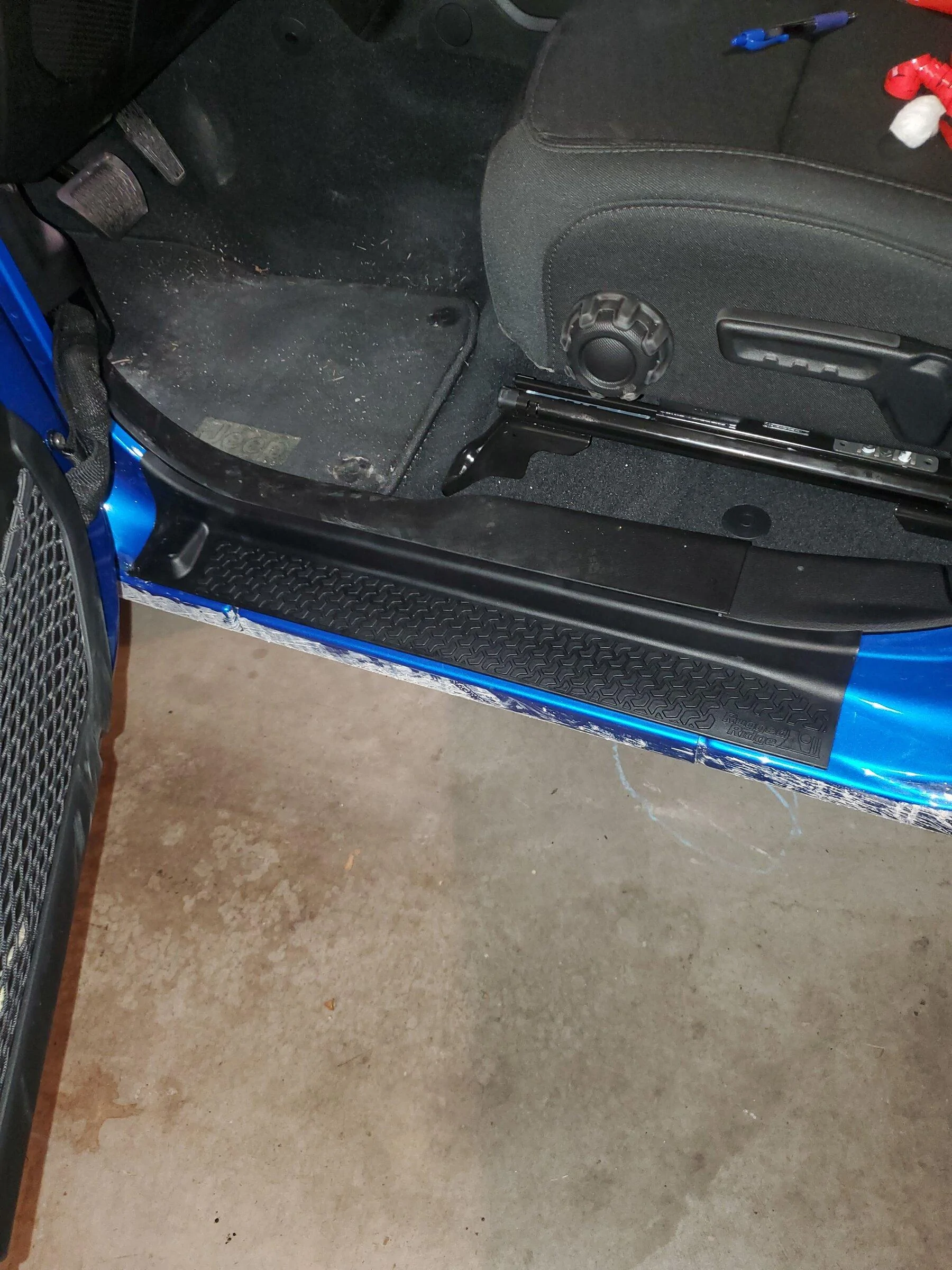

Tazer and Rugged Ridge sill protectors came in. I opted to through the easier of the two on for a quick confidence boost. I have 3w slush mats on order, but they're stuck in customs...or something.

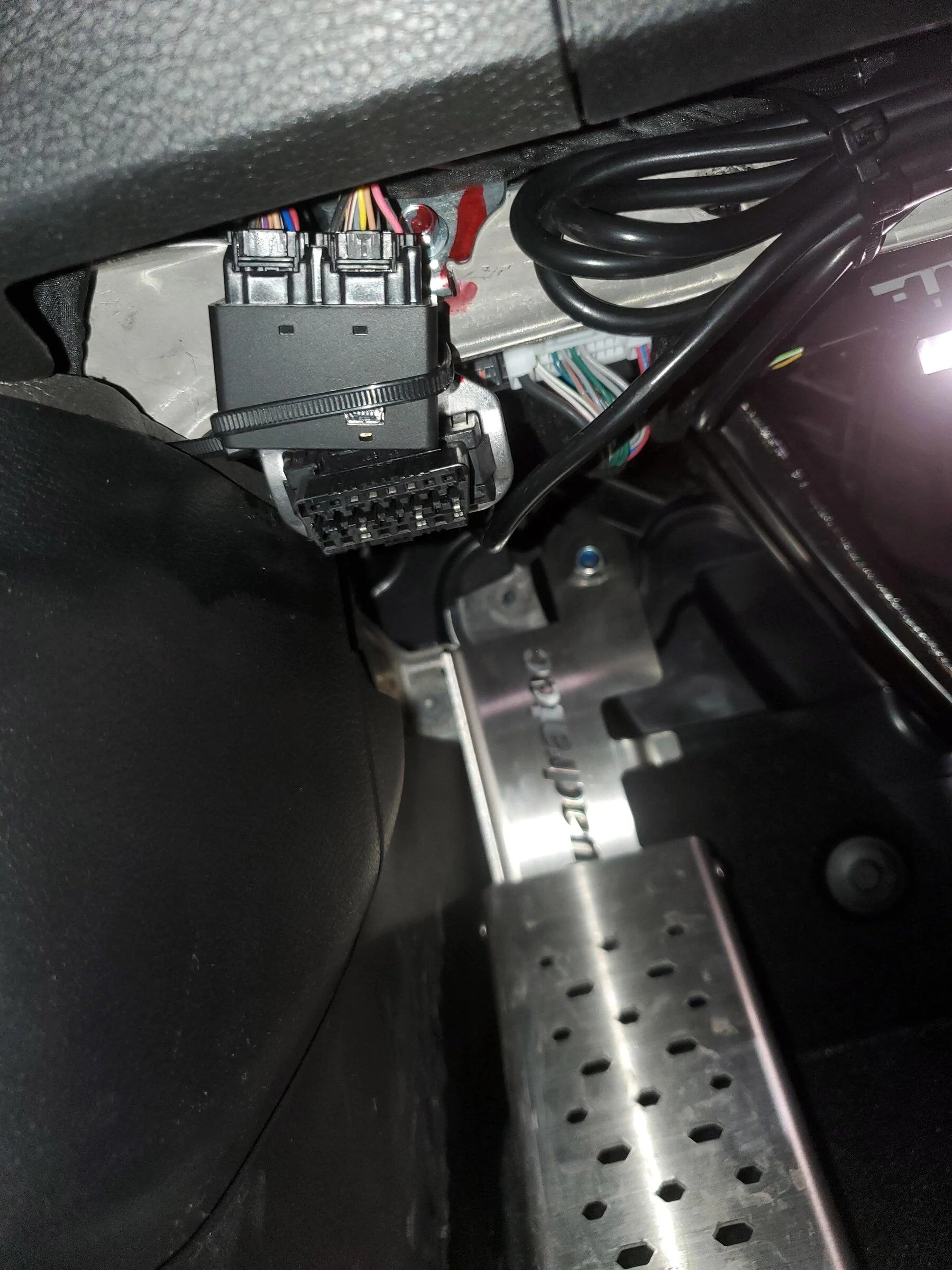

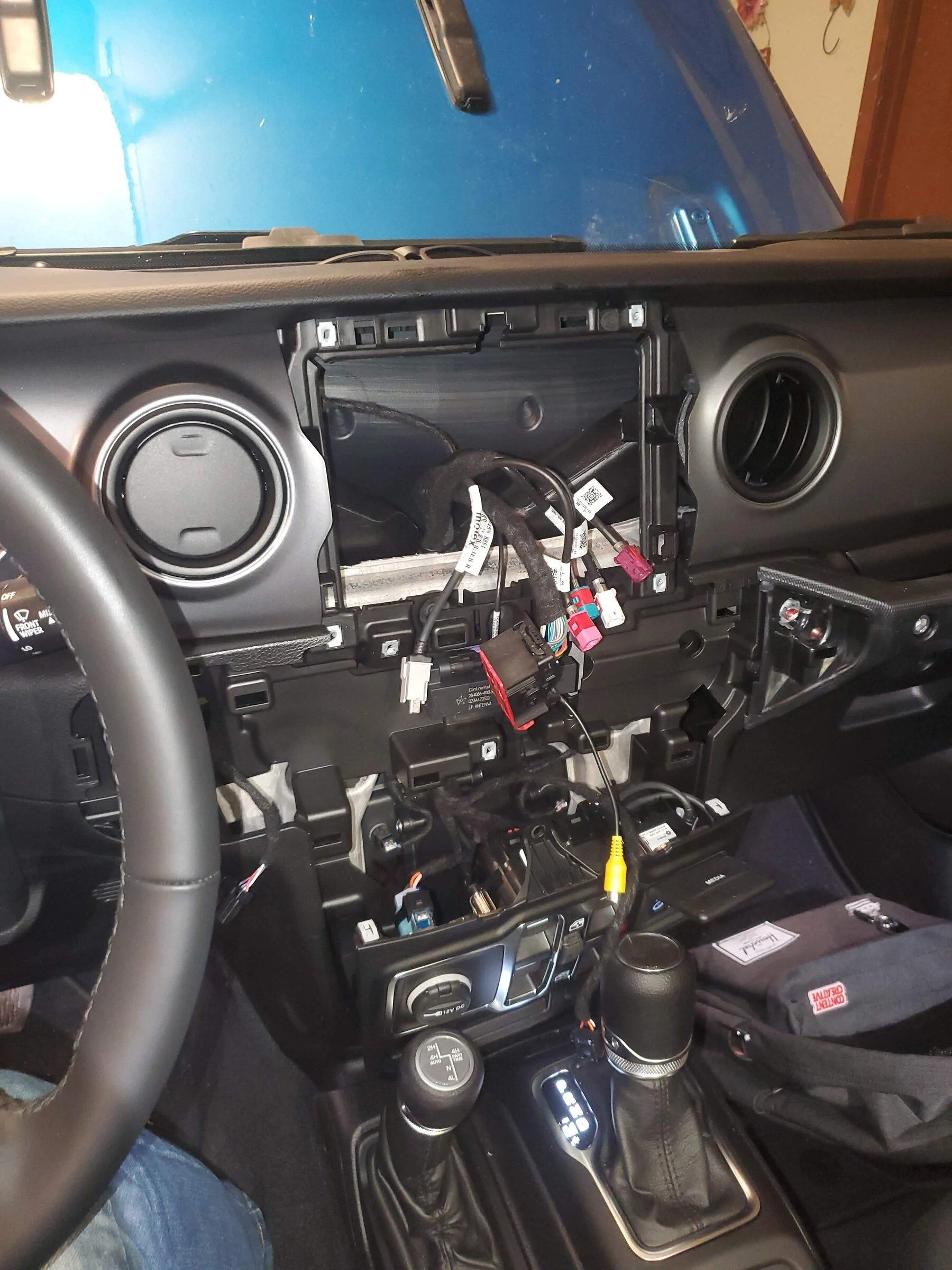

After a quick win, I jumped straight into installing the Tazer. I went back and forth between some random install videos and the .pdf on their site. Pretty doable for a novice. I threw some plastic tubing on the wires in the engine bay and tried my best to follow current wiring paths along the driver-side fender.
Jeep Gladiator Vrael's 22 Hydro Blue Sport S 20220313_204400
I pulled the center dash and only lost one clip into the unknown.
Jeep Gladiator Vrael's 22 Hydro Blue Sport S 20220304_214756
Threw it all back in and bundled it up nice and neat. I zip-tied the Tazer itself so that it's easier to access.

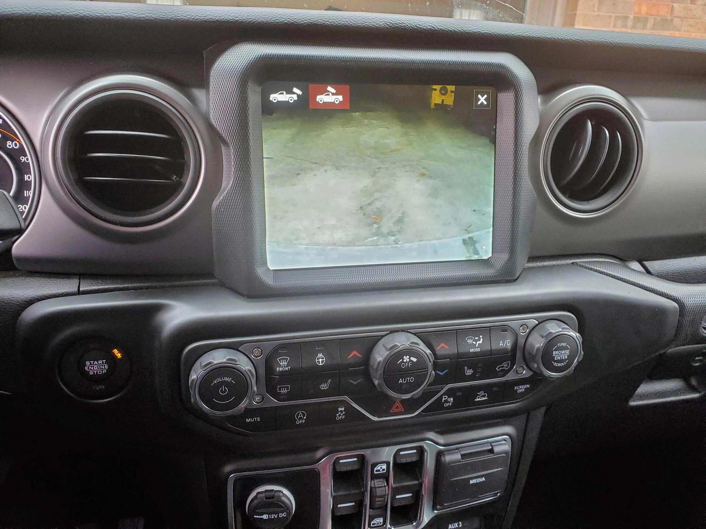

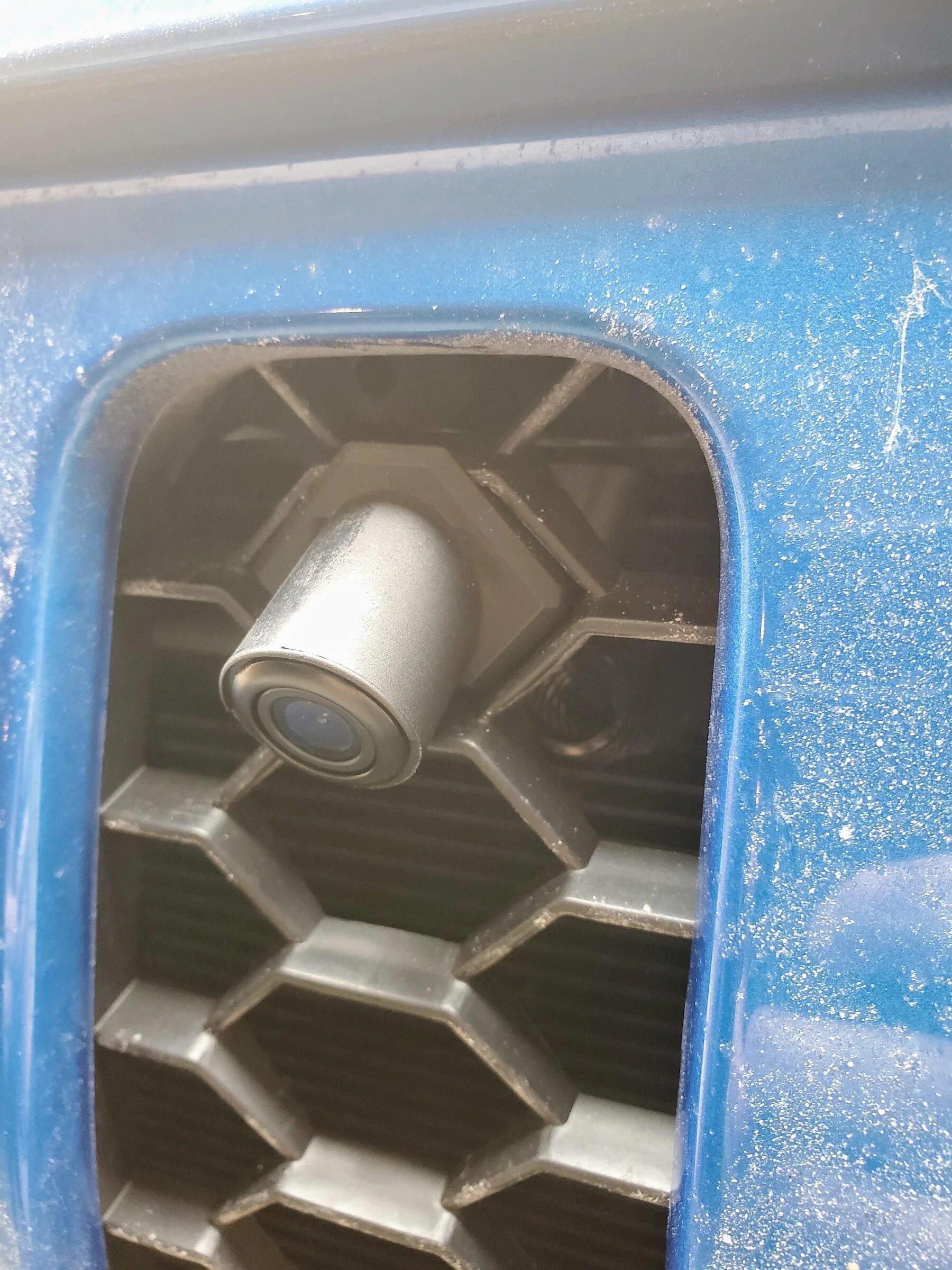

Quadratec Dead Pedal gets installed the next day but makes an appearance here. Getting the camera lined up took more work than I imagined, but it's done. I do think the JL bracket looks more OEM, but this should help get over any the bumper/winch combo when that time comes.
Jeep Gladiator Vrael's 22 Hydro Blue Sport S 20220305_092856
And... it works! Does anyone know if there is a way to change the icon though? This one drives me crazy.

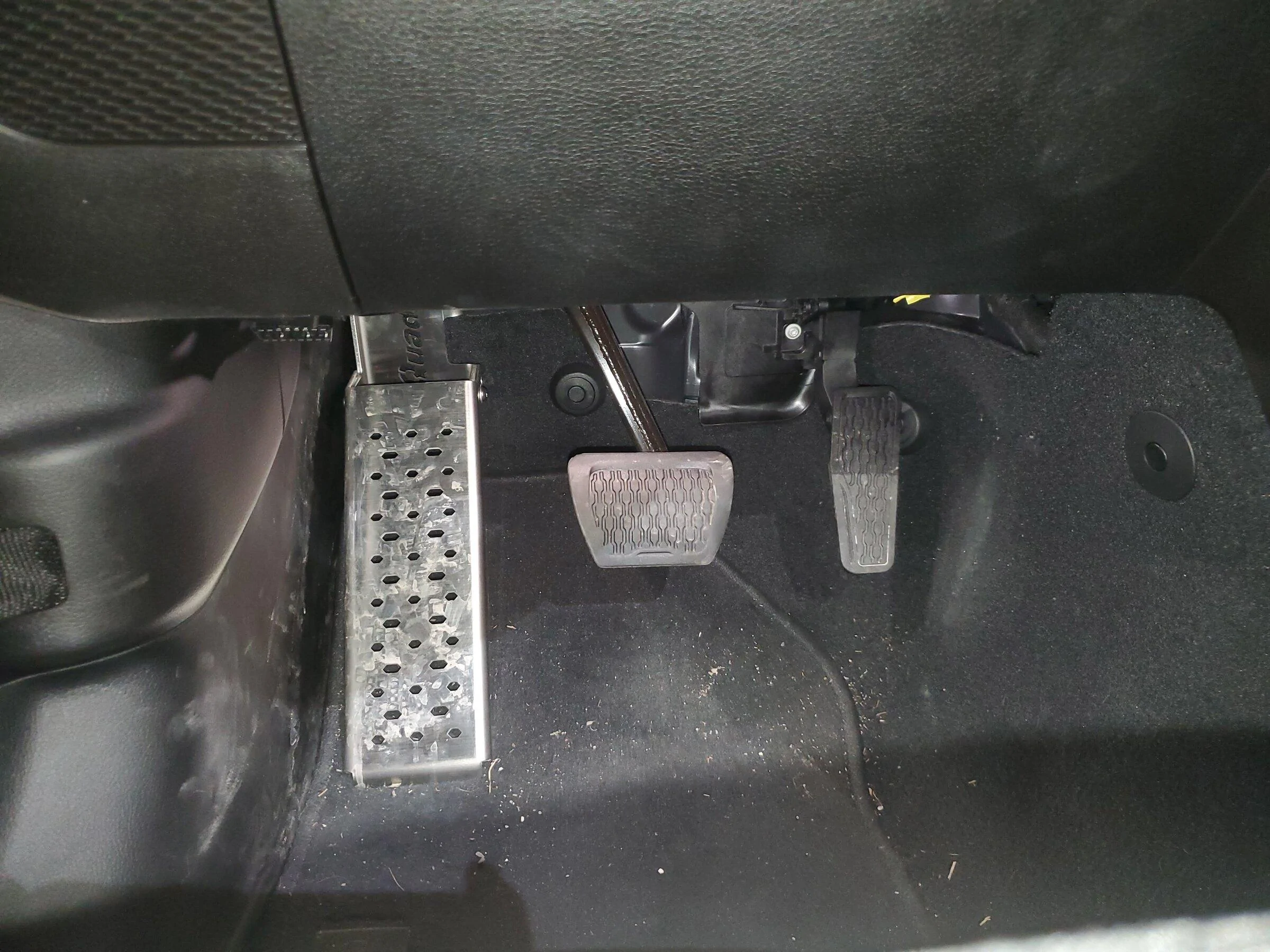

Next came the Dead pedal. Thought about it often with the JKU but never pulled the trigger. SO glad I did. Much more comfortable. I feel like the footwell here is narrower than in the JKU and my legs often feel cramped. I'm not super tall or anything. The dead pedal helps a ton with positioning. Install was super fast and easy. The rubber pad is on backorder and will ship... someday.

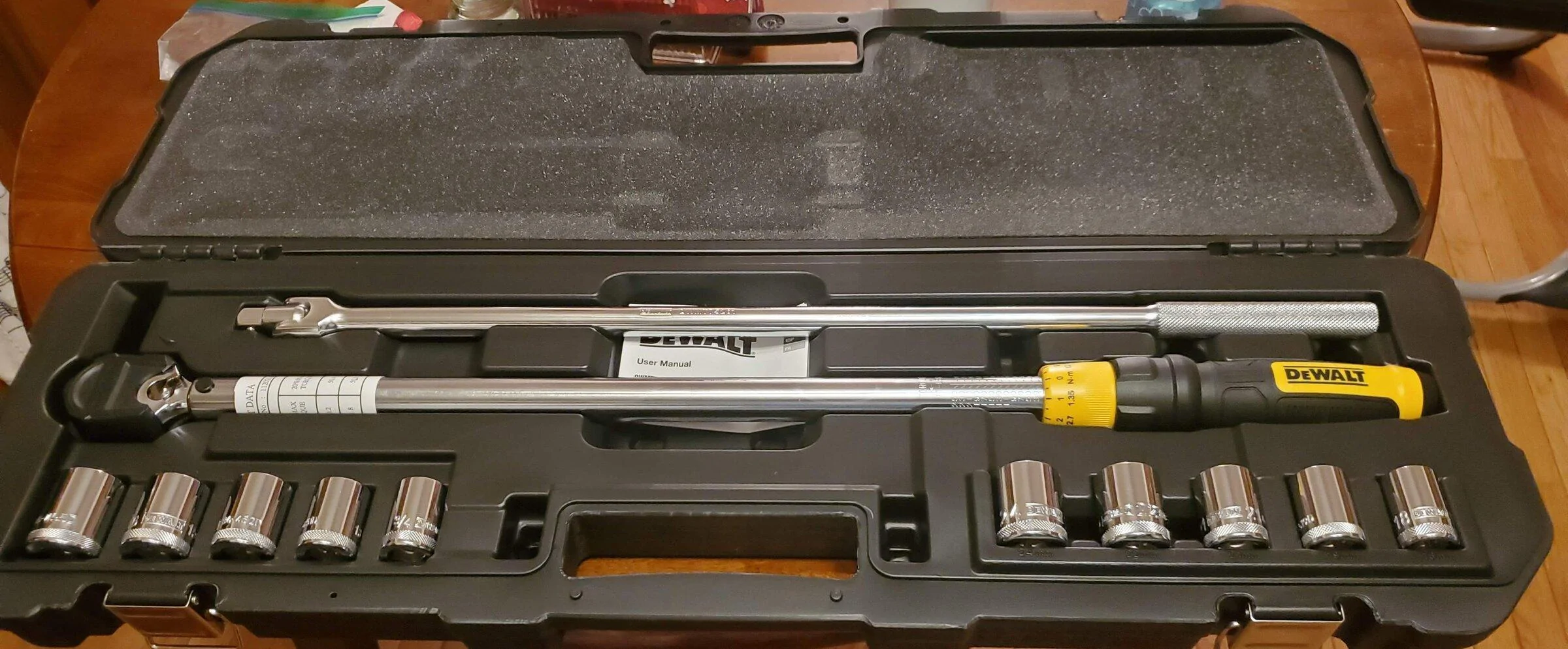

Was looking for a replacement torque wrench in line with my "Harbor Freight it until it breaks" motto. Stumbled on this sweet "tire change kit" from Dewalt. Part number DWMT45012. Had it shipped to a Tractor Supply for $100.

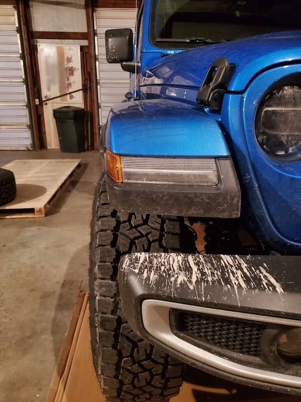

WHEELS FINALLY COME THROUGH! 285/75/17 Toyo OC III. Got them mounted and balanced at the stealership. Staff had concerns about them rubbing, but no issues. They also had trouble getting my 5th wheel in the spare location, so they just didn't. Took it home and got it to work, but I could see how trying for 30 seconds would not result in success.
Jeep Gladiator Vrael's 22 Hydro Blue Sport S 20220312_182322
The Salta XRs are perfect. Tires line up almost exactly with the max tow fender extensions.

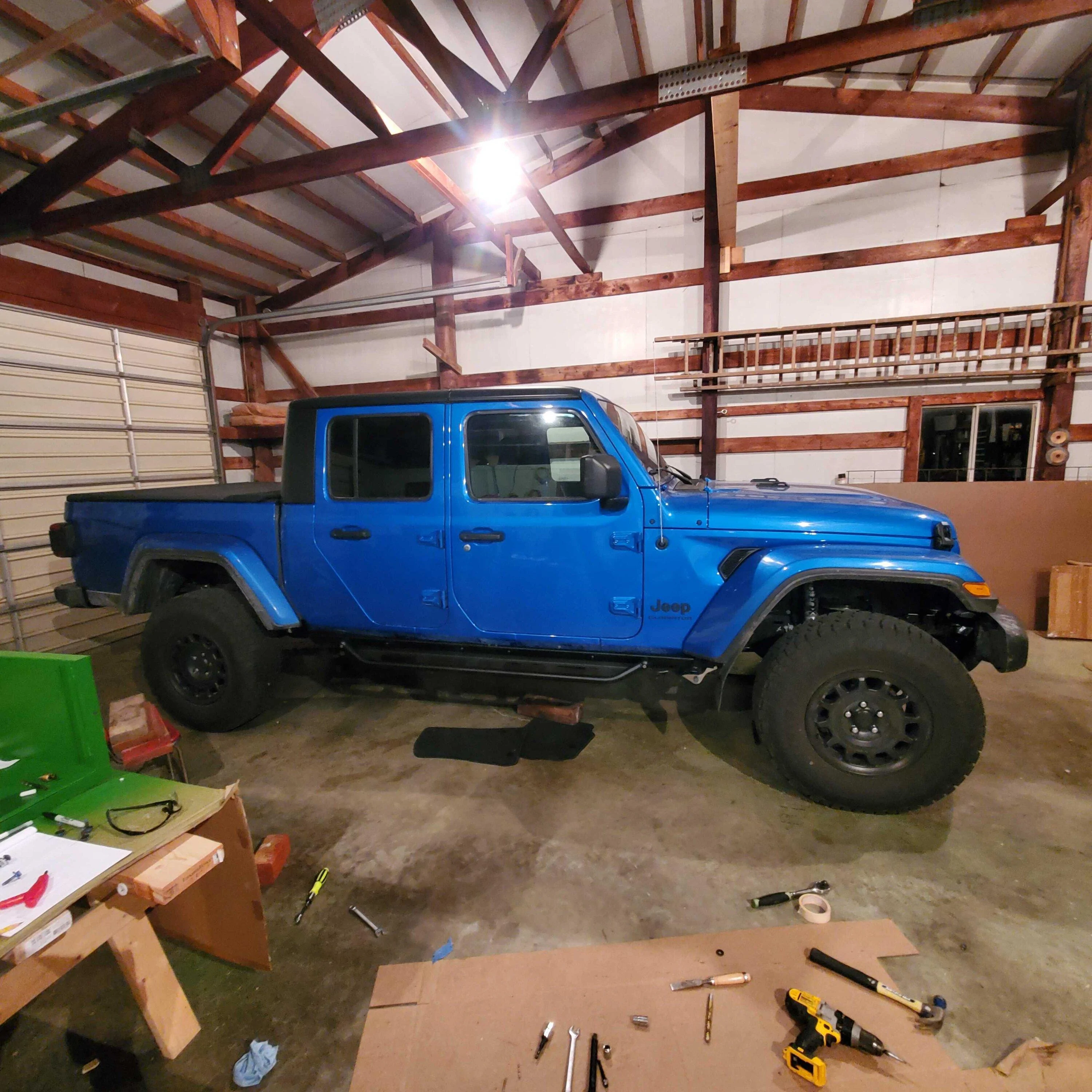

Whoops, that was a lie. Better late than never.

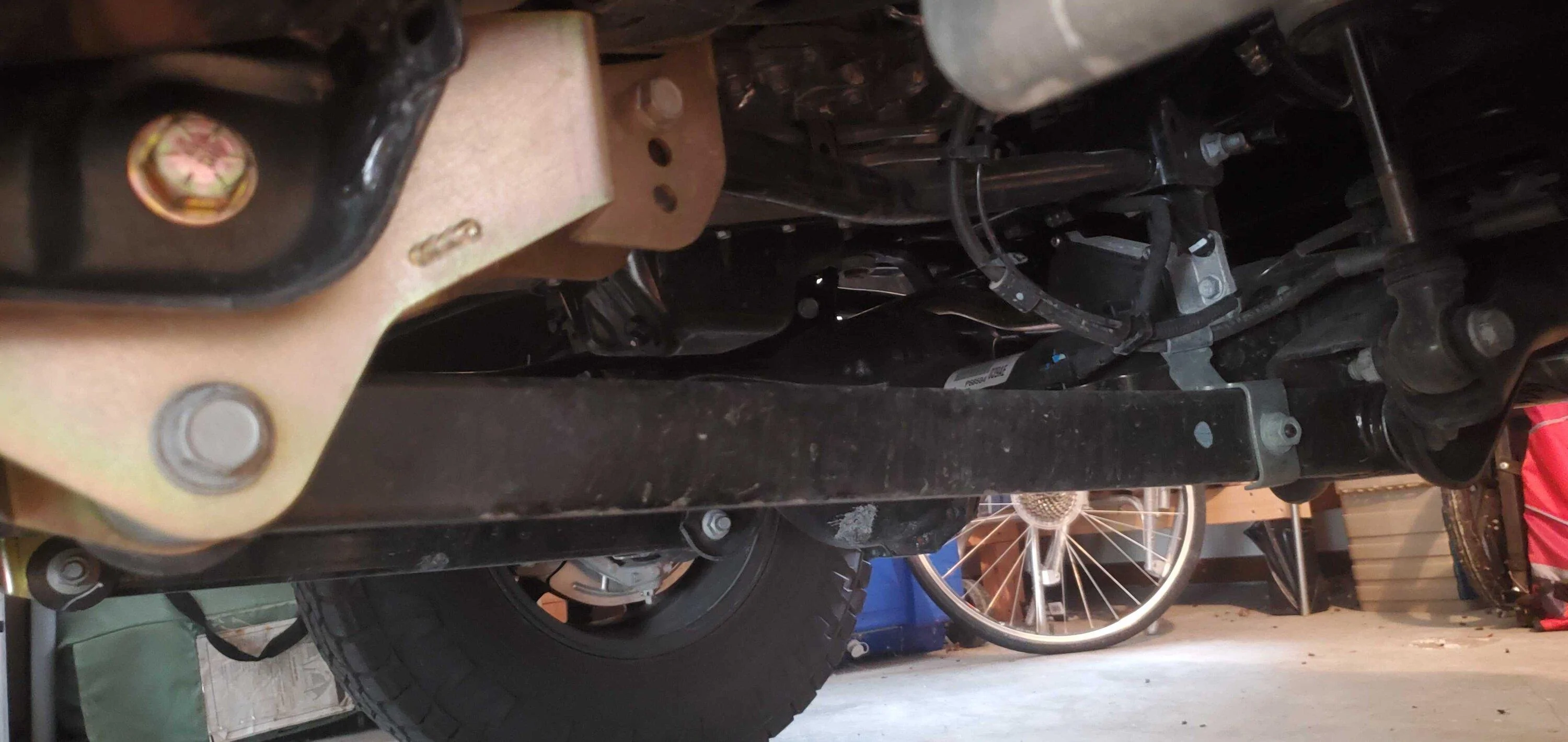

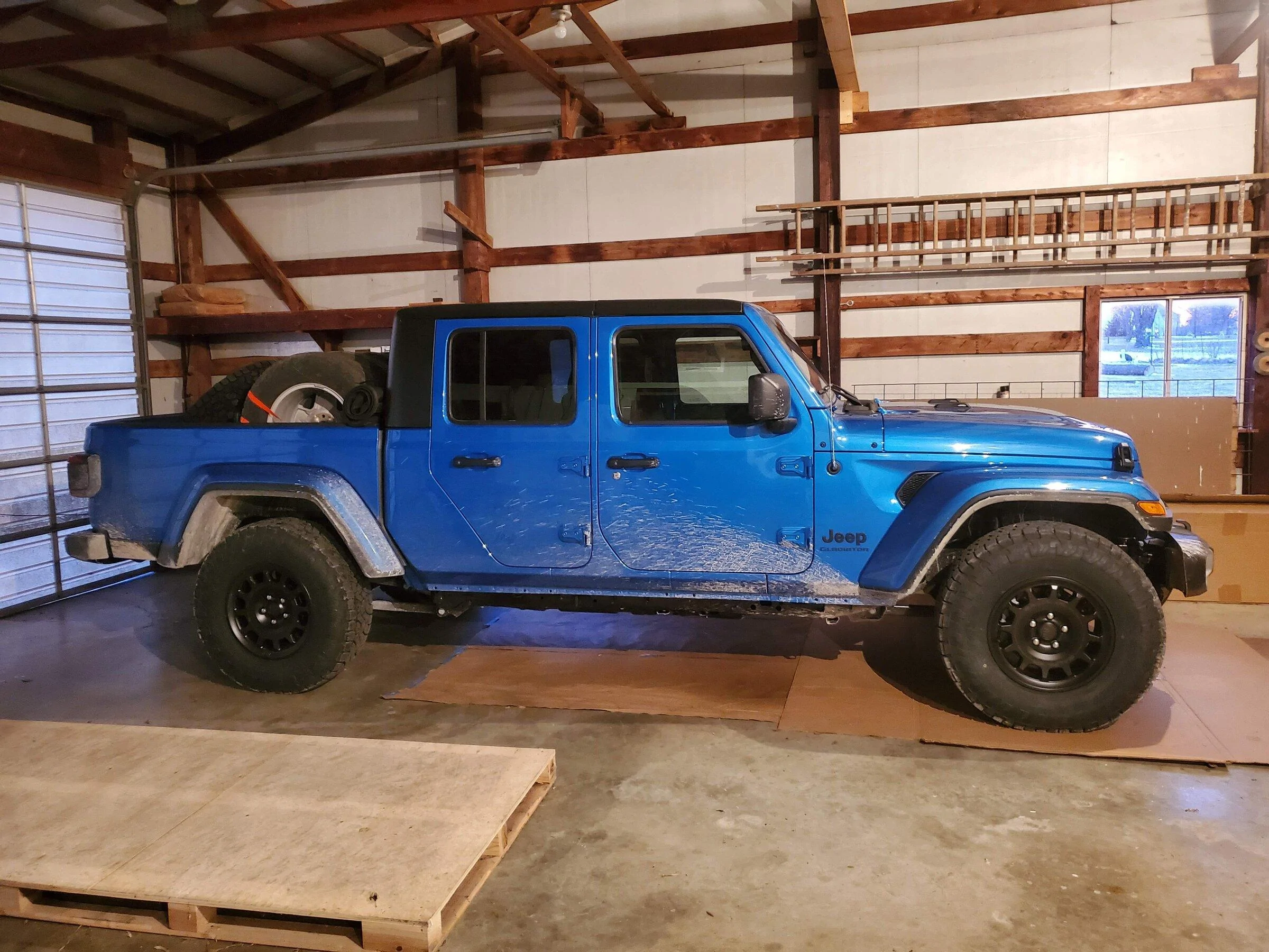

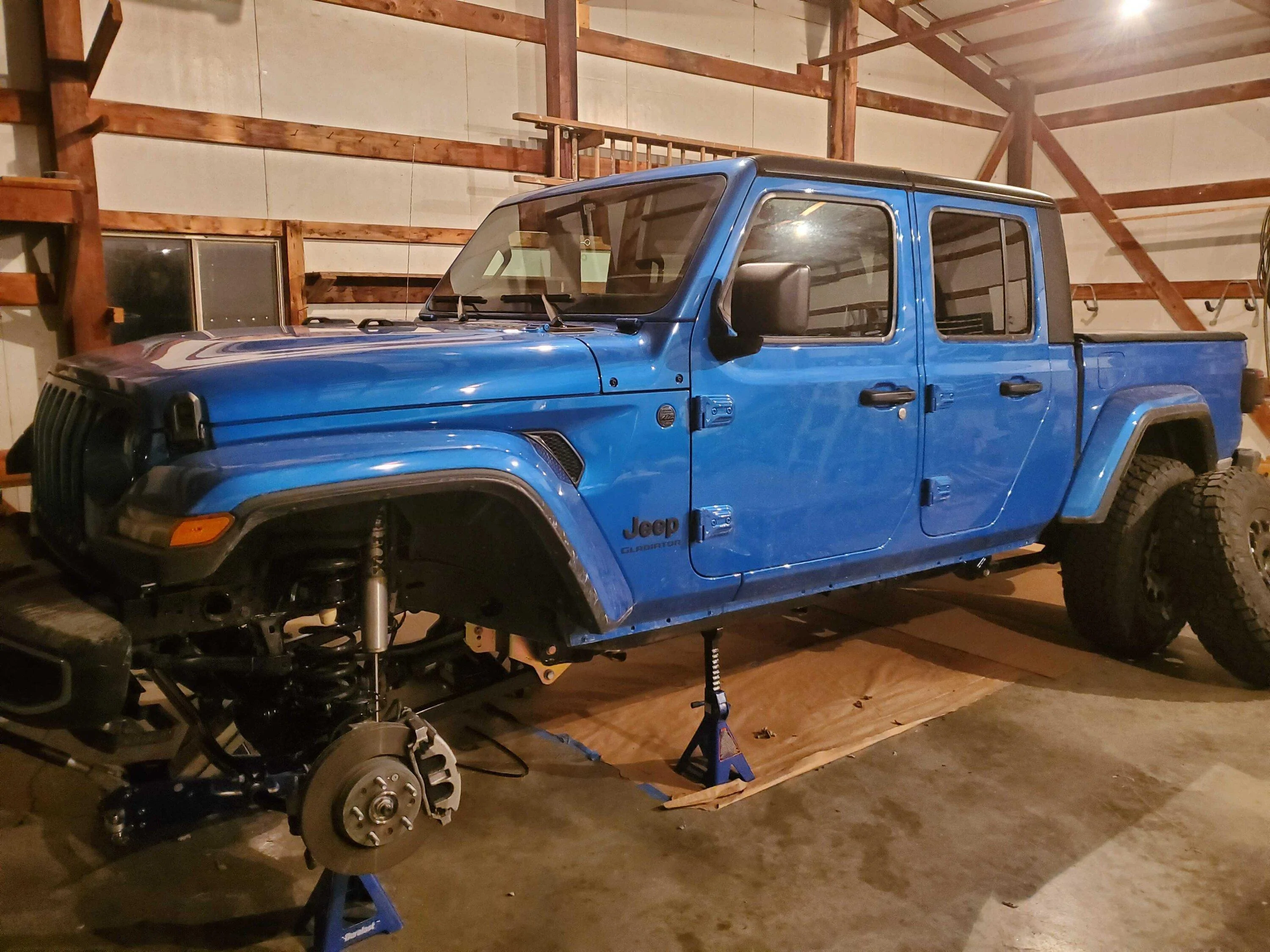

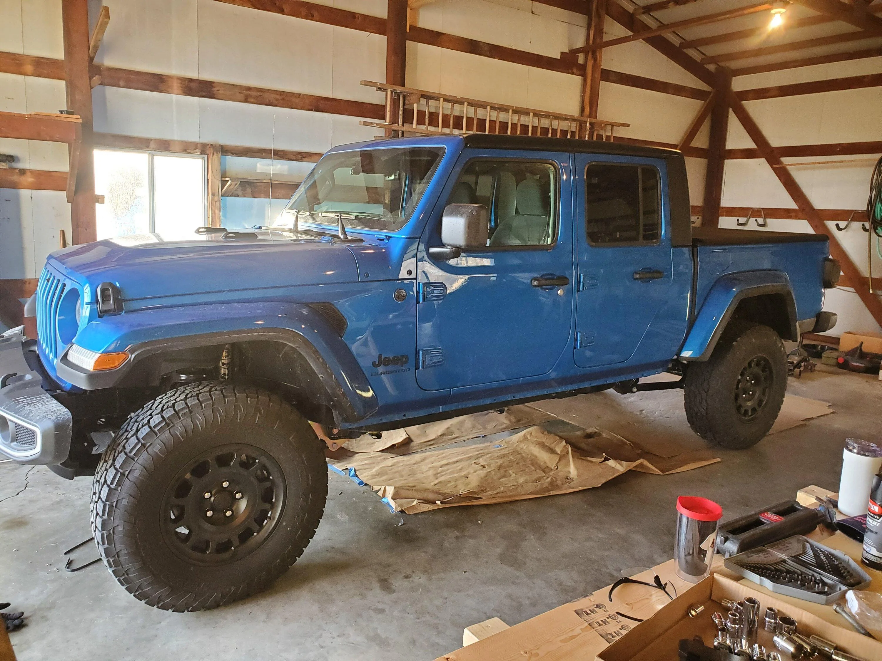

MOPAR lift + new front trackbar was relatively easy to put on. The only thing that really gave me an issue was the sway bar links.
Jeep Gladiator Vrael's 22 Hydro Blue Sport S 20220319_202455
Good to go.
Jeep Gladiator Vrael's 22 Hydro Blue Sport S 20220320_182157

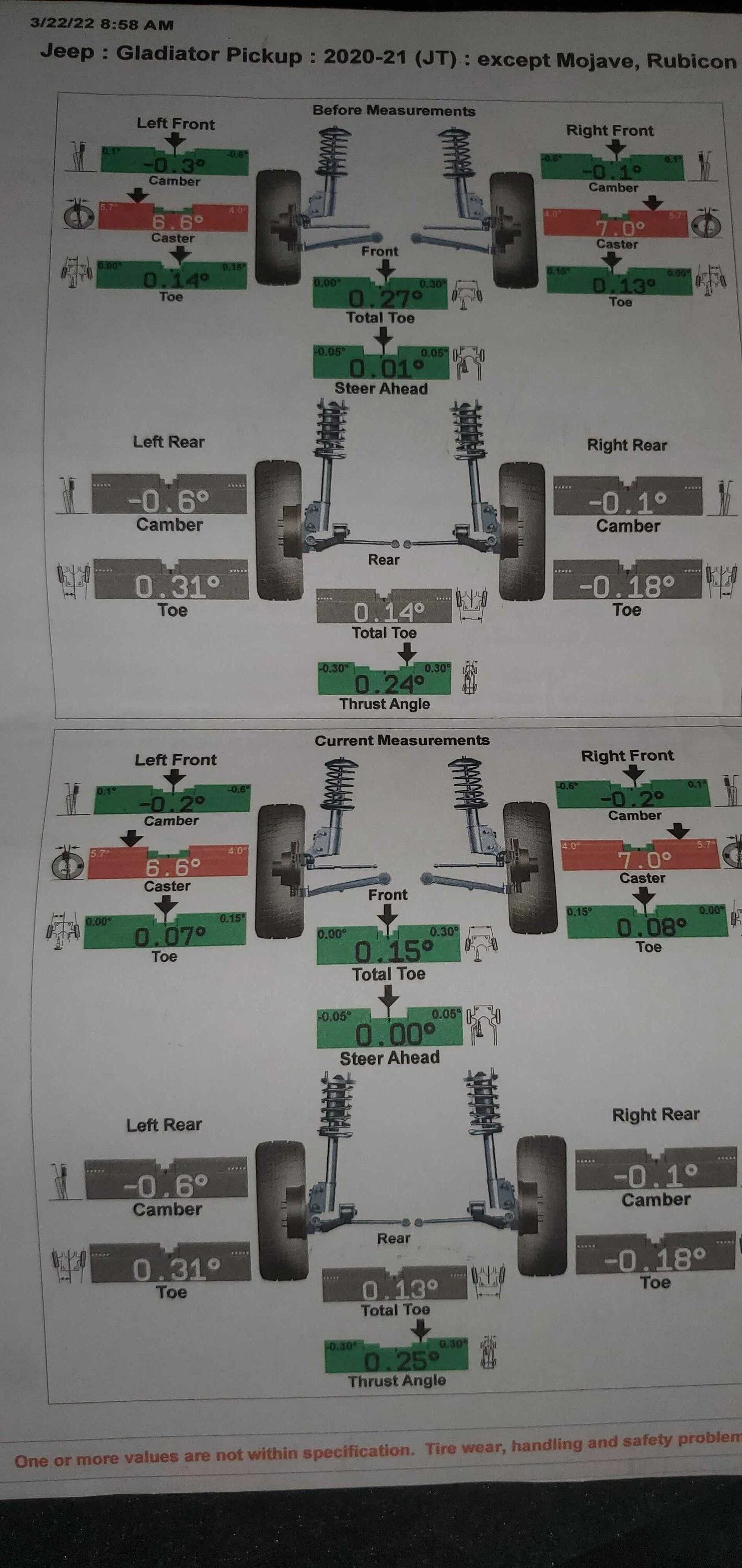

Got it aligned and the caster is pretty high. I've been meaning to look into that, but it's driving just fine. I'll probably post separately about the correction. Might have to mess around with the geo bracket or take it off completely.

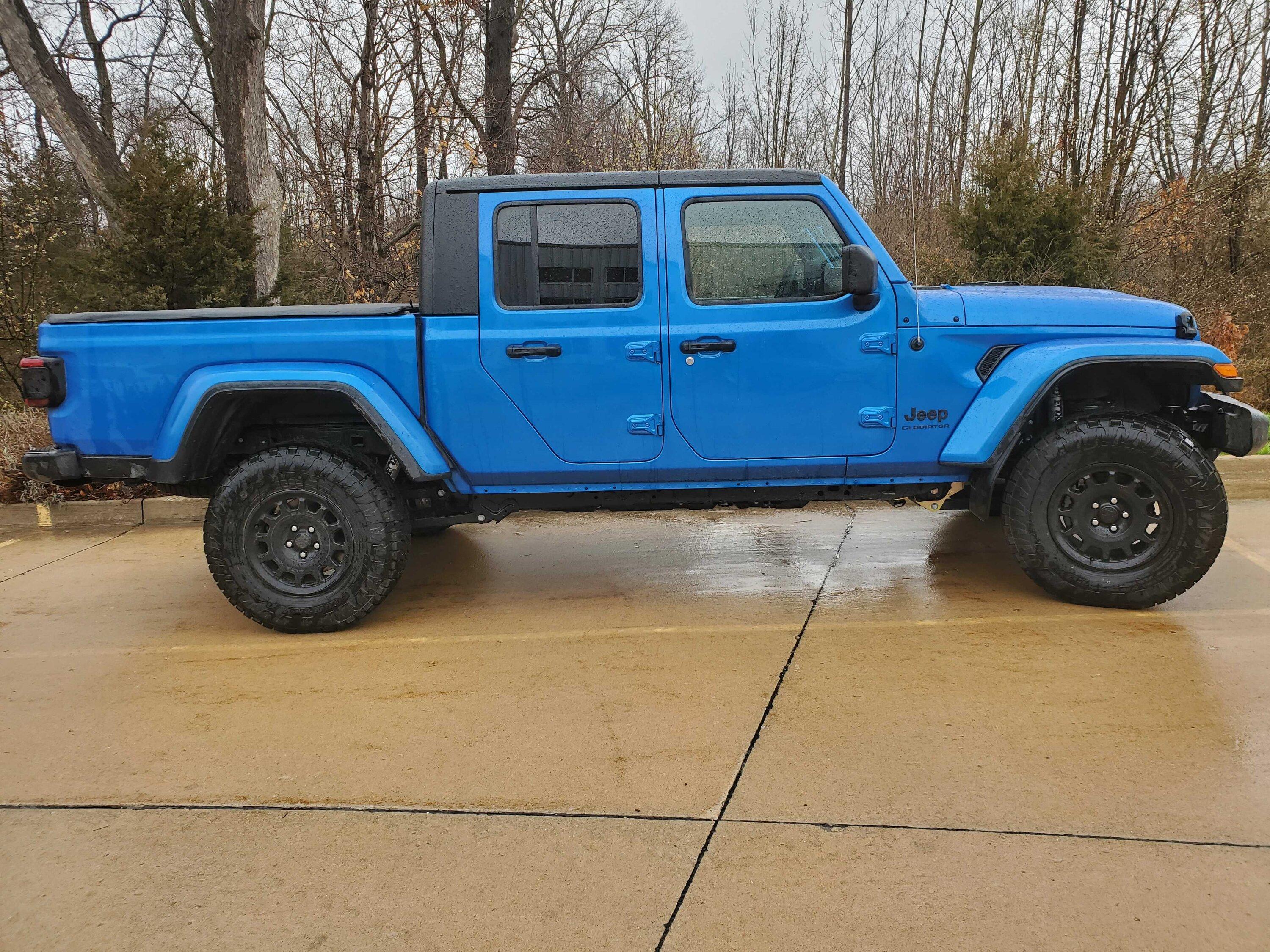

Installed the Weathertech front mud flaps, but they don't make the rears for the Max Tows yet. I love how the blue looks when it's wet.

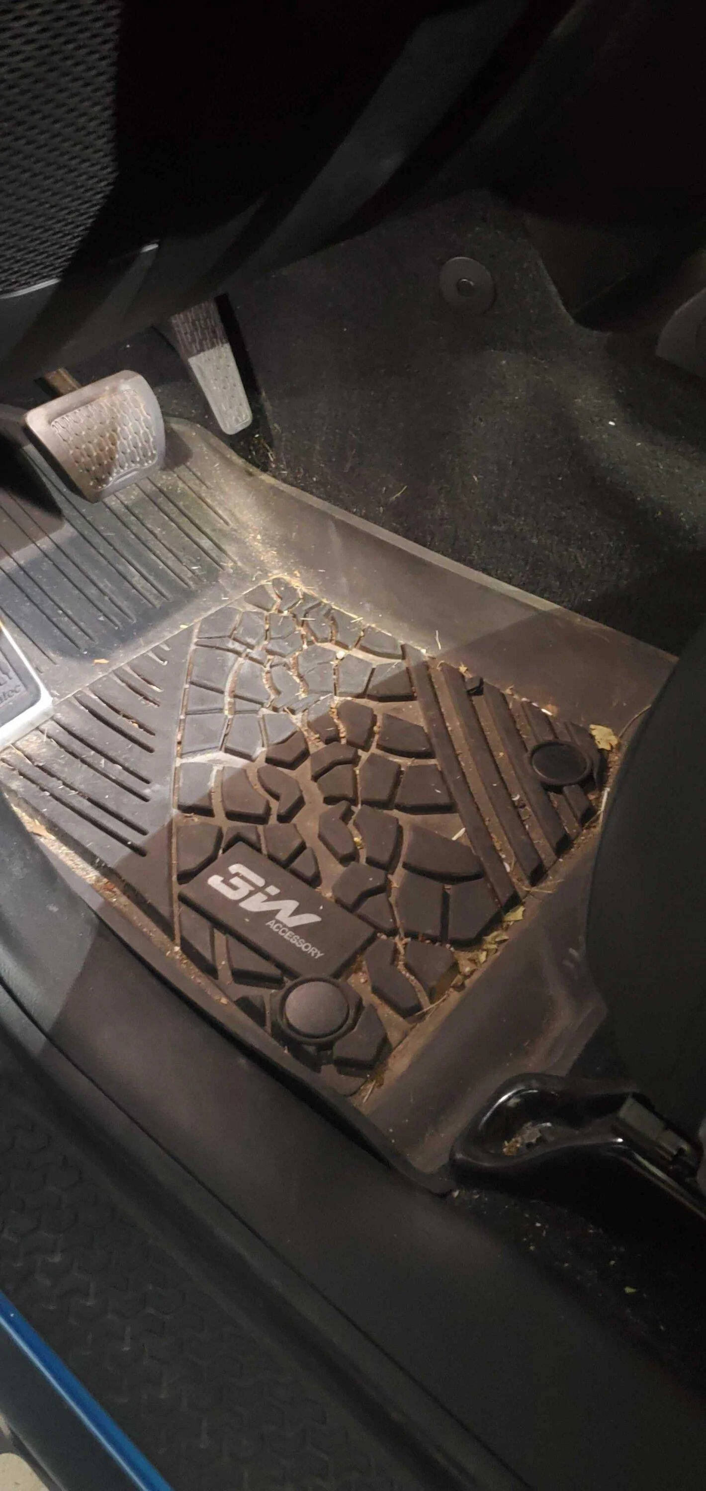

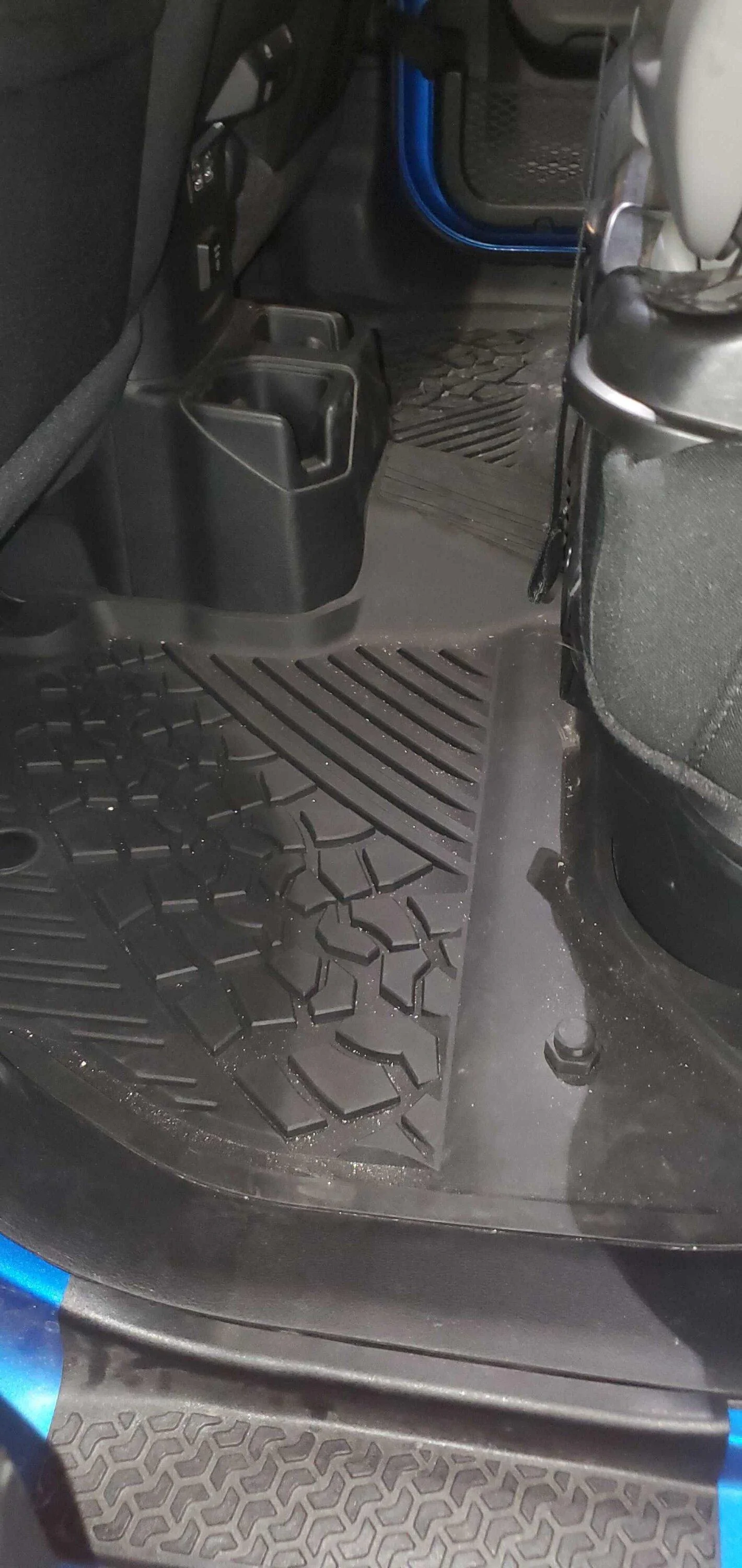

Speaking of rain, I put in some 3W slush mats. Great quality, but they got stuck in customs forever.

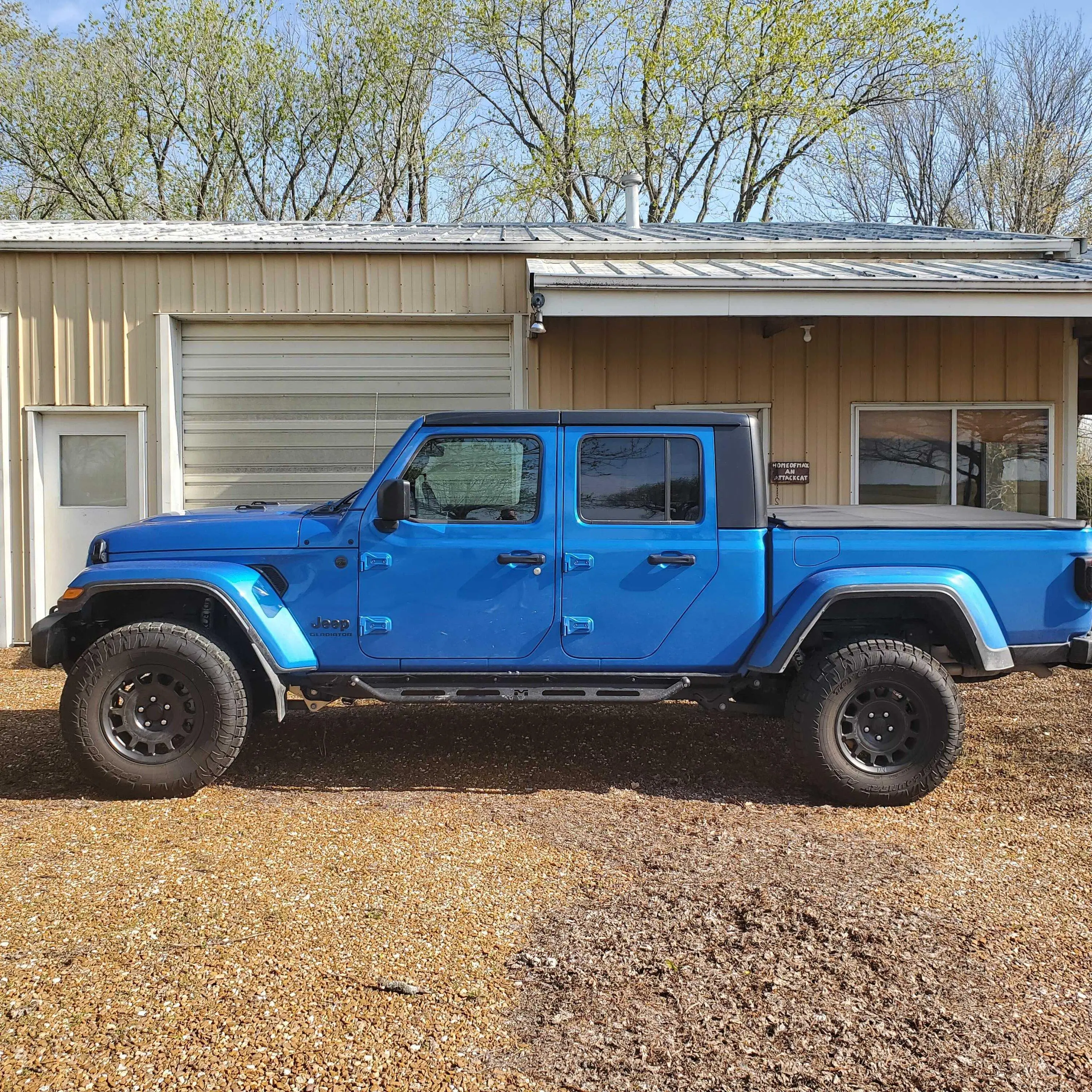

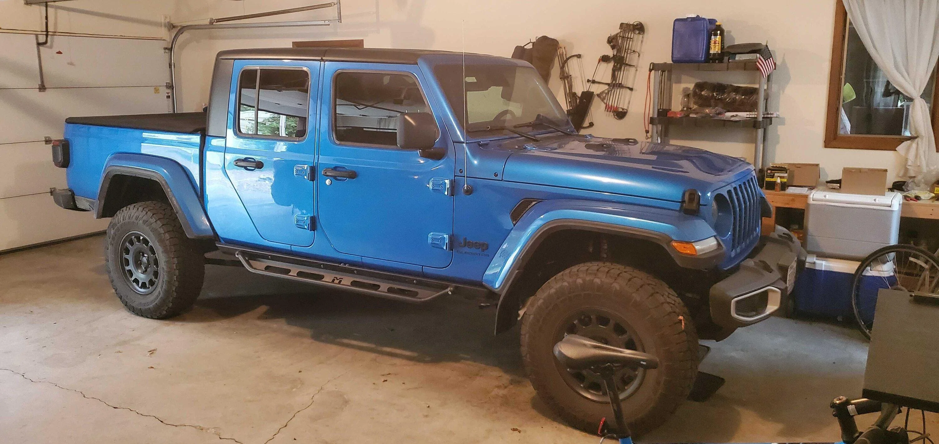

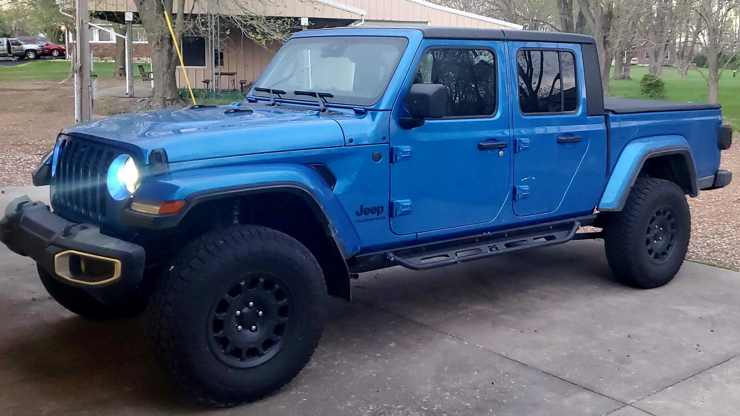

My toddler and wife had similar issues even on flat ground though, so it was time for some rails/steps. Ended up going with @Metalcloak Overland Rockers. Came packaged really well and went on pretty easy all things considered. I set myself up for a fun time attempting this solo though. Would def recommend an extra set of hands, but I didn't have the patience.
Jeep Gladiator Vrael's 22 Hydro Blue Sport S 20220411_173657
Here are a couple of shots of the setup after the lift settled and the side rails were on.

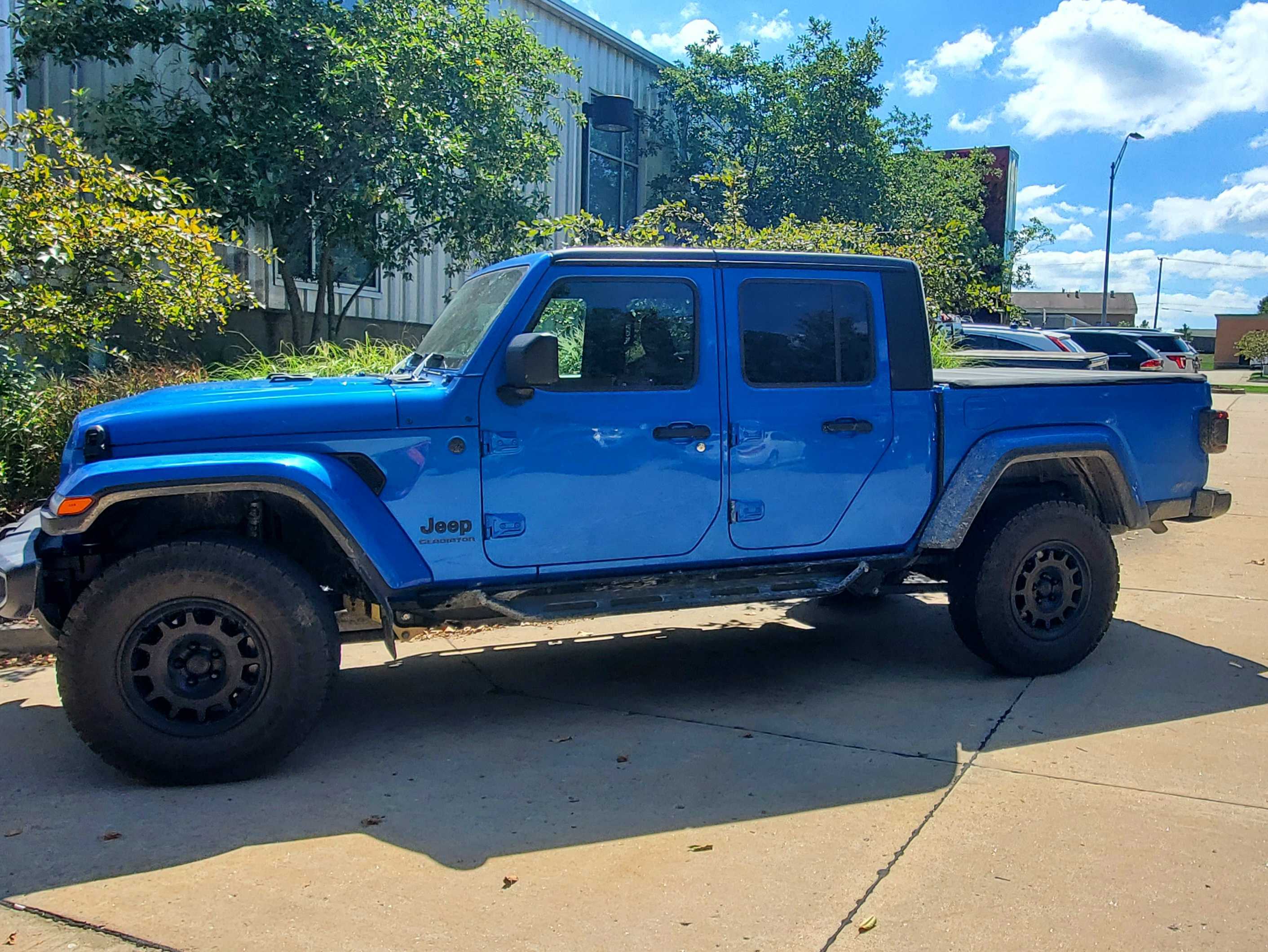

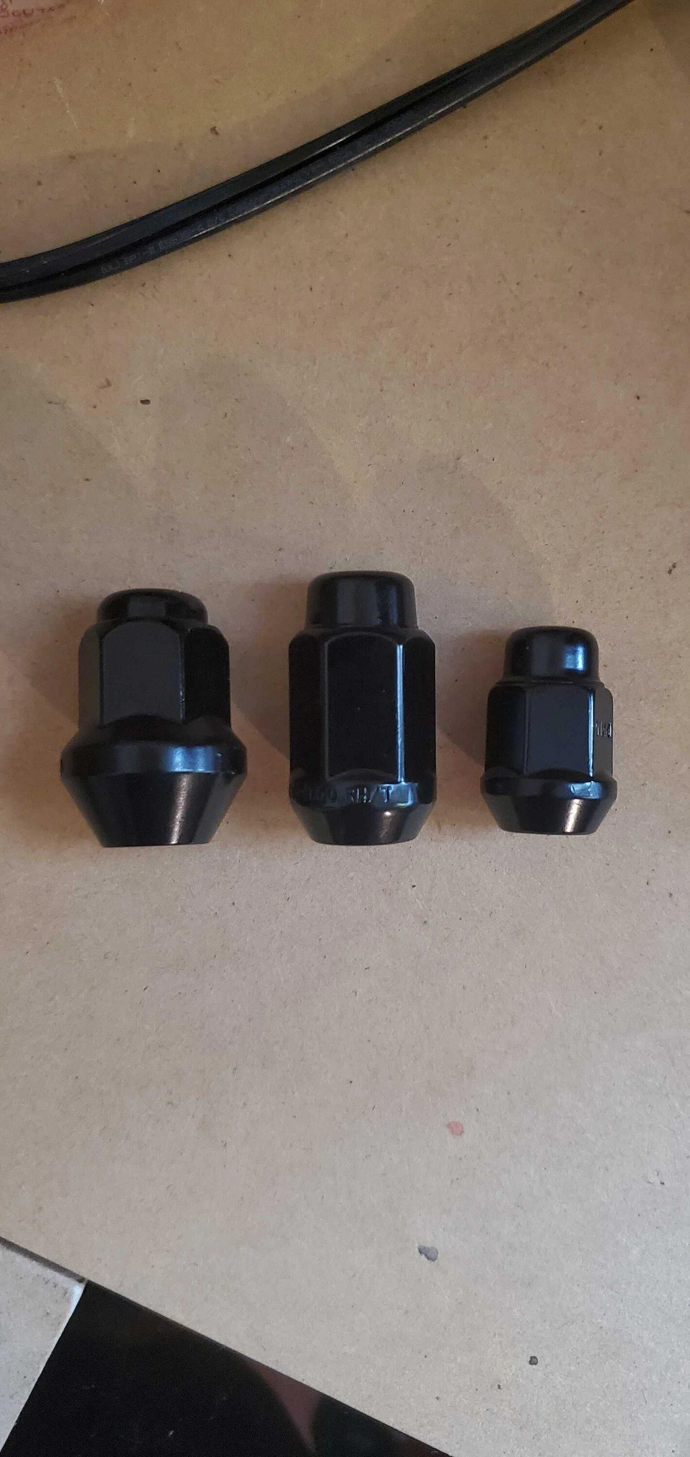

The silver lugs were driving me crazy so I tried a few different options. Left to right: Gorilla, Quadratec, Extreme Terrain. I thought the Extreme Terrain ones were going to be much larger than they were. I then tried Quadratec, but they didn't look right with the AEV wheels. The Gorillas ended up being perfect.

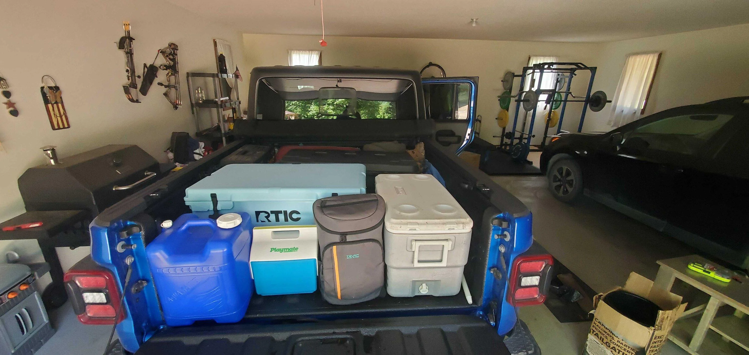

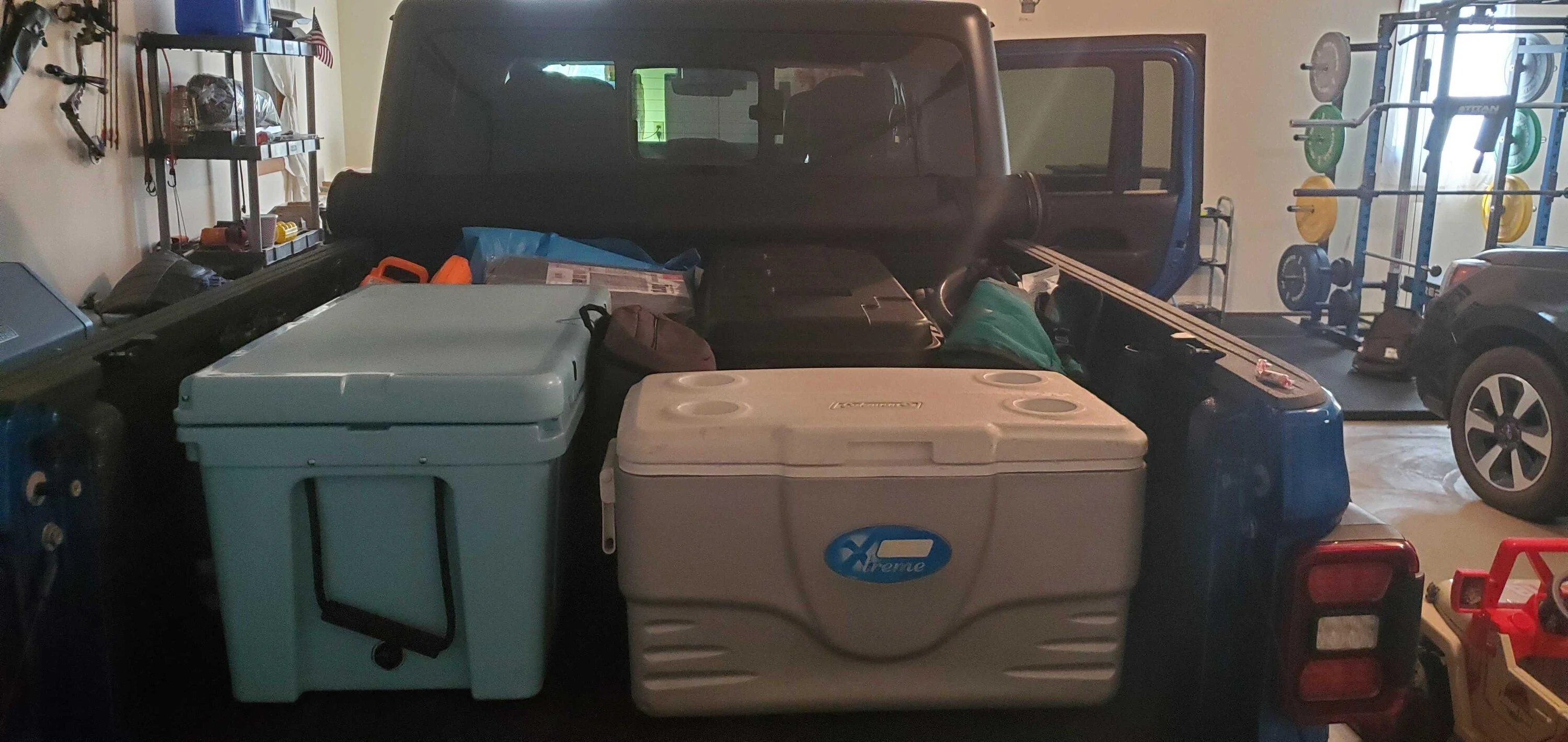

All then we started breaking it in! Always felt like we had just the right amount of space. Had some fun camping trips and hoping the temp starts to cool off so we can get back out there. I try to snap a pic of the Tetris-esque packing before I leave. Helps me remember how in the world everything fit when I'm packing it all back up.
Side note: The RTIC 65 QT fits perfectly under the MOPAR soft cover.
