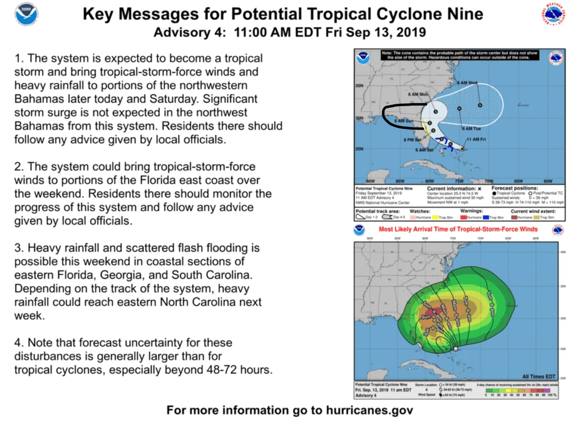

Shit, had I known this was going to happen I wouldn't have booked my trip to Alabama.
Florida AND Alabama are now safe. :clap:
Hope he doesn't say Utah is in its path tomorrow. :LOL:

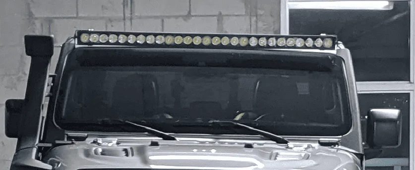

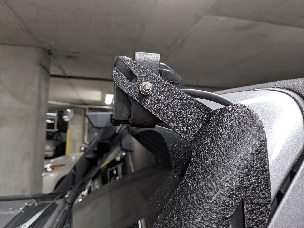

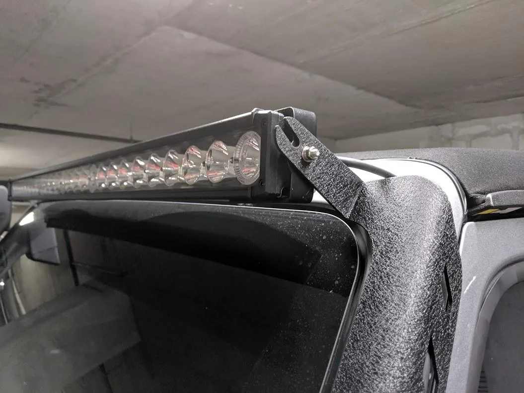

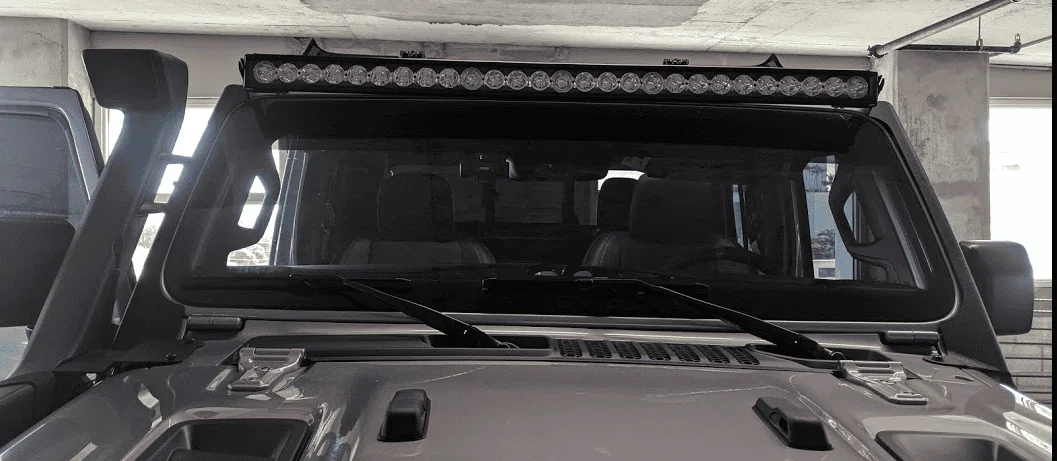

Last thing today:
Changed the bolts so I could move the lightbar closer in to the top.
I don't have whistling, but the SunRider 'thumps' in wind. I think the space between the bar and the roof add to the effect.
Some have said it'll settle as the fabric relaxes.
I also just like it tucked closer.
Before:
After:
cf02KuUWPrN_J_1NypCxsPbw-qcHhoax5hj56Y3SCFASDQX_yqLPgj9CGP_yF--EQIpWMXIXbj2aHH19gw=w1055-h791-no.jpg
8VRrPNcN4xvAT62Zg-1Bj8rhUddX6twktZBEWpcHrXNf1w6fIuvzFiCfjlSsXAstY8FX_BFcHV_fu0M48A=w1055-h791-no.jpg

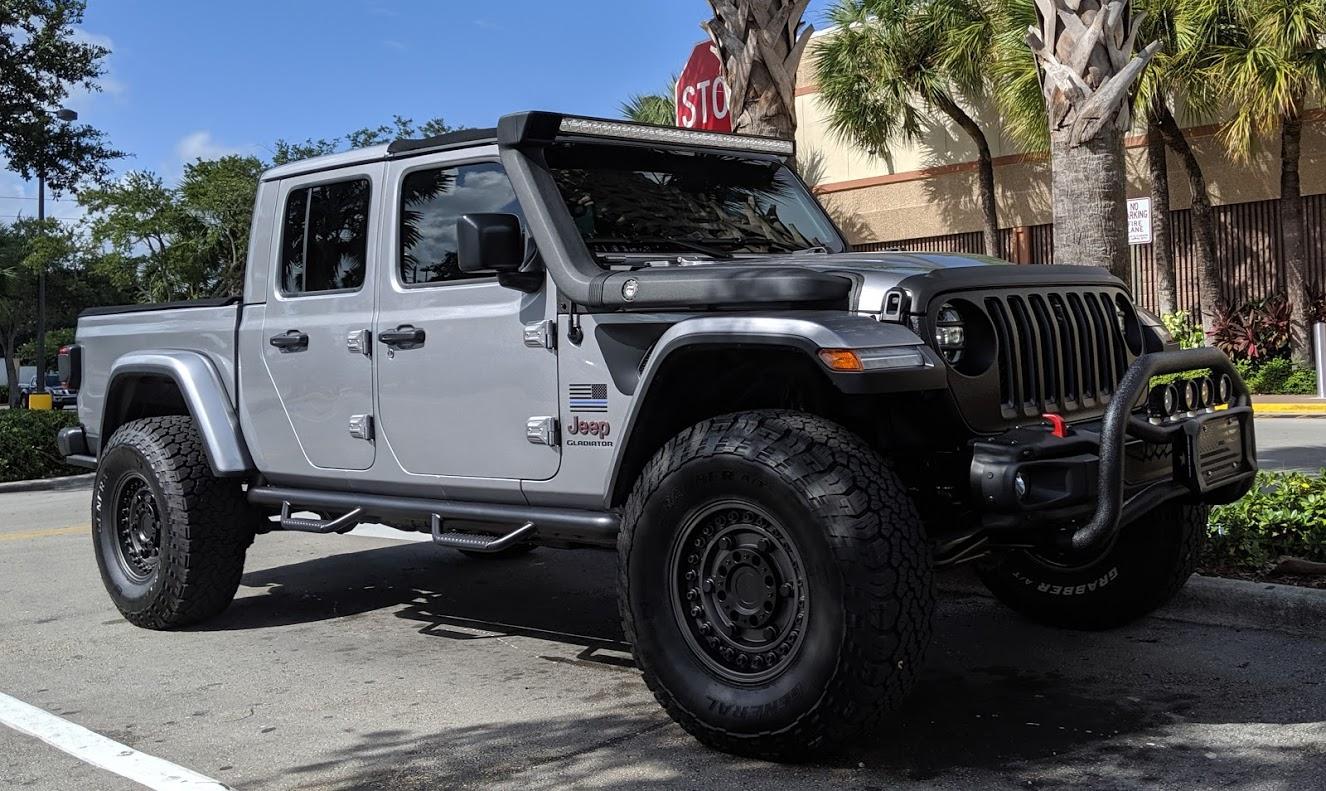

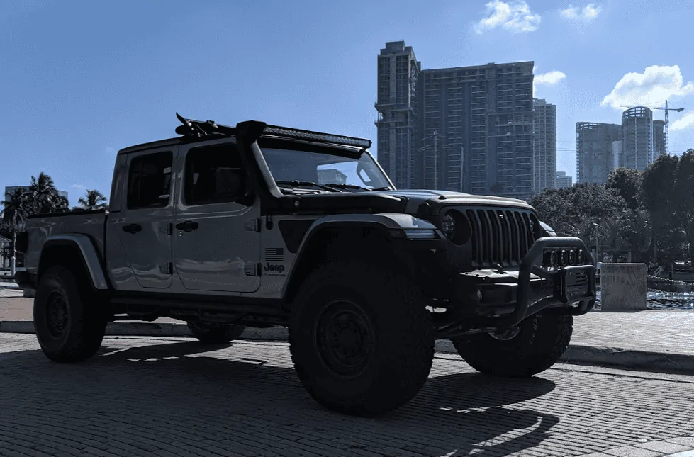

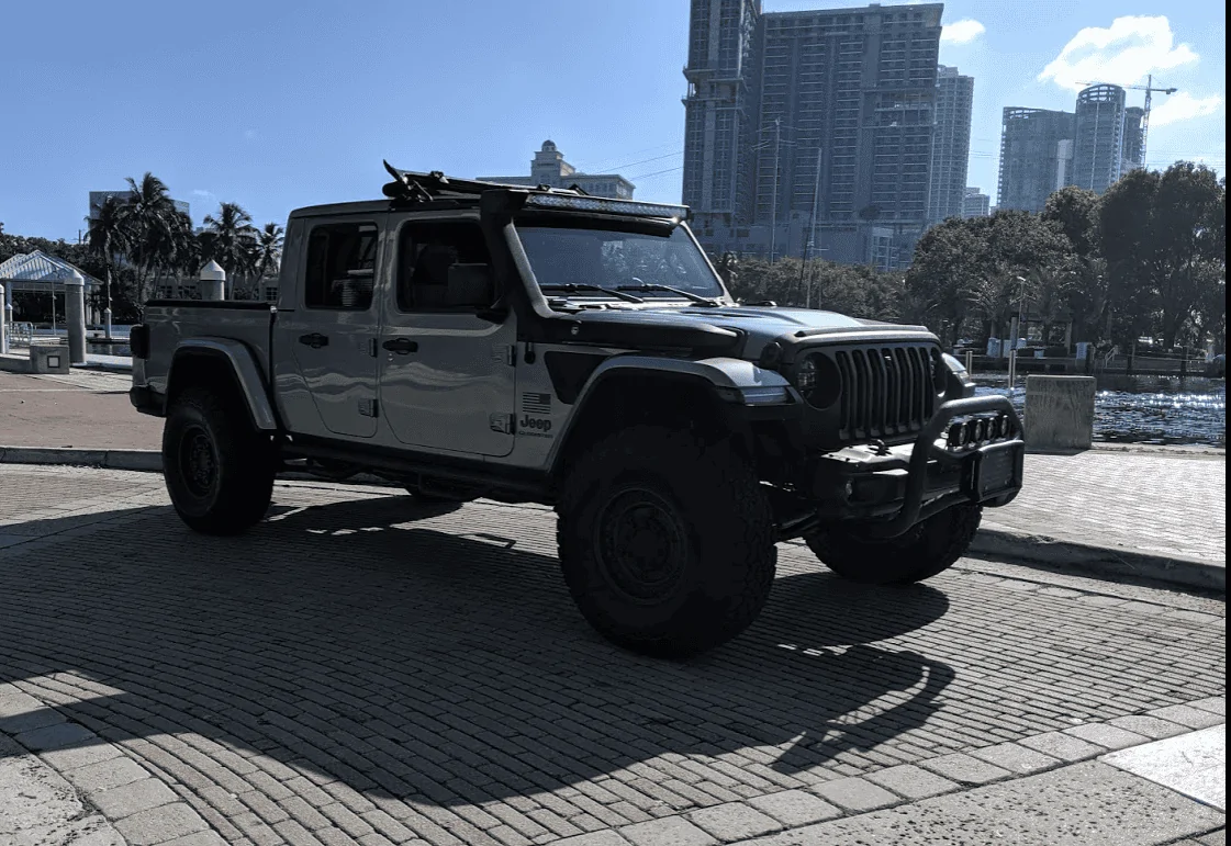

LET THERE BE 37s!
Before:
bGEpw_V9GQi1KXpBClqwt4bO3huzpd57jcDS1NmDnUk8HvvivoMh-A65J2GqdTsUuN8MmGrmeubXcQ9s0w=w1055-h791-no.jpg
After:
S7EXrXz31Xhodn0uS40cc882IlE-rggg30EBmlATKfmufDI8ba3JcBkS745uGxCVvzLqmQf_FvzUIXA3bg=w1055-h791-no.jpg
and DATs how I roll... :rock:
