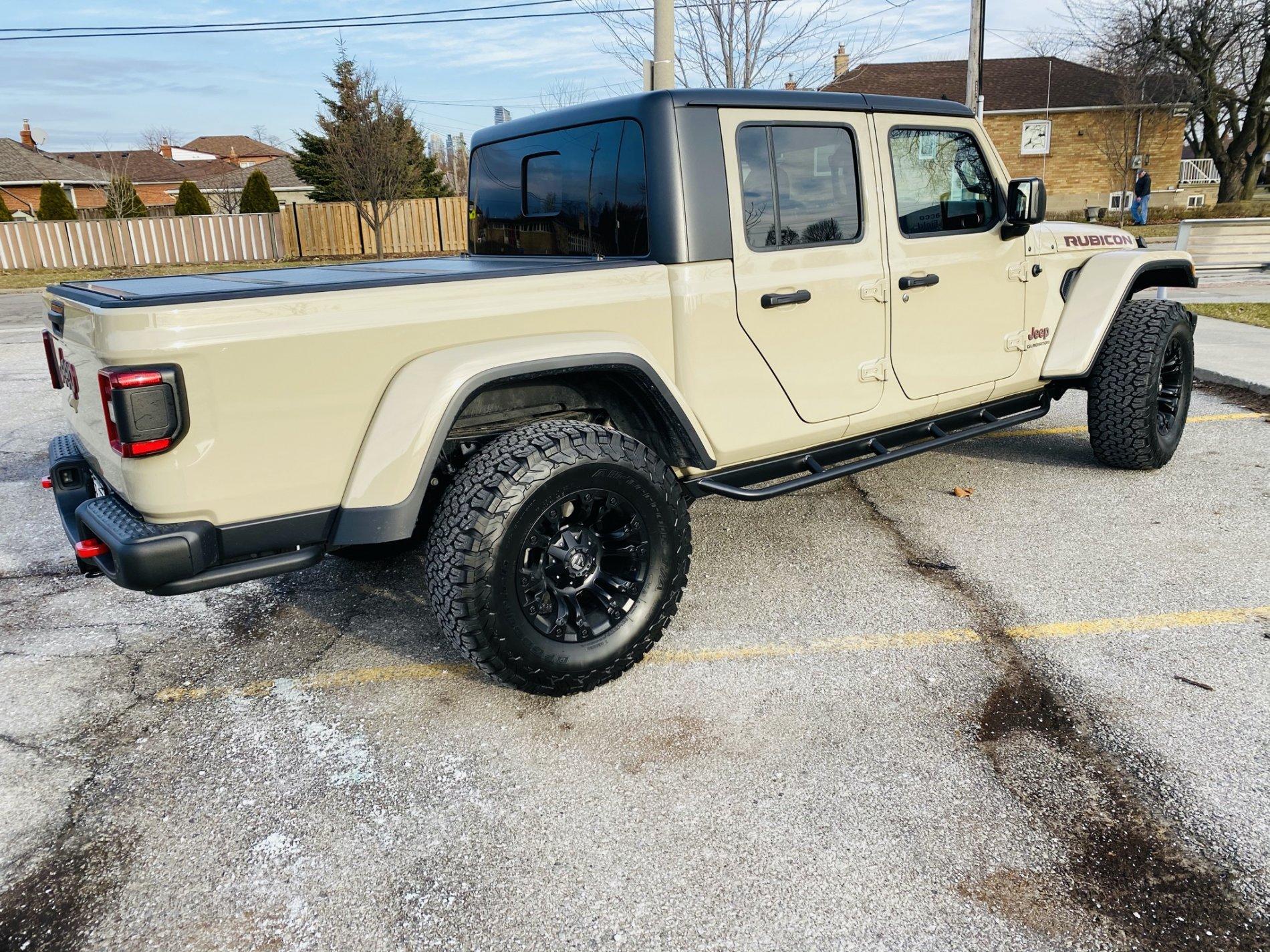

Here’s mine. Judging by how the rack mounts vs the roll up covering the entire top rail, I'm going to say it won't work.
Nope, will not work with that. We need access to the top of the bed rails.

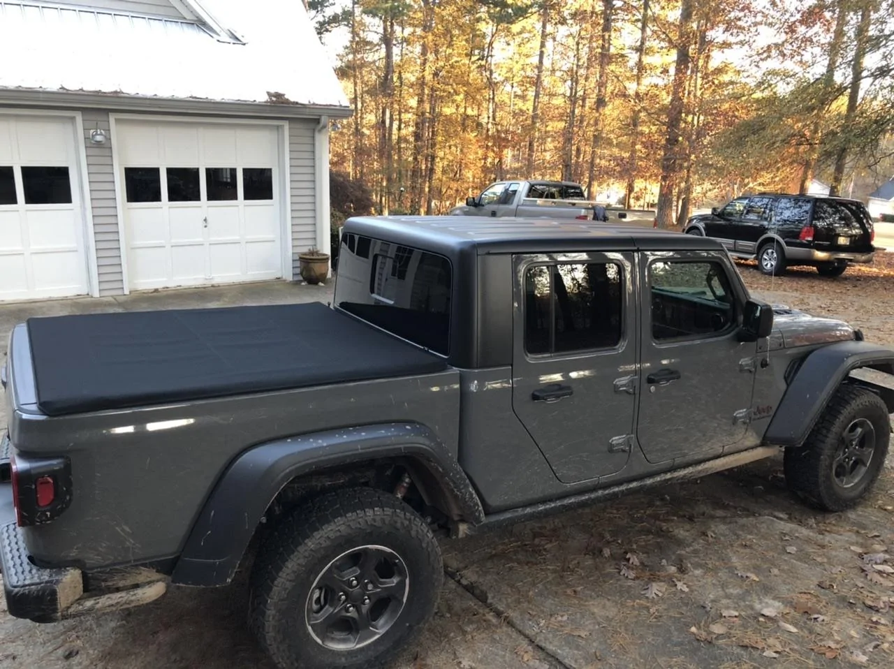

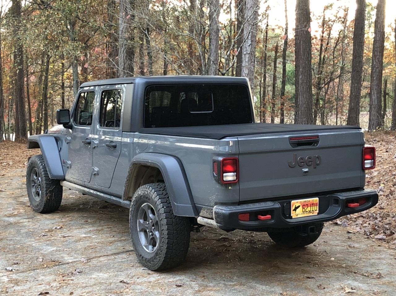

Mopar has a rollup? We've seen the hard and soft tri-folds. It will not work with either of those.
Sorry to ask again....so, it won’t work with the Mopar hard tri-fold cover that I have?
I keep hoping they will reply with Yup we now have an adapter. There are a couple other companies that have U shaped adapters the racks sit on top of to clear the cover.

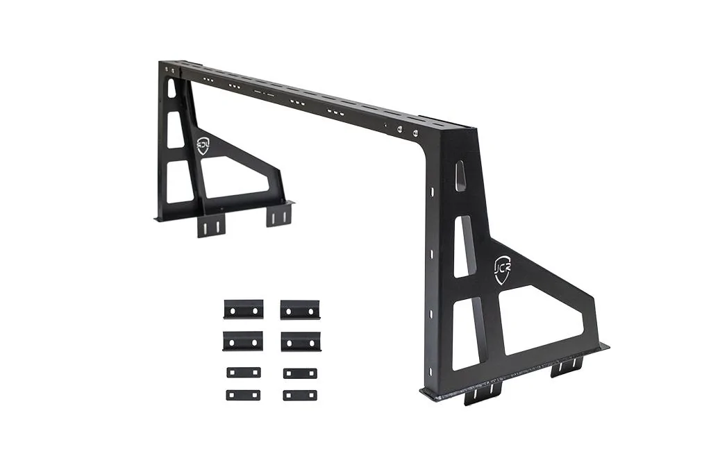

We won't be making that adapter because we really don't like the loads that a bed rack places on the bracket or the bolts when it's full of gear. The feet of our rack sitting on the bed rails adds a ton of strength.
