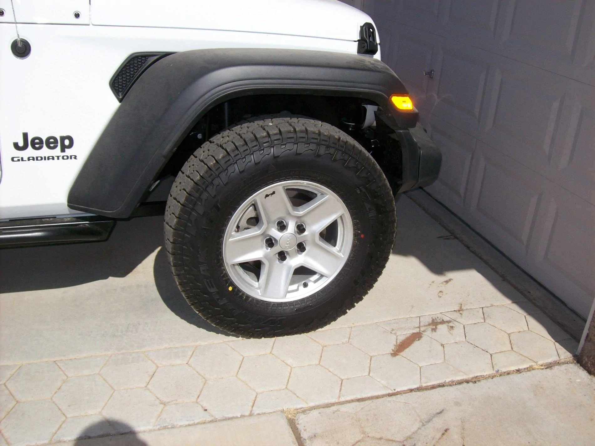

So I end up ordering falken wildpeak a/t3w 285/75r-17 .
Do I need to do any adjustments for the odometer? Or anything else when put theme on?

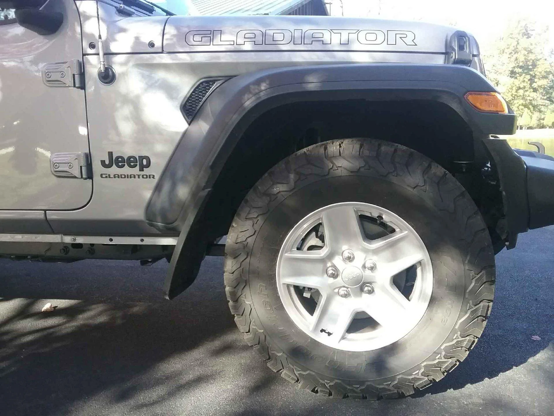

you can go straight to 37s in stock configuration and oe wheel. But not all 37s fit as most require 8-9" width wheel vs our 7.5". I did milestar patagonia mt, 37x12.5r17 before putting on lift. Only requires shaving the lower plastic winglets in front of both wheels. Any major articulation will rub further tho, so off road not recommended. Otherwise, on road the tires came to an inch or so from splash shield up front. Drove for 2 weeks like so before putting on lift with no issues.
Pre lift
Post lift 3.5"

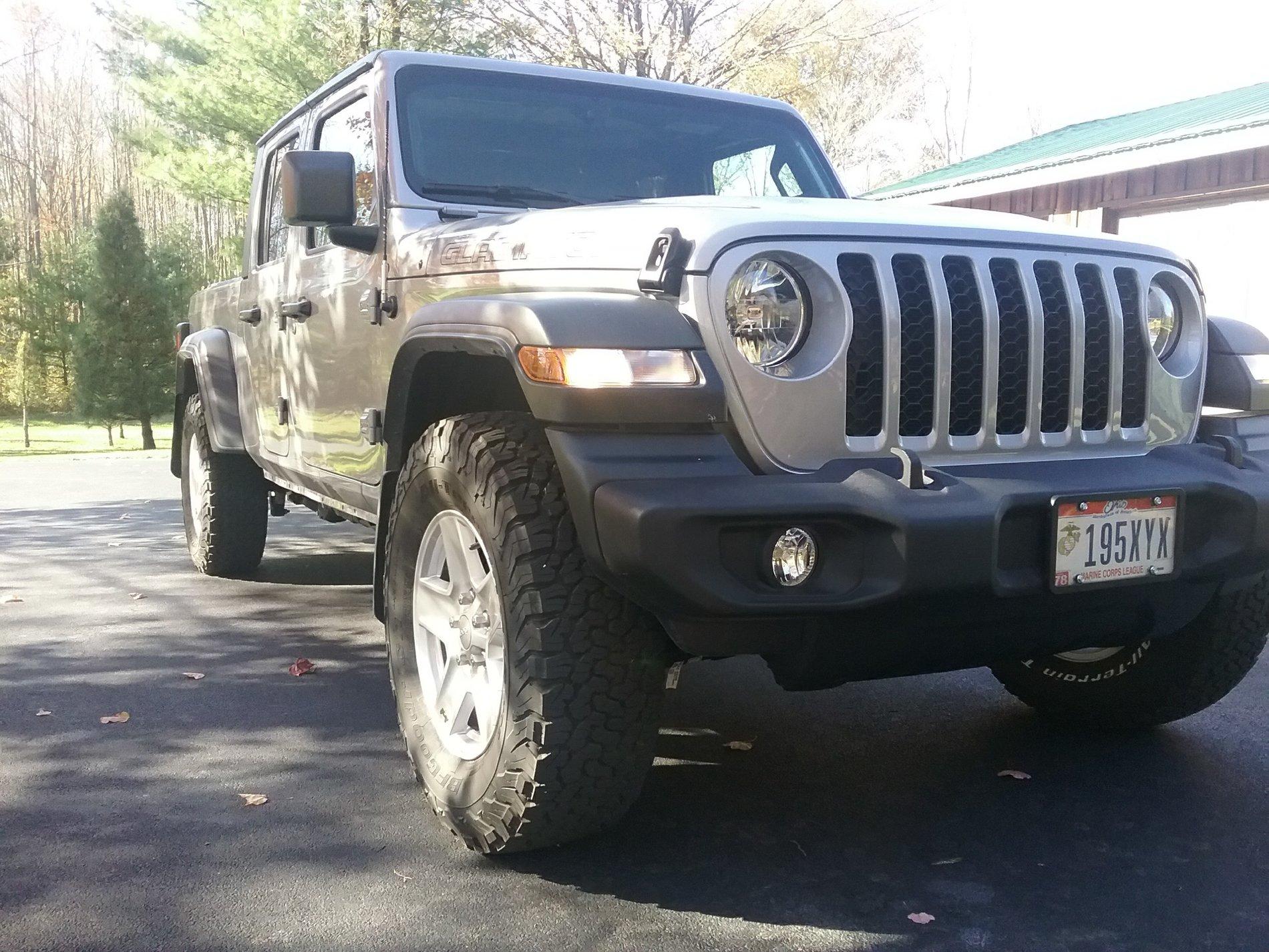

If u keep the oe wheels, u can do 12.5 wide tire and should only have the slightest poke via sidewall. Tread should still be under/inside fender. These are 37x12.50r17 on oe rim... pre lift

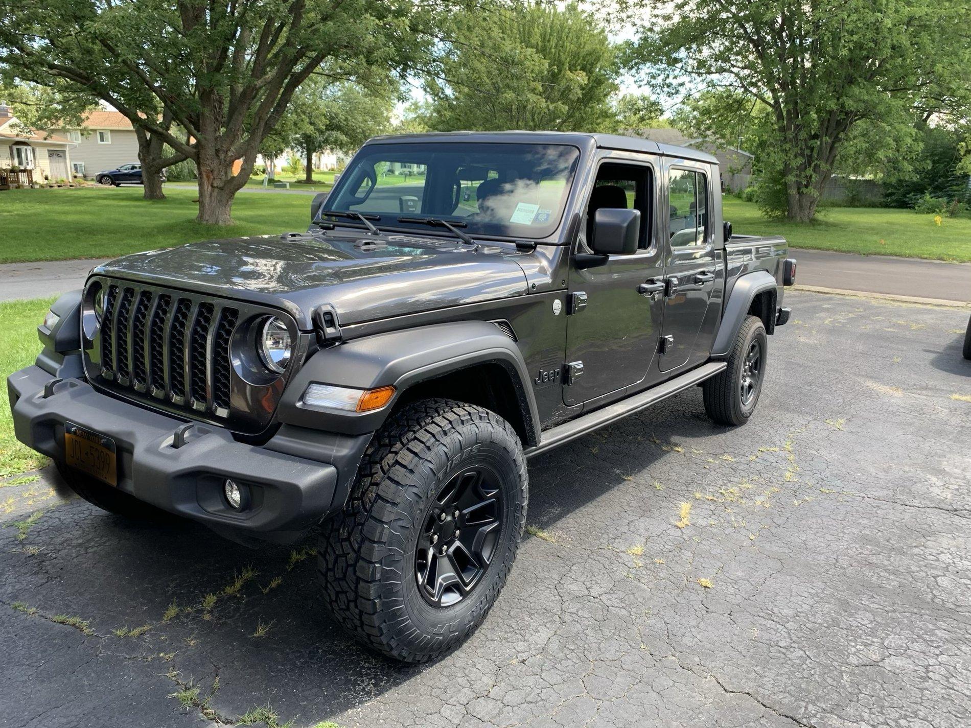

255-80-17 Falken AT3W on my max tow sport s. No trimming or mods, perfect fit. Just returned from hundreds of miles on rocky trails hunting. Tires performed perfectly.

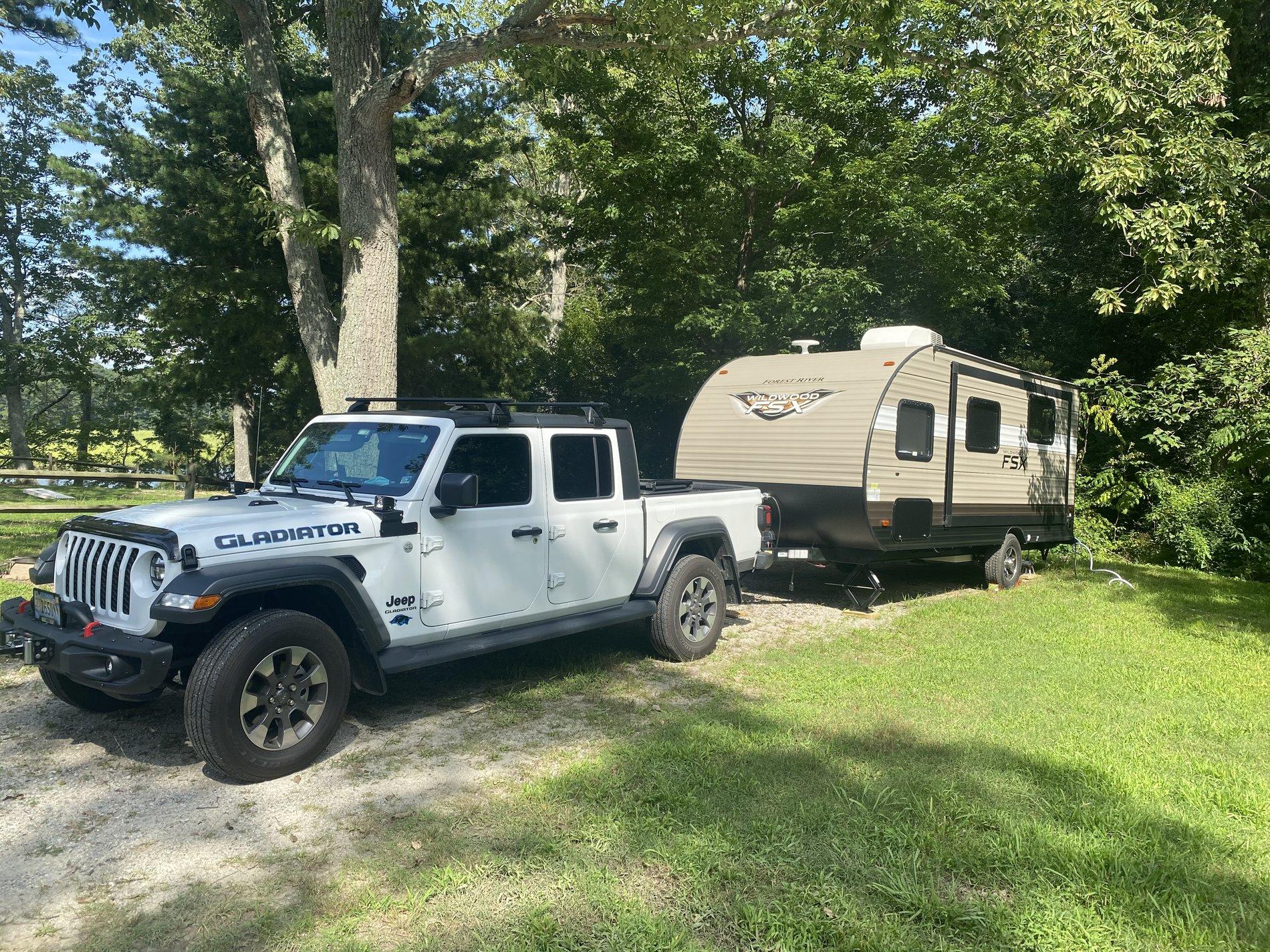

I’m definitely confused with all the other feedback discouraging anything
above 34’s and 35’s and above on stock/no lift- just won’t work??
My intent is to have more rubber on
the road trailering @ 22’/3500 lb
Camper-
It works but definitely not like a full size
pick up with a wider wheel base-
No off roadibg
Don’t want tires to protrude if possible or have overpowering look-
Seems 34’s just higher
35’s possible
Will check specs
Have max tow/sport s
Thinking out loud!!
35s may be better in ur situation. The squat may cause rubbing when towing. Look into Kenda Klever RT. There's a thread on here about them. Can do 35x10.50r17 with oe rim. Still inside the fenders and D load rating I think.

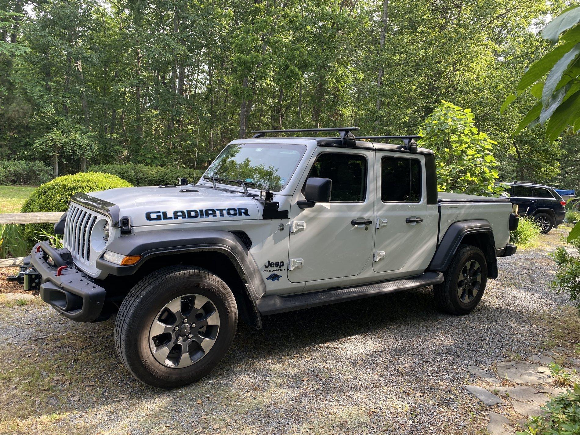

285/70/17 nitto terra grappler g2s on the stock wheel.
Those Nittos looks excellent... my Sport S is also white and has these wheels... I'm guessing (hoping?) that you can use 285/70/17 's with the stock wheels without ANY other mods (i.e. no lift, no backspacers, levelers, etc.) Also, does your have tow package or max tow? Sorry for all the ?'s but I'm new at all of this! :) Many thanks!
