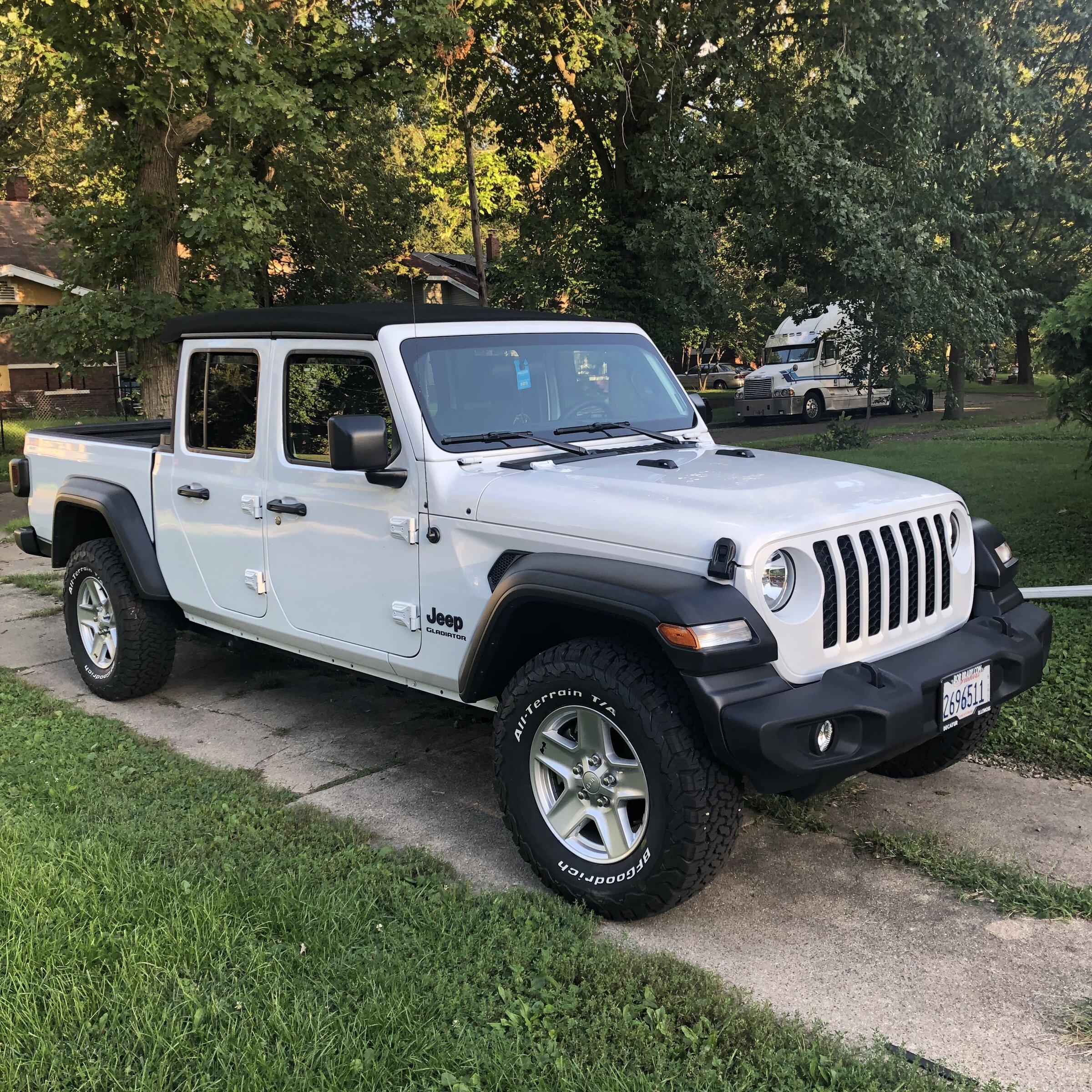

Your mileage may differ I've got 33/10.5/17 on stock rims no rubbing but the wider track of Max-Tow.
Jeep Gladiator Sport S Wheels and Tires question 20220326_080751
Only photo handy I'm getting tires rotation done.

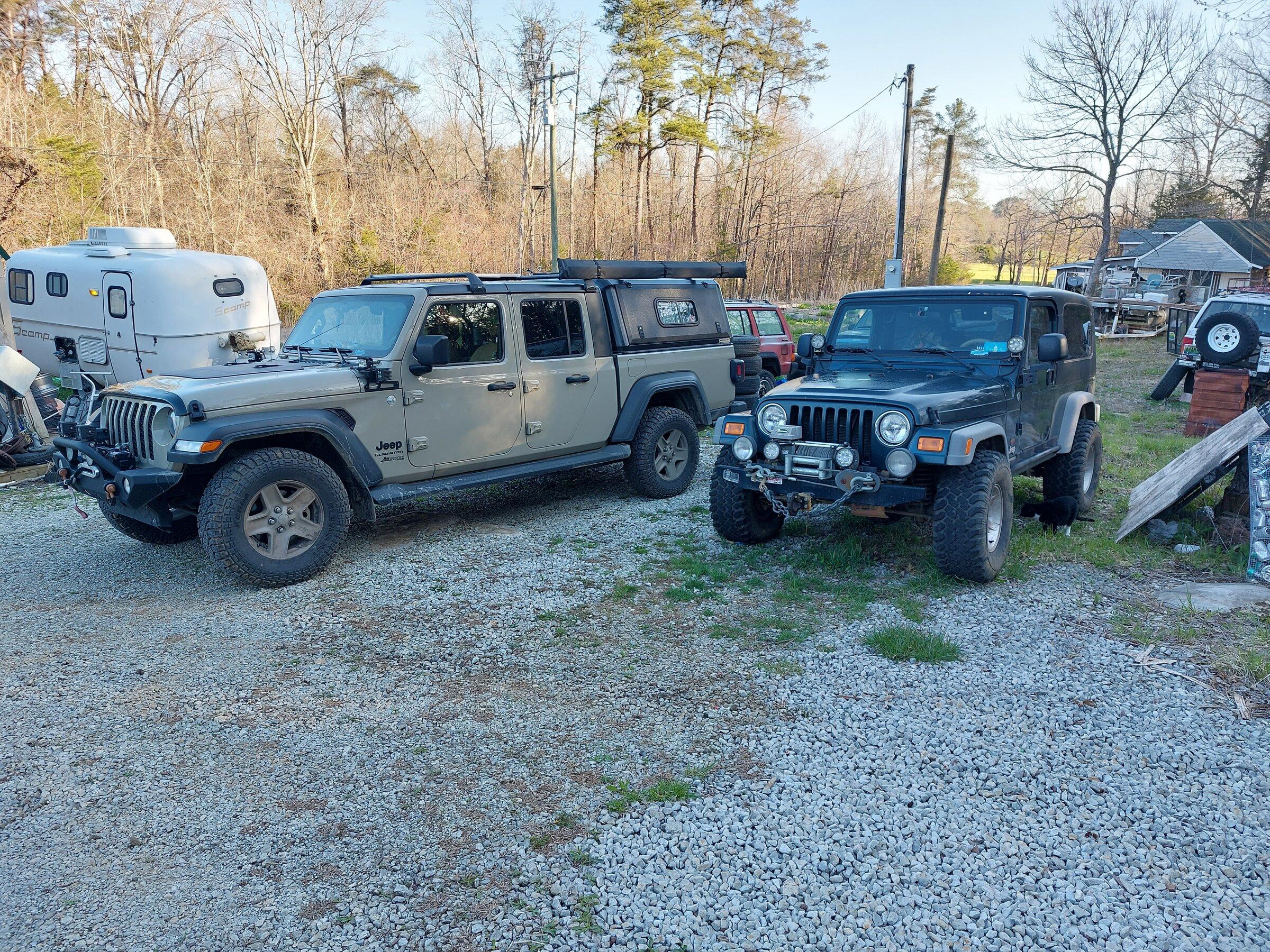

Jeep Gladiator Sport S Wheels and Tires question 1648509657102
2020 Sport S. 35 inch tires, 18 inch rims, sky jacker 2.5 lift

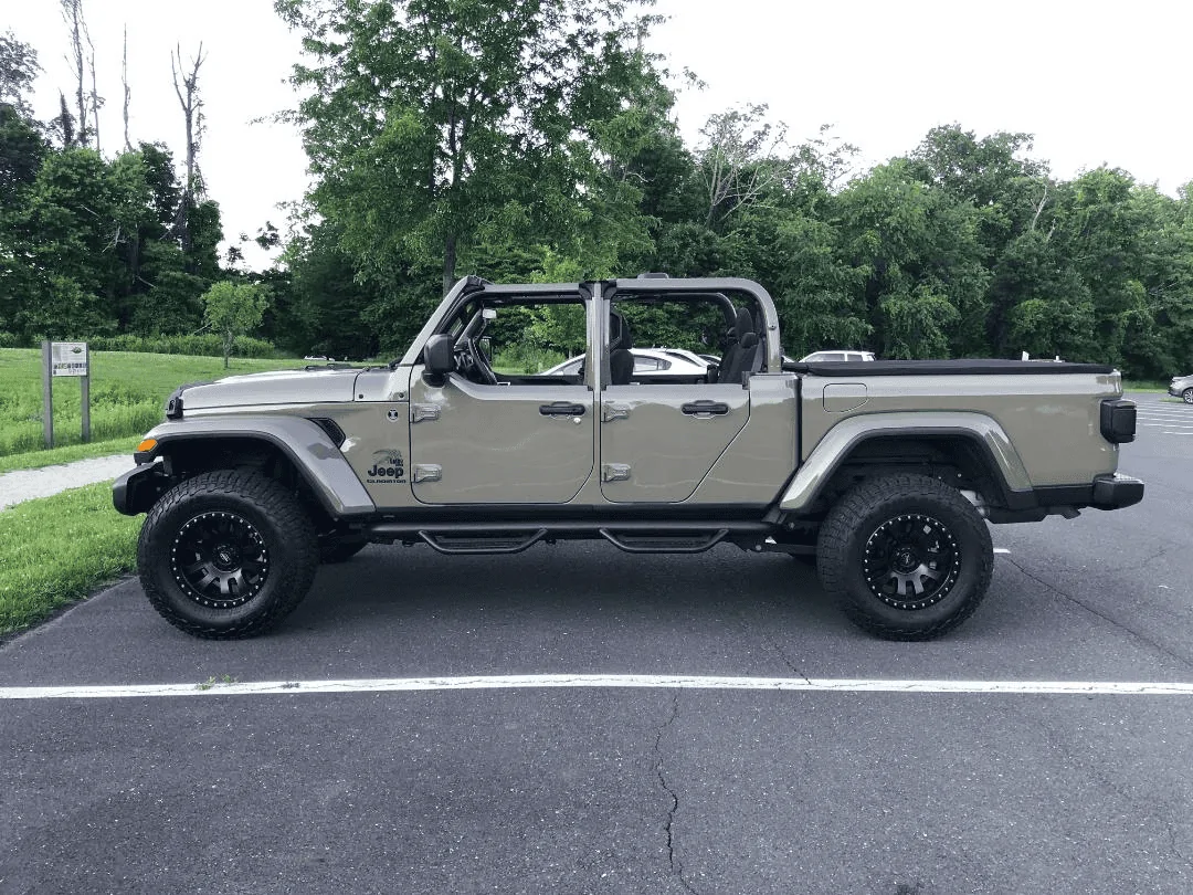

Law
285/70/17 no lift on sport S. 0 offset will bring the tire out so no rubbing on suspension components.
