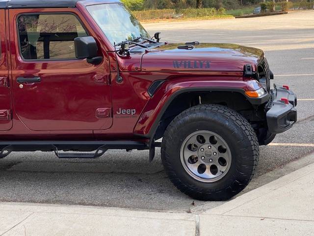

I went with the Toyo Open Country AT3's in the 35*11.5/17's. The only mod I did was add a leveling kit. There's no rubbing and the ride was a massive improvement over the Firestone MT's my Willys came with.

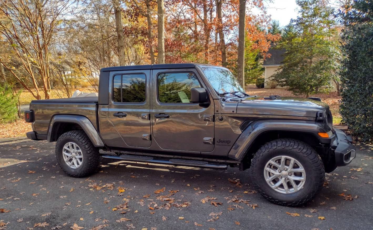

Here's another question: Our Sport S doesn't have the wider Dana axles that a Rubicon has. Sport S comes with the 245/75R17 tires. Without that extra axle width will those Rubi take offs with 285/70/R17's restrict the front steering? Guess not, nobody mentioned this. Can I hear from Sport S owner who has done this? 3% on the speedo is not a big deal but tire rubbing would be.
Maybe it would be better to stick with the 265/70/R17? I really want General Grabber ATX. I have Grabber AT2's on my Tahoe, nice tread, very quiet...and not made anymore. Can't get the ATX in 245/75's. I prefer narrow tires for mud, and out here I don't see snow to float over. As I said earlier, really like quiet tires that do not sing to me on the highway.
I ran 285/70/17 on my 2021 WILLYS with no issue.
