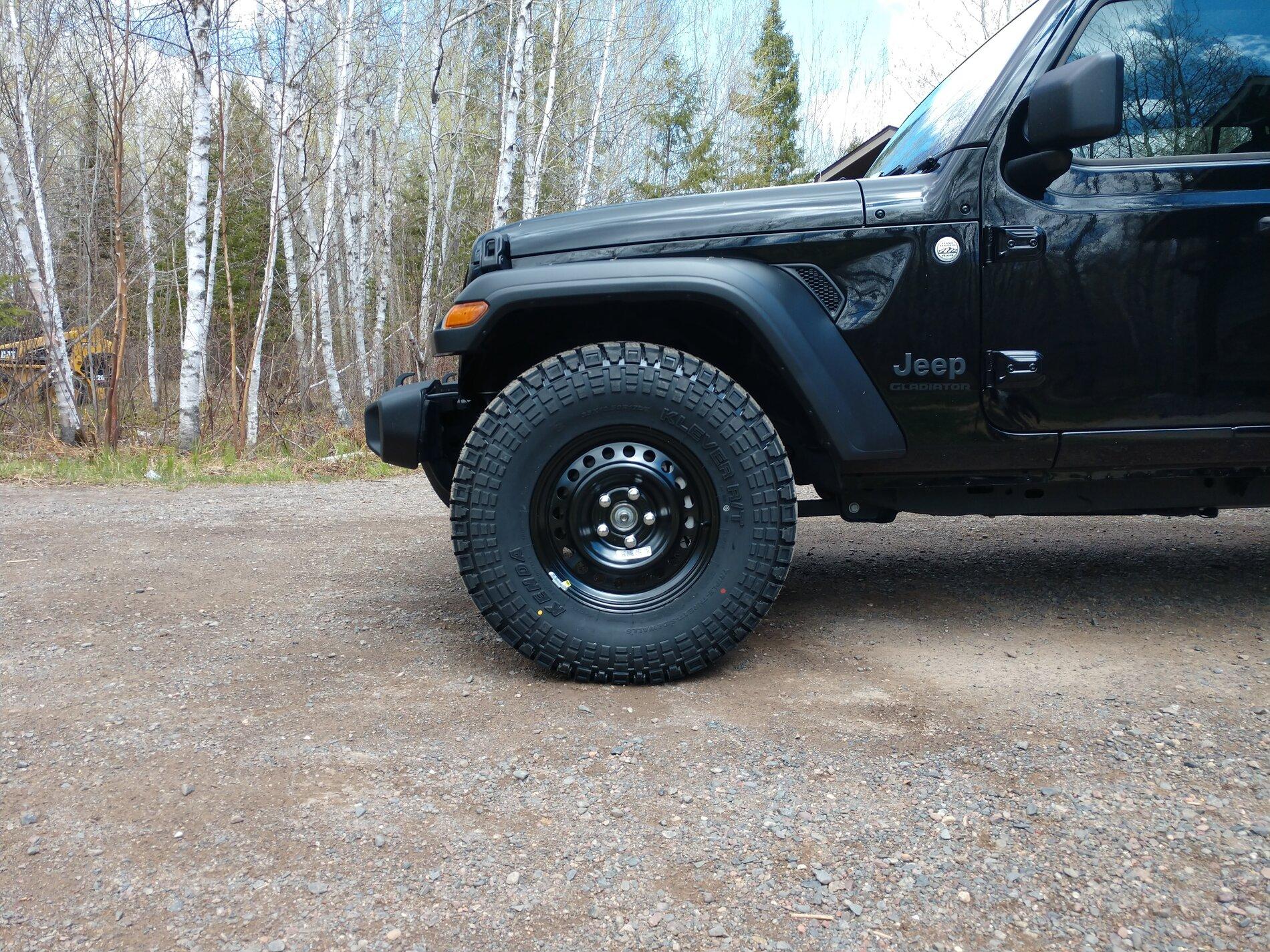

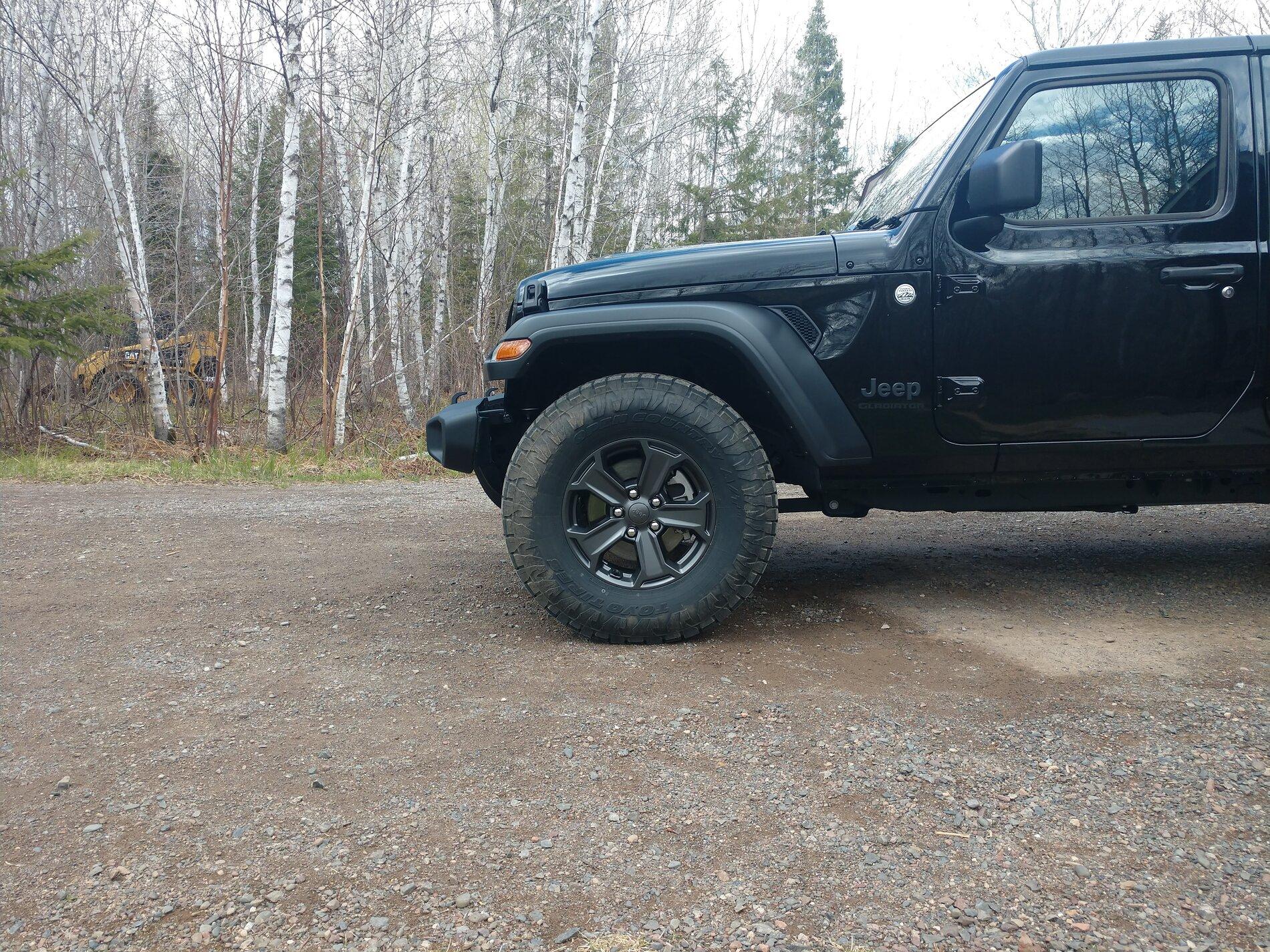

Like Higher_Ground I went with Toyo AT3s in 285/75r17s. I use the truck on a lot of low/no maintenance forest roads and I've never run into clearance issues flexing the truck out at full Iock. I also have the Kenda R/T 35x10.5r17 as a spare and have had no clearance issues with that either.
Jeep Gladiator Tires, when the time comes, for no-lift Sport-S IMG_20200514_160128297
Jeep Gladiator Tires, when the time comes, for no-lift Sport-S IMG_20200515_140706013
