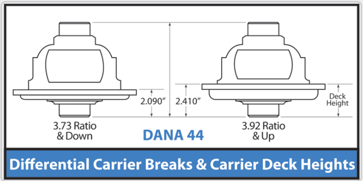

The prior generation of these axles DID require a carrier change. This version in the JT does not.
I have a chart that shows the break - assumed it was for these since the numbers were the same, but no, these don't require a carrier swap.
Maybe they are thinking of the other version or prior generation of this axle?
Supposedly this is for the pre-AdvanTec axles the JT has -
FWIW- The prior generation of these axles DID NOT require a carrier change. The JK 44's could go from 3.21 to 5.38. The generation PRIOR to the JK (the TJ except TJ Rubicon) did require a carrier change.
It's worth noting that the front JL 30 doesn't need a carrier change either although all prior models did require the change. The factory 3.45 JL gear is an ultra thin gear and the diff will allow fit of even 5.38 gears.

So, the bottomline to change from 373 to 488:
1-A new carrier is definitely required
2-It will fit in the existing differential case
3-The 488 ring and pinion set will also fit inside the existing diff
3-Therefore, the existing front axle (and its front diff) is fine, as is, so long as a new cxr is ordered, and a complete master install kit is also ordered?

No, he's saying correctly that this generation and the one immediately before it did not.
I'm trying to find the exact break as some of the "gear shops" have conflicting information, but the bottom line is that the JT does NOT require a carrier change or a housing change.
You need the gear set, bearings, seals, shims, etc. (so a master install kit) - no carrier is needed.
A good shop could put 4.xx gears into the housing you have and use the existing carrier.
Even in the prior generations, there were "thick" gear seat that allowed using the original carrier.

OK, that’s great news! That will definitely save me some $’s!
I was just reading in the 2021 Jeep Gladiator Mopar JPP accessories catalog under the description for the ‘JPP Ultimate Dana 44 AdvanTEK axle assembly,’ it says: ‘…The high-clearance carrier design adds an additional half-inch of ground clearance, and an expanded range of gear ratios (4.56, 4.88, 5.13, and 5.38) helps accommodate for a variety of tire sizes…’
So, my takeaway is JPP is describing the OEM axle equipped on all of the 2018+ Rubicons with the new wide M210, so there’s really nothing to be gained by going with an entirely new crate axle, other than I guess if someone wants to eliminate FAD, in order to get rid of the spliced axle on the passenger side (assuming that’s an advantage in the first place)? This also means all 2018 and up Rubi’s gained a half-inch of ground clearance, given the new M210 wide front OEM axle, and it’s new diff case?

I was able to get confirmation-
The JT m210 front 3.73 gear set uses the same diff case as the 4.10 case.
We already had confirmation on the rear m220. m220 3.73 gears will use the 4.10 case as well.

Yeah, that's been posted here because a few Overland owners have already changed gears - as well as some sport (non max tow) owners have done same. So it was a given the SAME housing will support any of the common gear ratios.
Can't change the rear and not change the front.
I asked the folks here last year - and we discussed carriers as well. The proof then was that several had already made the change.
