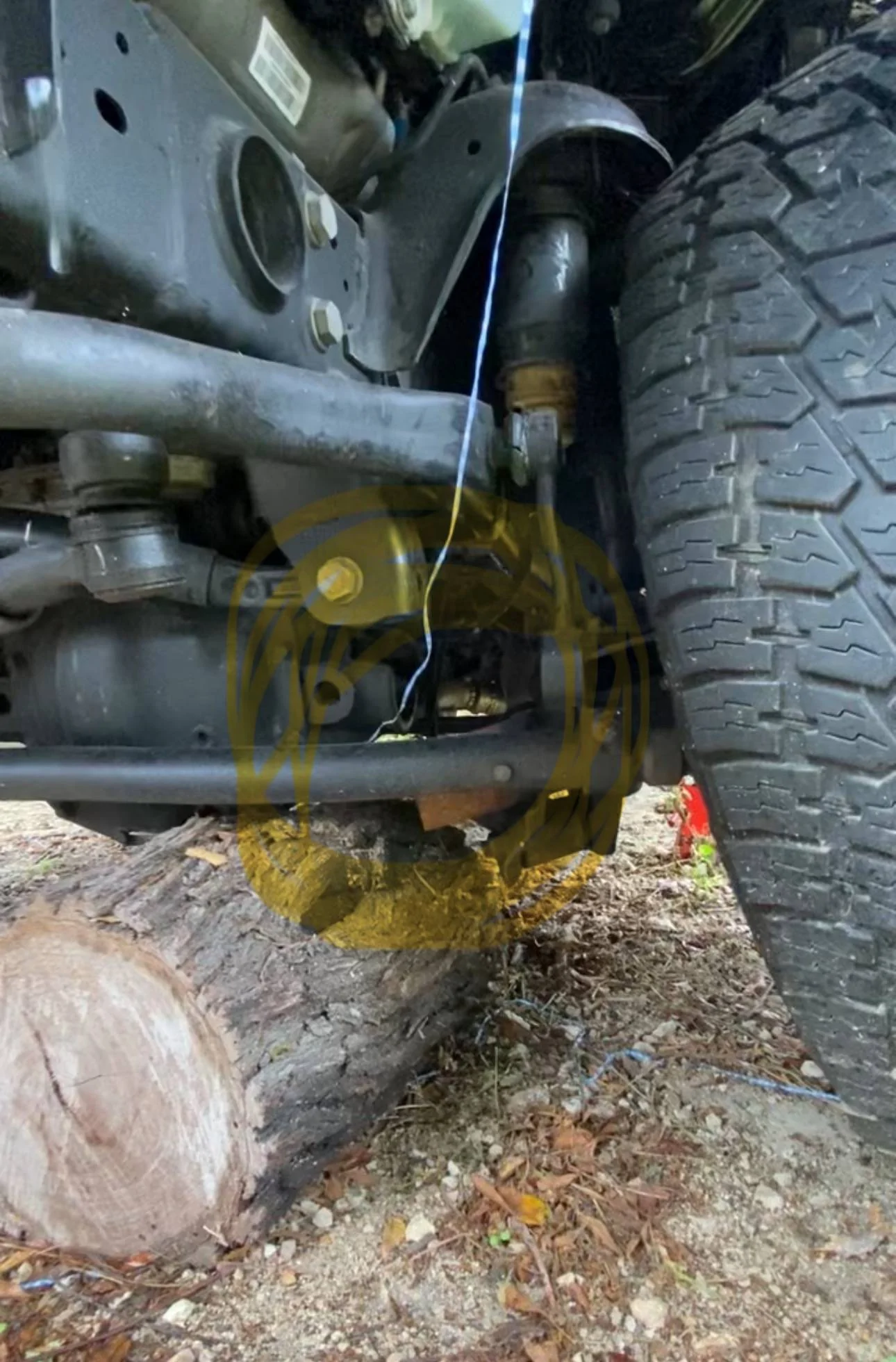

It’s got some damage,
Jeep Gladiator Can I install a front axle with wide track ? IMG_0282
Axle housing itself, or knuckle? (steering knuckle can be replaced)
Just a busted ball joint, or down to the core axle housing?
Can't tell from the pic if it's just the knuckle, ball joints, or the whole housing.
Got hit axle house is broken don’t know what else bent so that’s why I’m looking for a axle more complete the better

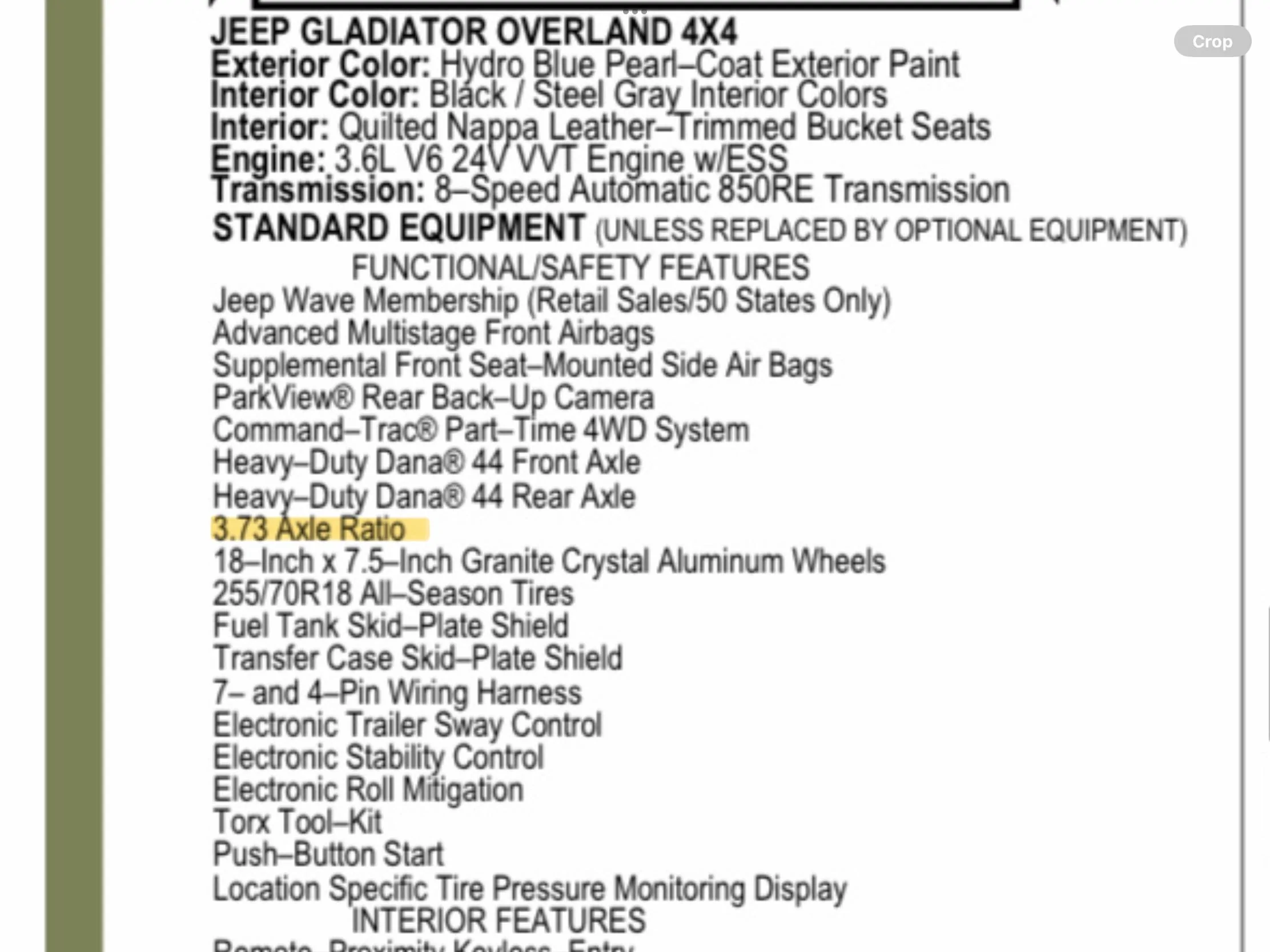

That was posted in 2017, before JT production and at the beginning of JL production - and said "from internal sources" - so were any actually produced?
Here is a window sticker from a 2020 with 3.73.
180
29,634
35,264
Jeep Gladiator Can I install a front axle with wide track ? IMG_0721
That works. Just that we all know what's said on documents doesn't always make it to production due to last minute changes.
Still, the ratio may be the same, but the axle itself isn't the same HD axle as Gladiator gets.
I'd not put a Wrangler axle under my Gladiator. (regardless of ratio)
