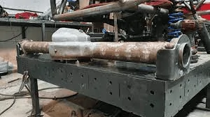

Hello , im looking for a dana 44 oem front wide track axle housing, i have everything else from the components just need a housing mine broke in half

did it break at the FAD?
If so you might be able to get a machine shop to turn a sleeve for you, then you can remove the FAD casting and use the sleeve over the axle tube to make axle whole and weld it.

I believe it did break next to the FAD , do you think i can do that and reinforce the axle on top? The shaft that camed out of that area i checked it and it’s in perfect condition no damage
anything is possible with a lath and a welder, trick is finding someone who can use one.

before they go cutting off the casting they will need to establish a measurement of what the gap is between the 2 axle pieces as if the cast was whole, then when they turn shoulders in the sleeve for the tubes the shoulders distance need to be the same as what the casting was.
I also suspect a jig will be needed to hold the wheel end of the tube at the same angle the cast use to.

a jig is something that can hold a piece in place without moving to preserve a distance or angle or both but still allow you to assemble or disassemble some thing. In you case a jig would be used to preserve the oem castor of the axle tube. A machinist should know what a jig is.
Jeep Gladiator Dana 44 wide front axle 1655355154389
I only mention it because if you don't match the original castor angle you will have poor handling truck.
A jig would need to be made before you cut the FAD housing off.
