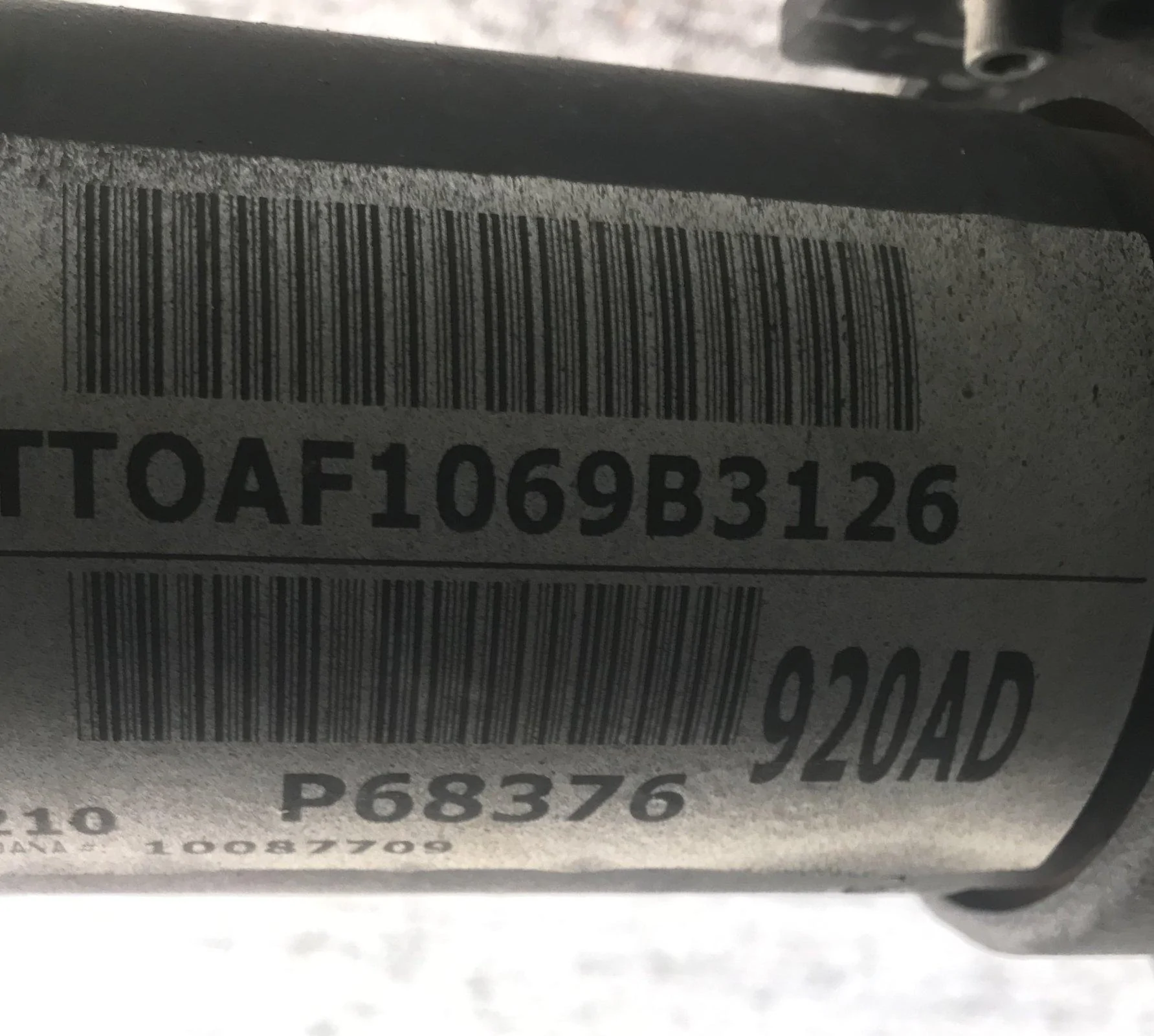

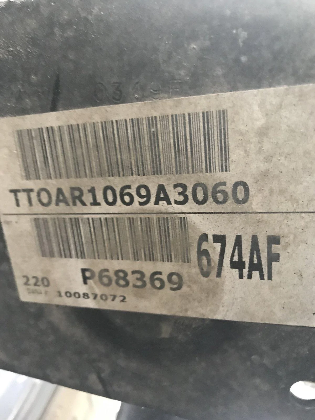

I have a Overland & it has heavyduty brakes & M210/M220 axles all axles have a tag on them check it out.

Jeep Gladiator Dana 44 axle 78ED2089-8228-438A-8842-5C5D3E114783
Jeep Gladiator Dana 44 axle CE87E8E4-61A5-4CFC-BD92-BDB4E7BAC002
Have you measured them?
No but the Rubicon & Max tow have a extra lip on the fender flares, mine doesn’t.
Here’s a picture of my axle tags
