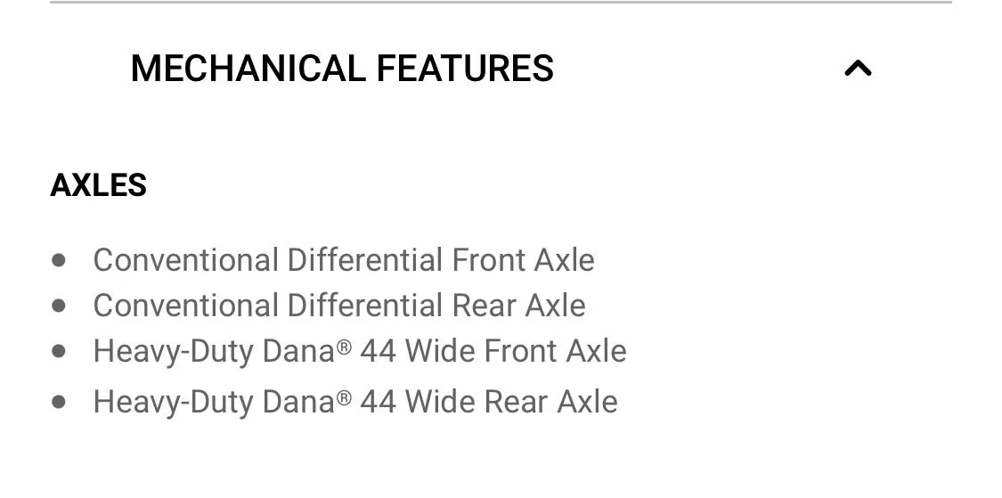

The High Altitude also has wide axels and a diesel option. The extra width is 3/4 on each side, or 1.5 inches total.
Iā€™m curious because Iā€™ve see this stated a few times, but when you look at the specs of the HA it shows a track of 62.9 like the other normal width axles. The Rubicon, Max Tow, and Mojave are the ones that show wider tracks according to Jeeps specs. Now I could see them getting this measurement wrong between the different trims. Iā€™m just curious if it states somewhere that the HA gets the wide axles.
WK2JT
Darren
Mar 11, 2020
662
664
Denver
JTC
Iā€™m curious because Iā€™ve see this stated a few times, but when you look at the specs of the HA it shows a track of 62.9 like the other normal width axles. The Rubicon, Max Tow, and Mojave are the ones that show wider tracks according to Jeeps specs. Now I could see them getting this measurement wrong between the different trims. Iā€™m just curious is it states somewhere that the HA gets the wife axles.
Never mind... I found it under the mechanical specs under the Build It section. Hmm šŸ¤”

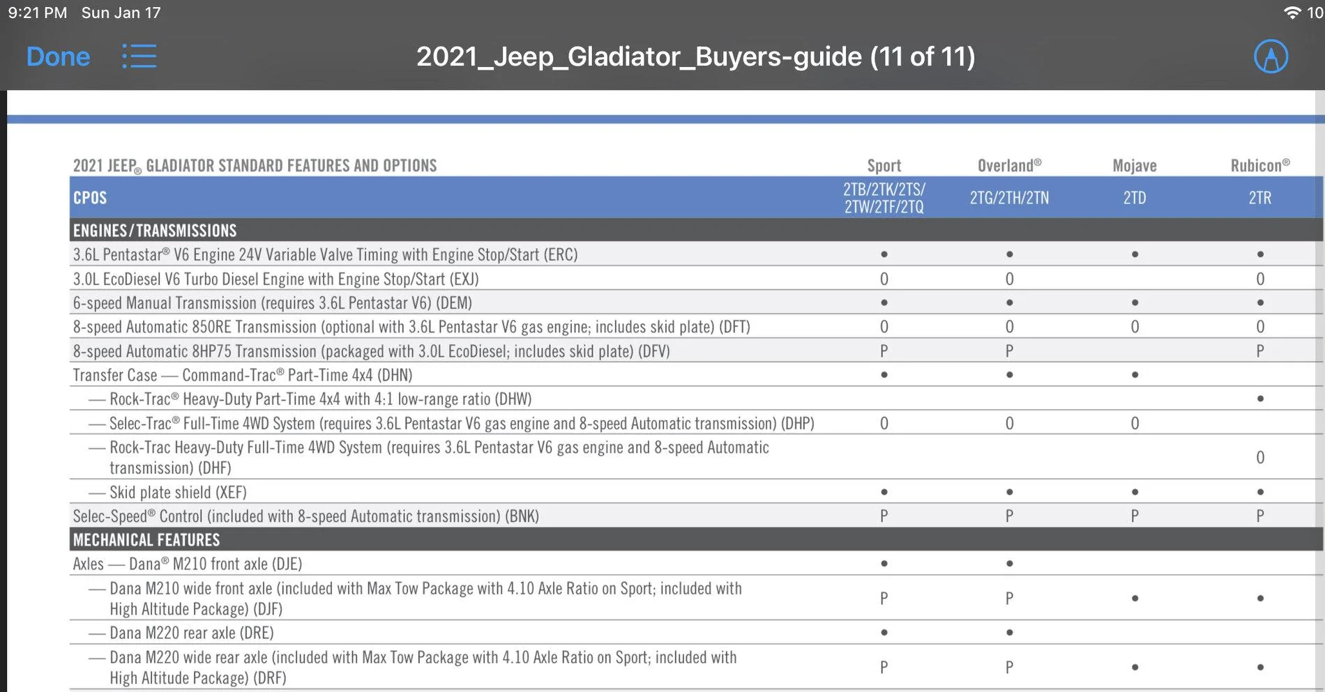

Jeep Gladiator Wide vs Narrow Track Axles 261DF9BF-510A-4C4C-BF0E-3E5EF31FEEAC
It is also in the 2021 Jeep Gladiator Buyerā€™s Guide
