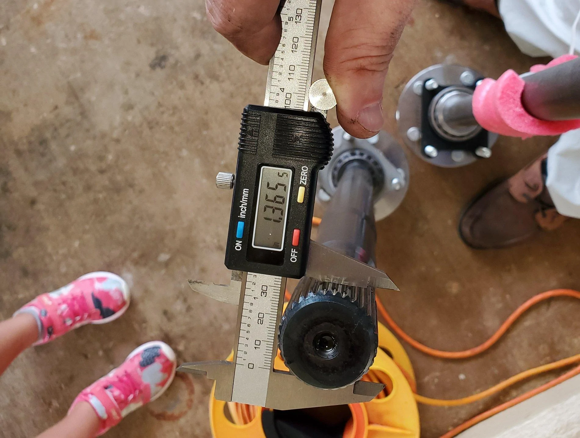

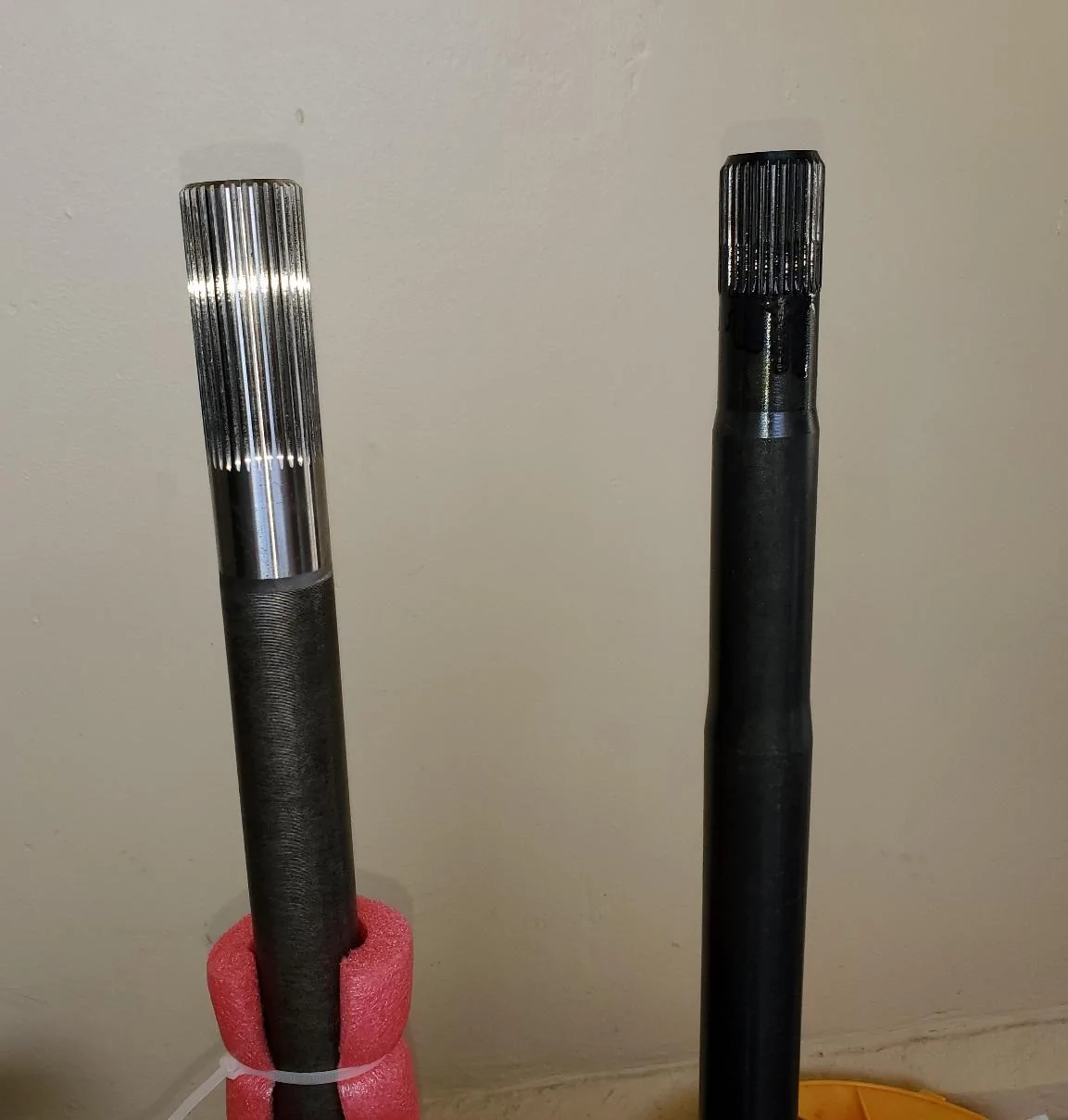

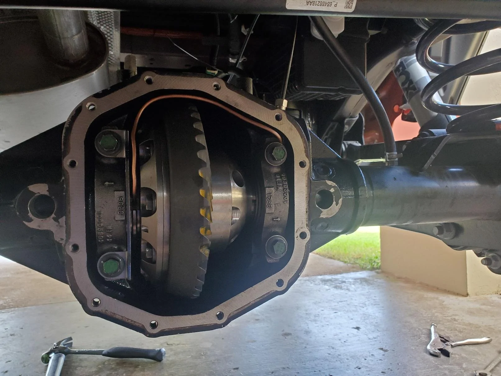

Got some stuff done today.
Should have the build done tomorrow.

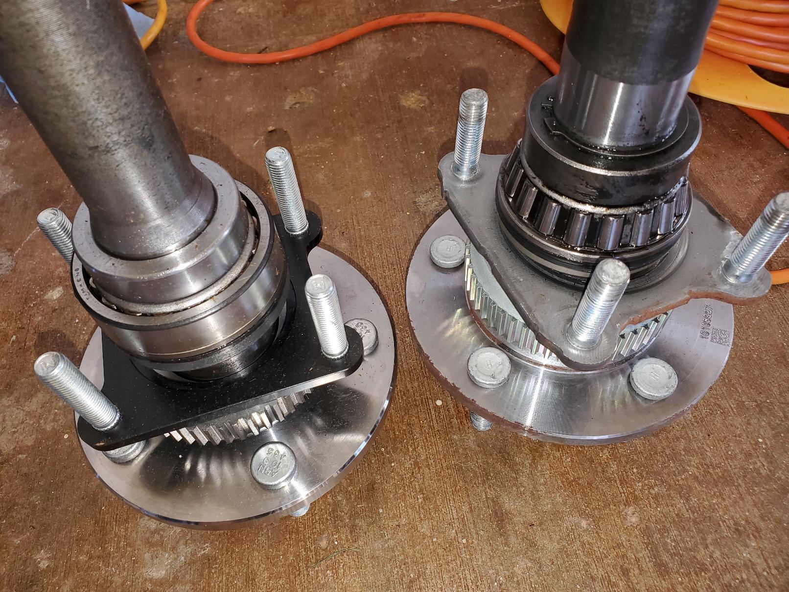

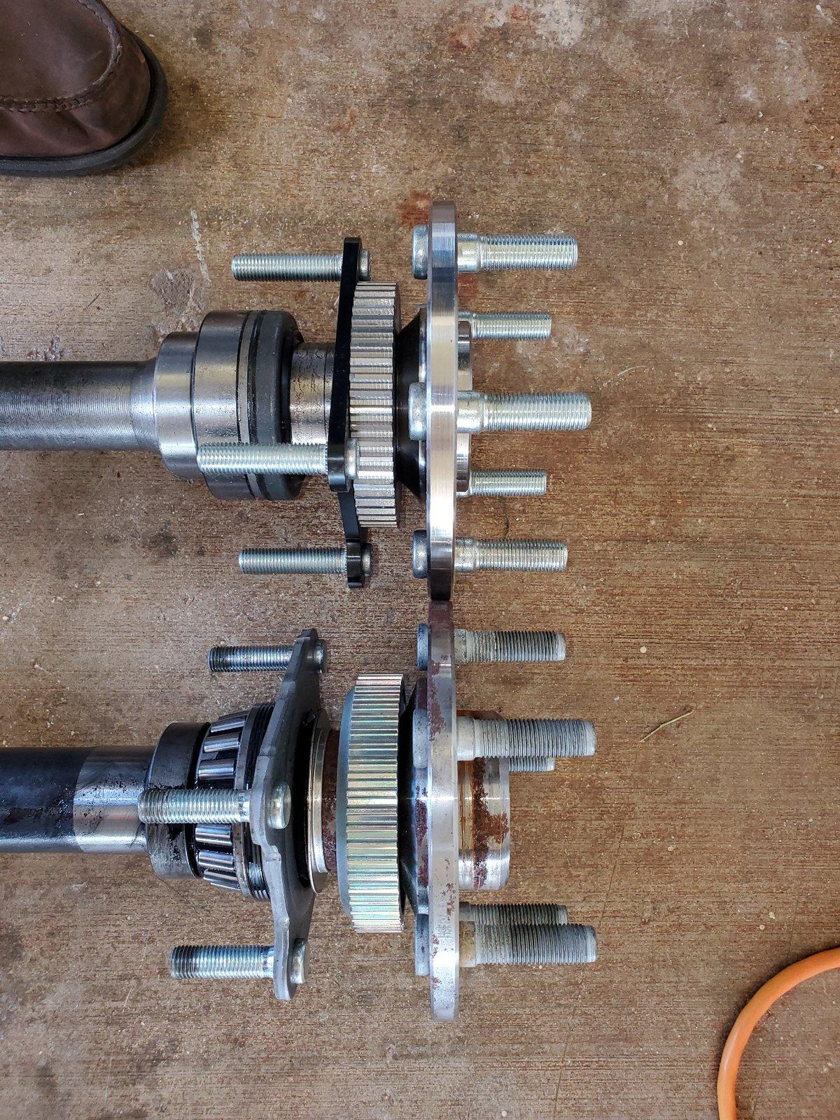

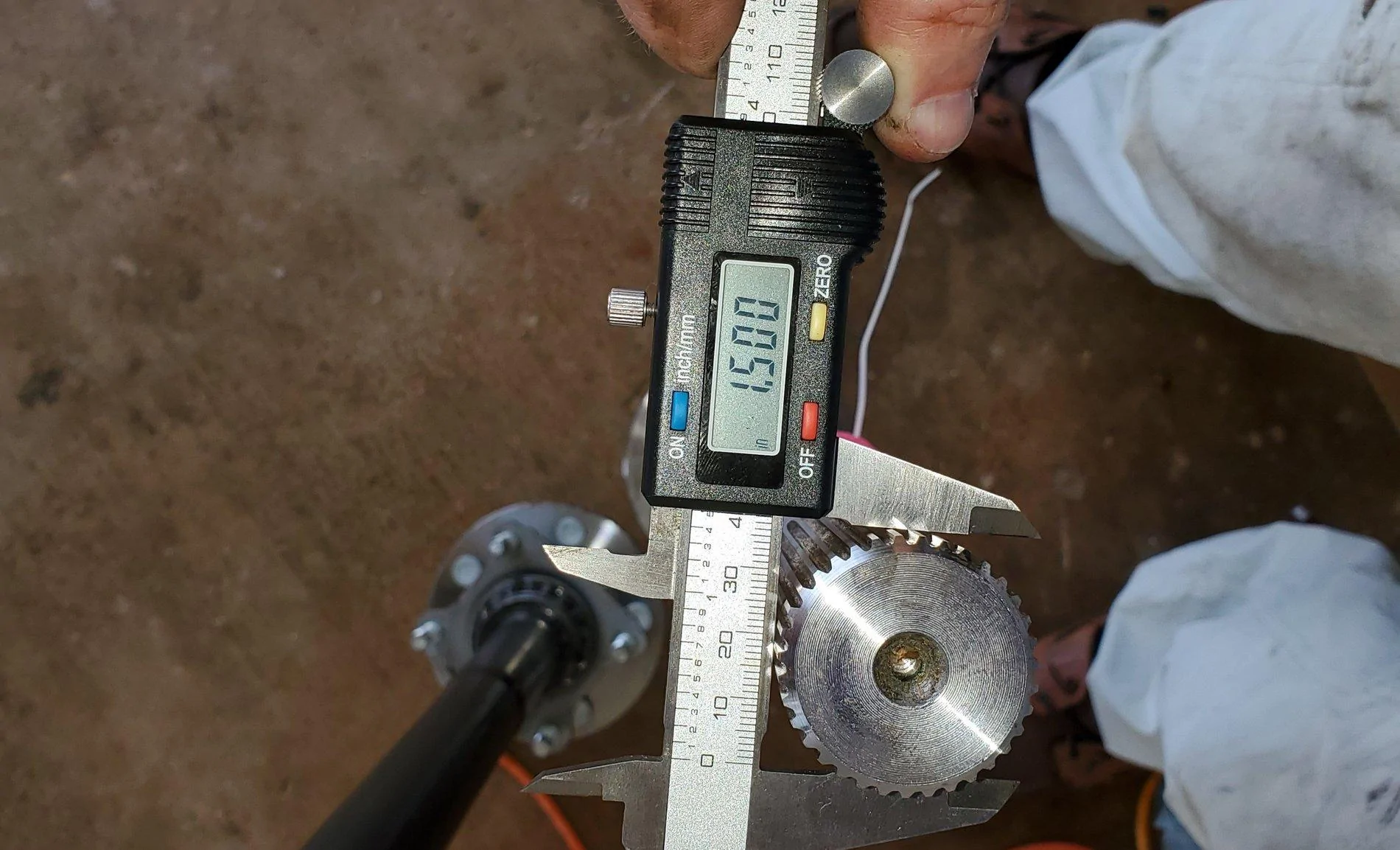

The shaft sizes. Notice the taper down on the stock 32 spline shaft. The 35 spline unit is 1.5 inches and made of case hardened forged 1541H steel. Should be the last thing i have to buy ever concerning axles.
Also note the set 10 bearings at the ends of the axle.
The rear axle is very strong. The tubes are huge. My sport is now a super sport. Lol

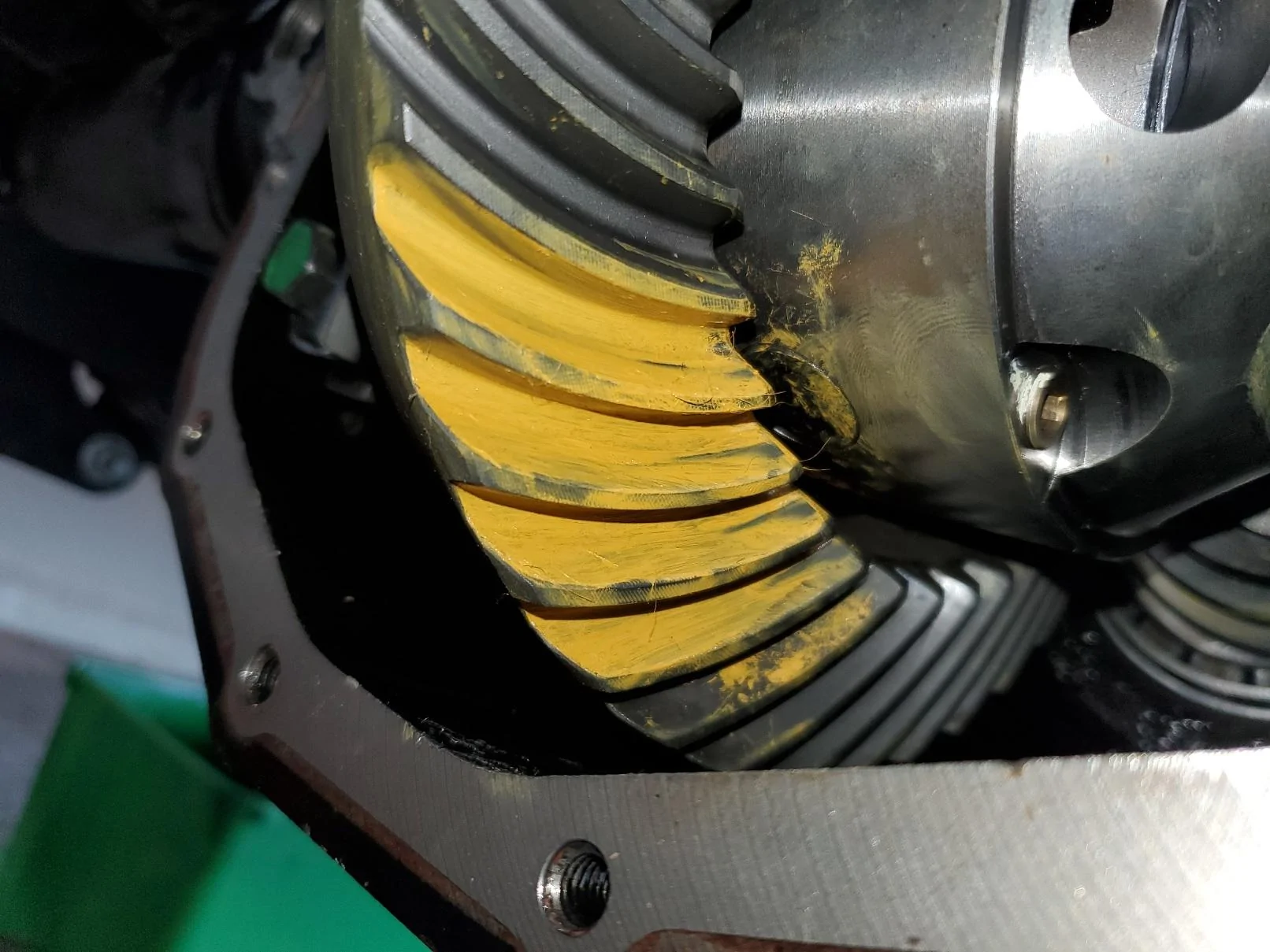

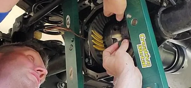

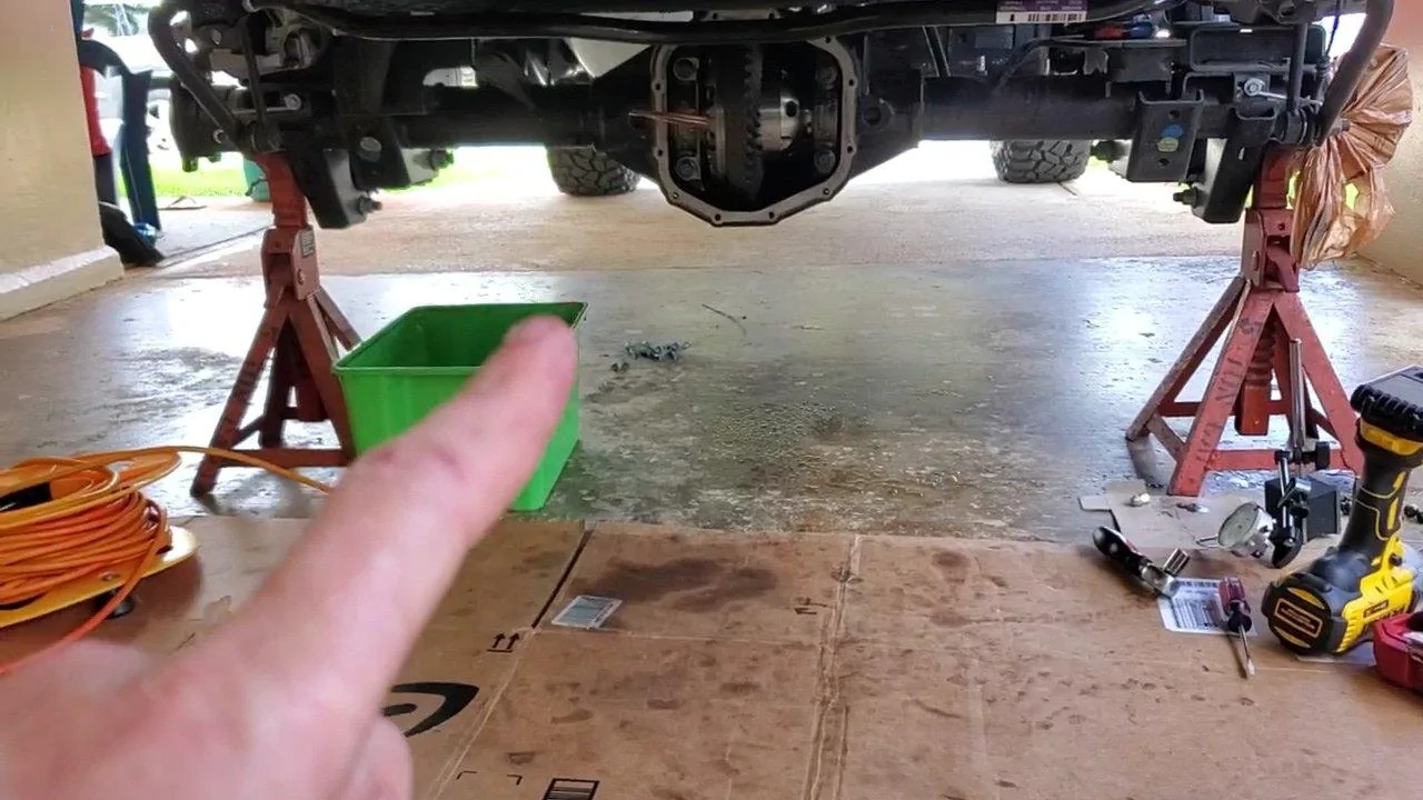

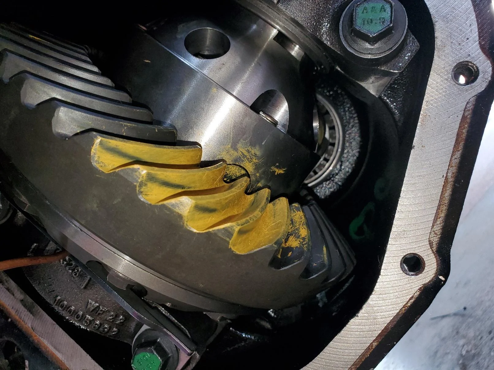

Spent 3 hours today setting up gears. Changed backlash about 10 times and currently on my third pull of the pinion. Changing gears and diffs is not for the faint of heart. The front was a breeze. This rear dana 44 is a bear. Lol. The pinions were off by .050 thou. I am now at about .030 thou to split the difference. Should be done tomorrow. Gear pattern currently is off the end, will have it centered tomorrow.

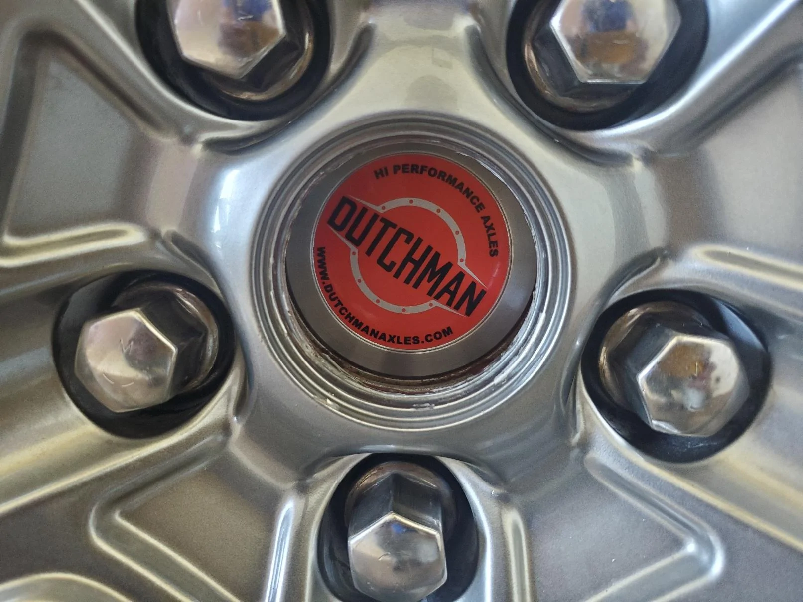

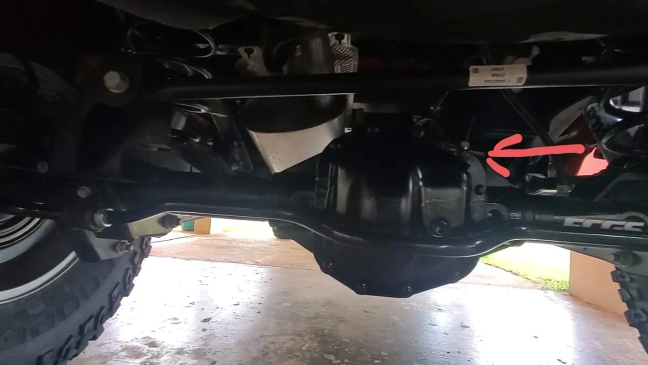

Looks so clean. I assembled and painted the axle. There is a little Easter egg of the axles by dutchman 35 spline super 44 behind the hub cap.
Finally the only thing you see is a stealthy east coast gear supply sticker and the fitting for the arb hose. This thing is sick.
