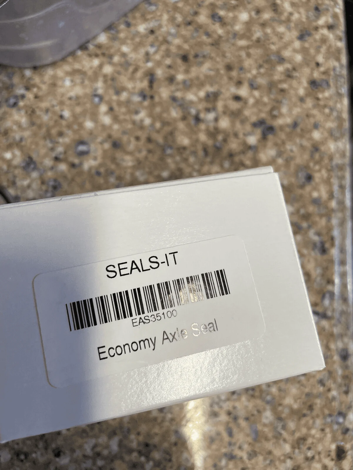

Do you have a part number?
CAll SealsIt. Tell them you are doing the 35 spline RCV on a gladiator. They were great to work with. Here is the box from a previous post in this thread.
itS been almost a year since my install. I was under the front this week and still no axle seal leaks.
Is the 32 spline what comes stock in the rubicon? What’s the benefit of the 35 over 32? Sorry I’m new to this.
If you are doing the 32 spline, i'm fairly certain that the factory seals will work. 35 is a larger/stronger axle shaft, more teeth in contact in the carrier. to use the 35 spline you have to replace everything inside the pumpkin too.
Deleted member 22728
This.
