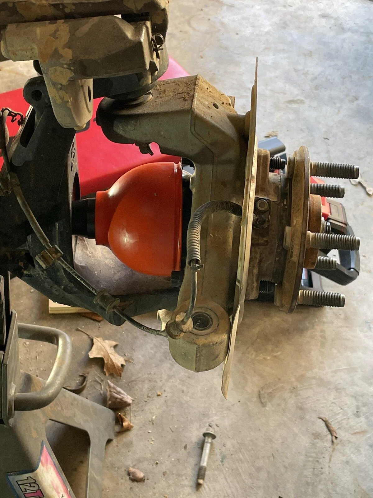

As of now, RCV is overnighting a set of seals. We’ll see tomorrow I guess.
When this is all over I’ll have a parts list for anyone following me on this adventure.

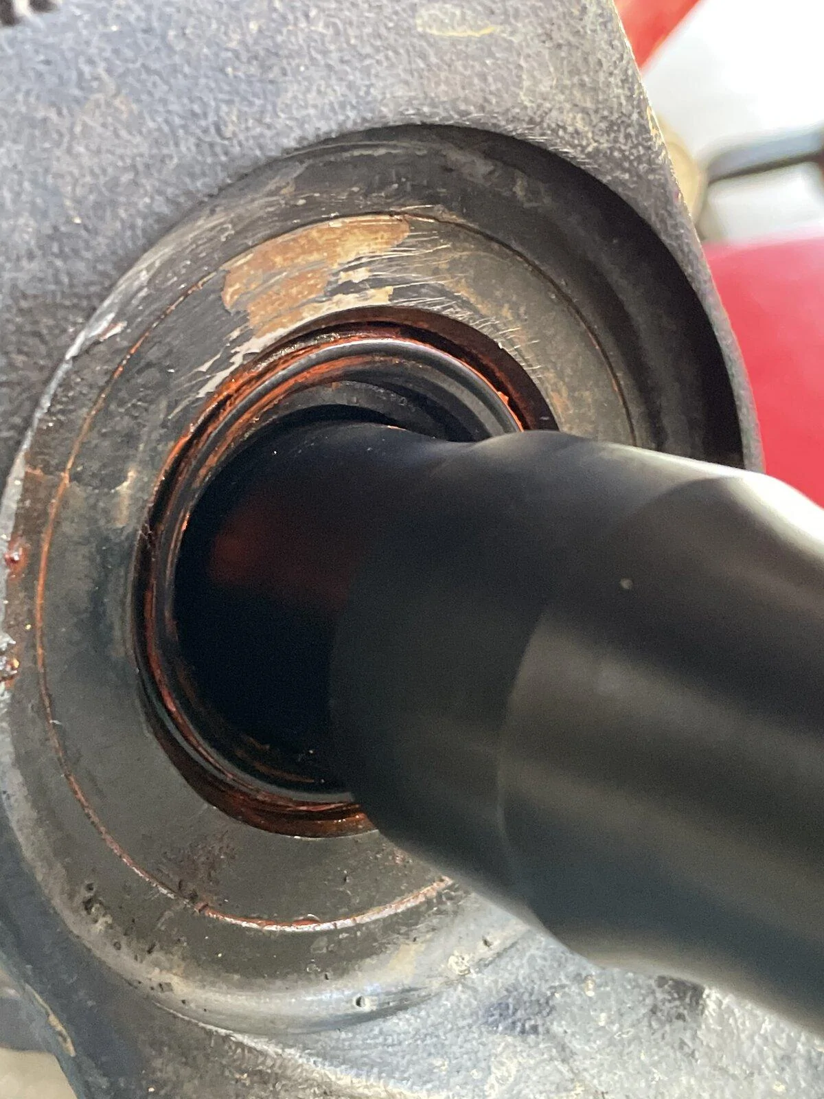

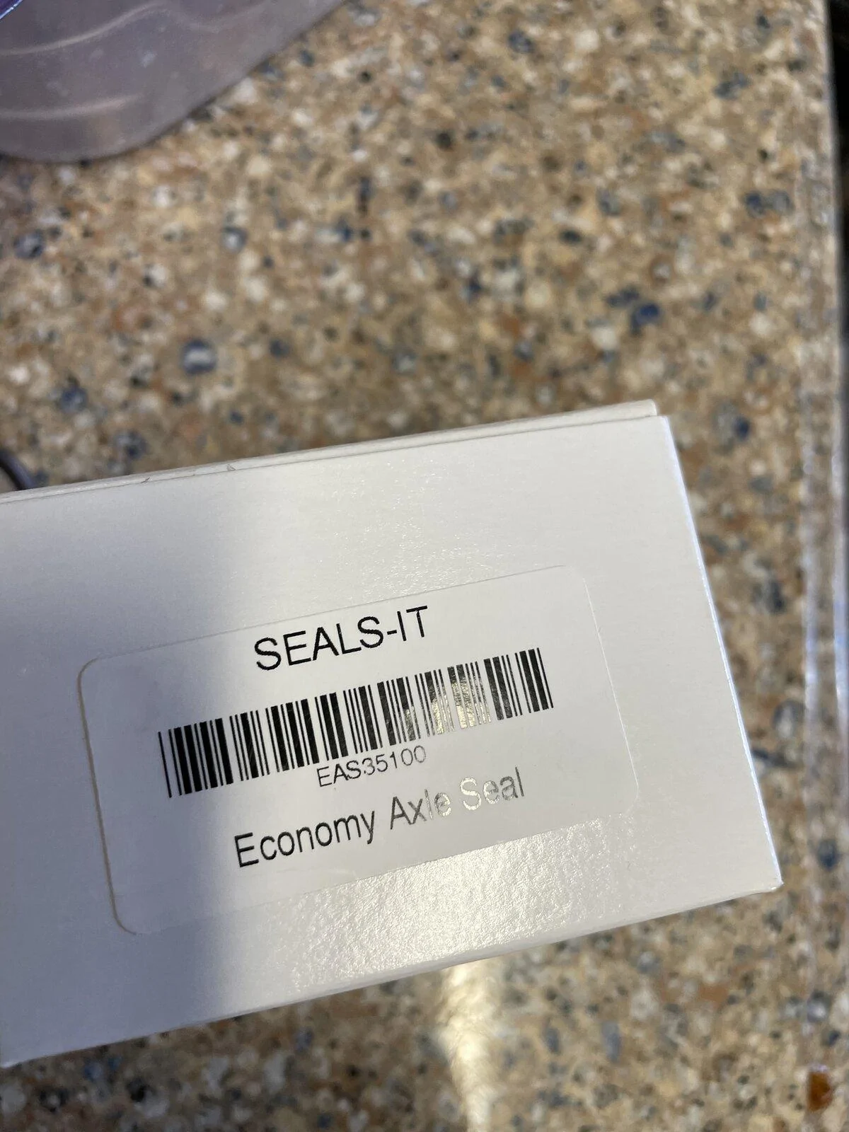

Well, ran buy the kinda local Yukon warehouse today. Grabbed seals that were as close as we could find and they don’t fit...
reached out to SealsIt and ordered another set late today. They’ll ship out on Monday to be here Tuesday.
When I finally find the correct ones I’ll post the part numbers and links for any who are wanting to do this same thing.

you bet! Let me know if you have any questions during install. Was pretty easy after finding the seals.
