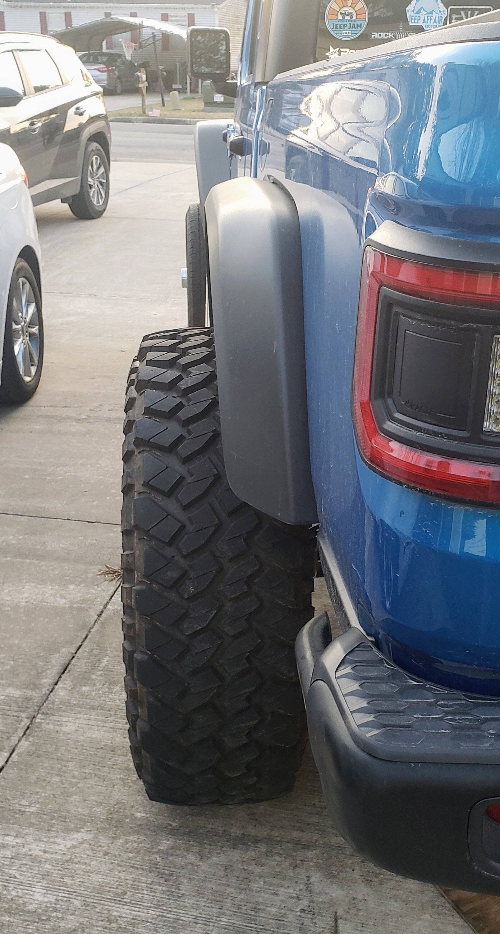

This is before I centered the rear axle but pretty close to how far tires stick out now.

17x8.5 0 offset KMC grenade beadlocks.
Nice. I'll have to give a look to see how those would compare to what I'd like to get. I'm thinking I may not be able to run the desired wheel and will have to get something else since the desired wheel is 3.5 backspace.

Should be about 1/4" more tire poke with 3.5" backspace and 70" axles. Most of the 3.5" backspace wheels are also 9" wide.
Exactly. I may just have to change my wheel preference and find something 4.5".
