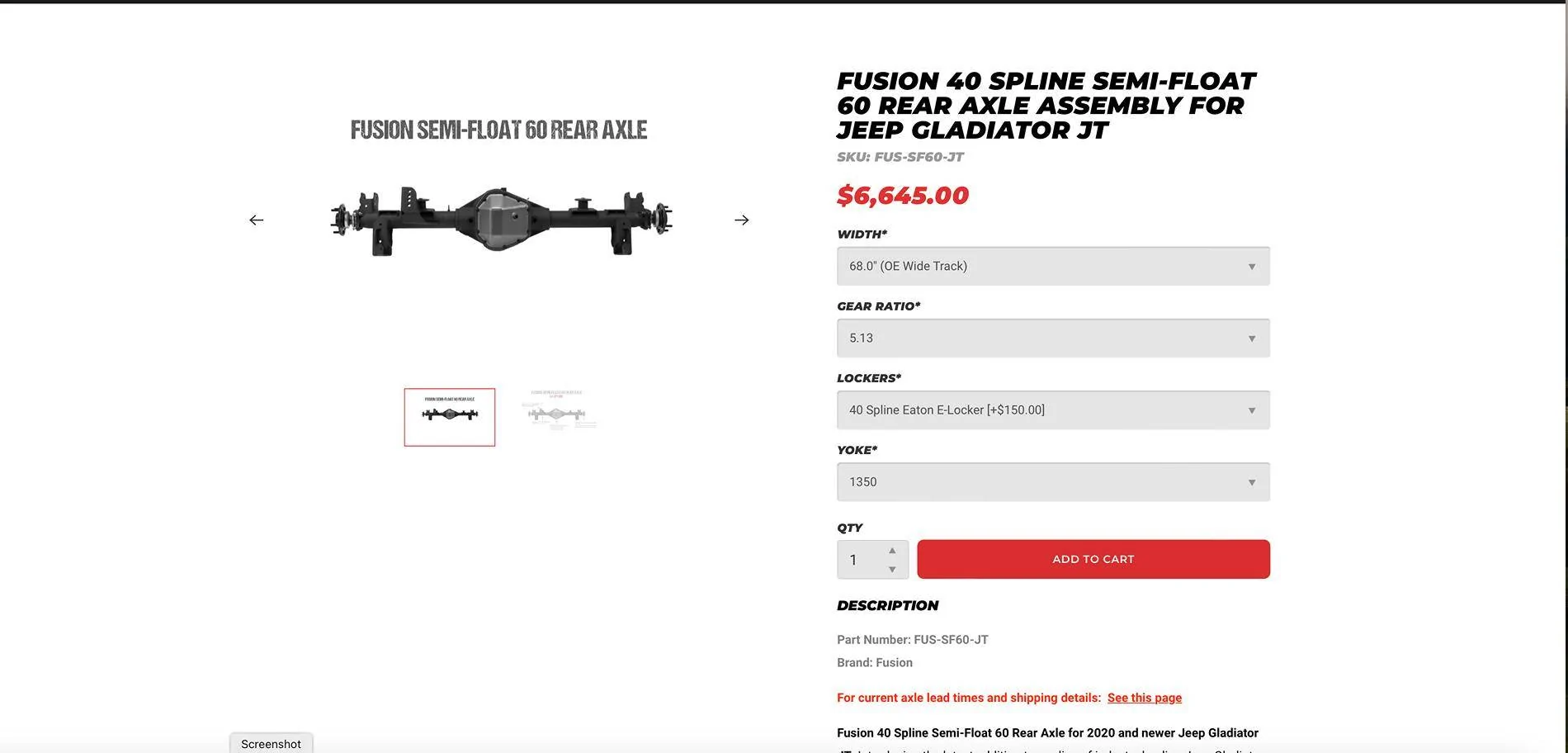

Thanks. I'm not seeing a rear Fusion D44 - just a front. I'm guessing no one wants to compete with re gear shops. The Fusion price - $6700 is the best I've seen and I might end up going this way - still need a new drive shaft so looking at Probably $8k
For the rears they don't have a 44. Guess the market for a built rear 44 isn't that big.
Semi float is going to be weaker than an equivalent full floater but it's hard to justify the price jump to full float for many people.
Agreed. A weak 60 is pretty strong. The big hit for the axles, drive shaft, and new wheels with full floaters doesn’t seem worth it for regular people on a realistic budget, like me doing mild trails, camping, hunting, daily driver.
