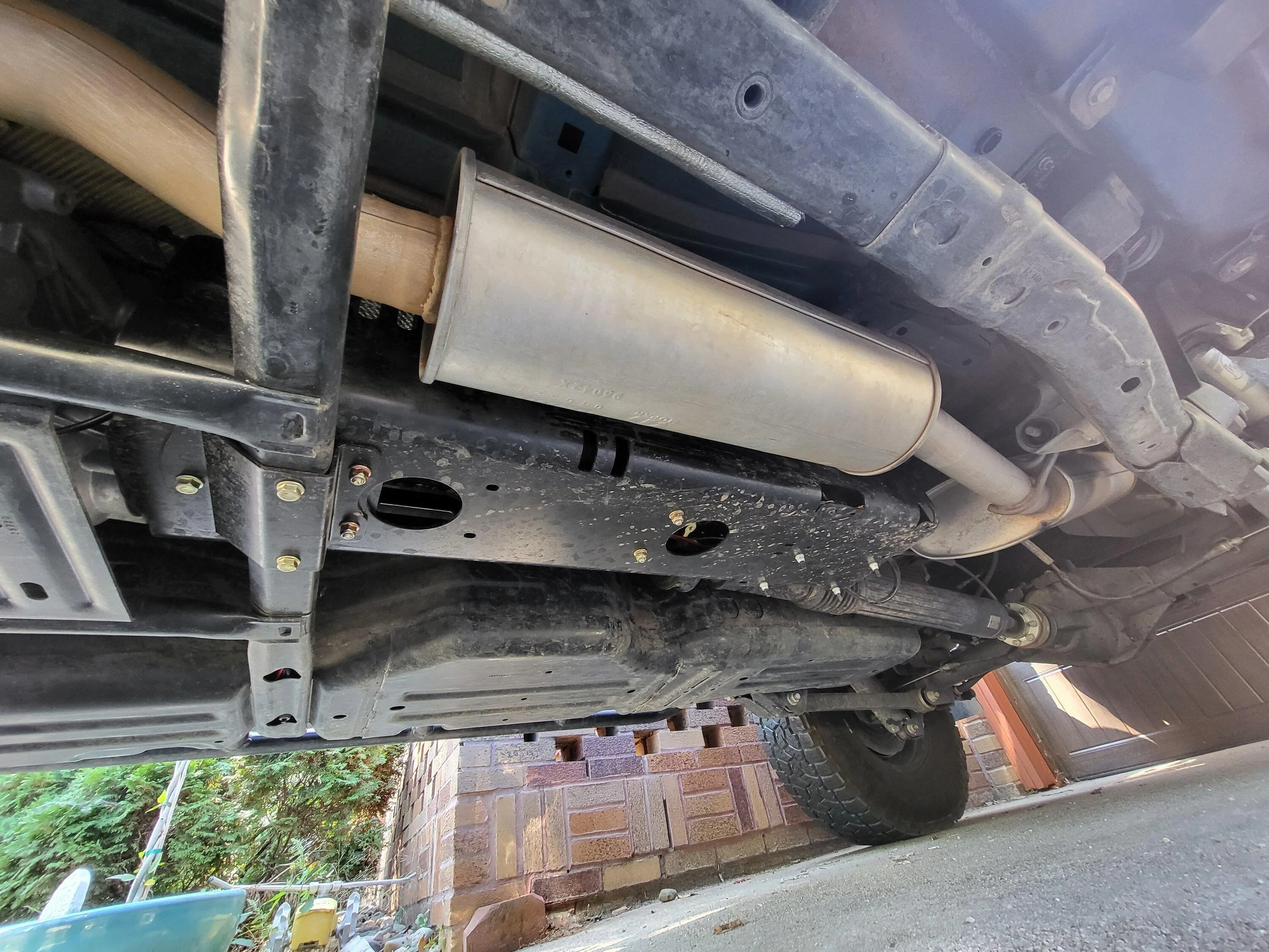

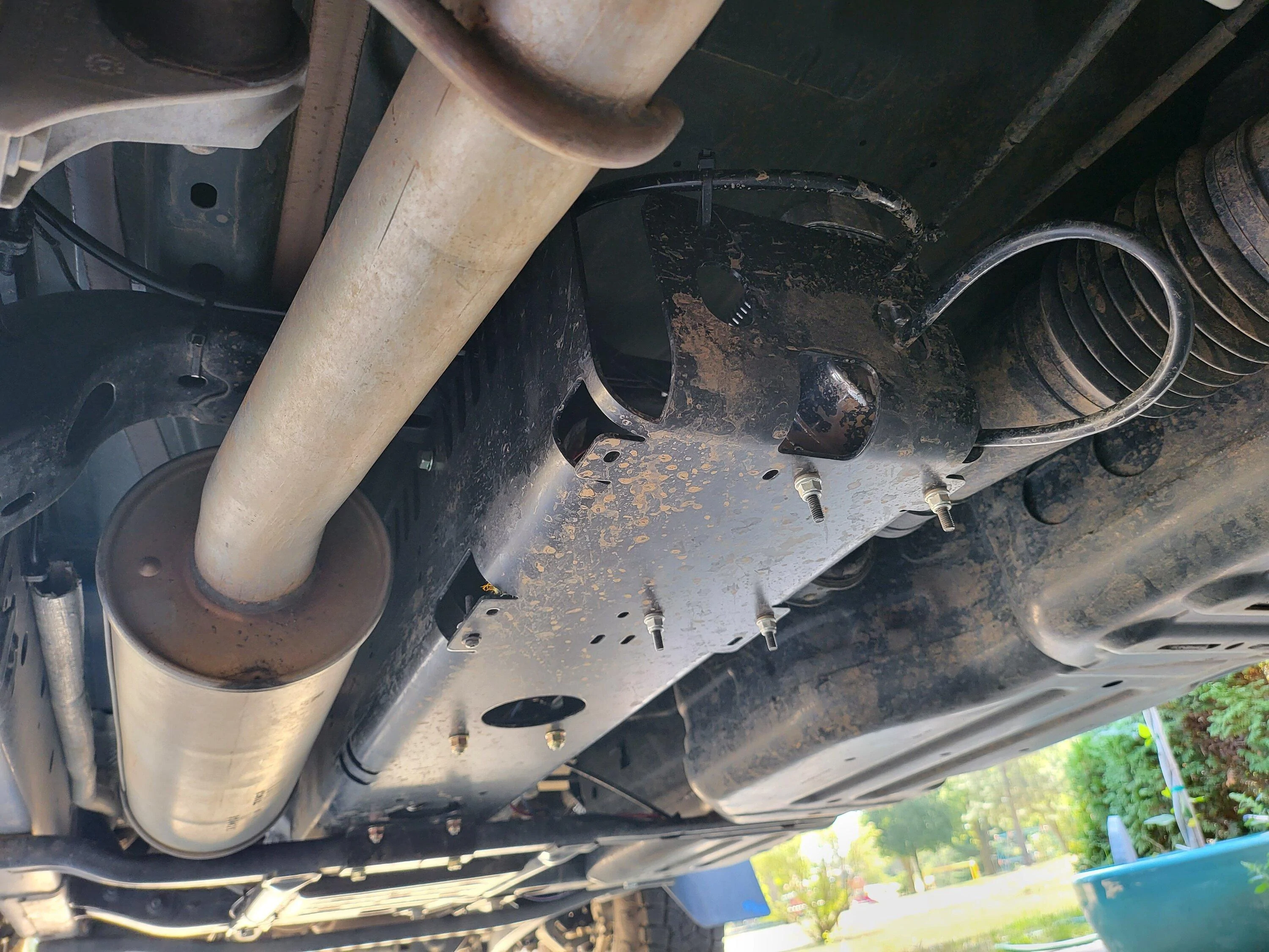

Did you fabricate that skid plate for your compressor or did you purchase online from a retailer? I have the same setup but have my compressor exposed which makes me a bit nervous at times.
Here you go, it sits right between the exhaust and driveshaft.
Cruizer8
Cruizer8
Ian
May 7, 2019
133
153
Northeast Nebraska
'21 Gladiator Freedom Edition, 1983 Postal Jeep
I bought it from Maximus 3. They have a really good option here
