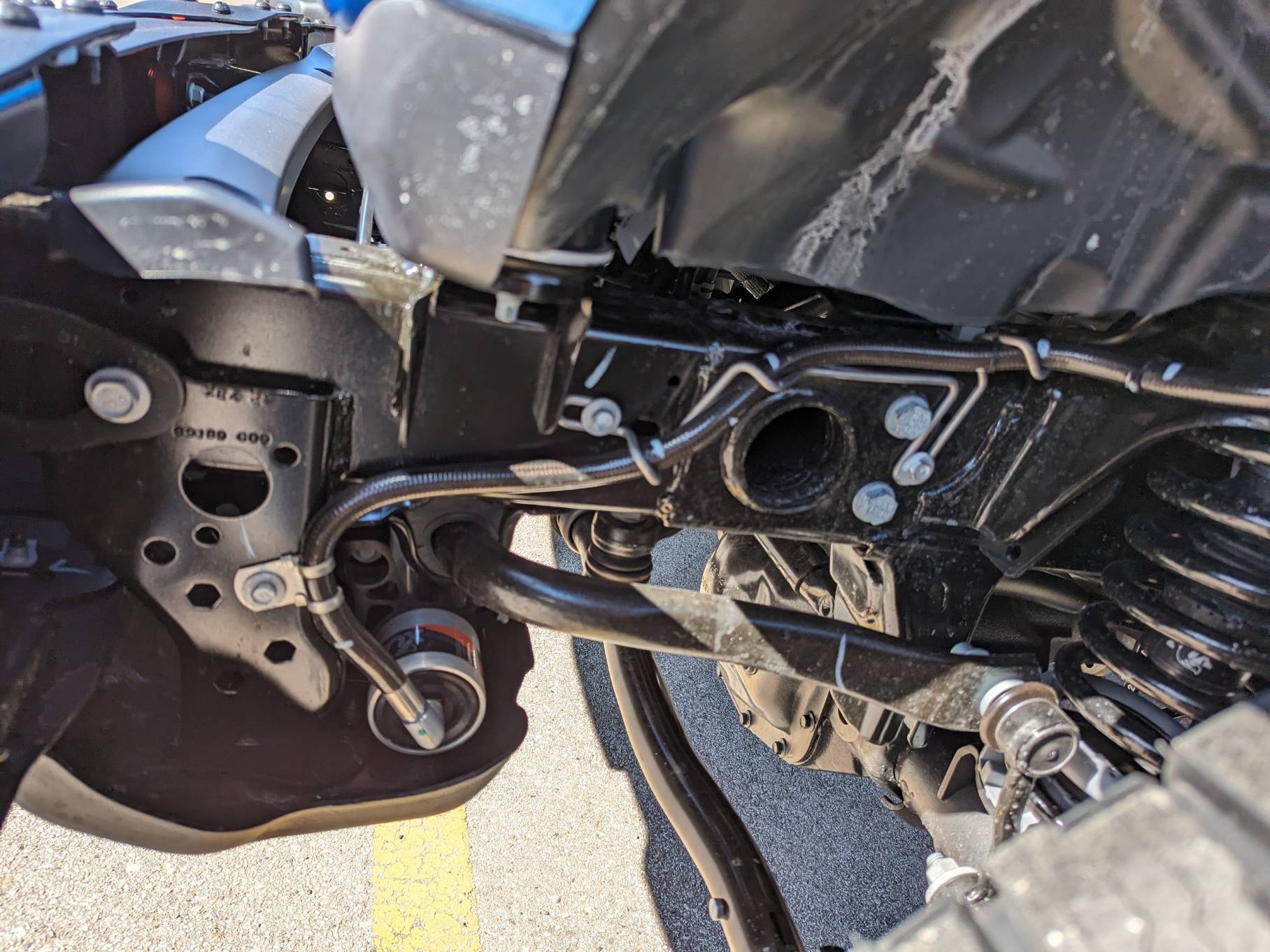

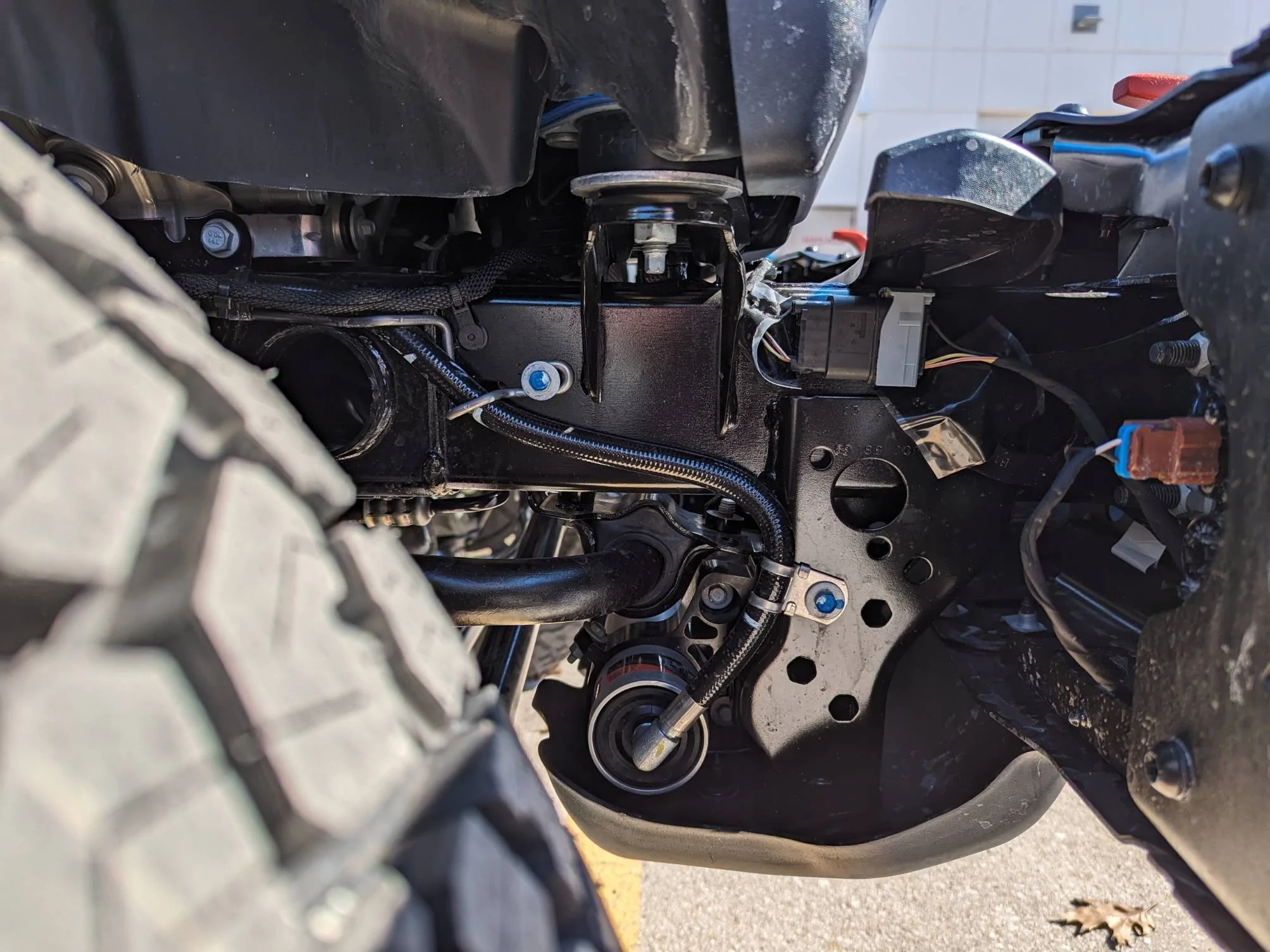

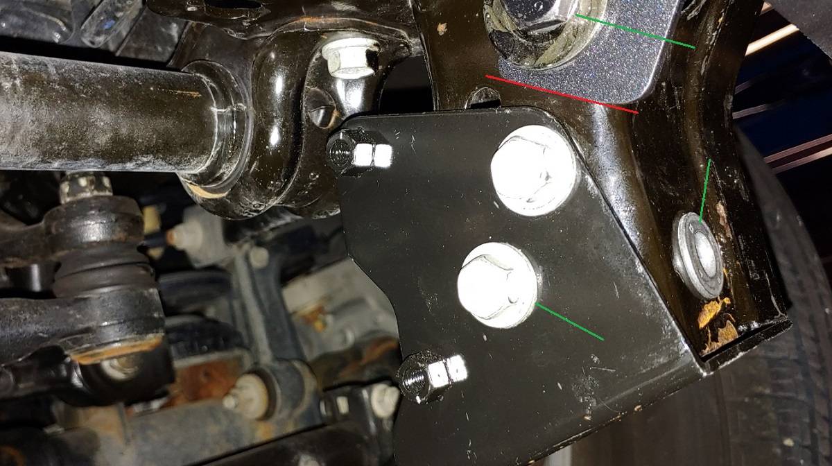

Looks to me like the Rubicon type skid plate that bolts to frame brackets and the bottom edge of the bumper works just fine on Mojave - the skid plate brackets bolt to the inside of the frame.
Skid plate bracket - bolts to inside of frame using these two silver bolts and rivnuts -

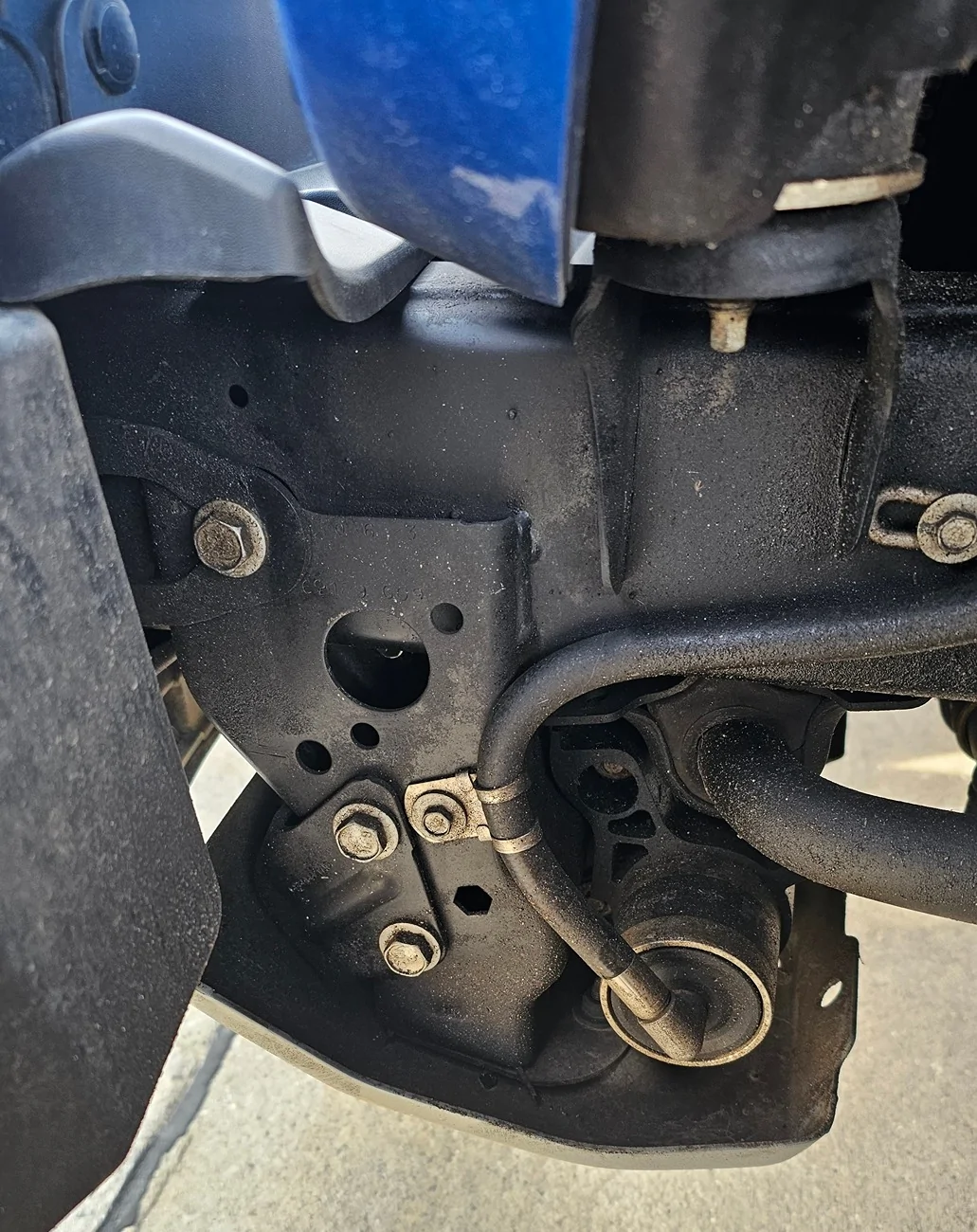

My '23 Mojave has the bracket on the outside. They must have changed in later years. Unless it's a Mojave X thing, but I thought they had the same front plate.
