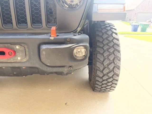

Mine came with the LED light group And the sissy plastic bumper. I scored a Rubicon hard rock bumper off FB marketplace for $140 and picked up adapters on Amazon for $20. Score…

What adapters?

What adapters?
4 inch Fog Light Mount Bracket, AUXMART 4" LED Fog Light Mounting Adapter Compatible with Jeep Wrangler 2013 2014 2015 2016 2017 2018, Hard Rock, Rubicon X,10th Anniversary Editions https://a.co/d/fhZnCW5
I had to widen the holes for adjustment room on the lights but otherwise the fit was perfect.

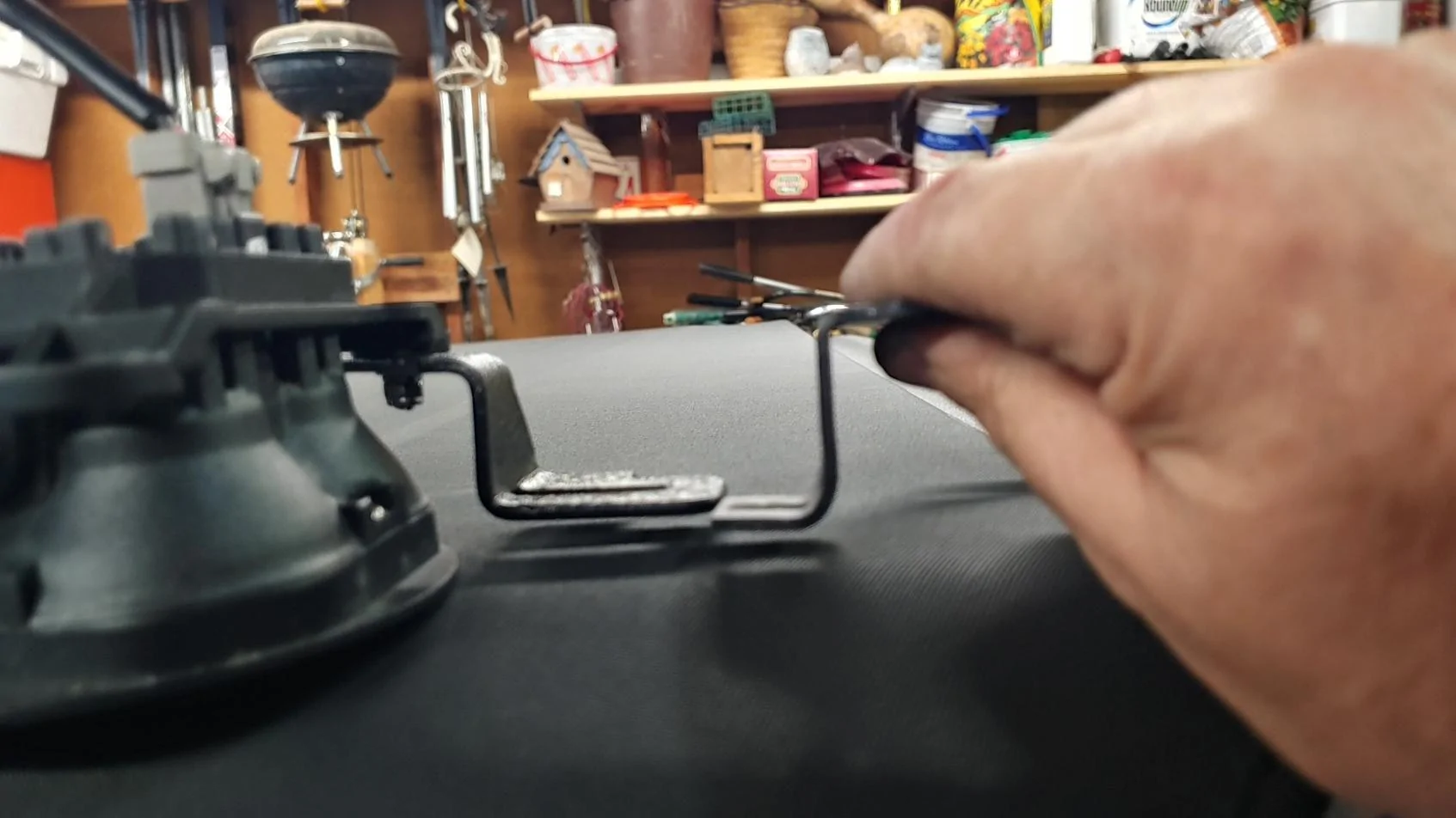

I bought those adapters and they were crap, no fit. They weren't deep enough and the lights were shoved against the bumper hard before the bracket would touch. .
I bought them a couple of months before I needed them so I couldn't send them back. I ended up using the adapters that came with my eBay bumper.
This is a heck of a difference.
Interesting. My bumper is off a 2013 Rubicon Hard Rock so it’s possible the internal dimensions are different. The LED lights off my 2022 fit perfectly with these adapters.
