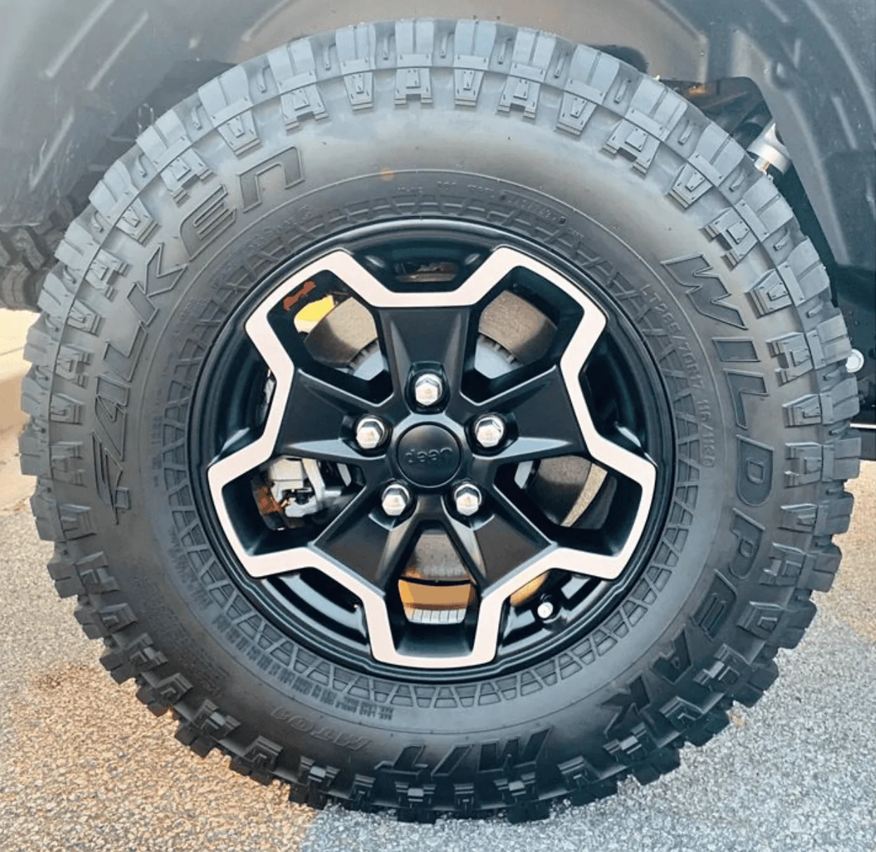

A somewhat local seller has some Rubicon take offs pictured below. I'm not a huge fan of the stock Overland rims and looking for alternatives. These seem decently priced and wanted to confirm they would fit the stock Overland? I think so, but not 100% sure.
33” Falken Widepeak M/T (285/70R/17) is listed size.

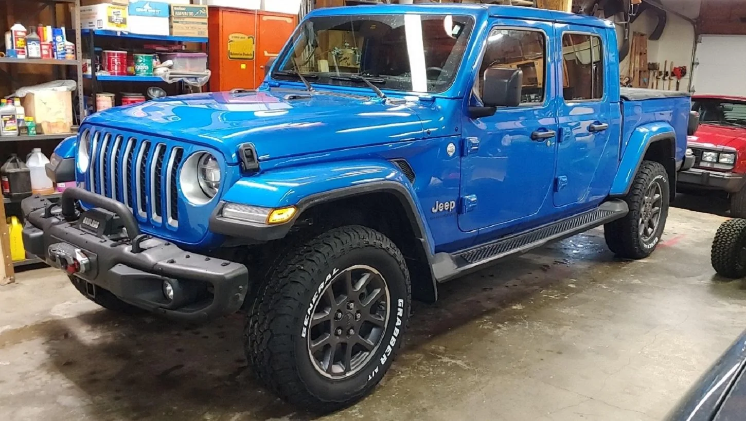

No problem, I ran them on mine until I sold them a week ago.

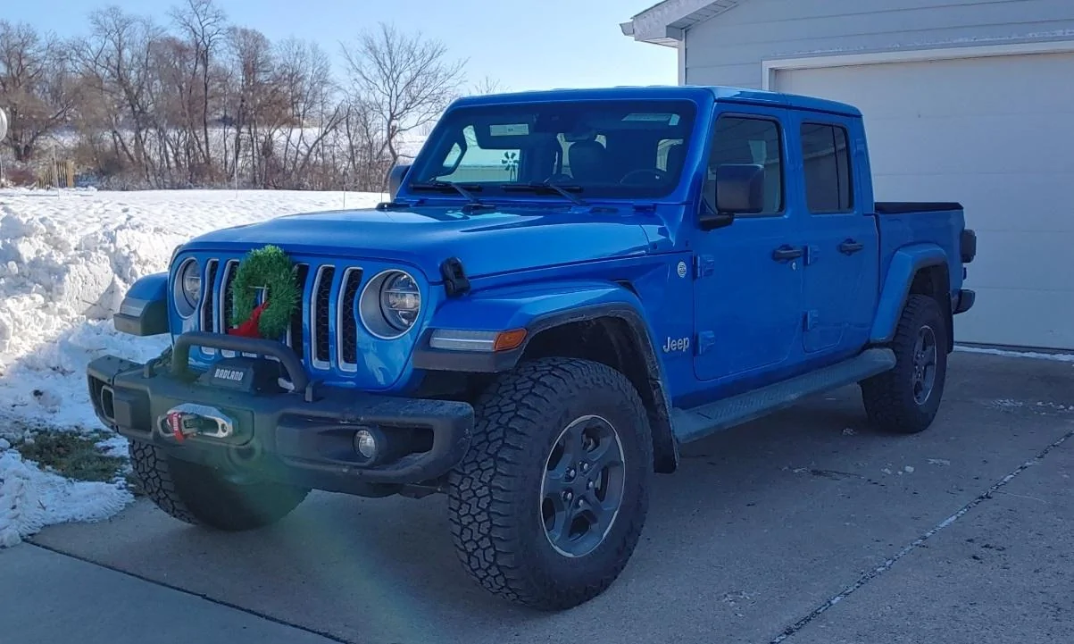

I ran the Falken A/T rubicon wheels and tires for 2 winters. Mine is an Overland.
The A/T tires are about 32.7 inch diameter (32.8" by some sites. Falken Wildpeak A/T3W 285/70R17
Keep in mind the M/T tires will make more noise and you will lose MPG- I dropped a couple of MPG with the A/T, I'd expect the M/T to drop at least that much compared to the stock Overland tire. I went with A/T for Iowa winters and our stormy weather.
I have since gone back to the wheels I like better - with new tires.

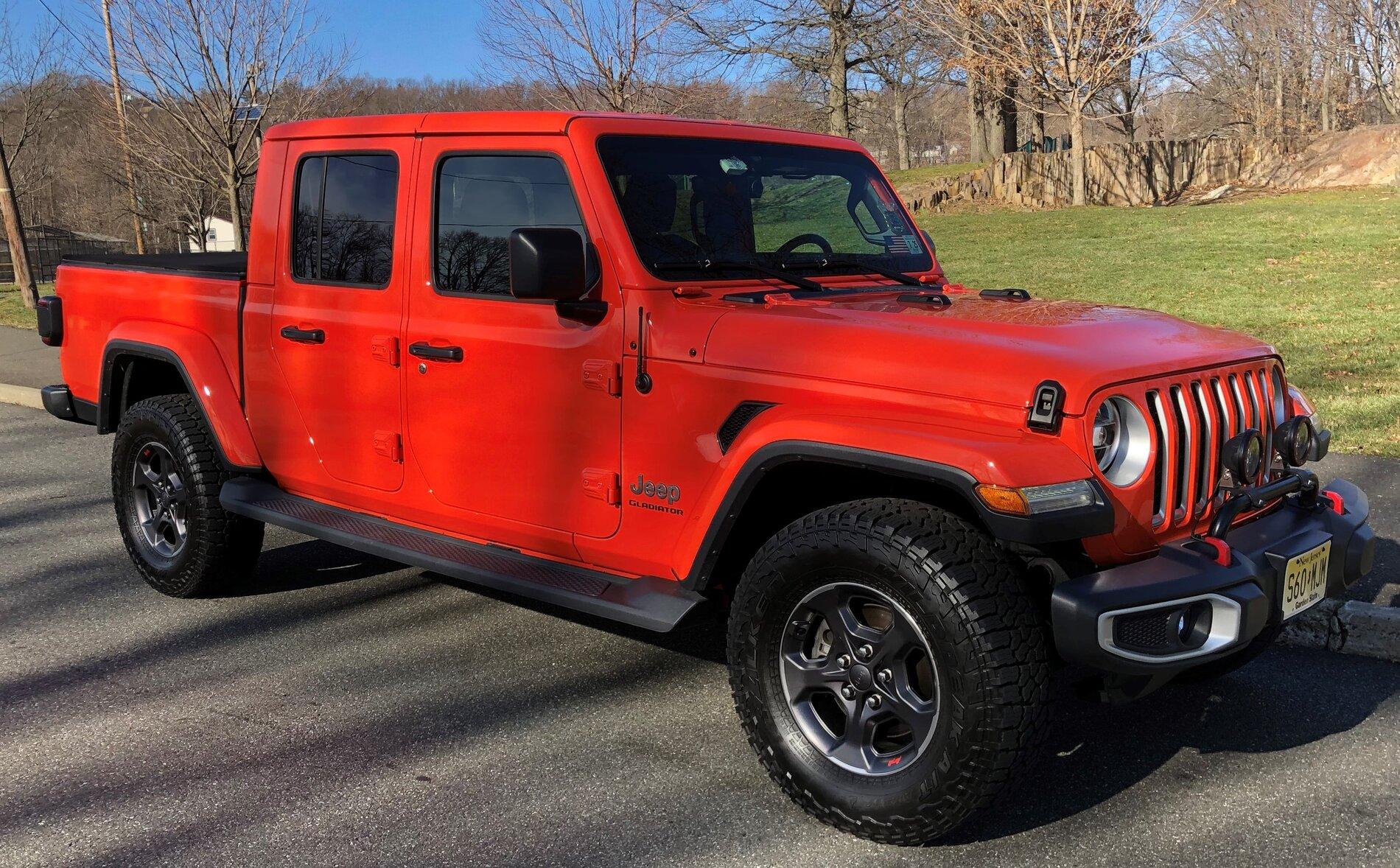

Yup Rubi take-offs with Falken M/Ts work just fine on the Overland.

They will fit no problem but what is the price? You have many options.
