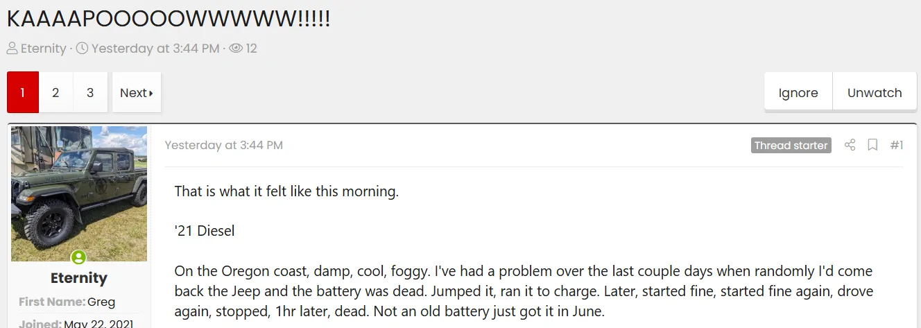

Everyone is focused on the batteries and I suppose missing my posts.
Rather than arguing over the batteries, which cranked the engine a good 5 times after the whole scenario started. Kaapppooww was my Batman reference as to how this hit me...not the sound it made. Perhaps nobody is old enough to recall seeing those words in bold flash across the TV screen.
Please, would you all consider the possibility that my new conclusion is perhaps correct and fits everything I stated at the start:
Diesel Gladiator '21 has a RECALL on the fuel pump. According to the recall, it can suddenly die causing the engine to stop and possible loss of control...therefore a recall.
The electronics on my car did not die when driving. The engine has a slight "bump" with the sound....which if the fuel pump suddenly broken, could be an interruption in fuel and hiccup in the power I felt. Then a few seconds later, it sputtered...as if being fuel starved, not a sudden loss of power.
Perhaps we could have the conversation consider if this is a reasonable explanation for everything I experienced and the battery was just secondary to my trying to get it to start after dying in the middle of the road.
Finally, I've driven this many times down to a gallon without a problem. This was a straight and level road in a small town, no accelerating or braking, cruising at about 30mph gently to the gas station a few more blocks away. This scenario was so shocking and unexpected that it felt like Kaapppooowww!!! Right in the kisser.
