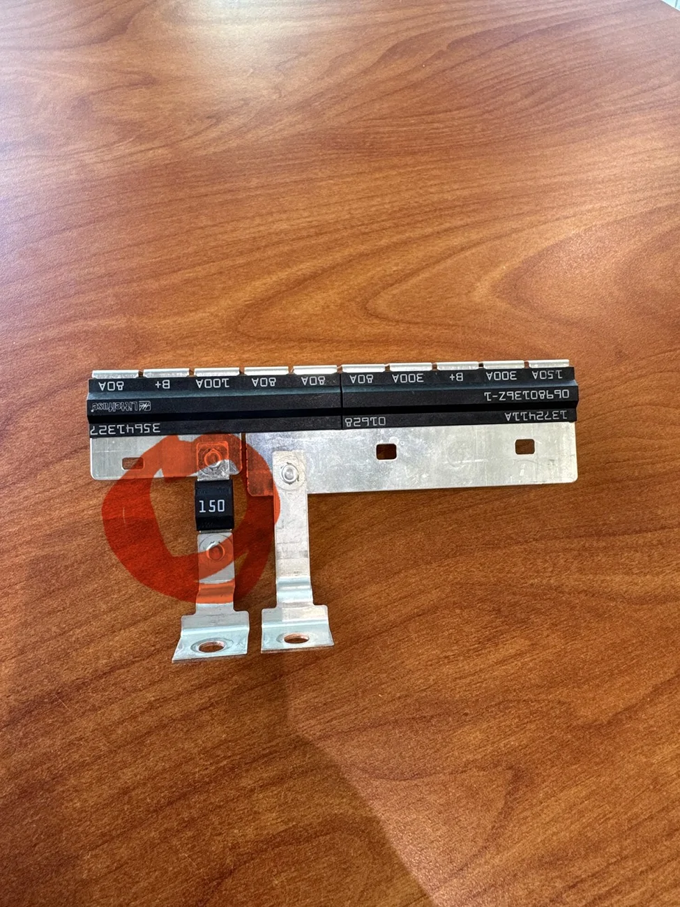

Using tazer does not take second battery out of the loop just turns off ess, Sounds like you blew the maxi fuse array at the end of the fuse box using the small battery as a jumper
Dealer jumped my ram day i bought it, they blew the circled fuse and it ran on the small battery only, then when voltage dropped all hell broke lose on the dash..... a multi meter will tell you if the fuse is bad and if it isolated the big battery.... these are avaiable on Amazon or parts stores
N3 is a 150 amp fuse that can blow that prevents the charging of the small battery, and when voltage drops, then you have issues.
150 amp fuse would be N3, the fust TO the aux battery from the alternator, tying it all in with the main battery. Blow that and you isolate the auxiliary battery from the charging system, eventually killing it, causing a "light show."
I'd love to know how jumping a Jeep can blow that fuse - something was going on for sure.
Makes me wonder about the health of one or both batteries to make that happen - a voltage imbalance.
I'm about to go out and dig deeper into it now that I am not stranded on the side of the road and blocking a parking lot entrance.
I do think the combination of events that one may have led to another, but I've convinced myself that the klunk I heard was not a rock from the street and a few second later the engine stutters and dies....that is fuel and not battery.
After it died, I was able to crank and start, ran for a few seconds, sputtered and died. Then cranked again, ran for 1 second. The battery was cranking. I had isolated the second battery completely...not connected at all. Main battery is showing 12.4v or so after all the cranking. Jumper batter was strong as well.
After pulling the main fuse bank, the 150A fuse (0104), next to the last, is blown. Not sure what that goes to, but in all the panic to get it started and jumped, something else must have gone.
Calling the dealer in a few minutes when they open.
The 150 that's N3 - that charged the smaller battery. And with your system, removing the negative battery ground unless the voltage is above 13, with a blown N3, it's never going to start. There's no power at all to the electronics to make it start and run. Your configuration relies on the main battery to feed back through N2 across the bus up to N3, then down to the PCR, across the aux battery positive and then to N1
With N3 blown, the power from the main battery can't reach N1 so there's no power to the electronics.
Unless you kick in the negative connection to the auxiliary battery, it will never run right, and if the auxiliary battery is low, then it's still a problem because it now can't be charged.
Two things with the combination of your system and a blown N3:
Main battery can't power the electronics.
Auxiliary battery can't charge properly.
12.4 volts is roughly a 50-60% charge. Not strong. "workable" but getting down there and very possible on older batteries with a 12.4 at rest state that while cranking it dropped too low to handle the electronics, too. Normally both batteries handle the load at all times. You now have a reduced capacity electrical system when cranking and starting.
