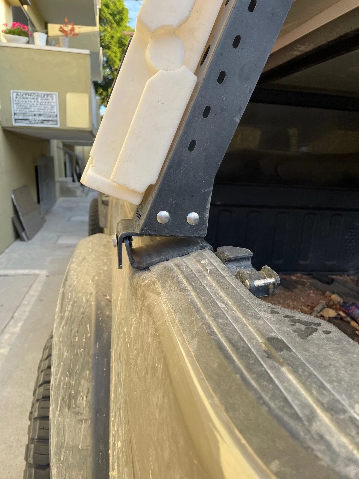

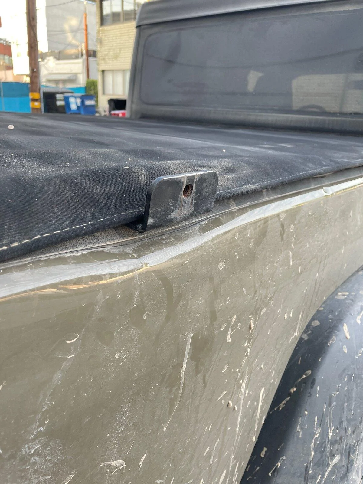

DO NOT BUY. I've had voodoo racks for years, lastly on my Tacoma and they were great. I got the 14" rack with the tonneau brackets. After a weekend in the mojave, the rack has completely damaged the bed of my truck. The only weight on the rack is my roof tent, which again, i've had for years. Where the bracket meets the truck, there is too much vertical play, and the base of the bracket is not wide enough to displace the weight (it's quite a bit thinner than the tacoma bracket). This results in a bouncy desert road slowly hammering down on the truck bed.

Yeah that sounds about right. KBV is a 4-letter word over on TacomaWorld and their customer service makes Chinese LED bar manufacturers look like rockstars. Horrible quality control and repeated (as in "we have a new partner" about 3x now) powder coat issues have pretty much tarnished them for everyone. Even with their new racks using extruded aluminum, the brackets still rust to shit.

This is insane!
Thanks for the warning. I will not be buying a rack from them.

That’s awful! Wow. Thanks for the cautionary tale - I came very close to purchasing (a 14” max modular bed rack with tonneau brackets) about a week before your post. So glad I waited! Sorry that happened and hope Chad provided some resolution.

Wondering what you were carrying on the rack ? if you were doing heavy wheeling with large load
