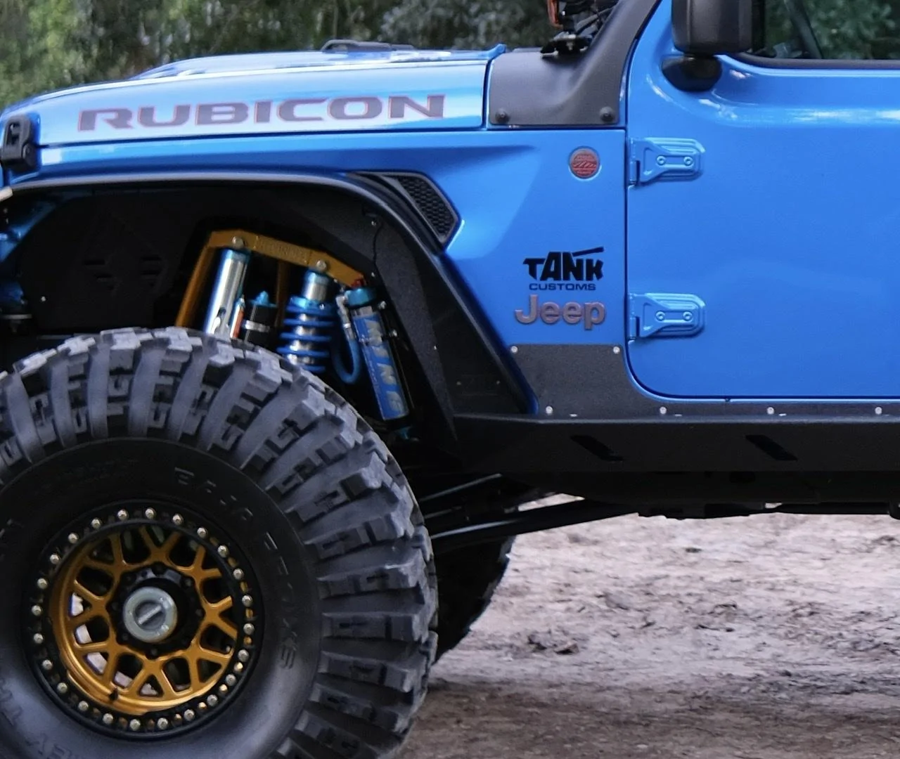

I forgot about that front “flap” under the fender that covers the otherwise exposed body panels. I ended up putting some black self tapping screws to either side of their logo where the circles are.
You can kind of see them in this pic if you zoom in
What did you use for inner fenders?

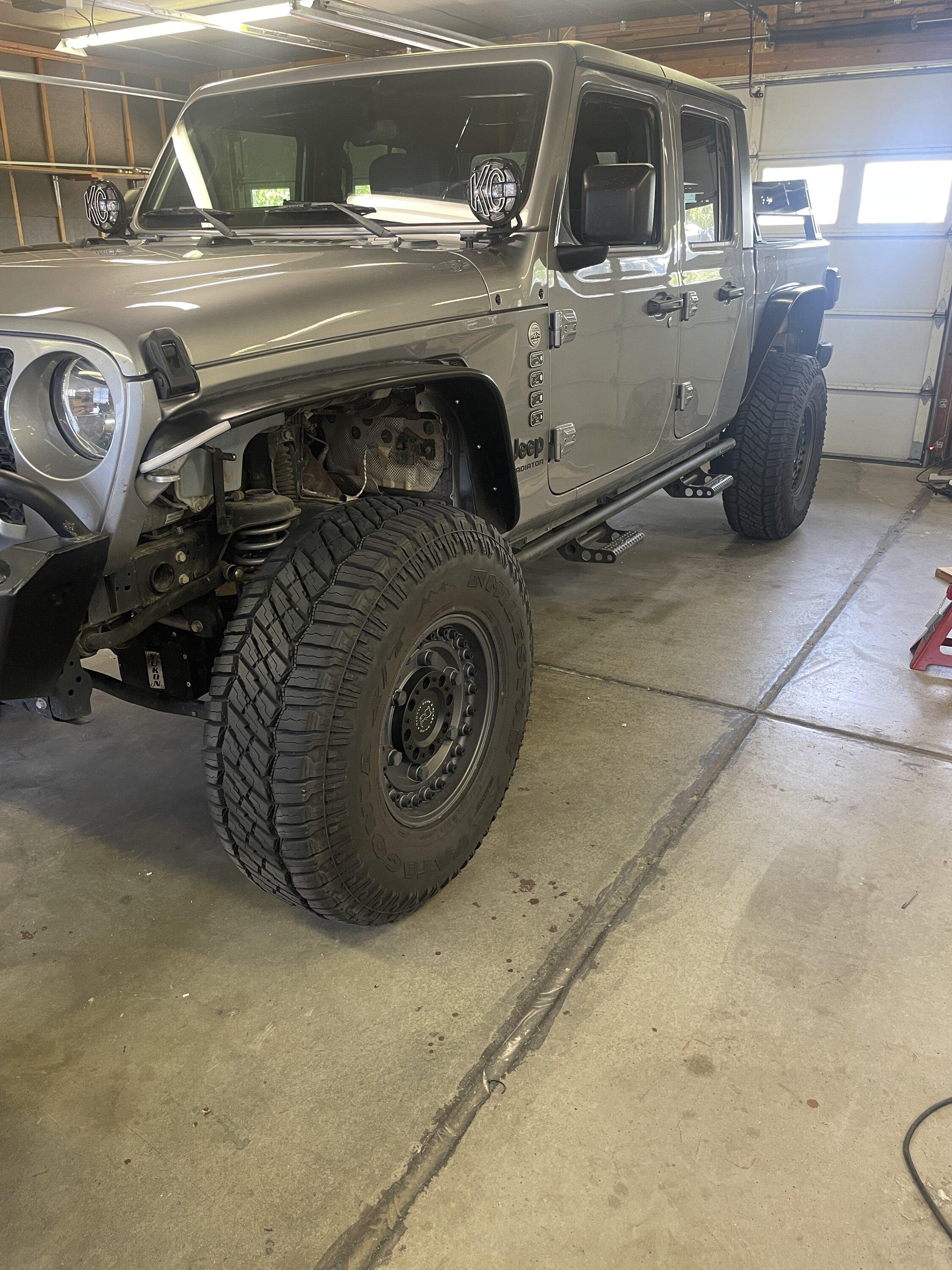

I recently installed a set of these. For the price they are great!
pros:
-Price
-Ease of installation
-Look great
-Included DRL that is plug and play(with Tazer)
-did I mention price
cons:
-Light looks/feels cheap, and the DRL is more blue than white
-Finish. They look great when shined up with tire shine etc, but when “dry” they have a raw look to them. I would plan to have them coated.
