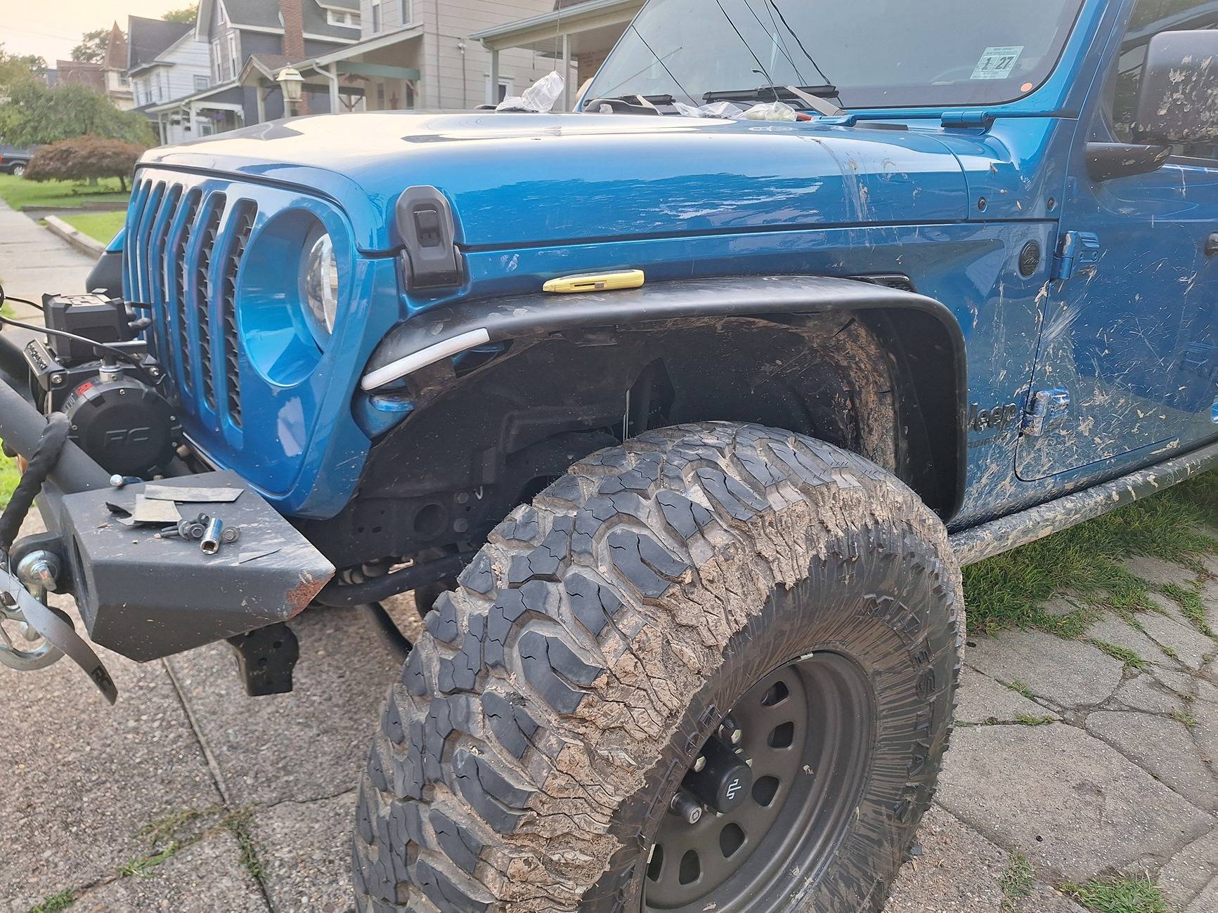

I didnt have to reshape anything, just popped them on. As far as removal, I broke a ton of the factory tabs. Tried getting them out just in case I wanted to reinstall the OEM fenders, but got to a point where I got fed up and just ripped them off.

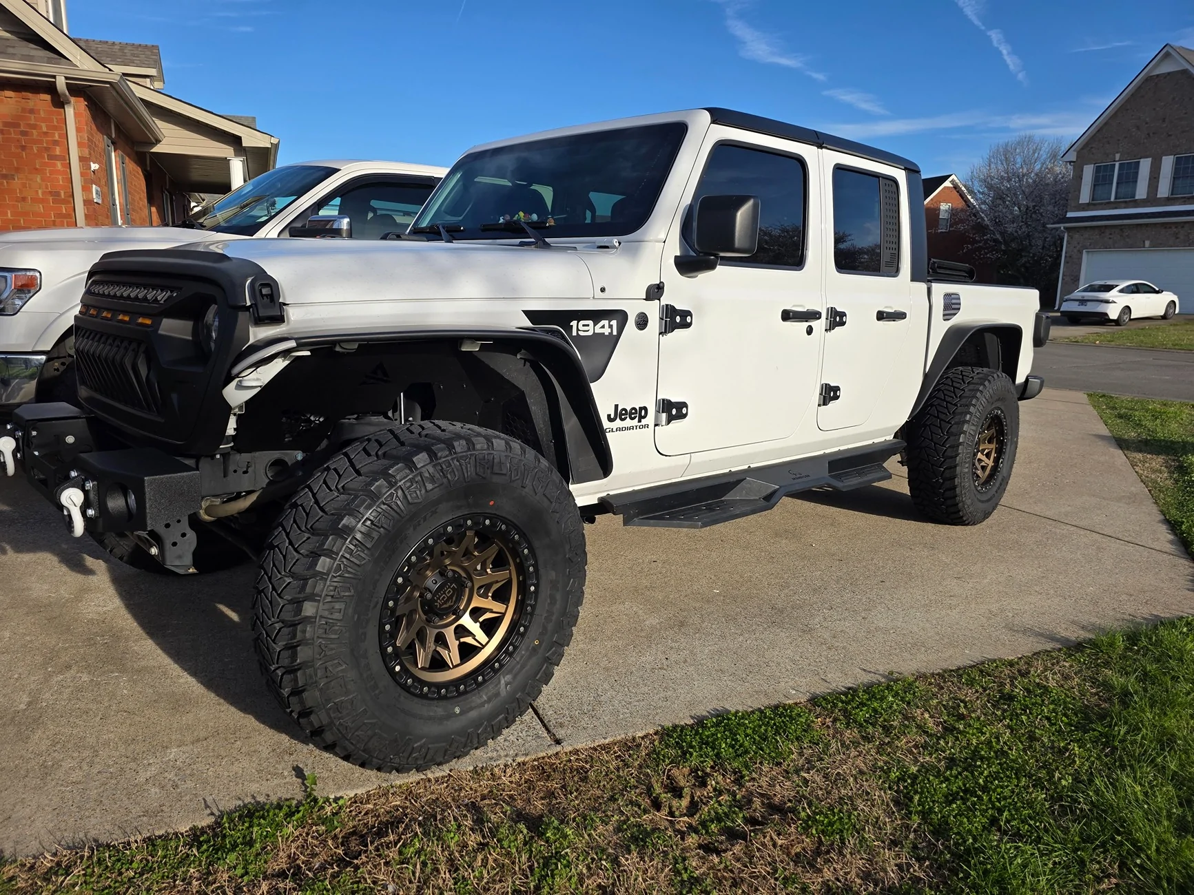

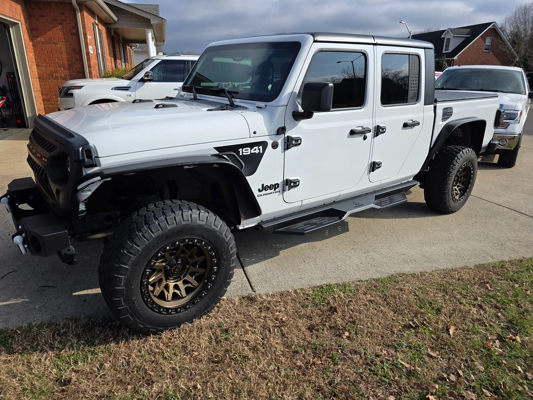

Got the front fenders on today! Looks pretty sweet so far. I don't know how to tap into LED lamp wiring to connect my fog lights. Are there two wires wrapped into the single wire group going to the from DRLs? If so it sound like I need open the wrapped wiring and tap into it. Any thoughts?

First day running the DRLs were great. No issues. Yesterday, threw a Right Turn Signal Out. Still works normal with a hyper flash inside. Left side, no issues. Of course. Going to make me crazy with one side hyper flashing inside and the other being normal. Resistors are likely in my future to retain sanity. Calling KBD tomorrow to figure out the fog lamp situation. More to follow.

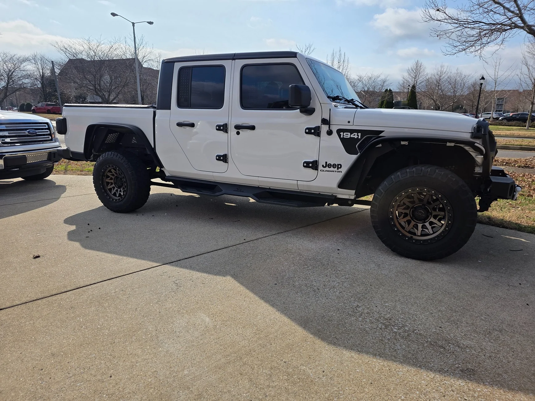

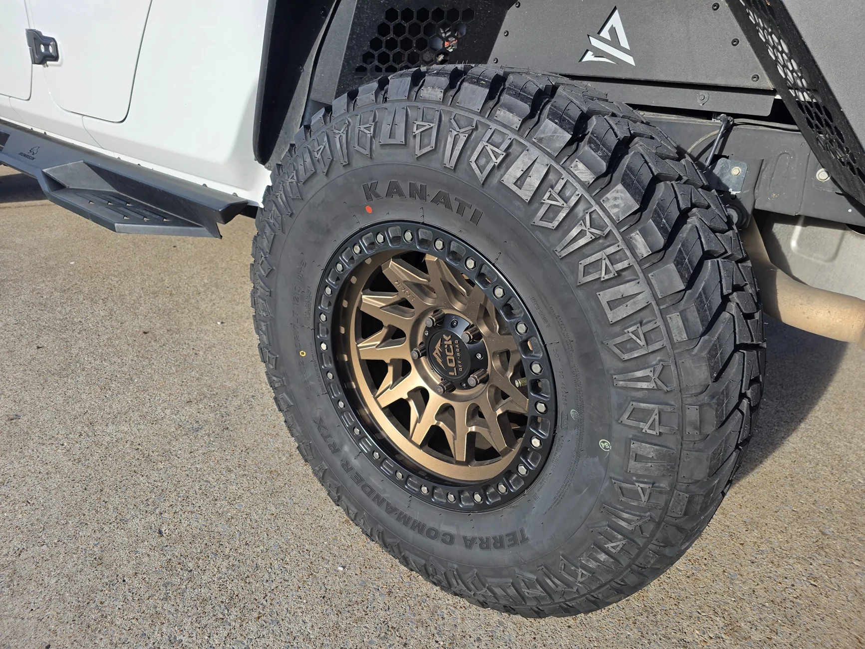

Got the 35" Kanati Terra Commander RTX tires and. BDS 2" Leveling Kit installed a couple of weeks ago. Really love the look. Bought the JSCAN to update the tire size and found that I could turn off the turn signal error check. No longer getting the error signal from the KBD fenders. Also disabled the ESS auto start stop while I was at it!
