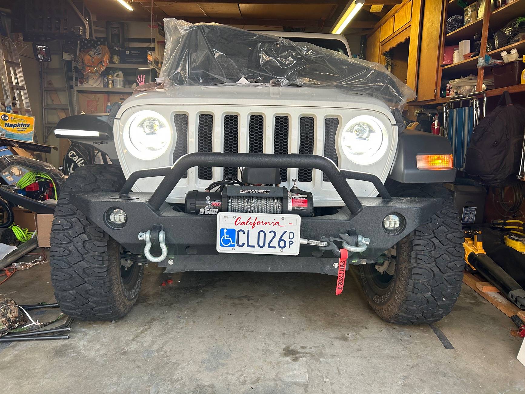

I used the Bushwhacker Hyperform fenders on my wife’s 18 JLU and gained a ton of clearance. They have their own LED turn signals built in. The flimsy plastic bends easily and doesn’t deform when hitting objects. Just fyi. Have not seen the Quadratec ones in person.

Sorry Chip, been at work since I sent that. We had to use JScan for the turn signals since hers was a factory halogen model. For the inners I used whatever was cheap to be honest. I probably picked them up off of eBay or amazon. I do believe we got close to 3” of extra clearance on ours.

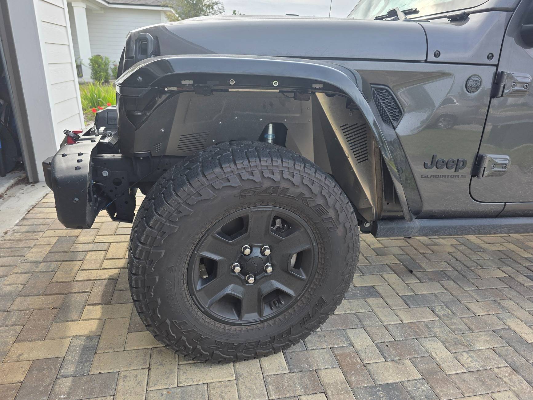

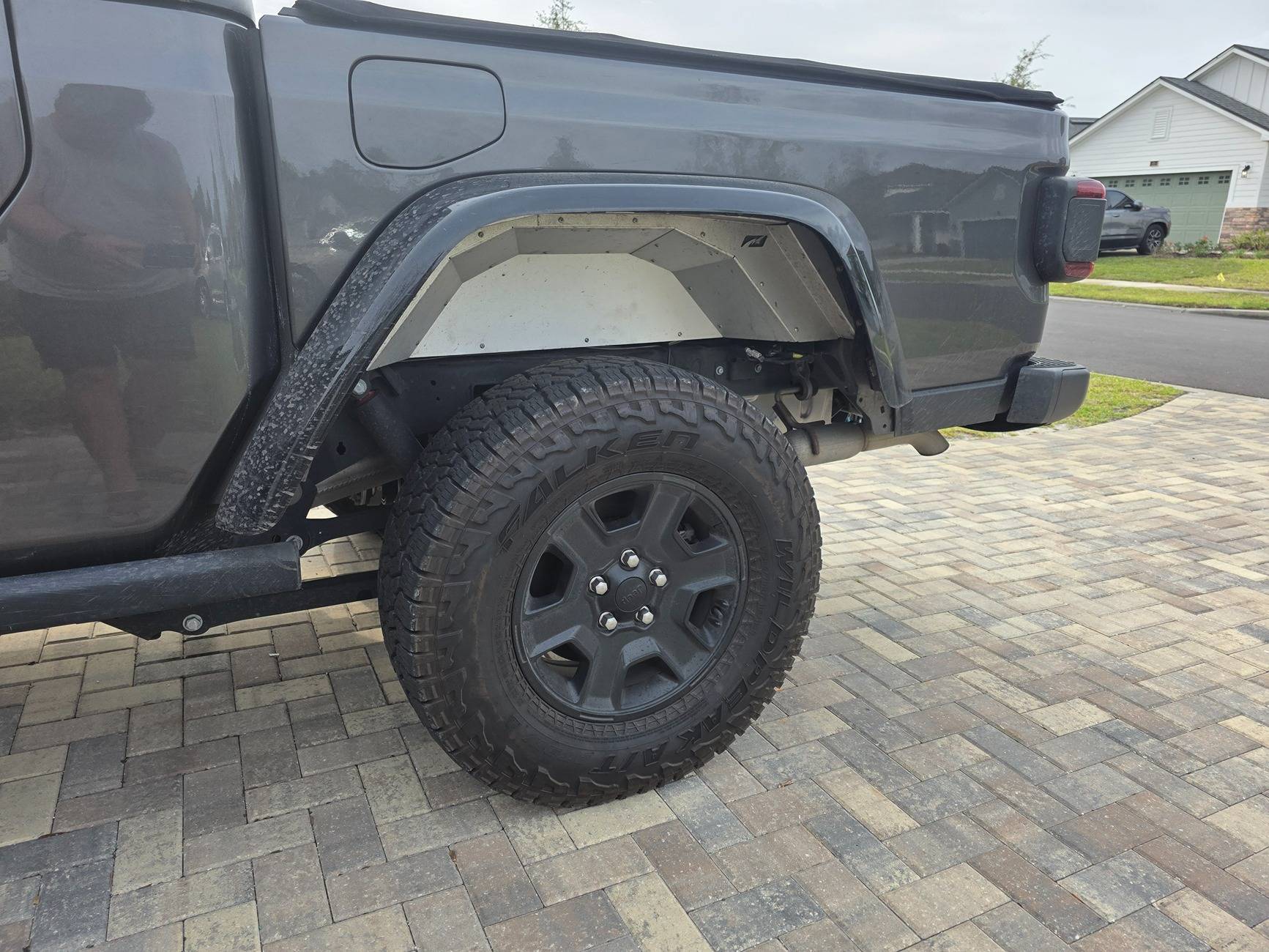

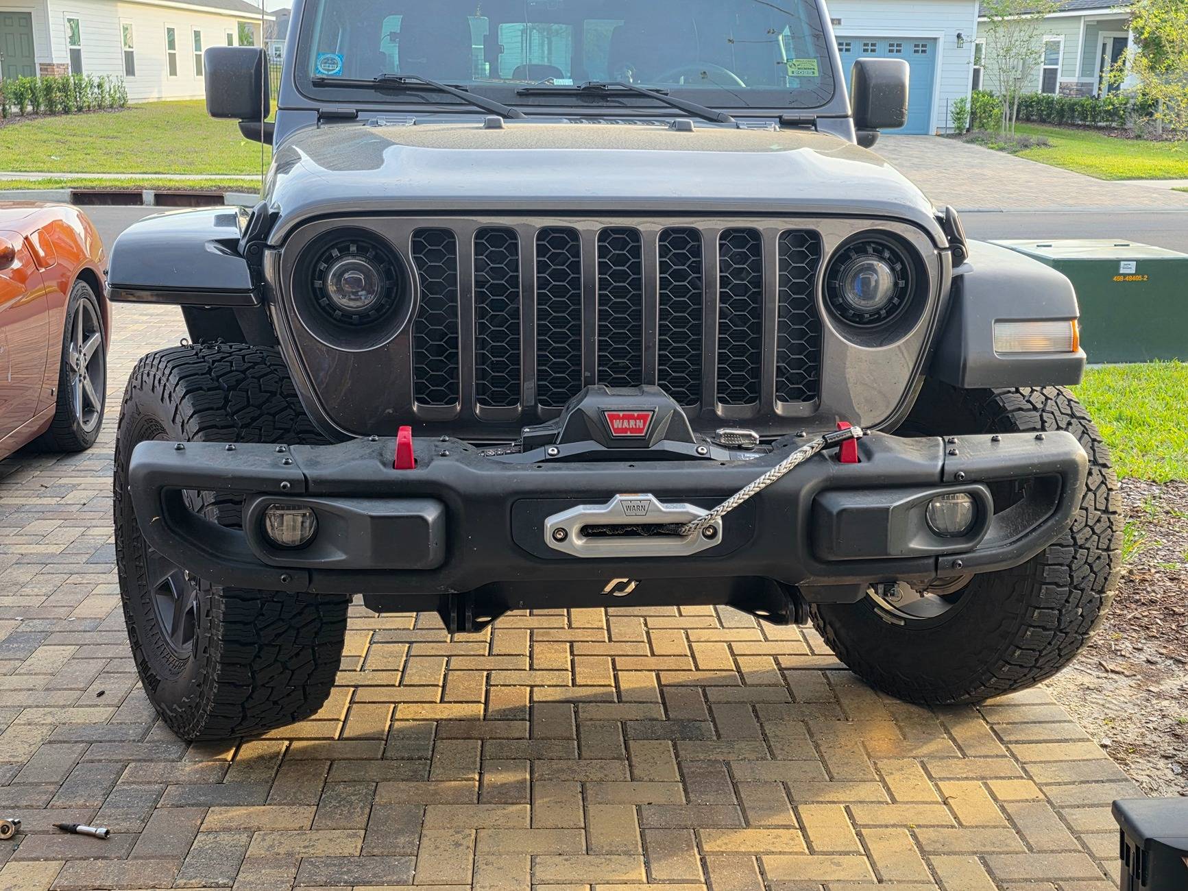

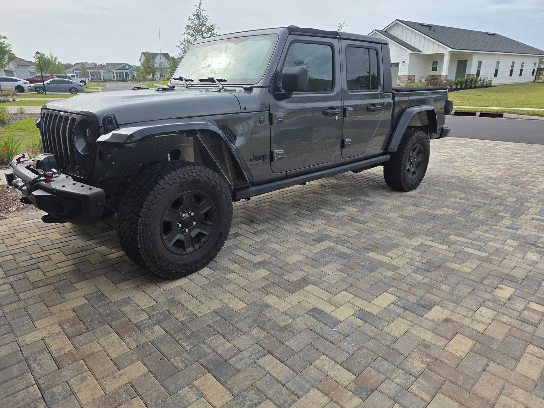

Just finished my swap. Rubicon chopped flares also have aluminum inner fenders and rubicon suspension on my sport. Plenty of room for 35s with no lift and full articulation. These are 33s from a mohave. 285/70/17. Using infinite offroad frnder chop brackets. Grimm front liners for the arb compressor install. Motobuilt rear liners cause they were cheap openbox.
