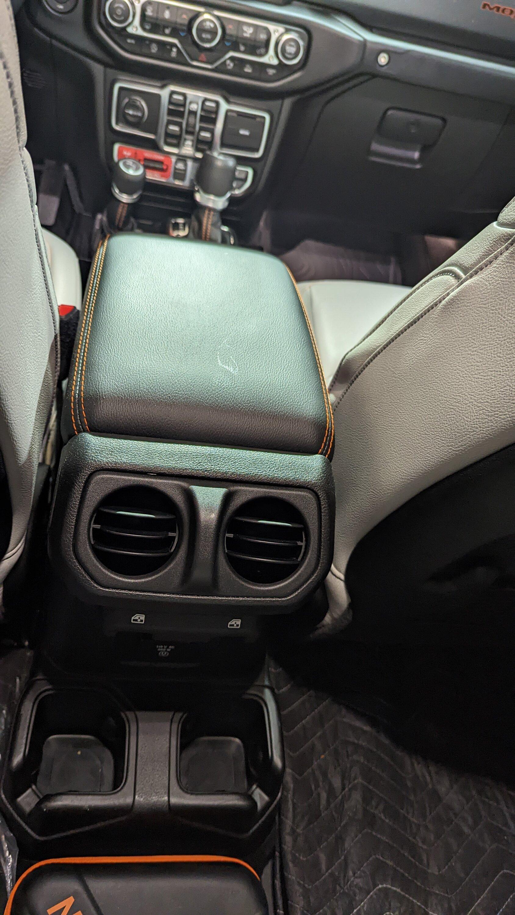

Gotta be honest I just looked and I didn't see this hole you were talking about BUT, the rear cupholder is pretty pliable. I think it's held in with a couple pop clips so you might be able to reach the key from the back there

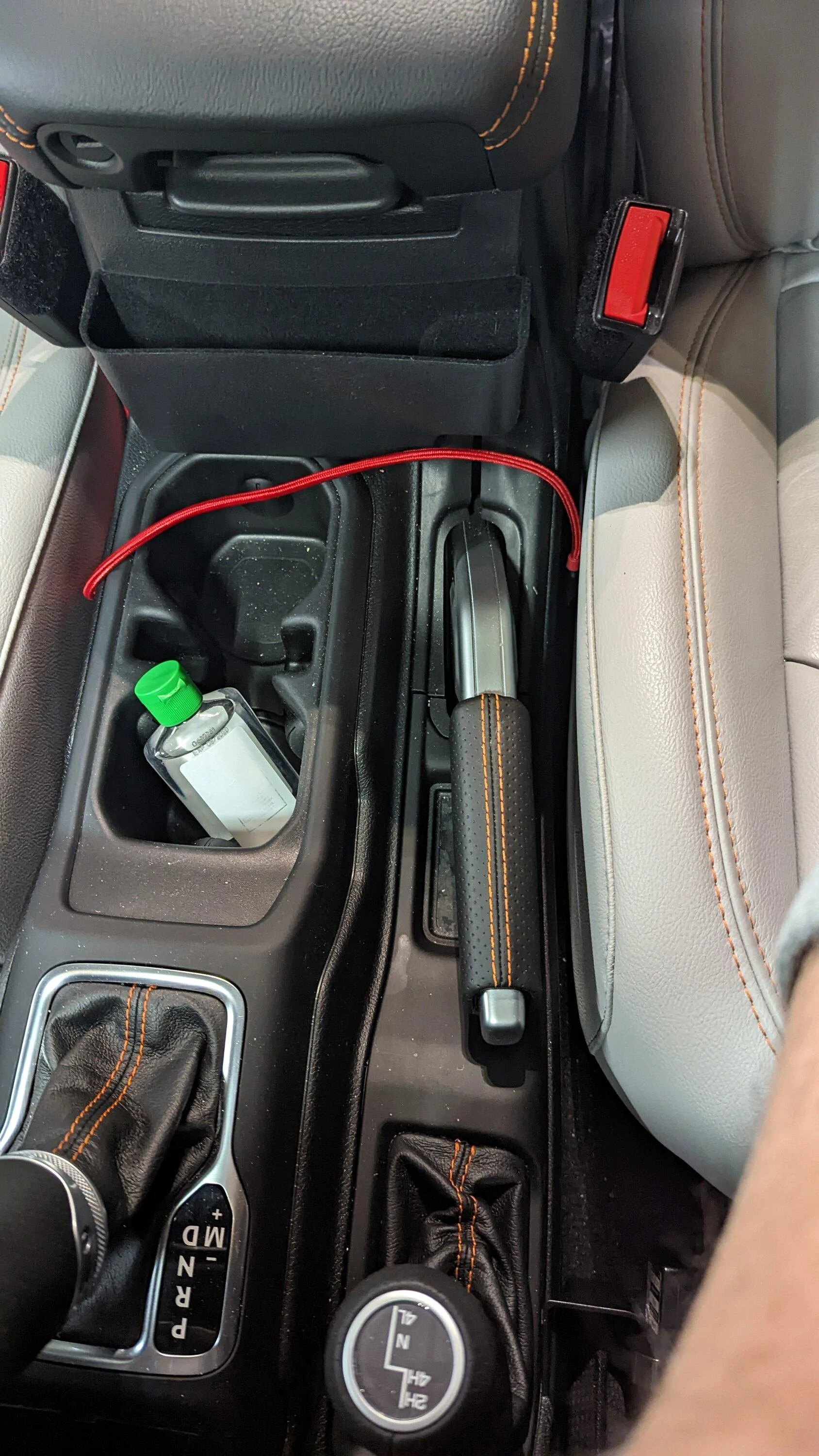

So my key fob fell in between the drivers seat and console. I reached down from the top to grab it and the key slid into the half circle hole in the bottom of the console. I cant get a tool or magnet in there. The seat won't move far enough to let me see or get a hand on anything. Suggestions???
Do I take out the drivers seat or try to get the console to come up?
It has proximity locks so I don't want someone to try and steal my daily driver.
Any help would be appreciated

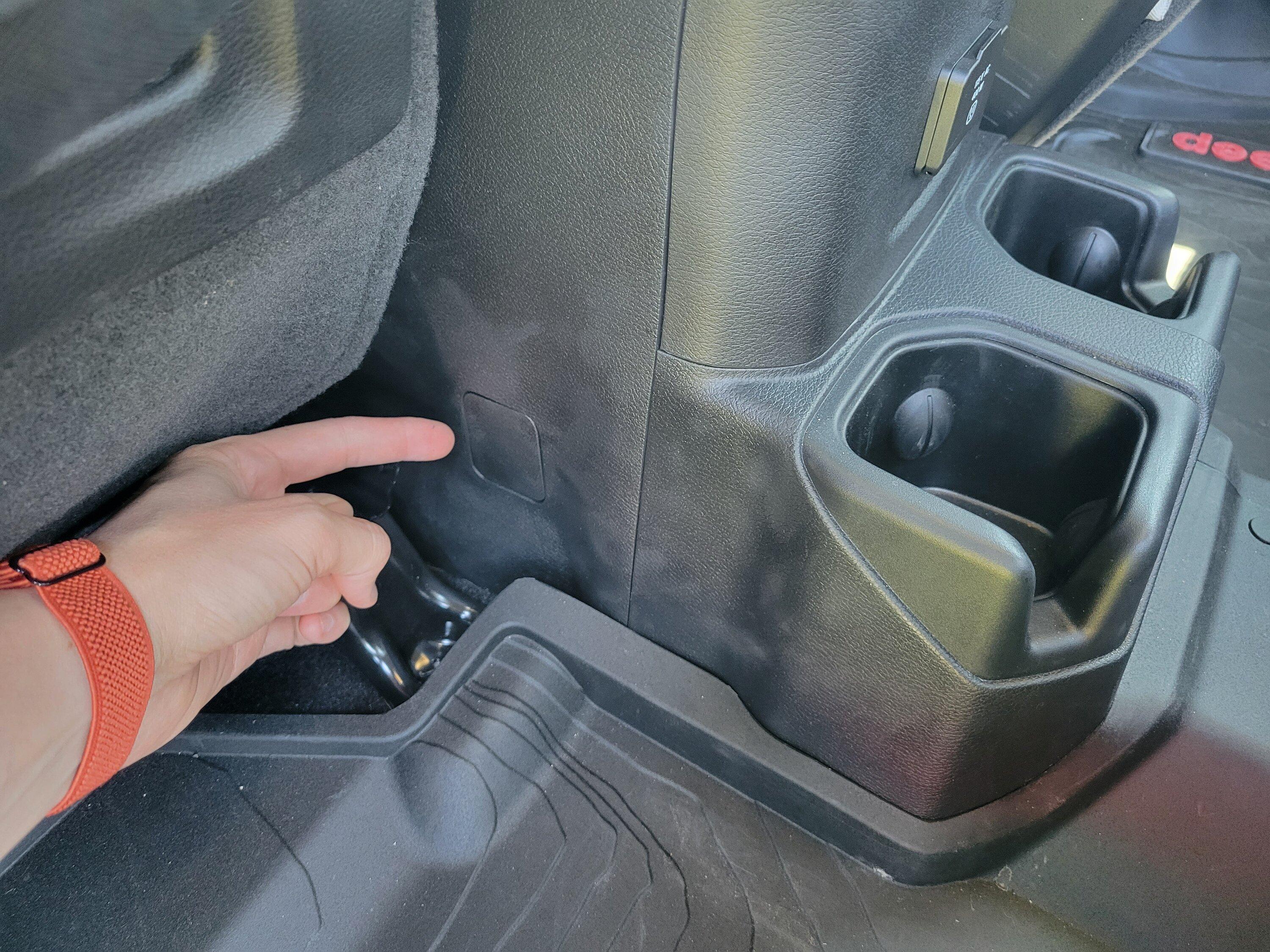

I just did this myself today. I couldn’t reach my fob. I saw it disappear when I touched with my finger. I decided to wait for daylight I’ll try again tomorrow.
I unbolted the back of the console and loosened the front console bolts. I was able to lift the console up from the back and get my arm in there.

I spent an hour with back scratcher trying to get my fob. I could shine a flashlight under the seat could barely see my fob. Got mad and decided to unbolt seat, I didn’t have any torque sockets so used 10mm socket but couldn’t get the inside bolt off for worrying about stripping so put the other bolt back and continued with my backscratcher. Another half hour and finally retrieved my fob. Never again. Oh, I also found a key to my storage locker that was missing for almost a year.
