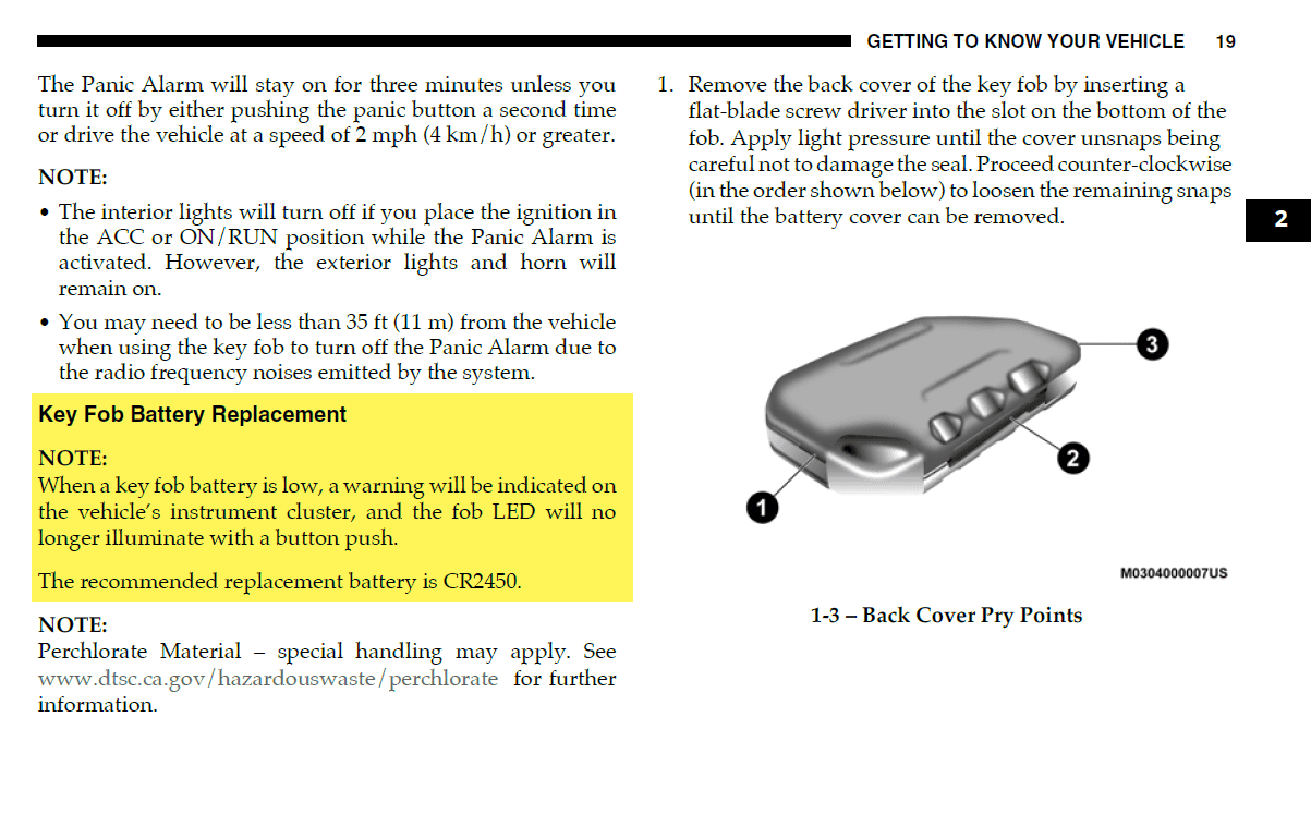

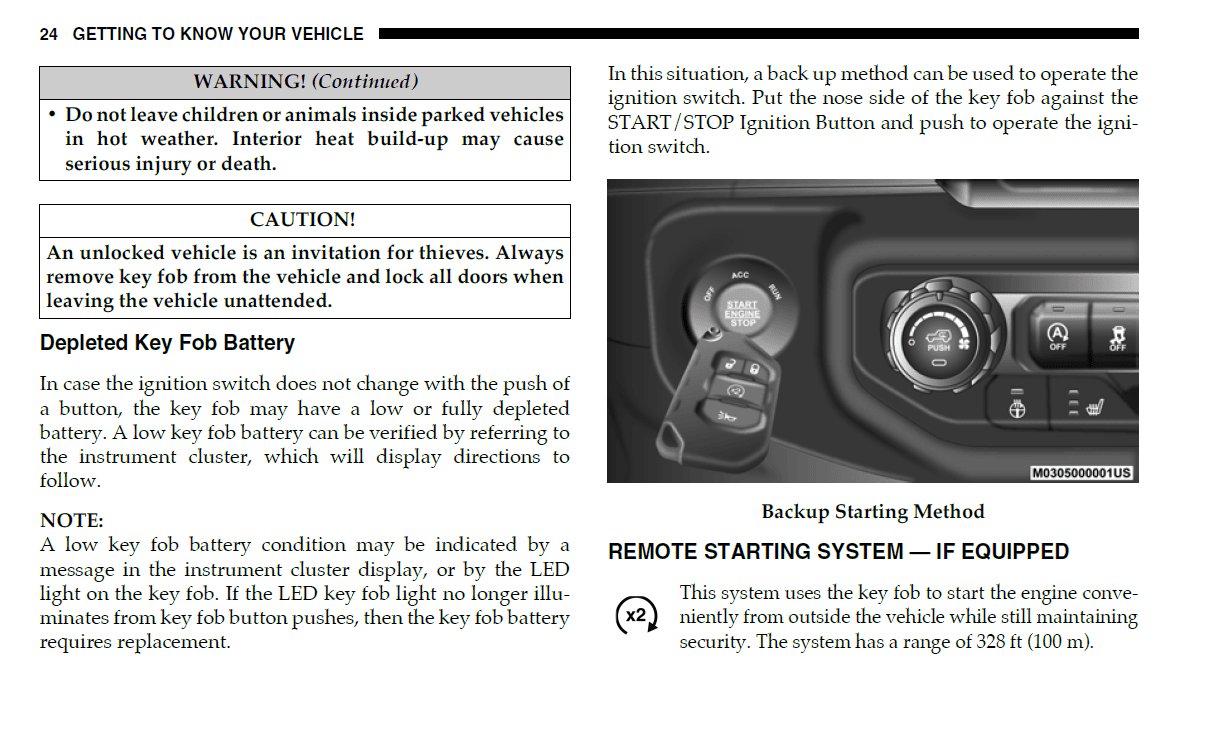

yup, page 19 in the manual confirms that there should be a similar feature:
Jeep Gladiator Key fob, low battery alert upload_2019-7-21_16-43-54
