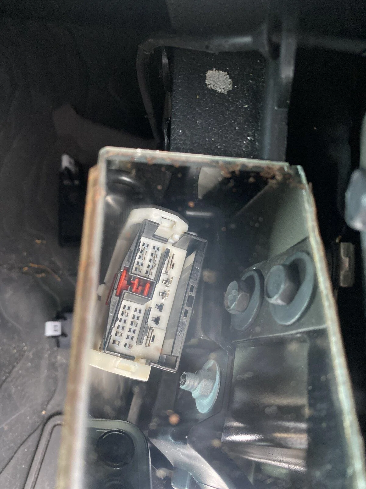

Jeep Gladiator Keyless entry not working on passenger door??? image
The pins look fine, no?

The bent pin would be on the other side connector, the one in the footwell.

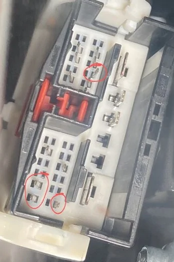

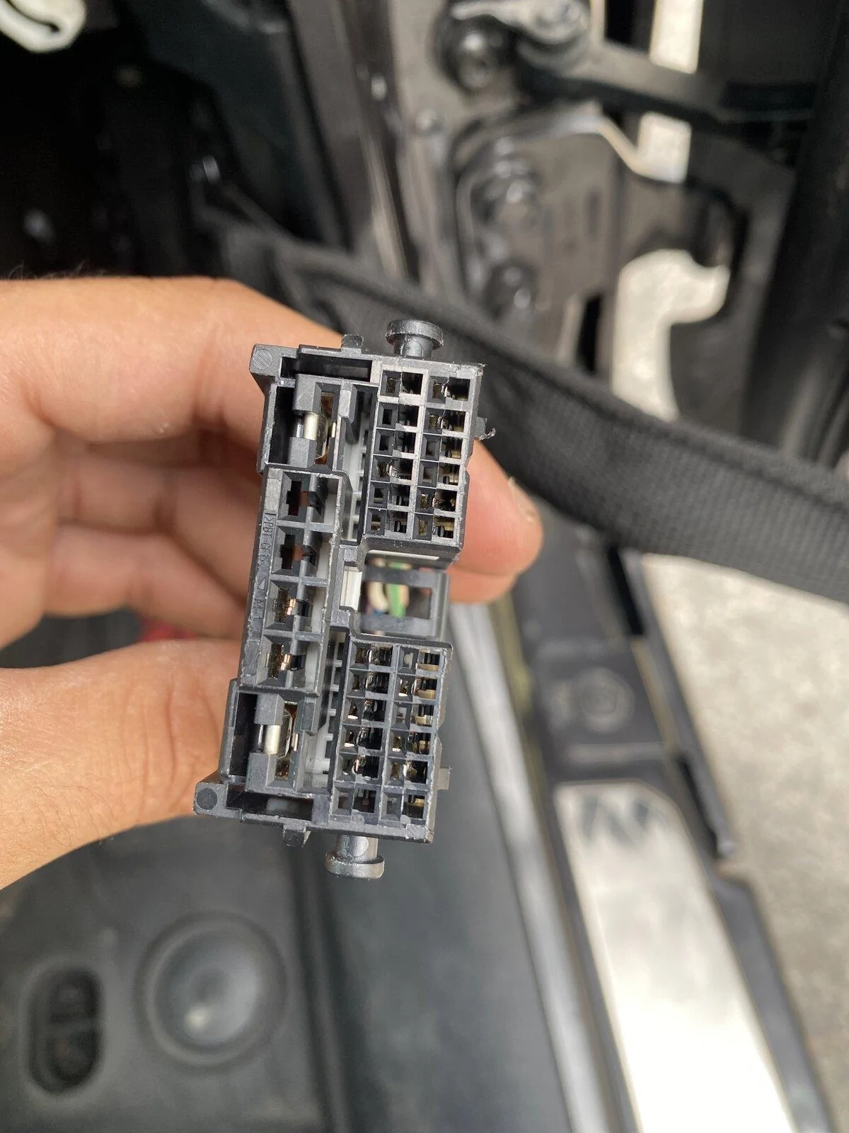

How’s that look now?

Nope nothings working. I try bending the pins straight, resetting everything nothing. So weird.

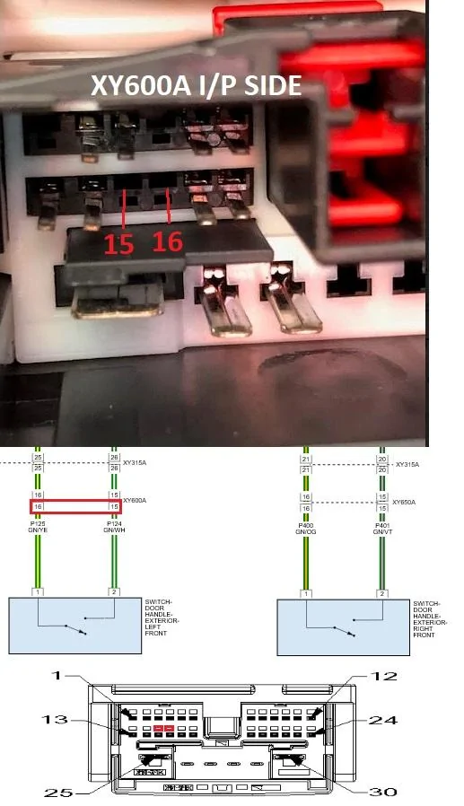

There's a thread about the wiring harness on the JL Forum. Search on "bent pins."
I just put my doors back on and had a little trouble with the driver's door harness. The door is locking, but the radio will not cut off right away when I open the door now. Not a biggie, but I'd like to fix it. Doors still lock. I do not have proximity entry. I never had a problem before in my 2018 JL.
