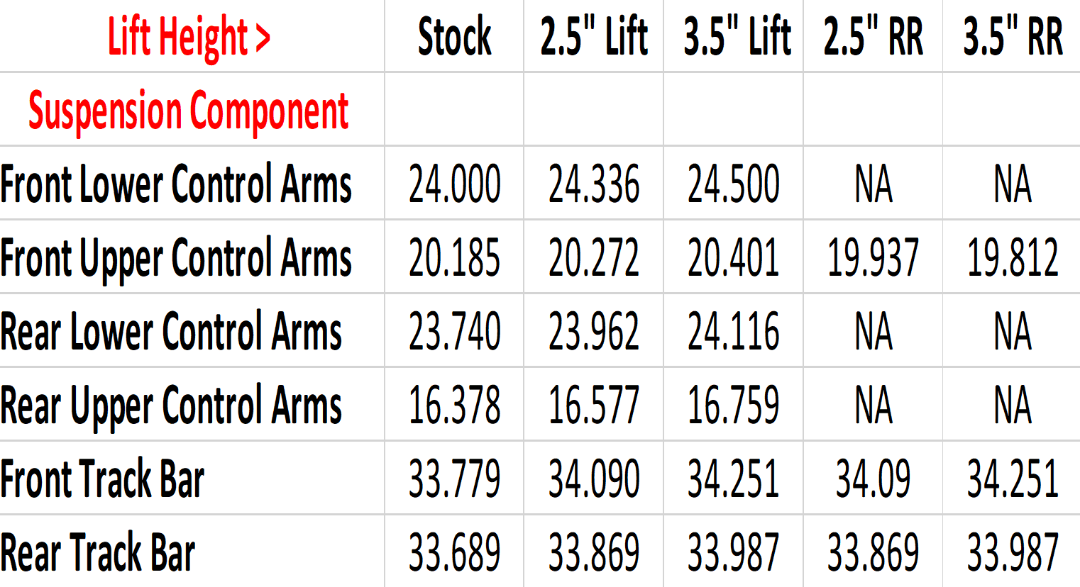

I’ll toss this in here as well. I believe it was originally posted by Clayton Off-road but I may be wrong......
Jeep Gladiator LCAs or Stabilizer for Rubicon Steering? 90F4EBA0-498E-461A-A5EF-421348A36341
So what I demise from this, when adding a 2.5 inch lift, you need to increase the LCA length 1/3 of an inch to get into the factory caster range.
Since I only went 1.5 inch and 1/4 inch longer than stock, my caster should be more than factory, which suits me just fine since general consensus is factory caster is way too low on the JLs and JTs.
At least that’s how the math in my head works it out. Haha
