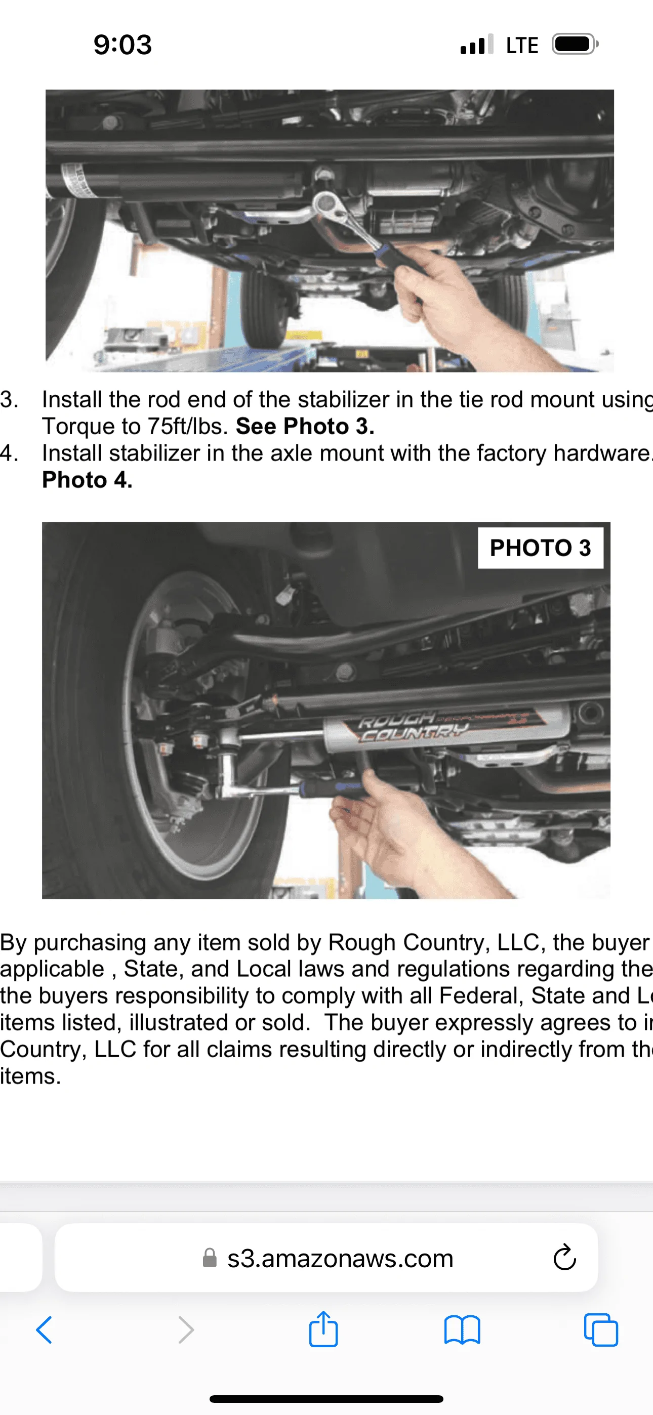

Yesterday I put on a steering stabilizer and the can end was shown towards the axel. I see a lot of videos online where the can is towards the wheel. I had crazy death wobble today for the first time after I put it on yesterday. Any advice on this

I joined a chat with them and they said to try flipping it, and when was my last alignment. I was aligned 2 weeks ago. But a lot of pics and videos online show it reversed.

I know this is a lower quality brand but the instructions are incorrect then?

And the OEM one is installed 'wrong', too?
I can't imagine it matters which which way it's installed outside of clearance considerations. I would assume the damper is the same C/R, so either way has the same resistance. My racing history says to have the body towards the center for a more even weight distribution. But I'm not an expert in these things.
Maybe it's a way of politely saying "it's not tight enough."

looks the same as instructions

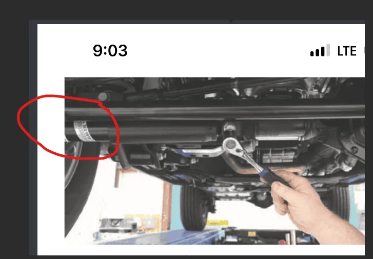

Pretty sure the OEM has the body towards the wheel. Mine was when I replaced it.
Jeep Gladiator Steering stabilizer orientation 1706542898335
ah... it was a small pic on my phone, couldn't make out the shaft protector.

The factory one has the body toward the wheel like @Jimko71 highlighted.
Did you check to make sure the stabilizer was working properly before install? Can you manually move the piston with ease or is it hard to move? How was/is it compared to the stock SS?
I don't see anything in the brief instructions you posted about making sure the travel is set properly. Some aftermarket SS's don't have the same compression/extension as stock and you might have to adjust the tie rod mount to accommodate.

Piston was hard to move, harder then the stock

Should I flip with body towards wheel??

I would give it a try, yes. Most other SS's are mounted that way except maybe the pass-through kind.

That’s what my gut told me but the instructions I posted above showed it like I mounted. I’ll give it a shot
