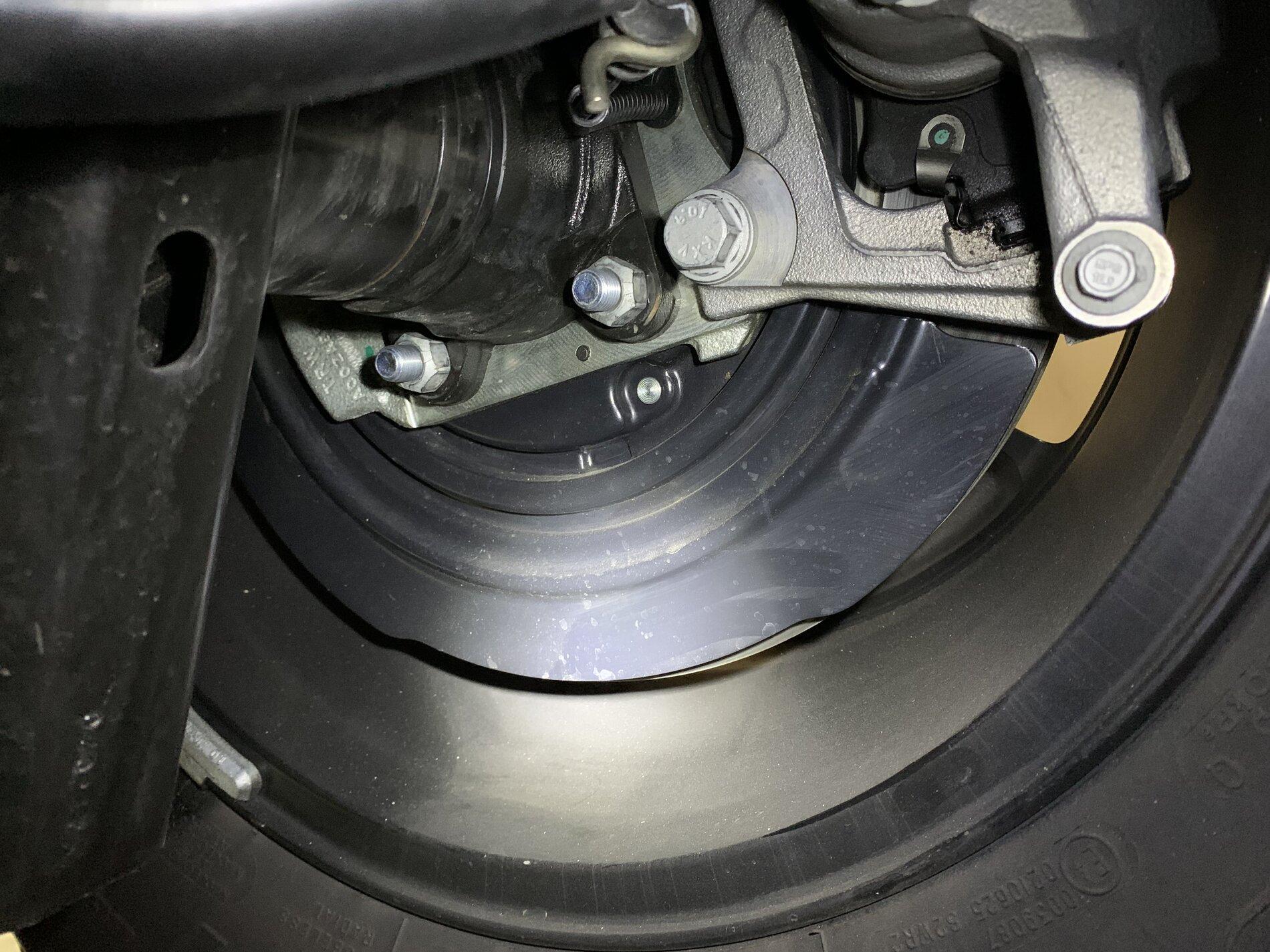

Axle day at the dealership. Got some new Wildpeak AT 285/70/17 going on too plus flash of computer for accuracy. Hopefully it doesn't leak after the fact.

A few weeks and no more leaking?
Nice - wish mine was that clean. Time to get it washed on the underside, I guess - before winter.
Anyway, this is great news. That is DRY. No sign of any dust collecting - and it would if there was the slightest spec of oil for it to stick to.
