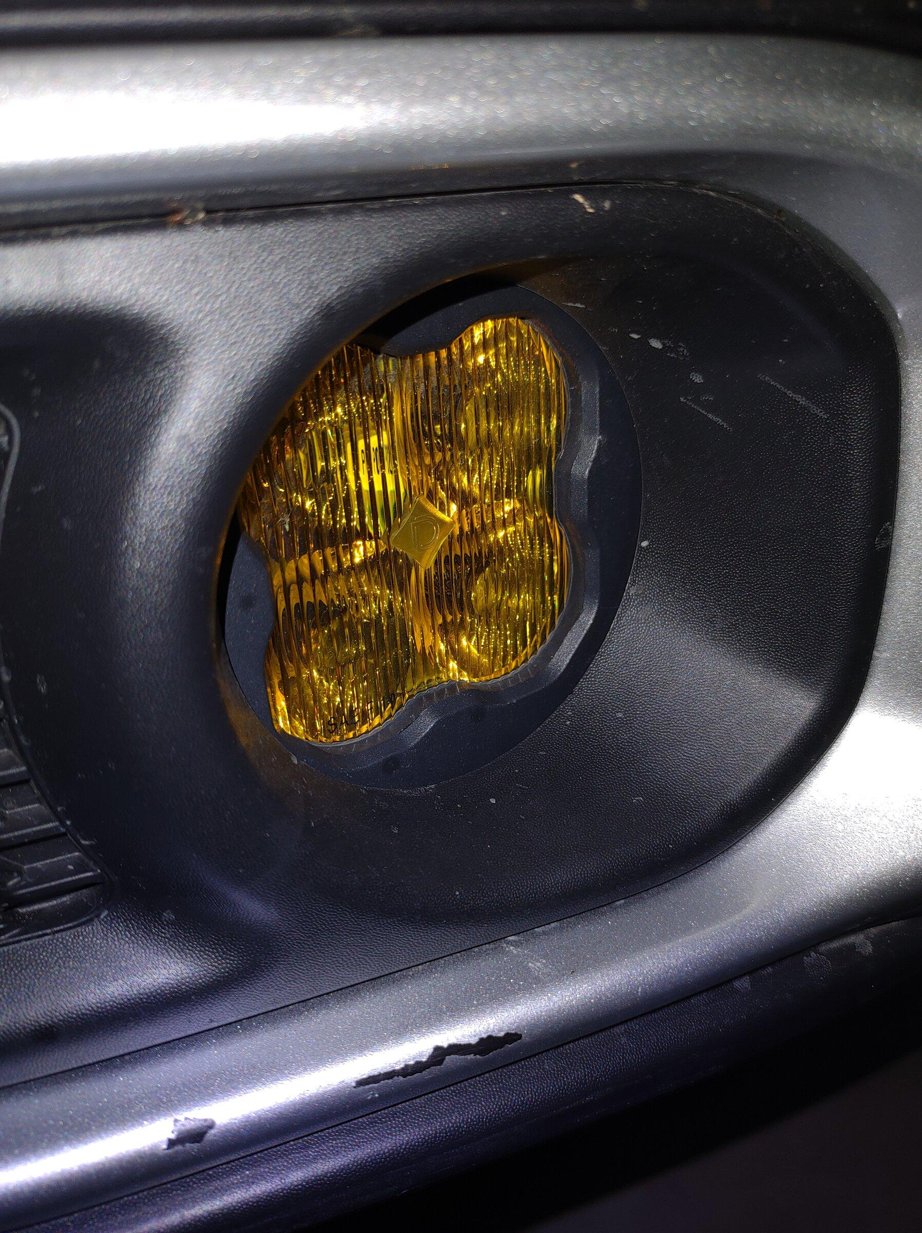

I imagine that depends on the manufacturer. I bought some Diode Dynamics amber fog lights and they plugged right in. Although they were second hand.
They plugged to the factory Jeep Plug?
Free2roam
Robert
Mar 1, 2021
5,486
11,679
89521
Yes. There might have been a wiring harness that came with them. Again I purchased the second hand off another forum member. So he might have had to buy that portion. But they work flawlessly. No flashing or blinking. Plug and play. I had factory halogens in there and went to LED ambers. Love them.

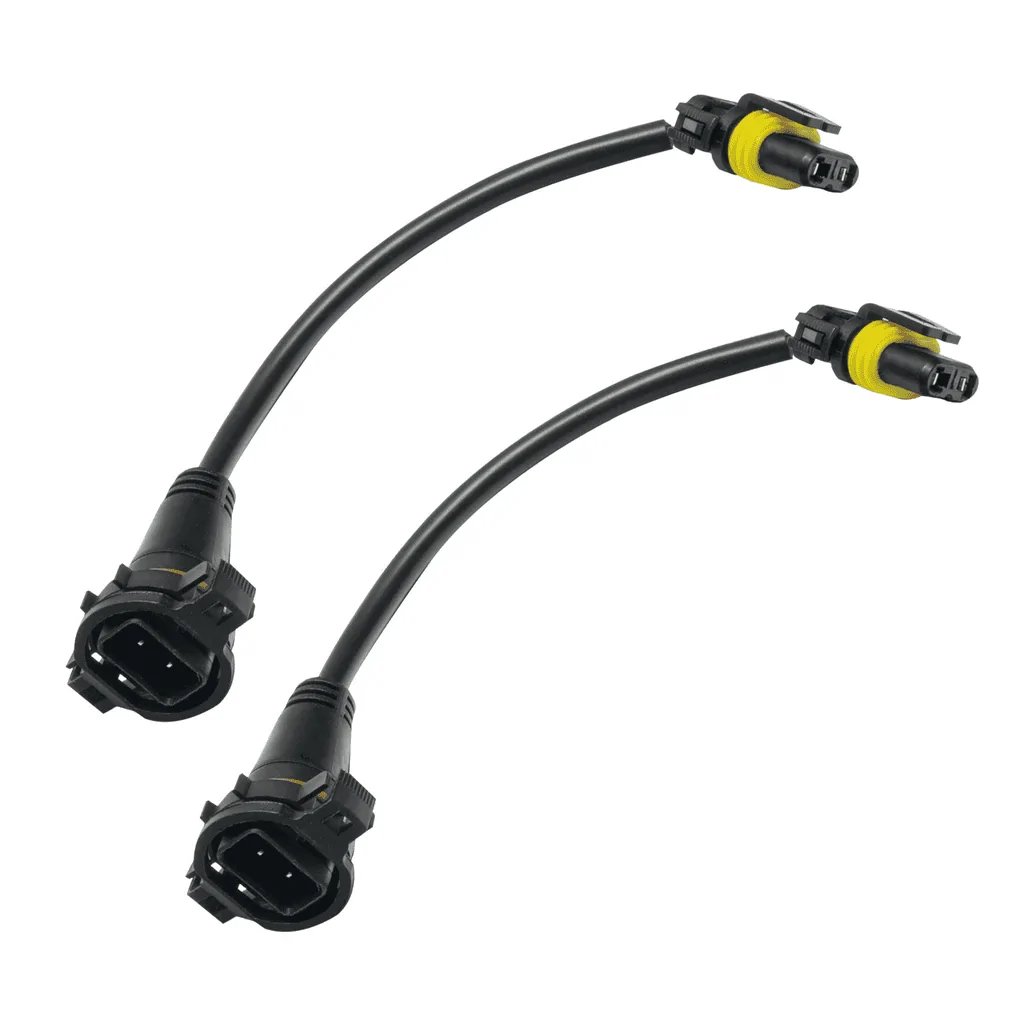

i am adding an aftermarket front bumper, I currently have the led factory fogs, can I Hook my aftermarket lights to the existing led plugs? ideally I wouldn’t have to cut any thing off the stock bumper, can I order that plug to wire into my new lights????
As long as the AM lights have PSX24W connectors, give'er.

JP_Oracle
Peak Sponsor (Level 2)
JP
Jun 29, 2021
236
217
ORACLE Lighting
21 JTR
I have never seen aftermarket lights with any plugs, just wires usually
Our fogs have 9005/9145 connectors and we include an adapter plug to convert to PSX24W
