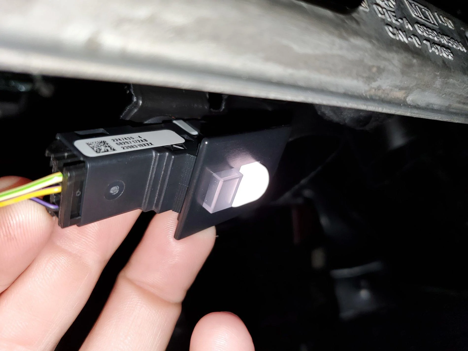

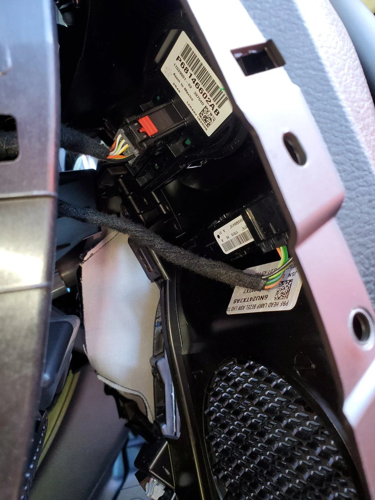

I pulled the panel off at lunch, its apparent the knob is plugged in. The light is tandem in the second picture. One is on with the dome light. One is off. Wiring shows two circuits and a ground wire. We have something not working. I also pulled all my light and interior fuses as well as checked for missing fuses. This leaves me to think there is a wiring or can bus problem.

Maybe we can get some traction on this @JeepCares , I discovered the problem. There are two 12 v wires and a negative ground. The ambient knob controls the circuit on one light and the other is your dome light/footwell light. When these parts were made, they failed to solder in the second led and not catch the cost cutying measure by their vendor or maybe a duality assurance fail. I am having the dealer address this by ordering two new footwell lights. Both part numbers are as listed. Everyone needs to address this or there will not be a tsb for it.
68297172AB
68346812AB
