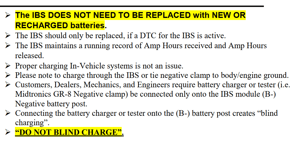

... require battery charger ... be connected only onto the IBS module (B-) Negative battery post.
Connecting the battery charger onto the (B-) battery post creates "blind charging".
"DO NOT BLIND CHARGE".
I think I know what they mean, but the above contradictory text sure don't make it clear!

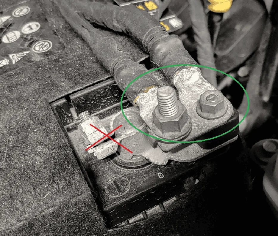

And worse - the pictures in their IBS training info aren't all that great, either.
Here's mine - green circle = OK
Not on the battery post or the IBS clamp - red X = not OK
Jeep Gladiator ESS not working 1682569162202
Body ground is a great place to connect if you can get to it.
Or like the Grand Cherokee has - jump starting posts on the right fender inside the engine bay.
