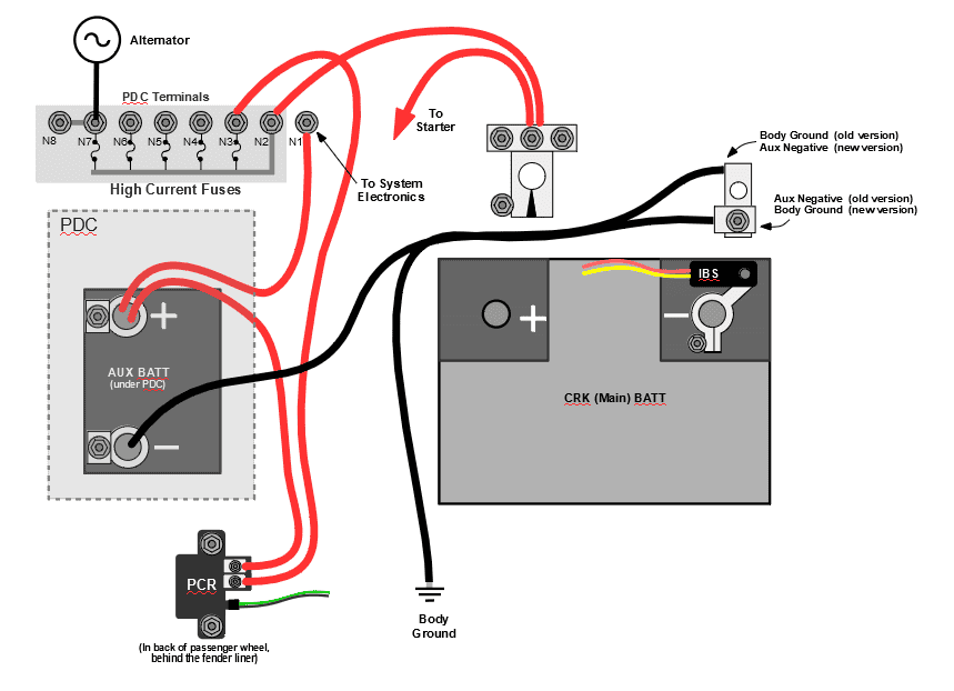

The batteries are in parallel unless ESS is active, Connect the maintainer to the big battery. Both will get charged.
His small battery may already be dead or weakened. According to this guy, you need to hook two posts together in order to charge that small battery(4:50 time mark)

Does the battery maintainer get attached to the main battery only?
As long as you have a stock setup with no changes to the factory battery cables, then the maintainer only needs to be connected to the nuts on top of the main battery (not to the actual battery posts).
As long as the Z Fuse is good, you can just connect the maintainer to the big battery. Electrically, they are connected thru the PCR relay.

If you just checked the voltage at the main battery without disconnecting anything, all you know is that you need to charge them. 12.3 is low.
Remove the fender ground, remove the negative terminal off of the main and separate the two ground cables that you just removed. One of those cables goes to the fender and the other goes to the aux battery. Measure the voltage at that ground and the + battery main post. This will be your aux battery voltage. Move the negative meter lead to - battery main terminal. This is obviously your main battery reading.
Charge each battery while still disconnected and separated.
