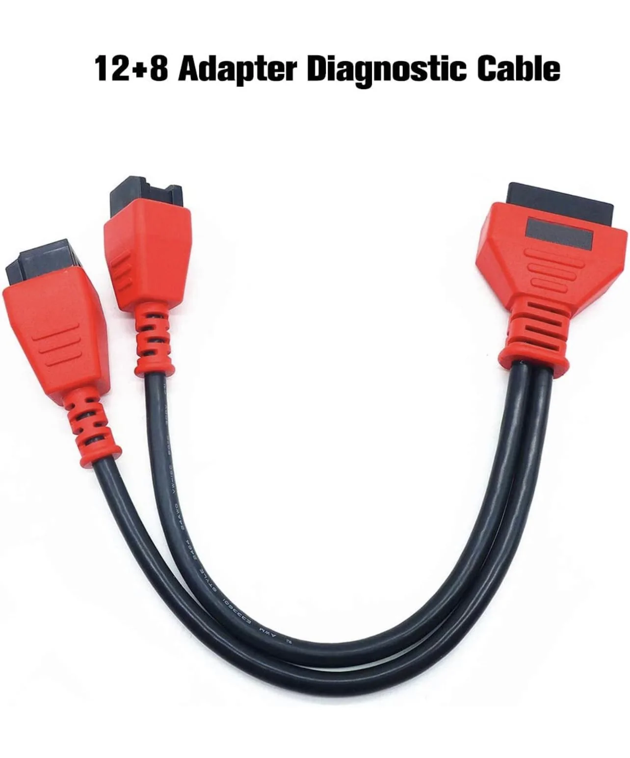

The HP Tuners Smart Access Cable and the Chrysler Security Bypass Cable accomplish the same thing.
I almost forgot. I used an Autel Chrysler 12 +8 security gateway bypass cable for use with my JScan app and Bluetooth adapter. It works with HP Tuners Tool and with JScan. The HP Tuners cost about 4-5x as much but it allows you to use the original OBD port on your car. The bypass utilizes it’s own OBD port you use.
I had an HP Tuner cable fail (possible due to the bad wiring job I did, or it may have been bad when I received it). The bypass cable looks to be just wires while the hp tuners cable seems to have a resister or diode in the system.

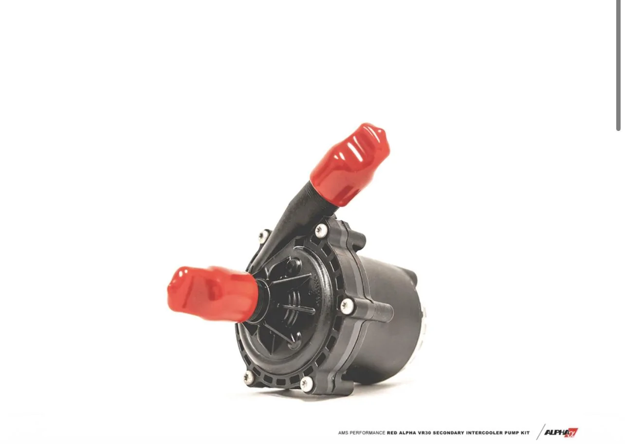

Lesson 4: The intercooler pump (best know as Varimax Pump) shuts off when not moving fluid.
I suspects the issue was with my pump. I checked for voltage from battery to electrical connector that connects to pump and it all read 14v. I could figure out why the pump would run. The pump is smart and can be controlled in different ways and is variable speed however in this application it is wired without the control wires and should operate as either on or off. The pump is wired to the injector fuse so if the truck is running the pump should be running. I could get it to come on but it would shut off. I wired the pump up on the bench and the pump would come on for a few seconds and turn off. I called superchargerparts.con and they weee out of stock. I found a pump on eBay and had it over nighted. When I put it in the truck it came on for a second and I cheered before it quickly turned off. At this point I knew it wasn’t the pump and suspected it had a protection feature to keep it from running dry. I had thought this was a possibility before but since there was fluid on both sides of the pump when I removed the pump I discounted this. I also wanted to rule out a problem with the relay so I jumped the relay (after a few google lessons) and noticed the pump would come on and off. I mailed the hose to prime the pump and after about a half dozen attempts the pump came on and ran. I logged and IAT came down as expected but the truck still would not make power. I updated Dave and he had concerns about my intake Cam on the drivers side. To learn more about this read the thread “the good and bad of roots supercharger”. In short it looks like the intake cam is likely shot. The major evidence of this is misfires on only cylinders 1,3, and 5 when revving engine above 4000rpm. I’ve also found if I keep the RPM low it seems to drive fairly normal. What is strange is this problem was not evident on factory tuning or even Dave’s Naturally aspirated tune. It only showed up under forced air. https://www.jeepgladiatorforum.com/forum/threads/the-good-and-the-bad-of-a-roots-supercharger.54832/
I have now ordered the suggested parts on that page (which are about $700 total, but I couldn’t get the CAM phaser or one of the solenoids, also the lash adjusters are very hard to found but after some work I found them). I am waiting in the parts now and plan to install them myself.
It seems I have had about every problem possible so I’m not certain this will fix the issue but I am hopeful and I have learned so much about how these engines run and the systems that govern them.

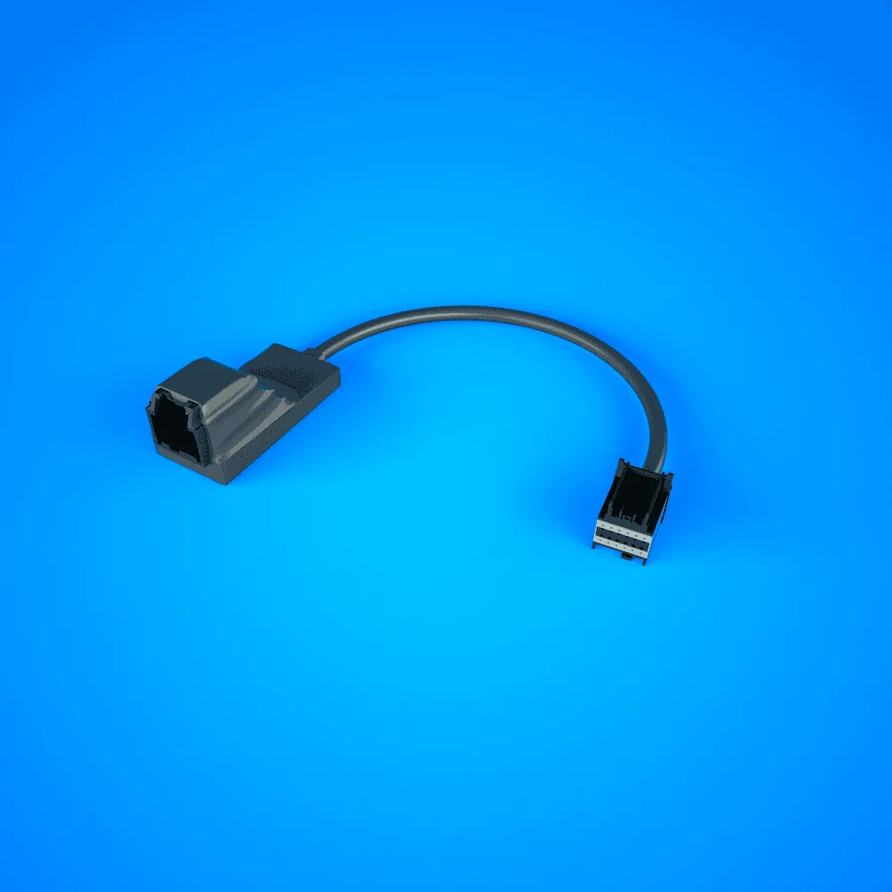

If you ever wanted to change the VIN yourself. Here is the tool and how to use the software that does it.
mghoodlum
Oct 24, 2019
87
51
Midland, TX
JT Pearl Blue Rubicon on order
Thanks. I saw this was for a 2014. I went to the website for the product and was confused by the amount of items and what they did. Most looked to be pretty expensive and also require and subscription to use.
Do you know if this works the same way on 2018+ Vehicles?
