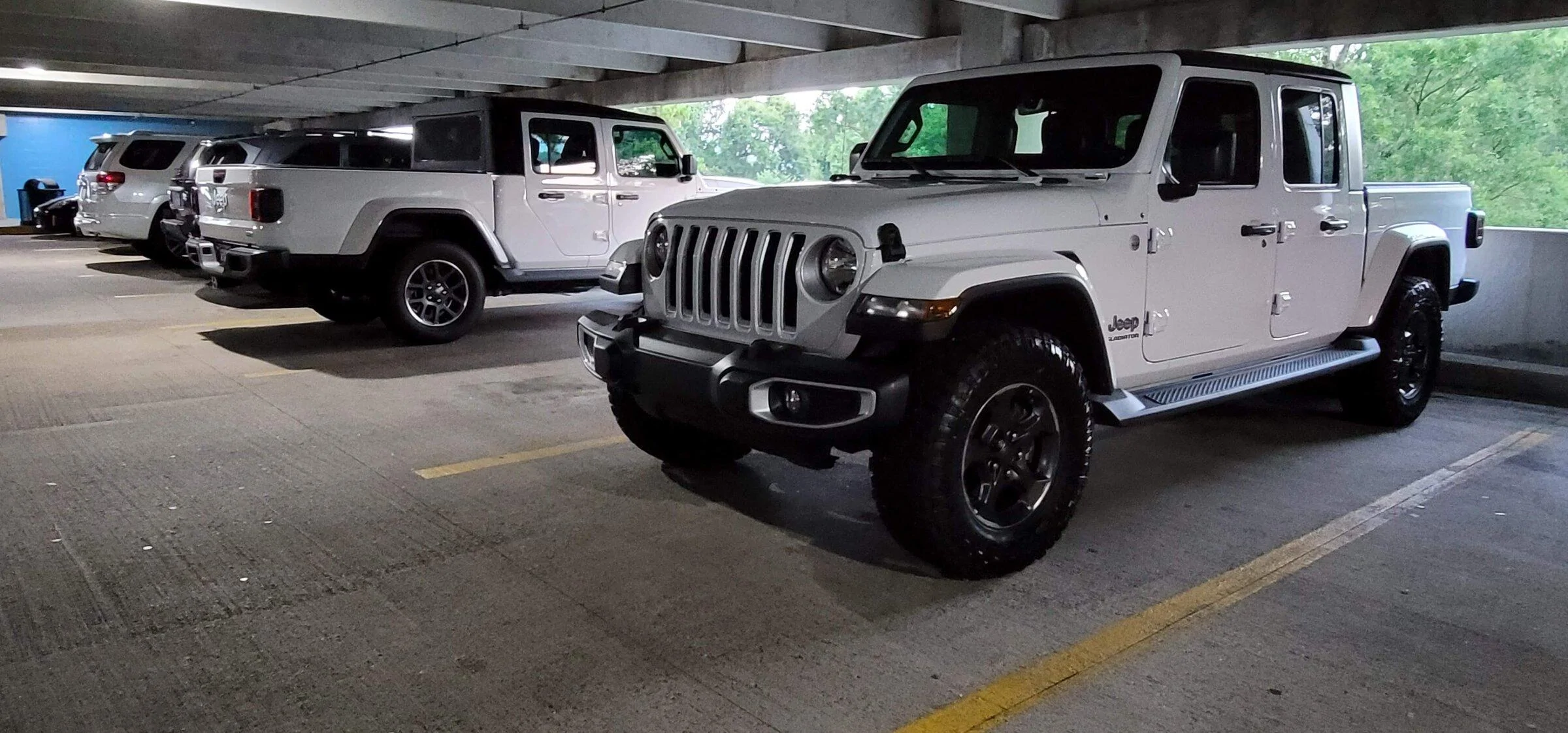

My coworker with the stock Overland rims and tires. BTW she has since added a 2.5" lift and much bigger tires with new rims.
My Overland with take off Rubicon rims, no lift, with the DuraTrac LT285 /70 R17 for comparison. I searched a lot in the builds and decided on this as I'm not much of an offroader.

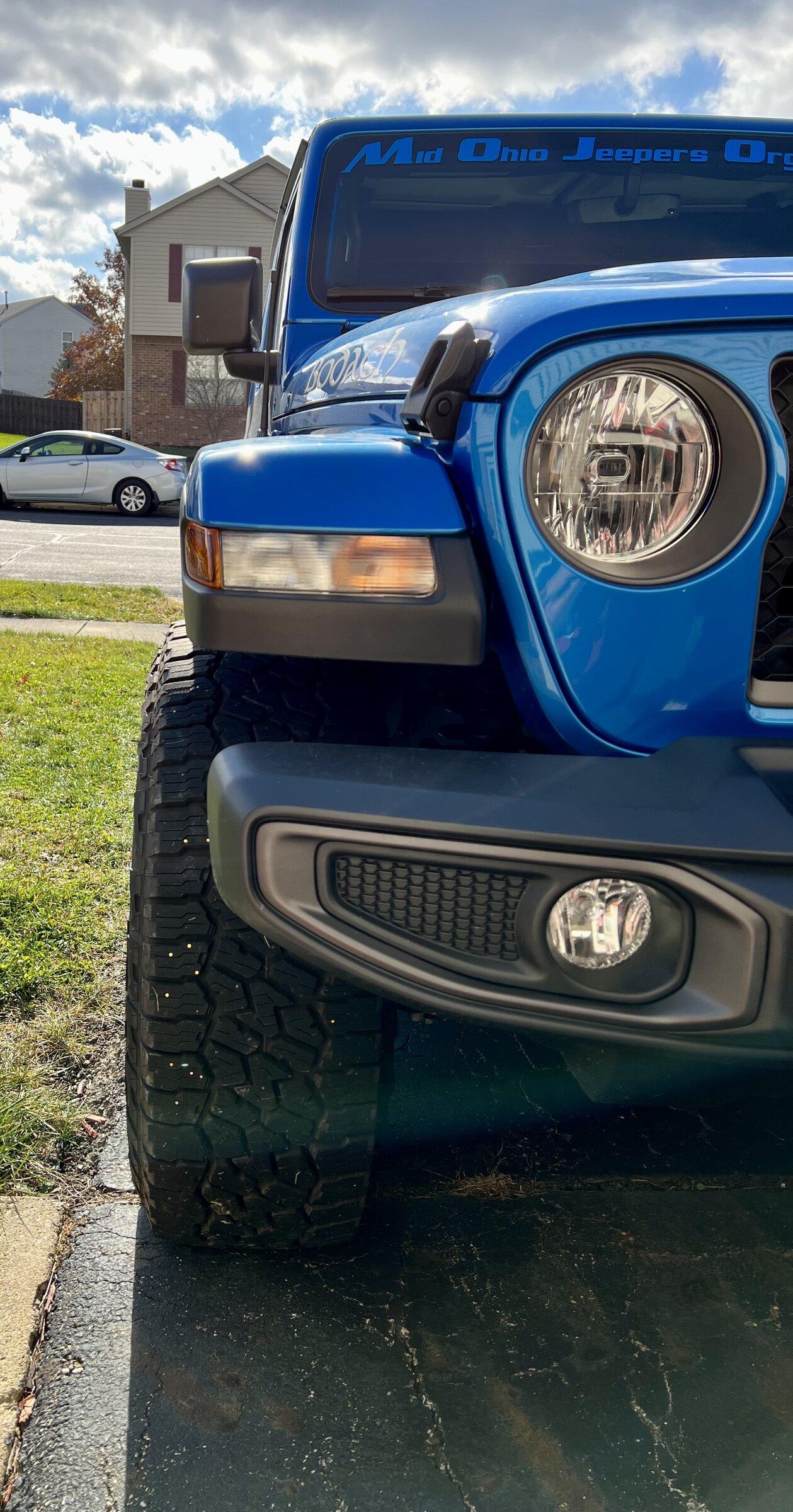

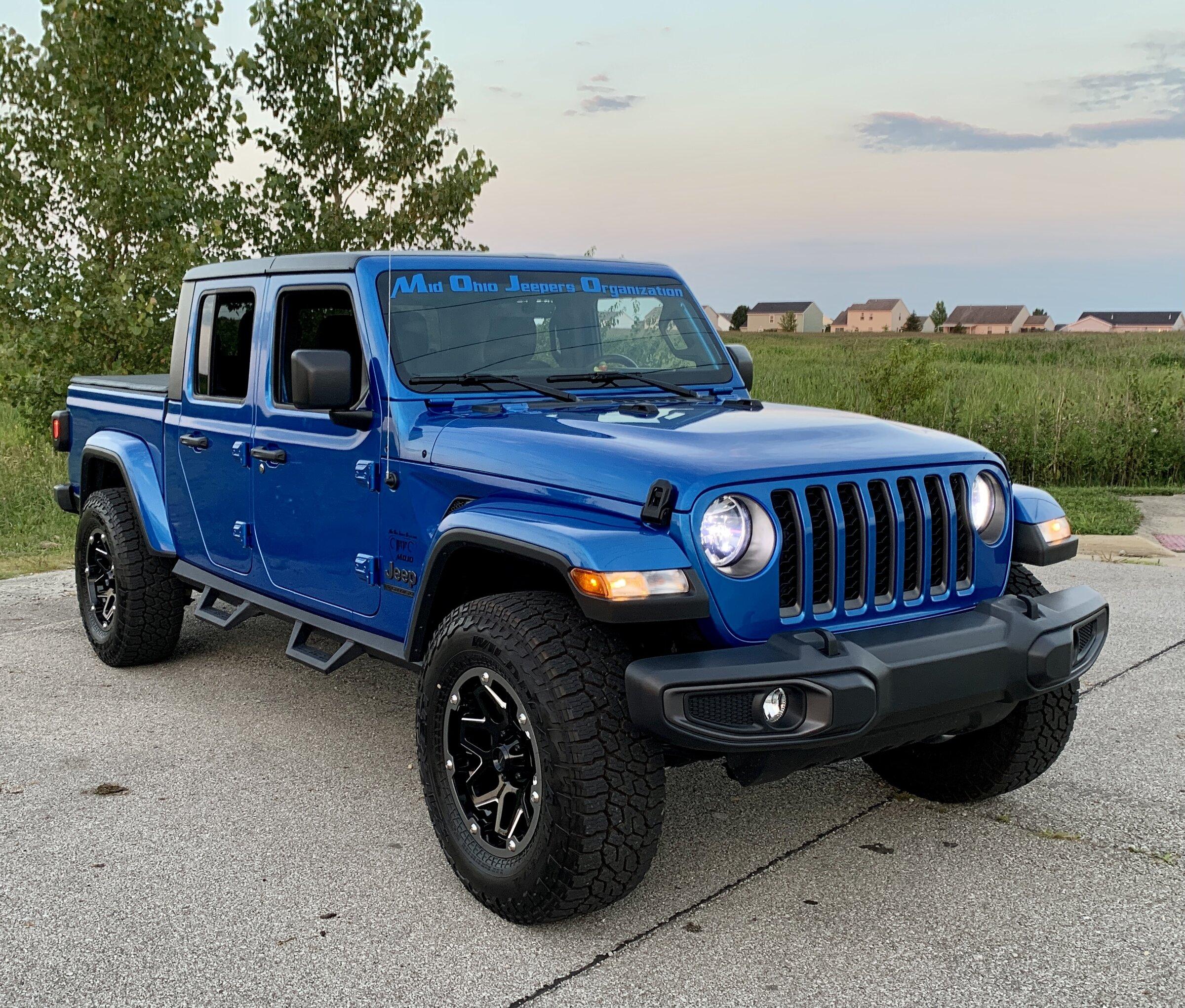

My 80AE also came with Overlands. I swapped them out for some 18x7 Visions (+12 offset) and 295/70R18 Falken Wildpeaks (34x11.5). I stayed with the 18s because I actually like the way they look, and that would allow me to keep one of the factory wheels for the spare.
No rubbing with a 1.5” level in the front, and very minimal poke.

For the record, my Falkens when mounted actually measure almost 1/4 taller than the 315/70R17 on my daughters JKU.
