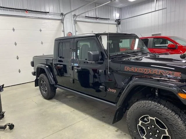

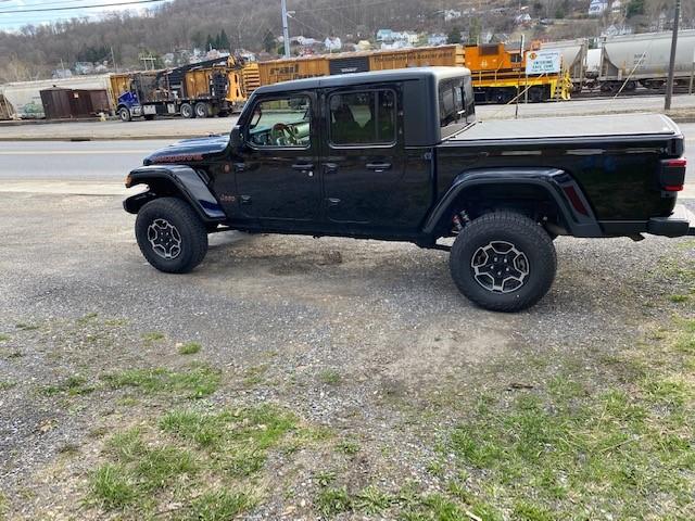

I posted these pictures in another post but I think this might help you. I changed my original falken tires from a 285/70/17 to a 255/80/17 same tire. They are about a half inch taller 32.8 to 33.1 and 1.5 inches narrorower. The before picture is without the AEV lift and after is with it. Going with the skinnier tires I picked up about 2 mpg as the tires are about 10 pounds less.
Jeep Gladiator Replacing my stock Mojave tires for some more AT tires? jeepbeforeaev
Jeep Gladiator Replacing my stock Mojave tires for some more AT tires? jeepafteraev

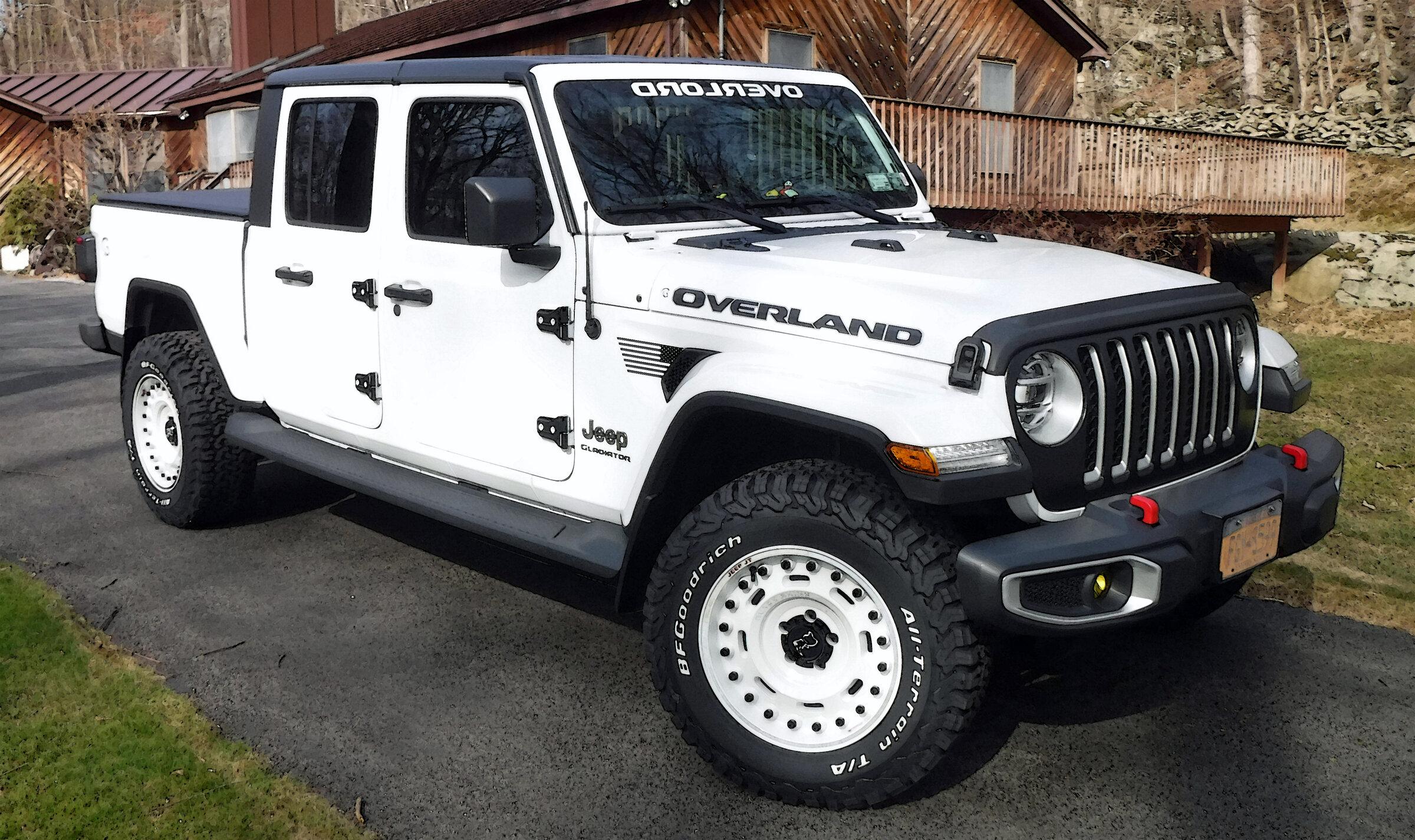

KO2s
Quiet on the road and good traction off.
Not a huge BFG A/T fan (irrelevant), but I love the look of that white wheel on your white Jeep with the white letters out. That’s a great look.
what wheel is that? I’ve never seen it, but I dig it.
