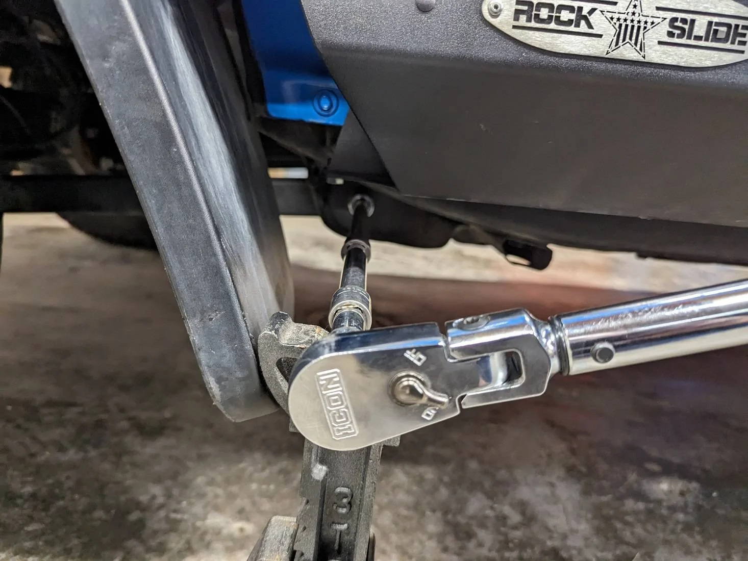

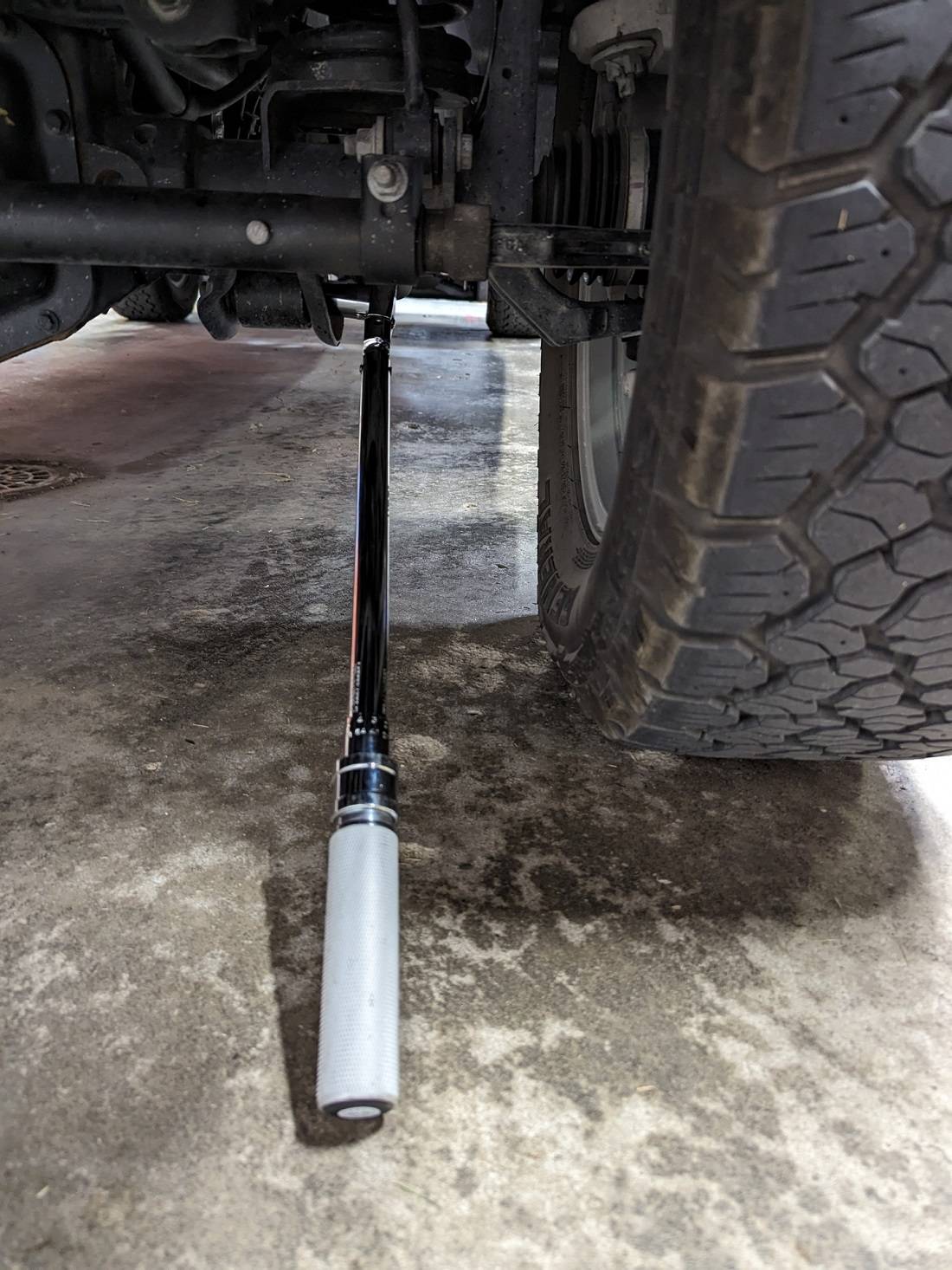

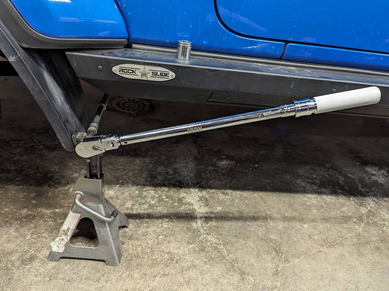

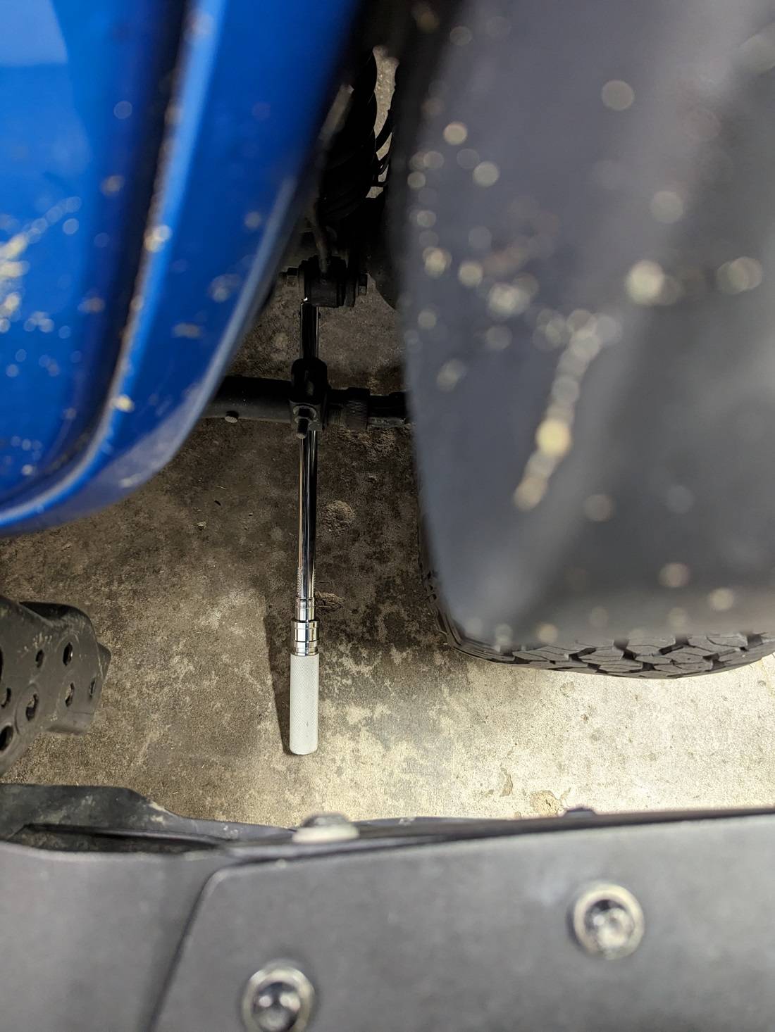

And for the lower control arms - there's this ->
Jeep Gladiator leveling kit and alignment PXL_20230825_025230625
Jeep Gladiator leveling kit and alignment PXL_20230825_025239429
Jeep Gladiator leveling kit and alignment PXL_20230825_025417550
Jeep Gladiator leveling kit and alignment PXL_20230825_025428863
Lowers are simple. Uppers are tougher but getting creative - or eating your spinach.........
