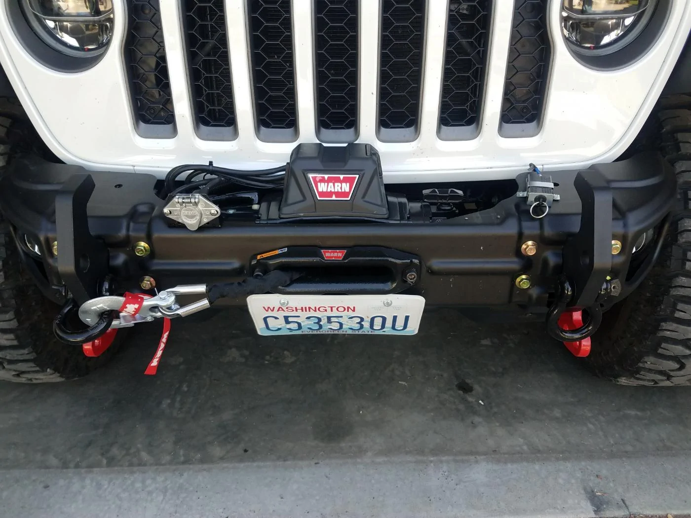

Threaded holes in steel bumper for homemade bracket - two simple machine screws to remove when going off road .
I am thinking about that bumper. I have read a few reviews and they are generally good, but a few folks reported issues with the installation and installing the Warn winch. I am a bit confused as to why you would have to trim to fit a Warn winch into a Warn bumper. Did you have any issues?

Actually this is a Quadratec winch, but it mounts the same as the Warn winch on my TJ. There is a requirement to trim one bracket if using a certain Warn winch and that is covered in the bumper installation manual. It does not appear to be a big deal.

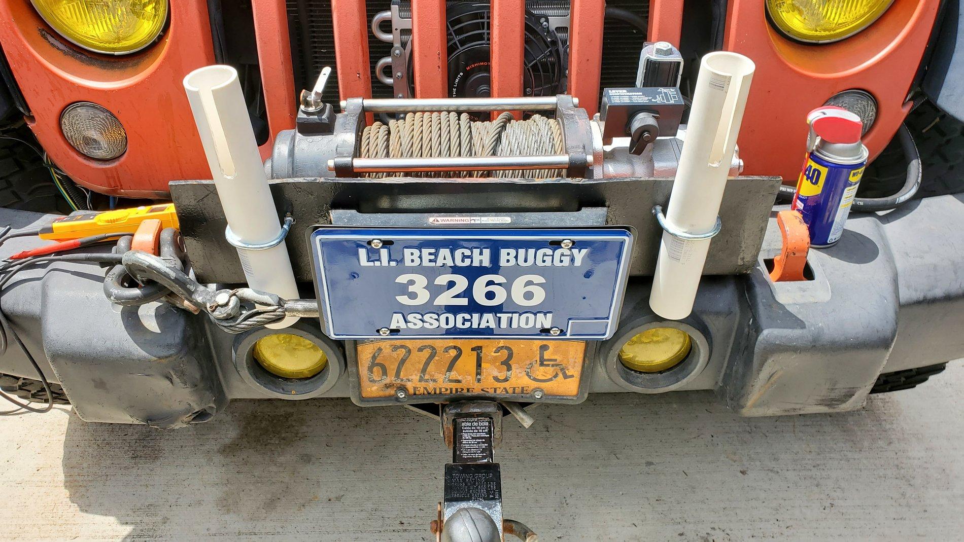

I just recently put the quadratec plate mount on and couldn't be happier with the setup. The clamps are snug and stiff. This won't be coming off unless you mean it.

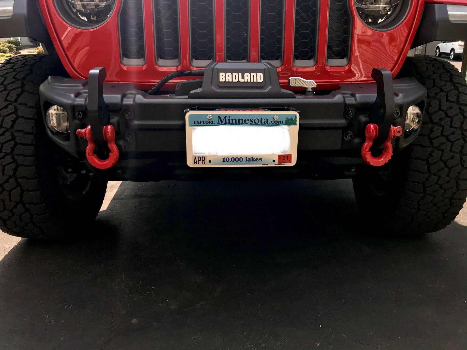

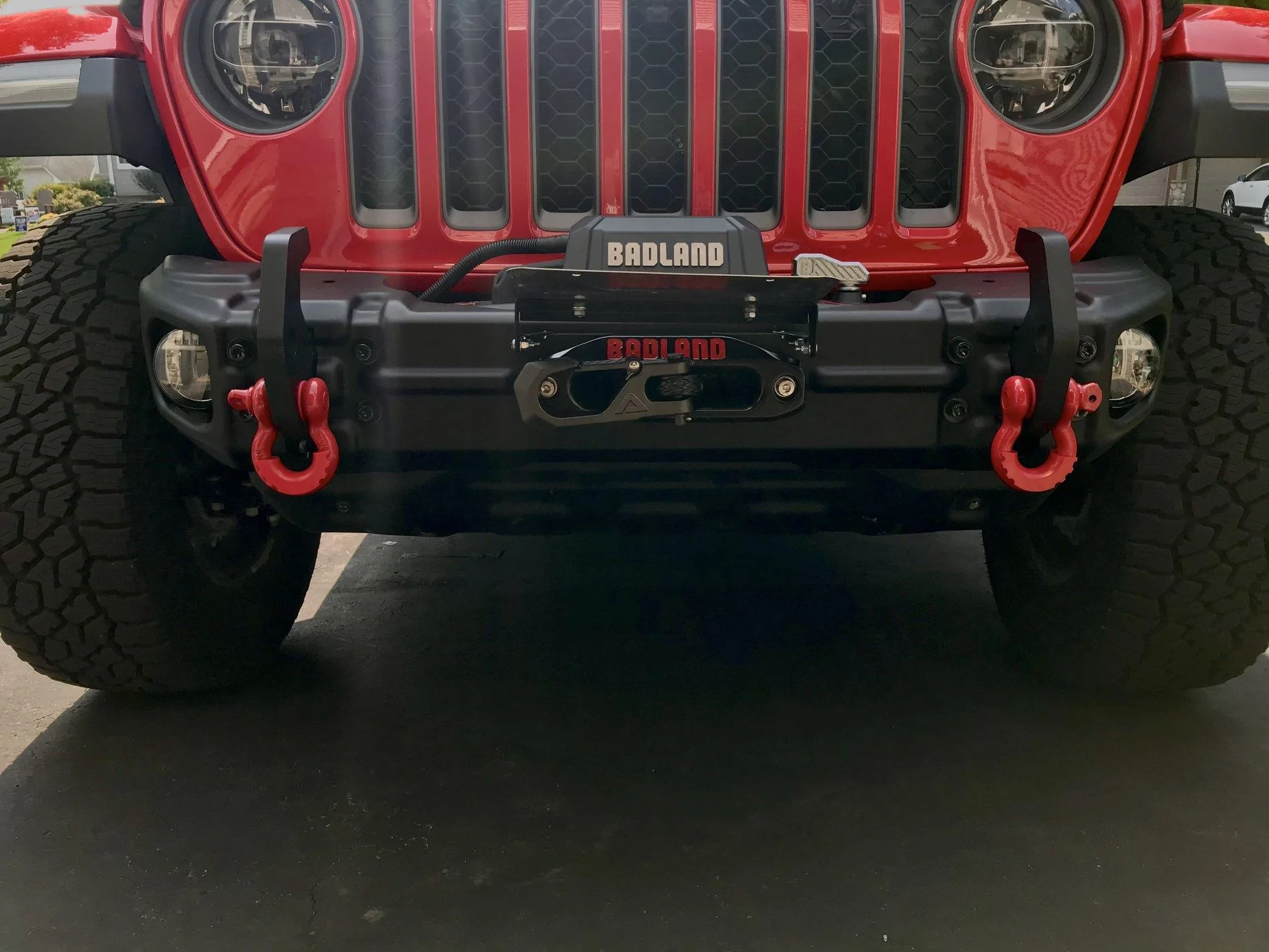

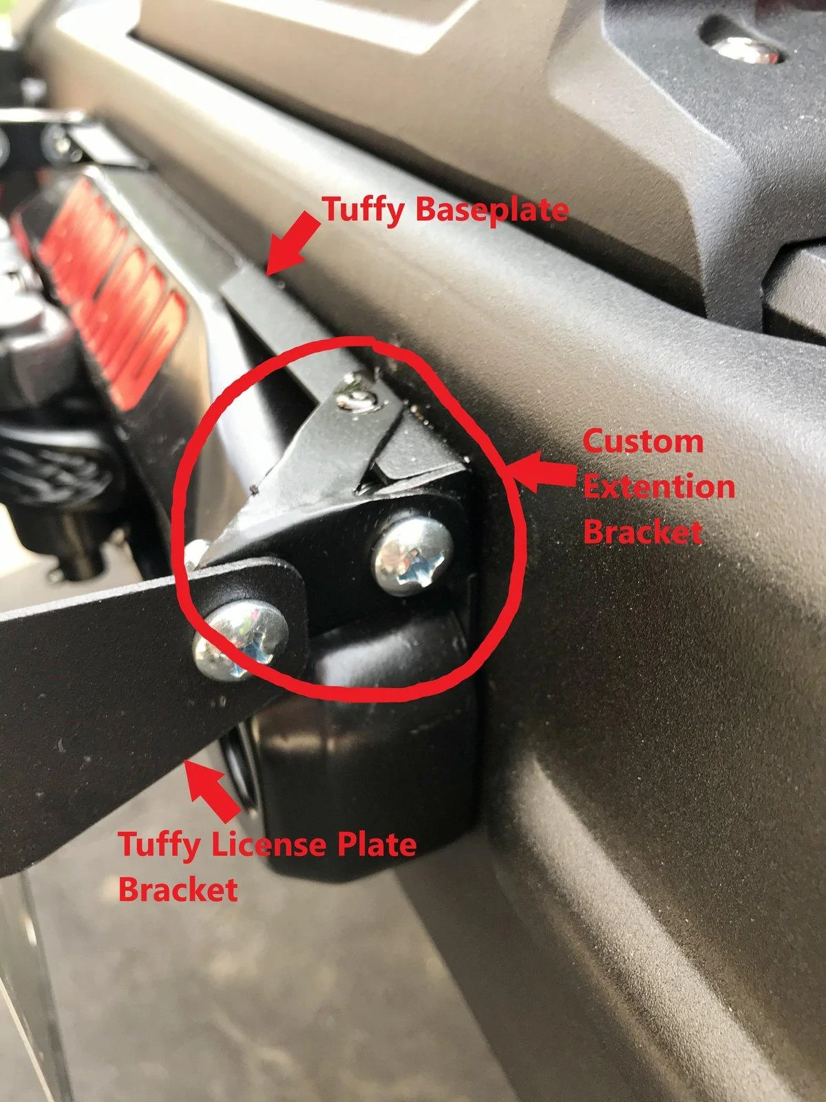

I'll pile on. I also went with the Tuffy hawse fairlead bracket. I have the Badlands Apex winch which comes with a very thick hawse fairlead. It's so thick that the standard tuffy bracket can't get out in front of it. To solve this I made a couple of brackets of my own to extend their baseplate.
Down:
Jeep Gladiator License plate with winch? IMG_5392
Up:
Jeep Gladiator License plate with winch? IMG_5394
Custom Brackets:
Jeep Gladiator License plate with winch? IMG_5397_1

Thanks for that post! I was convinced I wanted the tuffy bracket until I saw this.

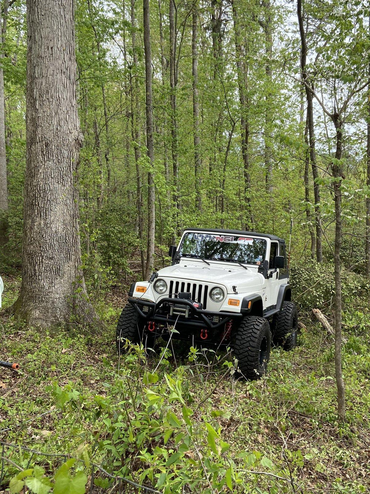

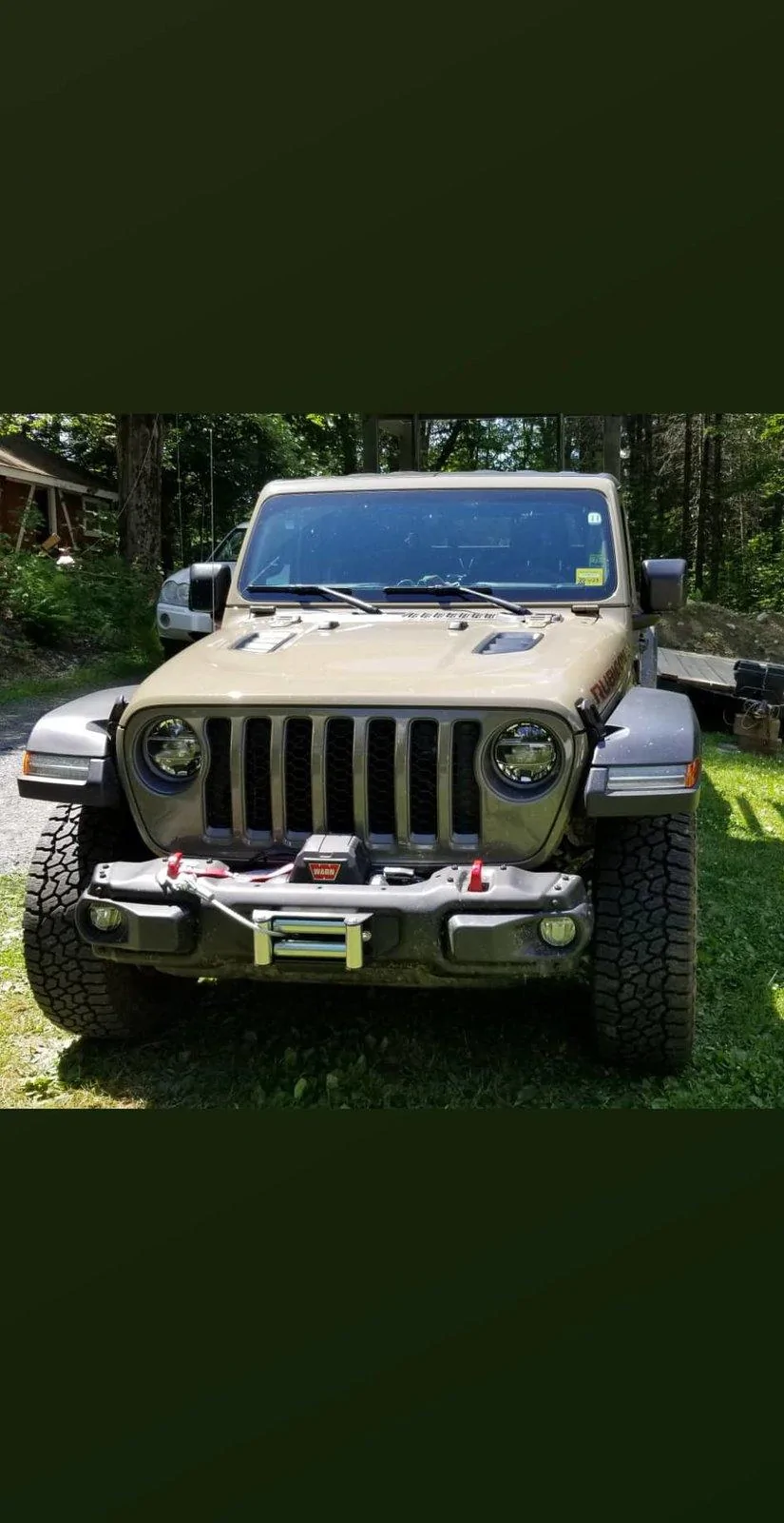

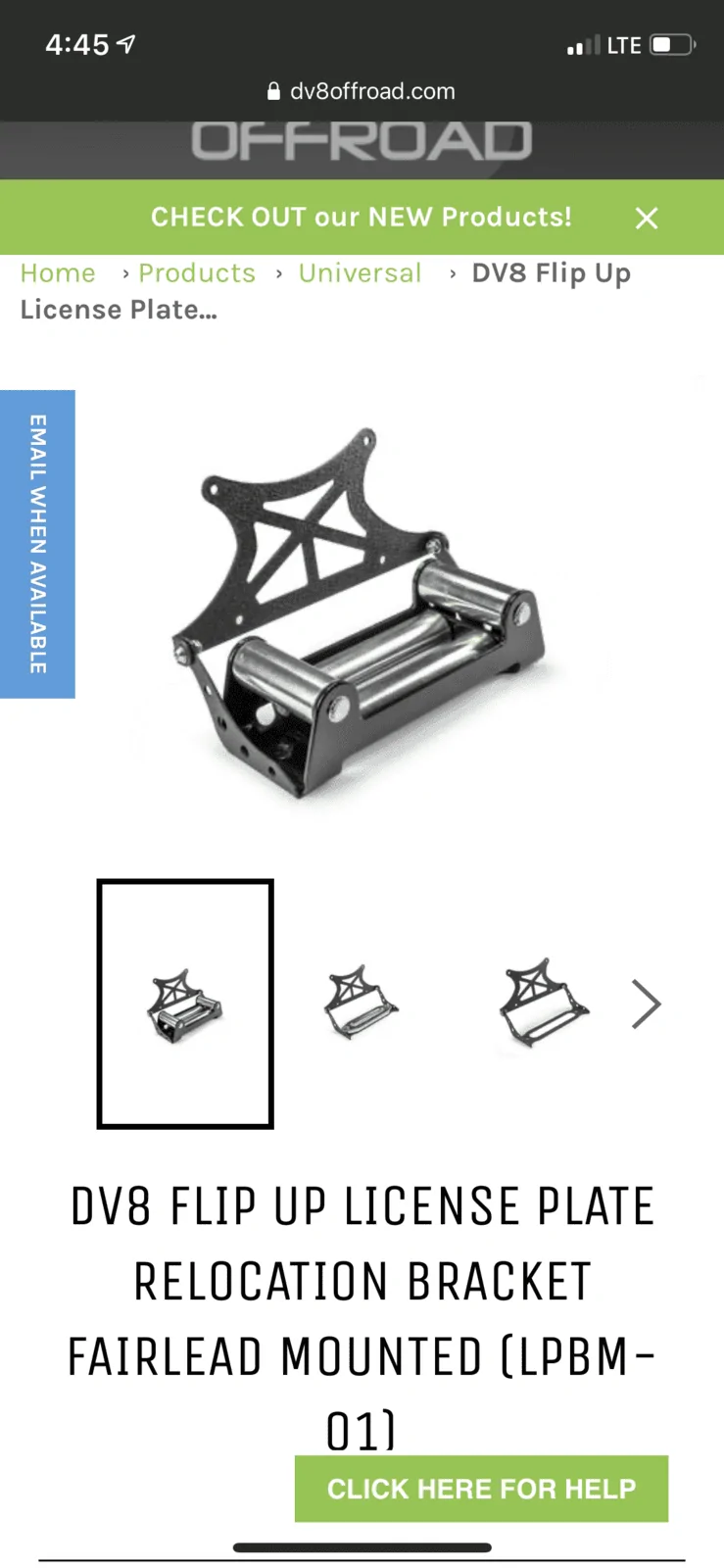

Had this setup on my TJ. DV8 license plate bracket that swung up and out of the way. A little pricey ~$45, but worth it for the quality. In use in the picture ripping up some fence that laid over and was overgrown with vines
