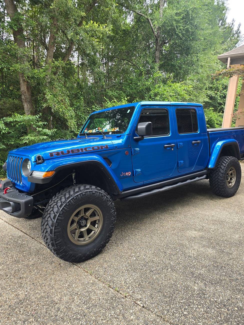

If you're really set on getting a lift kit Clayton Offroad is nice. I have their 2.5 Overland plus kit and am very happy with it

What size tires are those? Looks like you have the fox 2.0 with remote reservoir? Do you wish you had gone with an adjustable shock or you happy with that set up?

They are 35x12.50R17. I am happy with the FOX 2.0s but do wish I had spent the extra on the adjustable ones.
