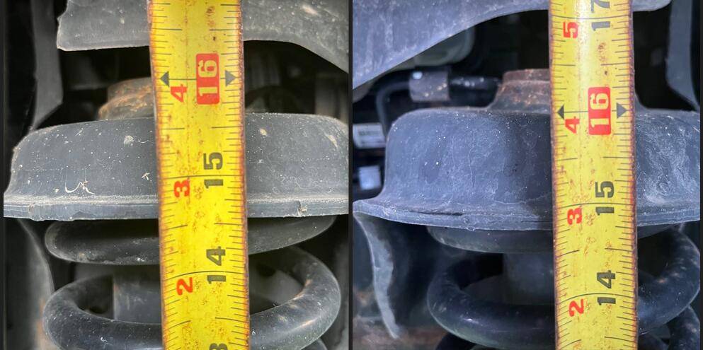

Hey all, I’m looking to see if we can start a mega thread for various lift brands and their heights. This measurement measures the upper coil perch to the axle tube. Yes I’m aware this isn’t 100% accurate BUT it will give people a ballpark idea of what to expect after a specific lift. I think the most accurate way to do this would be to list your trim level, lift brand, advertised lift height, and any modifications that would affect the measurement such as factory metal bumper, aftermarket bumper, winch etc.
This won’t be perfect but it will ballpark things. Personally I’d rather have some sort of idea of what to expect as opposed to going in blind. If this actually takes off and gains participation it could become very valuable for prospective buyers.
Jeep Gladiator Lift height mega thread IMG_9230
I’ll start:
2021 JTR
2.5” spacer lift
Rugged ridge arcus front bumper, factory steel rear, super winch 9500 w/synthetic rope
Measurement- 12.5”

2021 Rubicon EcoDiesel
RK X-Factor w/Synergy F&R Springs
Front Synergy 8863-50 (Supposed to be 3" for my model)
Measurement 15 7/8 😳

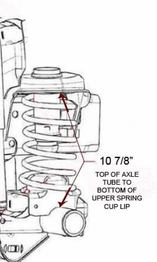

I know when this image was originally posted, it was labeled as being the measurement for a stock Rubicon. Can anyone confirm this measurement?
