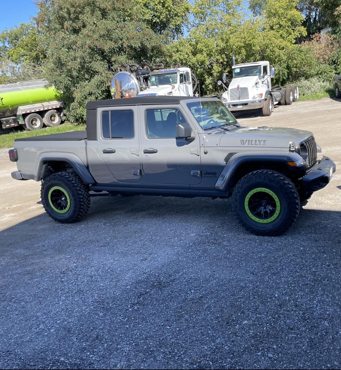

Since you have a Rubi, I feel you will want 37" tires. The highline front fender makes the 35"s look small.
For shit and giggles, 2" AEV spacer on 35's

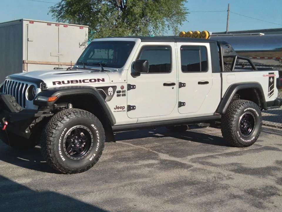

Here's mine with no lift on 35's and with 2.5" SST Readylift on 35's and with 2.5" SST Readylift and Rubicon Takeoff springs in the front on 35's which gave me about 3-1/4 inches in the front and 2 in the rear with the Readylift spacers.
No lift on BFG KO2 35's
Jeep Gladiator allowed lift height IMG_20200213_183121
Jeep Gladiator allowed lift height IMG_20200213_183207
2.5 inch Readylift with BFG KO2 35's
Jeep Gladiator allowed lift height MVIMG_20200215_113302
Jeep Gladiator allowed lift height MVIMG_20200215_113311
2.5" Readylift and Rubicon front springs on BFG KO2 35's and 1-3/4 inch wheel spacers
Jeep Gladiator allowed lift height PXL_20210107_204552153
Jeep Gladiator allowed lift height PXL_20200913_173326147
Same lift setup on Kanati Trail hog 37 12.5 17
Jeep Gladiator allowed lift height PXL_20220315_220315579.MP
Same lift setup on Fuel 17x9 wheels with -12 offset and Kanti 37's
Jeep Gladiator allowed lift height PXL_20220601_213734217.MP
Just to give you a idea. Personal I think anything over 2 requires 37's to look right. Almost like they are made for 37's

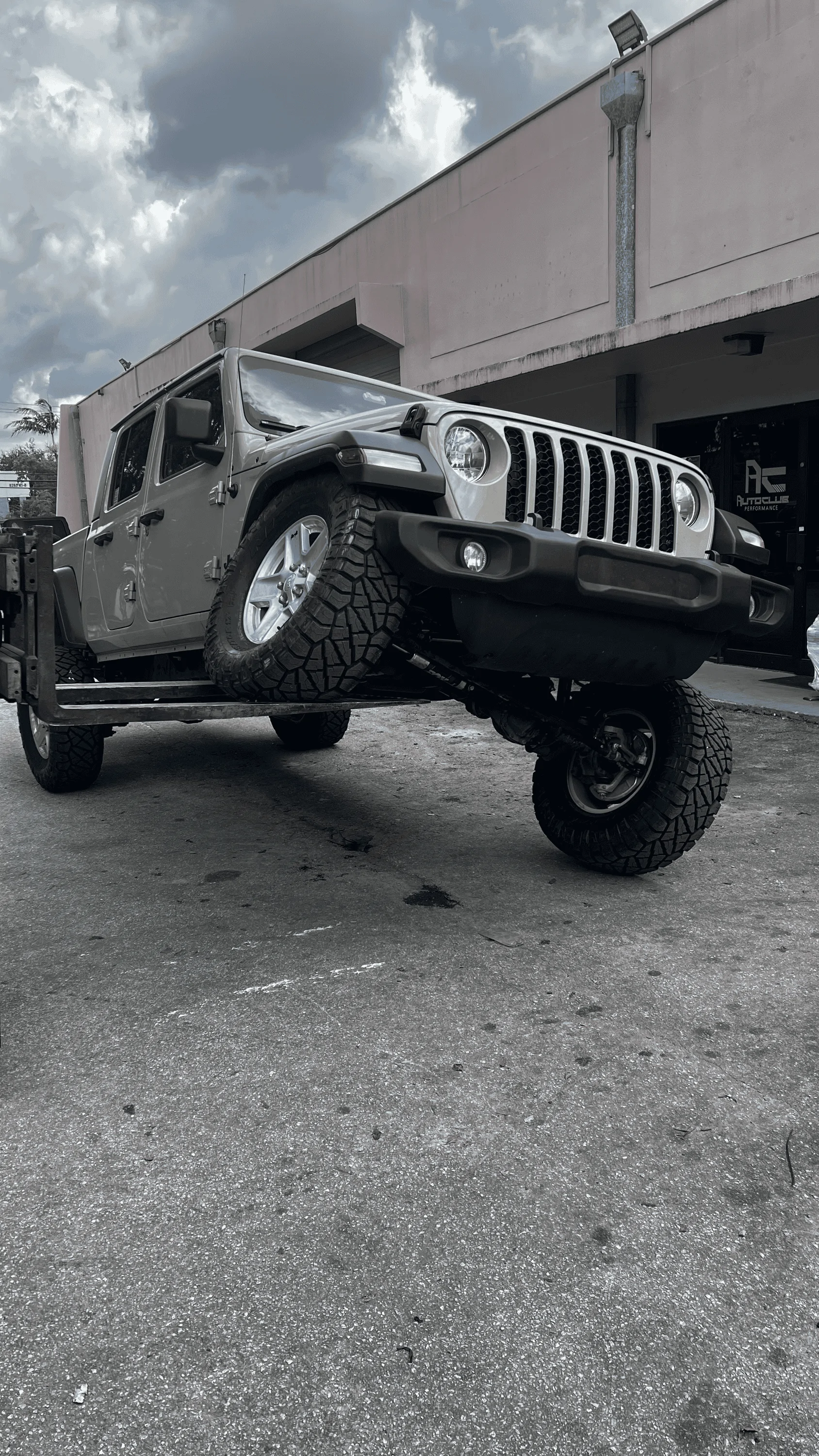

3.5 MetalCloak with 315 nitto ridge
Jeep Gladiator allowed lift height tempImageqSehOx
Jeep Gladiator allowed lift height tempImagemntlw8
